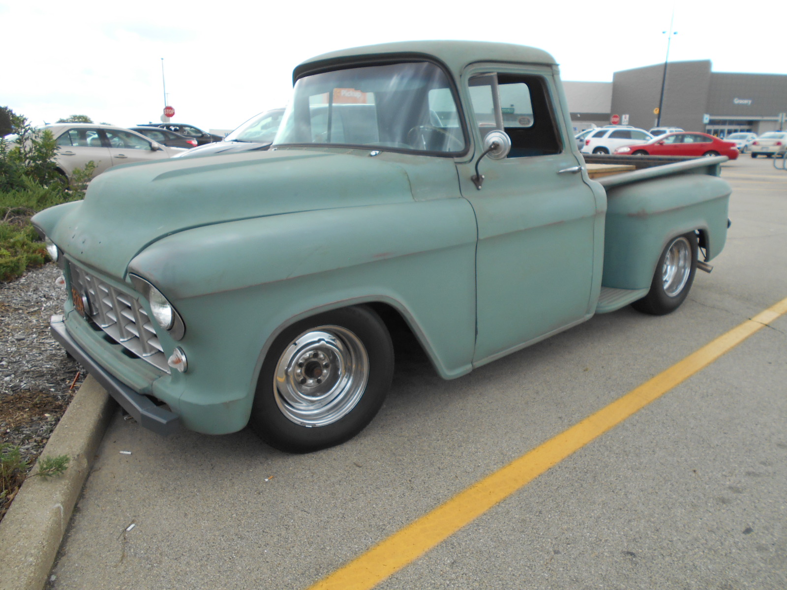

    brush painted my 55 pickup for $11.00 total, , $8.00 quart of paint, $3.00 3 inch brush and 2 days of work.
    Cheap Walmart flat house paint, brushed over 4 different colored body panels, sprayed some red oxide on the high-wear areas, scuffed it up a bit after the grey/green paint, looks just fine to me, and no masking at all.
    ...that paint lays out real smooth too.

  9. rusty rocket
    Joined: Oct 30, 2011
    Posts: 5,299
    rusty rocket
    Ha looks good to me!!

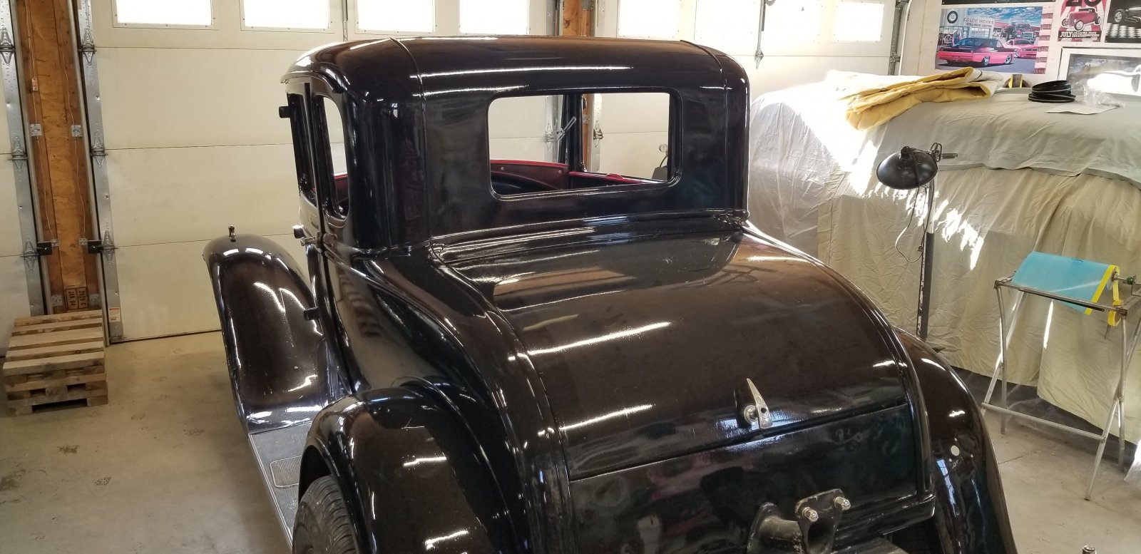

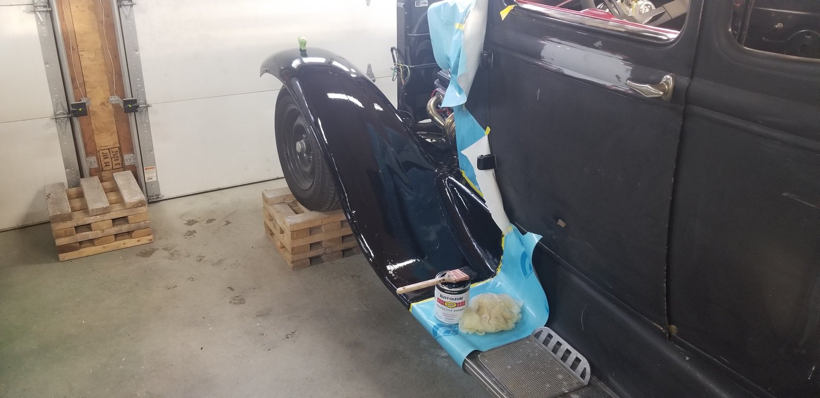

  22. Bugguts
    Joined: Aug 13, 2011
    Posts: 1,016
    Bugguts
    20201108_131425.jpg 20201108_134725.jpg 20201218_152256.jpg 20201218_152251.jpg 20201218_152300.jpg IMG952680.jpg 20201226_123740.jpg 20201226_123751.jpg 20201226_123808.jpg I brush painted my buddies coupe a couple years ago. He rolled it in ditch backwards and asked if I would repair it. As we talked about it, he said "I dont want one of your $20,000 paint jobs. Keep it simple and cheap." He had cancer and knew his days were numbered.
    I mentioned brushing it with RUSTOLEUM, and he was sold.
    $12 quart of paint.
    $12 brush.
    I rolled the primer on repaired areas and wetsanded and scotchbrited all panels, then got to brushing.
    It turned out pretty good. Of course you can see the brush marks when up close, but its shiny and all one color. He loved it and the new owner does to.
    winr, RyanAK, osage orange and 19 others like this.

    Our 29 A sedan was brush painted long ago. My wife made it clear I was NOT to repaint the car! Since the roof was replaced with metal, I brushed it with Rustoleum to emulate the old brushed paint. I did buff FB_IMG_1660795733438.jpg the whole car out to bring the shine up. Not sure what they used as lacquer thinner doesn't touch it, so it must be hardened.
  24. ^^^ If those two cars aren't proof that a brush job can look good, you must be blind. I think the OP needs more details and advice from @Buggats and encouragement from the rest of us...
