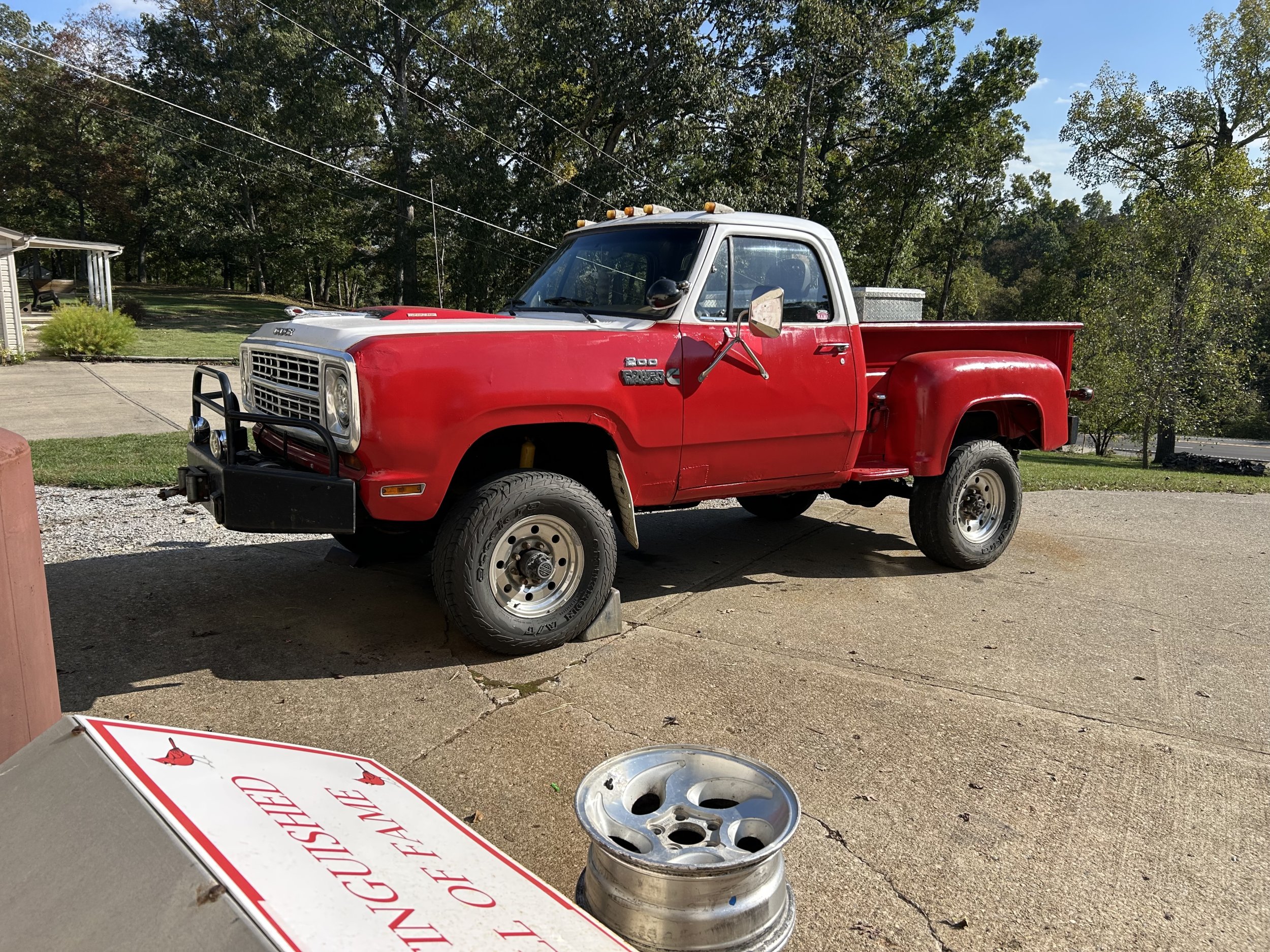

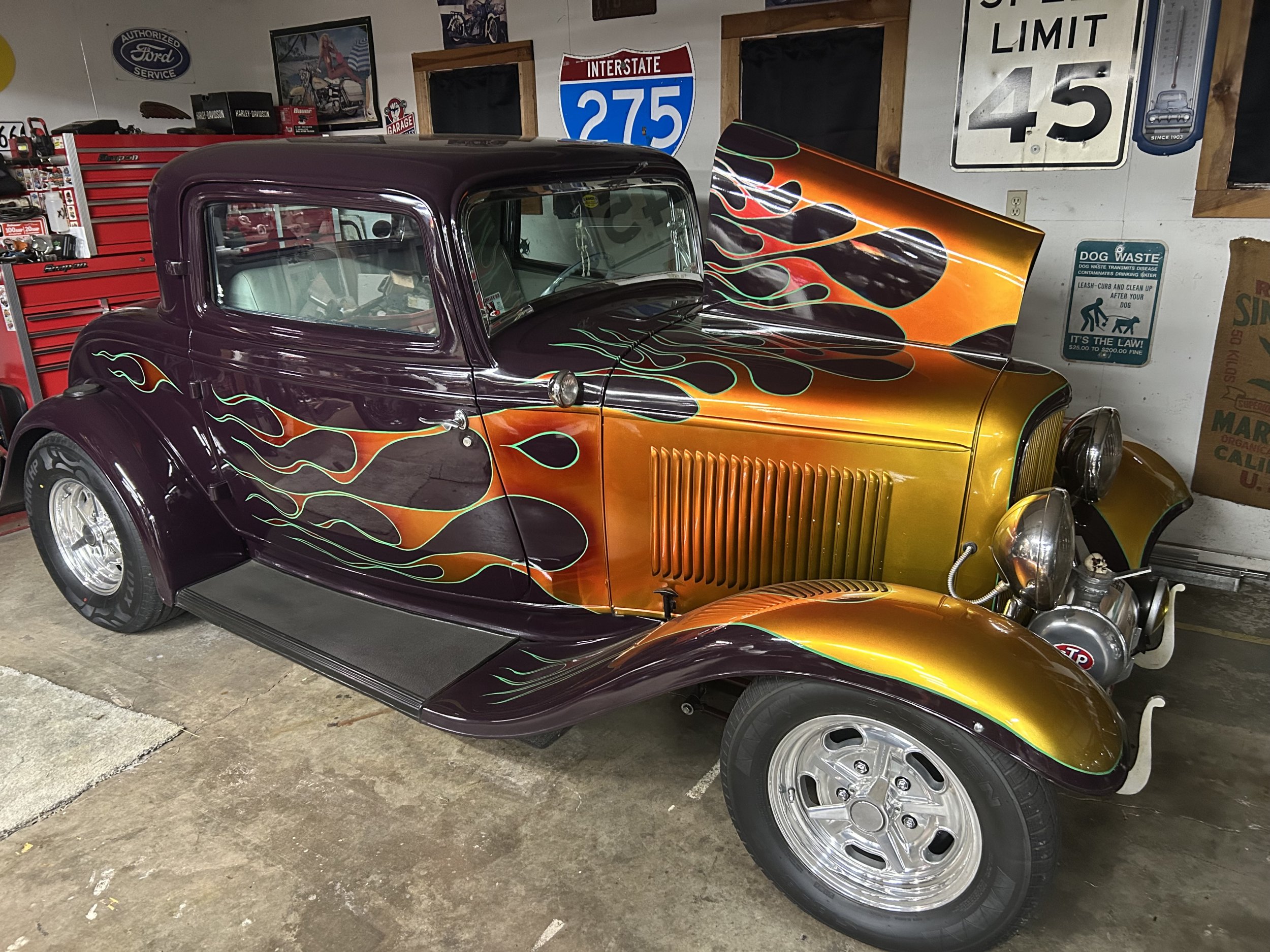

    The 32 is single stage urethane , no clear , only on the flames . The Power Wagon is fresh as still tacky roller red , roller clear coat .
