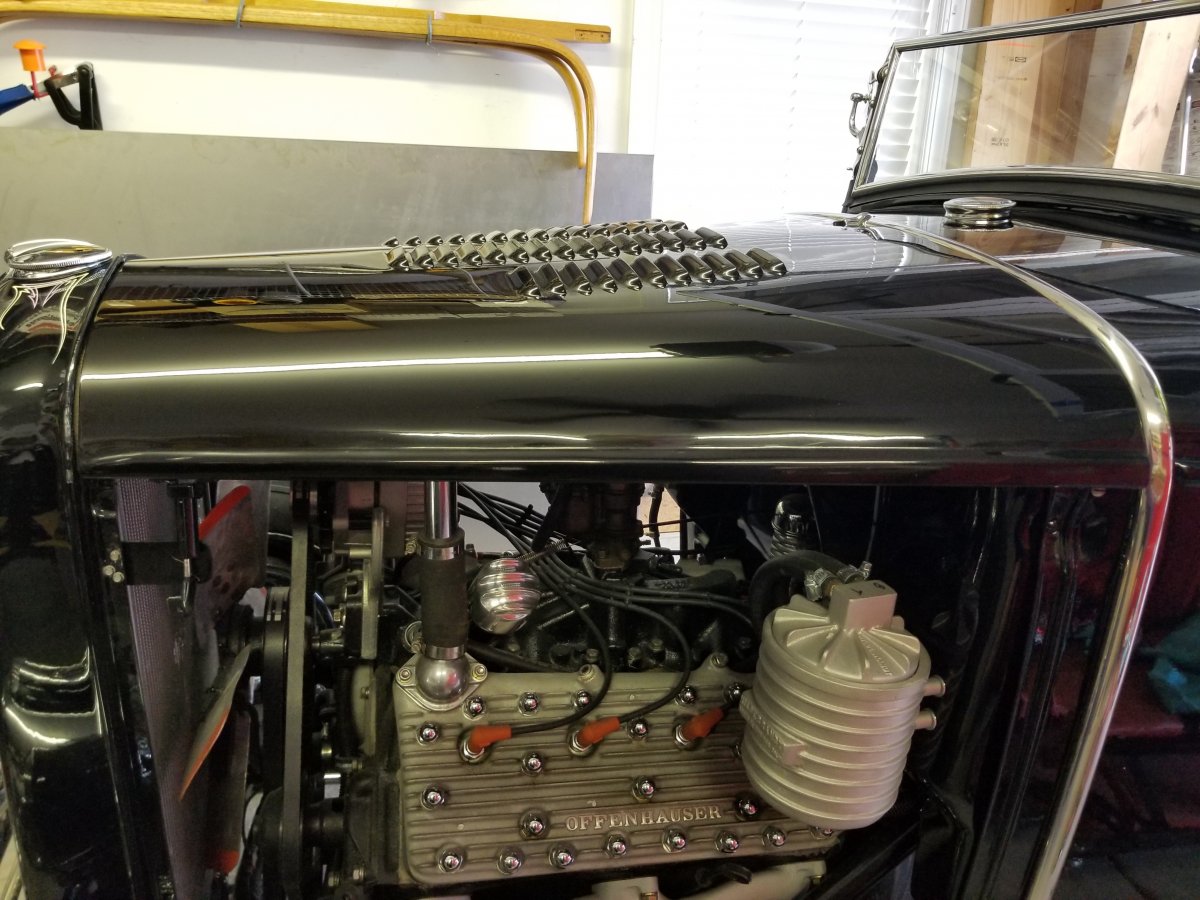

    That looks great. I'm curious what you used to retain the hood onto the body?

    Blues4U - The hood is kept on by a center pin that I welded on the hood which inserts where the normal A hinge would go on the cowl. I then used some standard hood hold downs on the two sides of the radiator. Seems to work ok so far. Here's a pic.

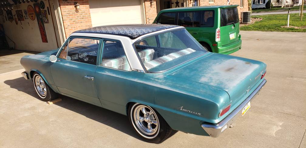

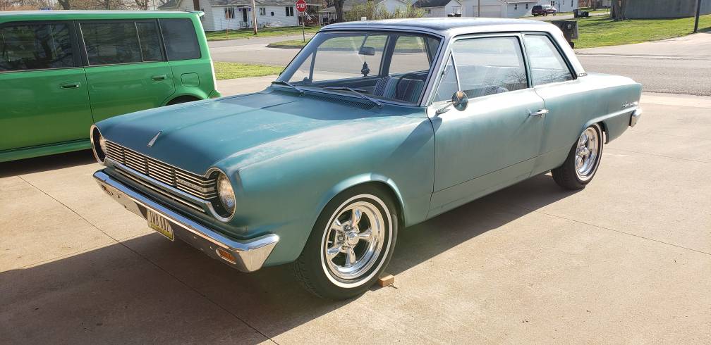

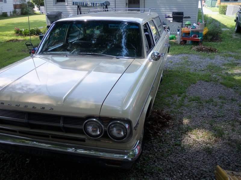

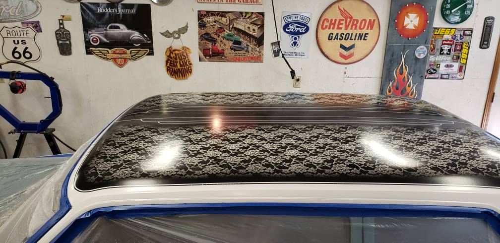

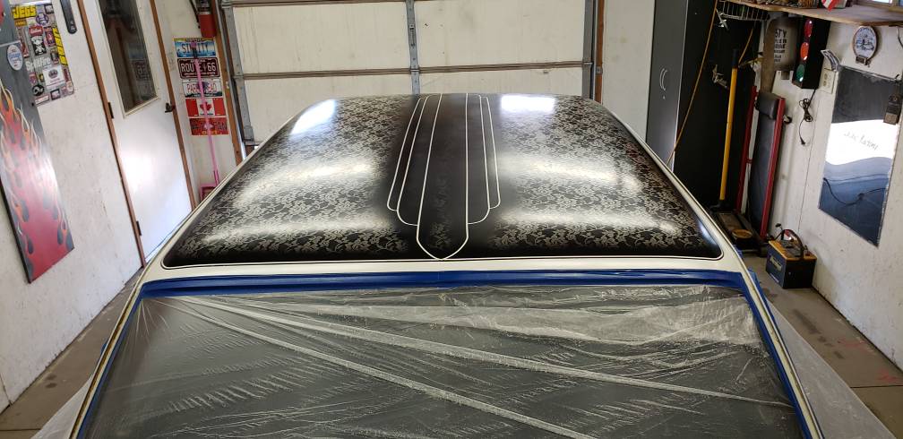

    Spay bombed the roof of my Rambler a couple weeks ago, if that counts? 20210404_130620.jpeg 20210404_130632.jpeg 20210405_172458.jpeg 20210405_172520.jpeg

    Ah, clever! Thanks for the info. One of these days I'm going to add a hood like that. BTW, that paint is just gorgeous, that came out really well.
