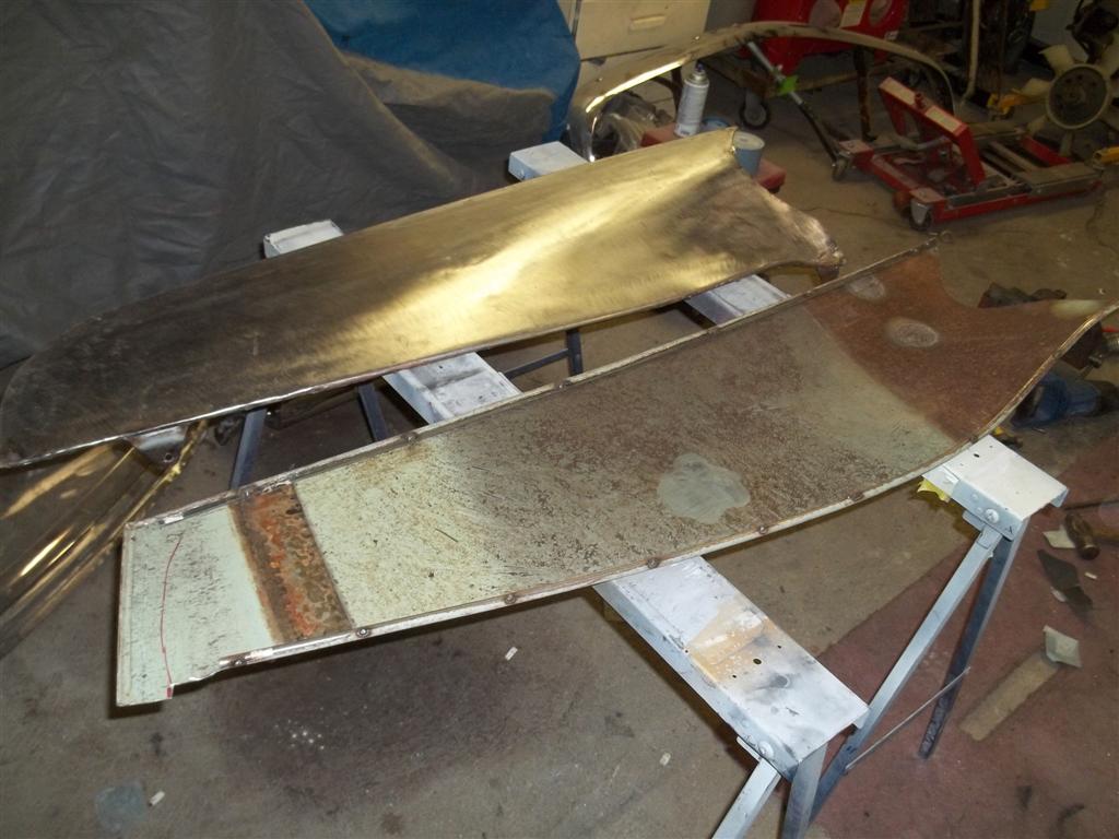

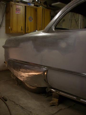

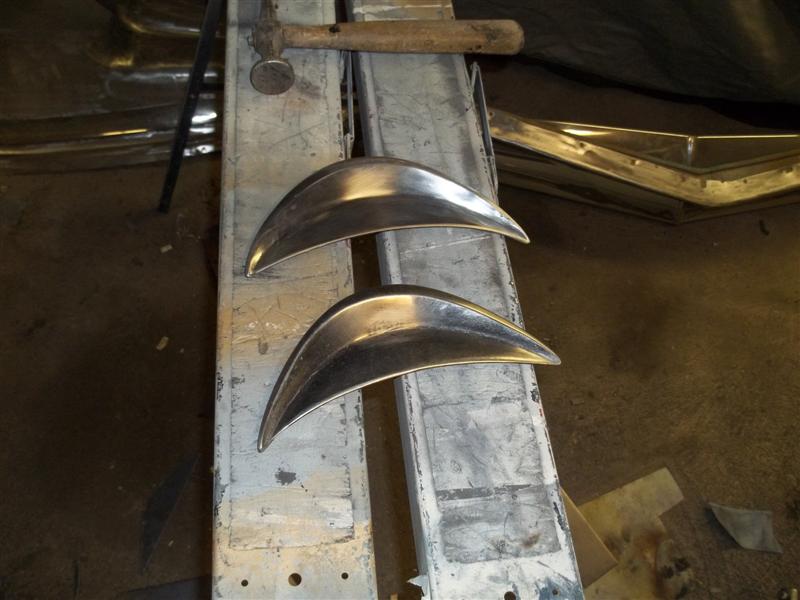

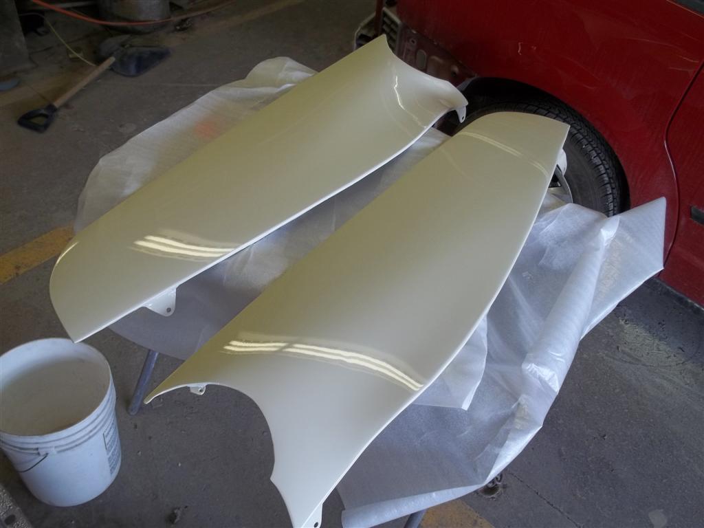

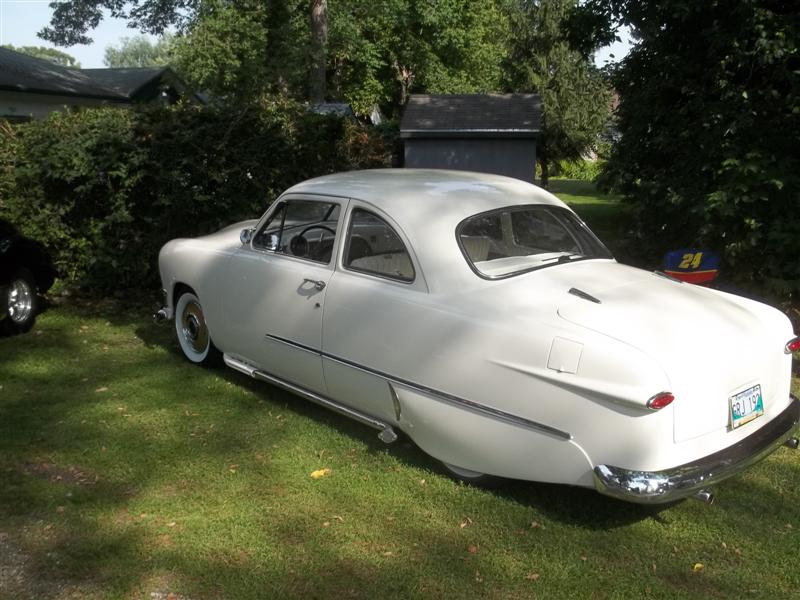

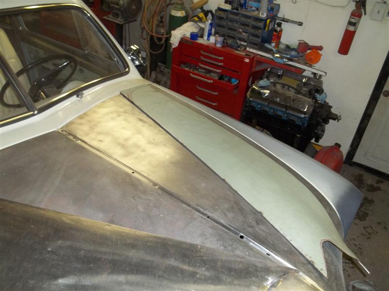

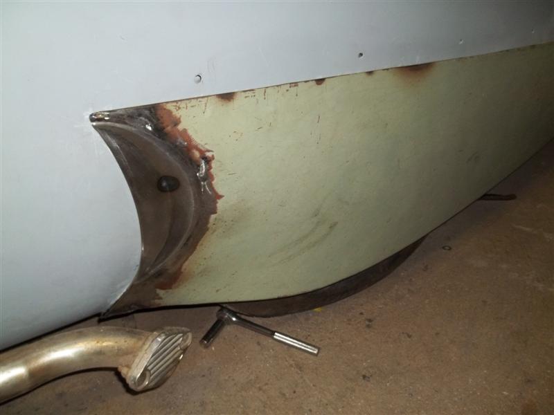

    Made my own from a donor 50 hood for my 50 coupe. Hood offered some complex curves and rt and lt sides. Gave me the basic shape to rework them. Made a frame and folded the edges over like a door skin. Then made a leading edge scoop out of 1/8 plate out of 3 pieces.
    Not everyones cup of tea but i kinda like them. torino build 003 (Medium).jpg torino build 005 (Large).jpg 50 ford 596 (Medium).jpg 50 ford 592 (Medium).jpg 50 ford 176 (Small).jpg misc 027 (Large).jpg misc 052 (Medium).jpg

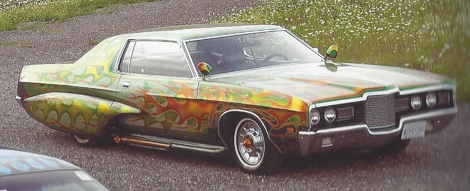

    That is bad ***! Question though, are the forward ends permanently attached to the doors?
    OG lil E likes this.
  23. stanlow69
    Joined: Feb 21, 2010
    Posts: 7,346
    stanlow69
    They`d have to be. Might be just bolted on. It`s Yosmite Sam Radoff`s from Canada. Somewhere I`ve seen a picture of him holding one in the upright position.
