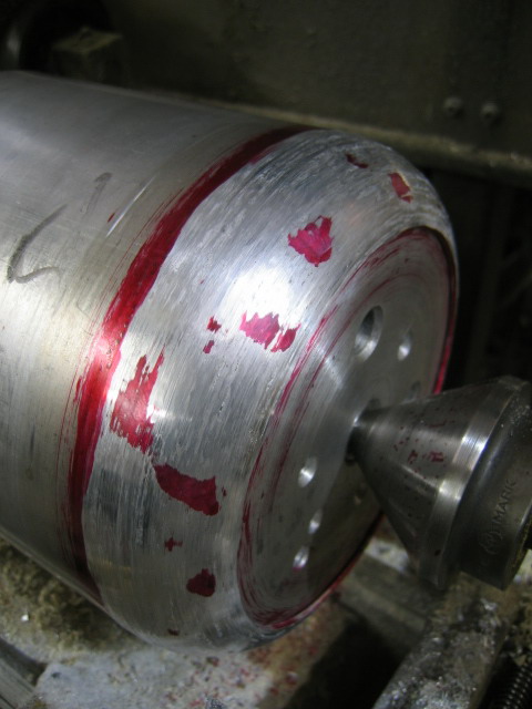

    If I can ask; Set #14, I'm struggling on visualizing how you got results from picture 4 to 5; did you actually file down the high spot ripples in pic 4 to get smooth in pic 5?

    51 - Yes I did - I really would'nt call them ripples - but there are high & low spots.
    As you shrink the material over the radius, the part picks up thickness - So much so, that even after the file job the edge is still thicker than what you started with.
    The finish on the inside is as nice as the finish on the die or form - the finish on the out side, not so much.....Lots of hammer'n - lots of file work ( easy in the lathe ) a few more coats of ****m & then sand, sand, sand.
    I will see if I have a picture ( in between 4 & 5 )

    Here you go 51,
    The low spots are ( not really low ) or lets say not real deep - just low enuff to show up red.

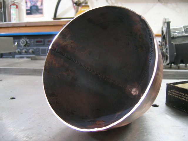

    So as I was looking for the above pic's & I found these.
    Felt I should add this info too,
    When you get to the metal finishing stage, MOST TIMES you are not dealing with material as thick as I use.
    These Copper parts are .063 thick - So a different aproach is needed.
    The weld crowns are Knocked off, then a small bit of blending.
    Sheet Copper moves around when you weld it up - even with tight fits.
    The inside welds are knocked down so the part can go back over the form.
    I hammer the area's around the low spots, to drive the low spots up.
    In the spots were I can not get the movment I want working off the buck, I switch to a small dolly to raise the low spot up.
    The sanding or filing on this parts is ONLY to show were the shape is off.
    This part has a way to go, but when I'm done it will be as uniform as the buck.
