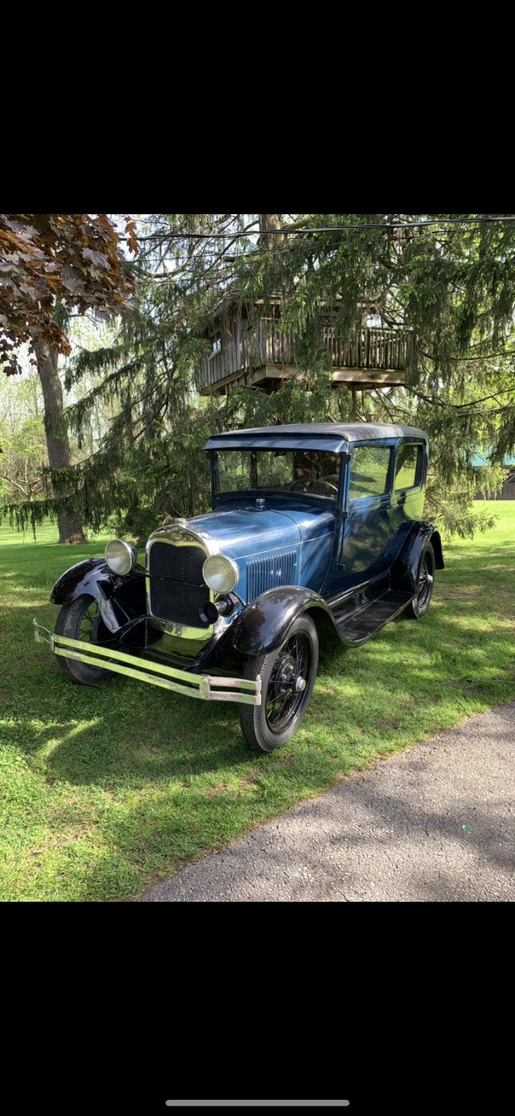

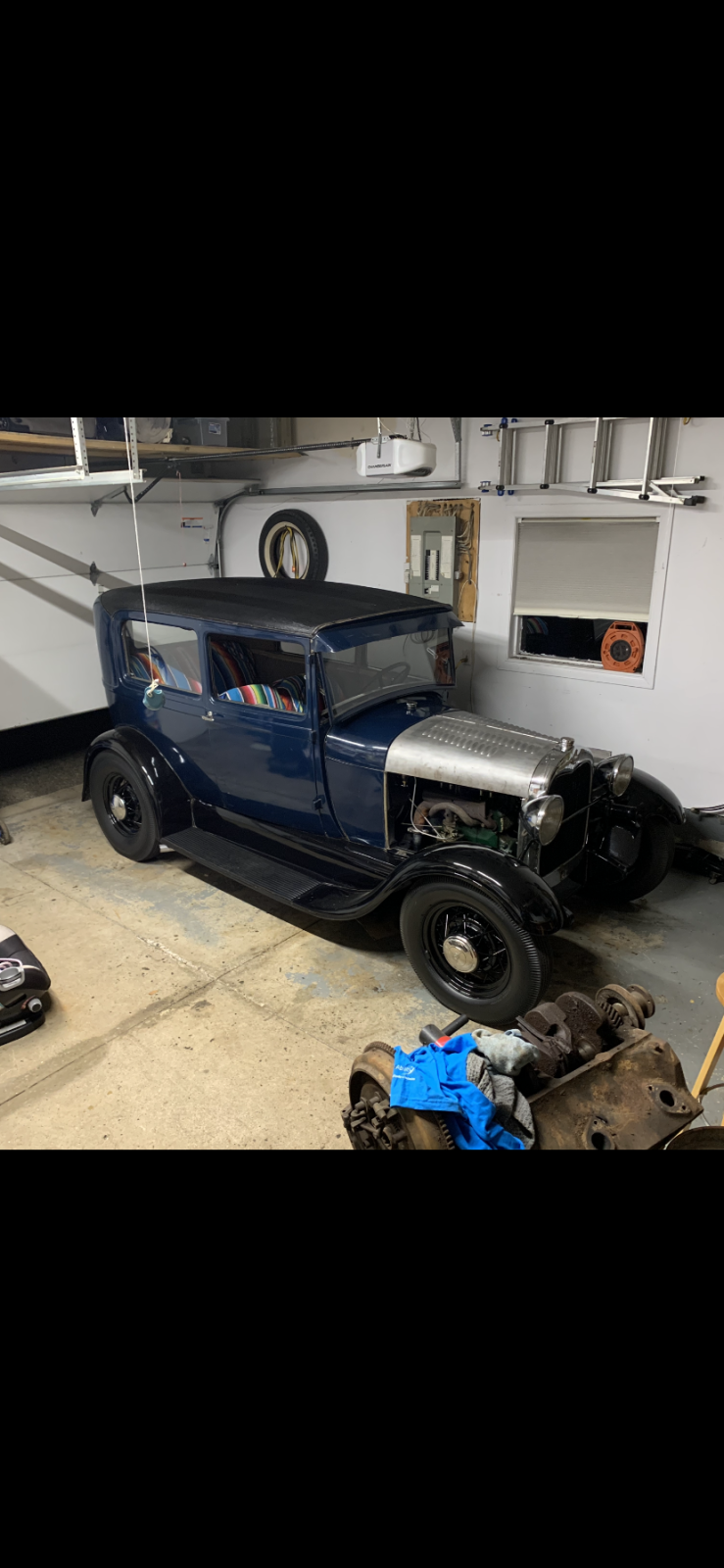

    In May of 2022 I went to look at a 28 Tudor with zero intentions on buying it, I just wanted to go look and sit in one because I don’t know anyone with a hotrod or anything pre 1967. But the car was solid and the price was right so.. why not, I bought it.
    It was a plain jane tudor that’s been “restored” at some time in its life. Had all the old man bits on it, but I’ll try and slowly turn it into a hotrod.
    I have limited funds and limited time to build a hotrod, but I’m going to try it anyways.
    I’ll do my best at do***enting my process and updating this thread.
    I’d like to thank all you good folks on the HAMB for what I’ve already learnt and will continue to learn about early Fords. Here are some photos of when I first bought it, the posts will become more HAMB friendly as I go.

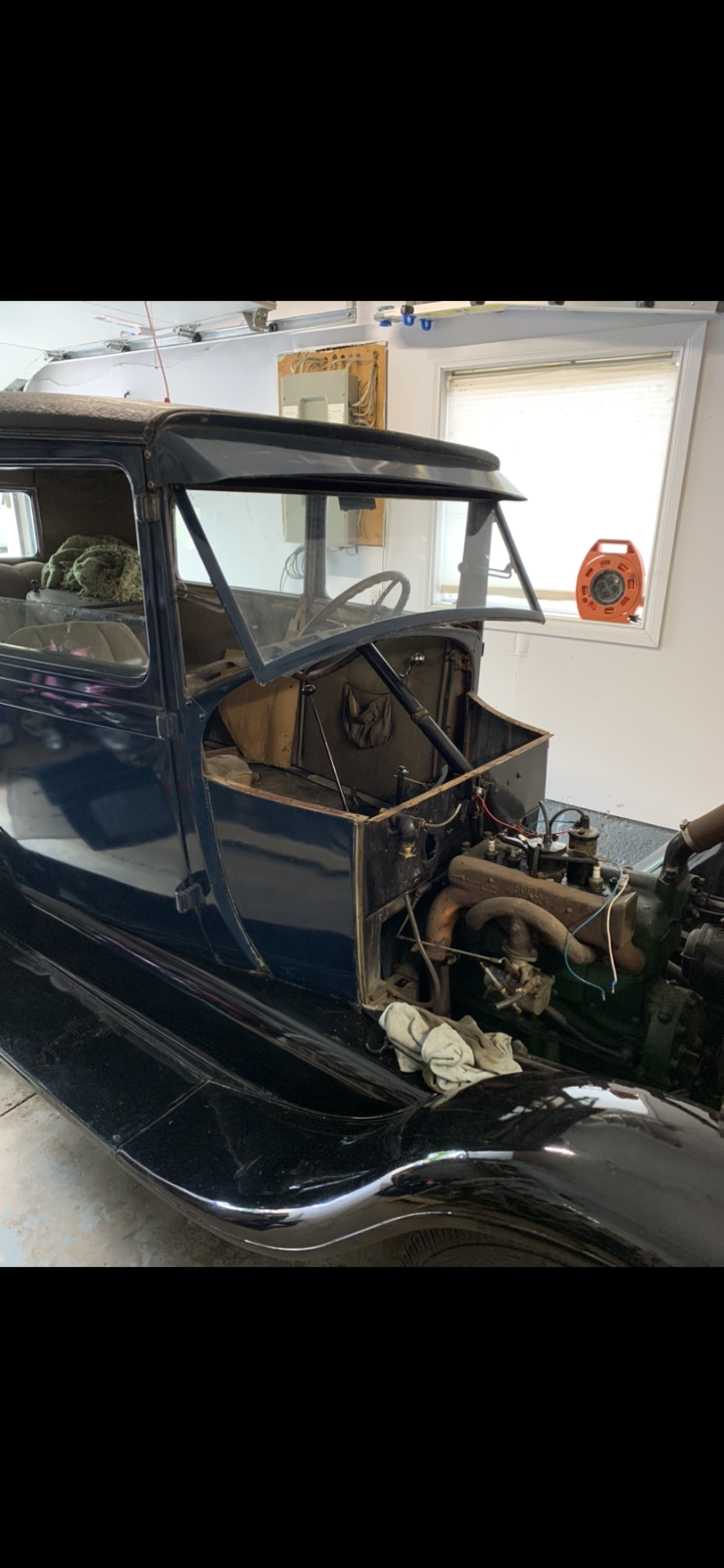

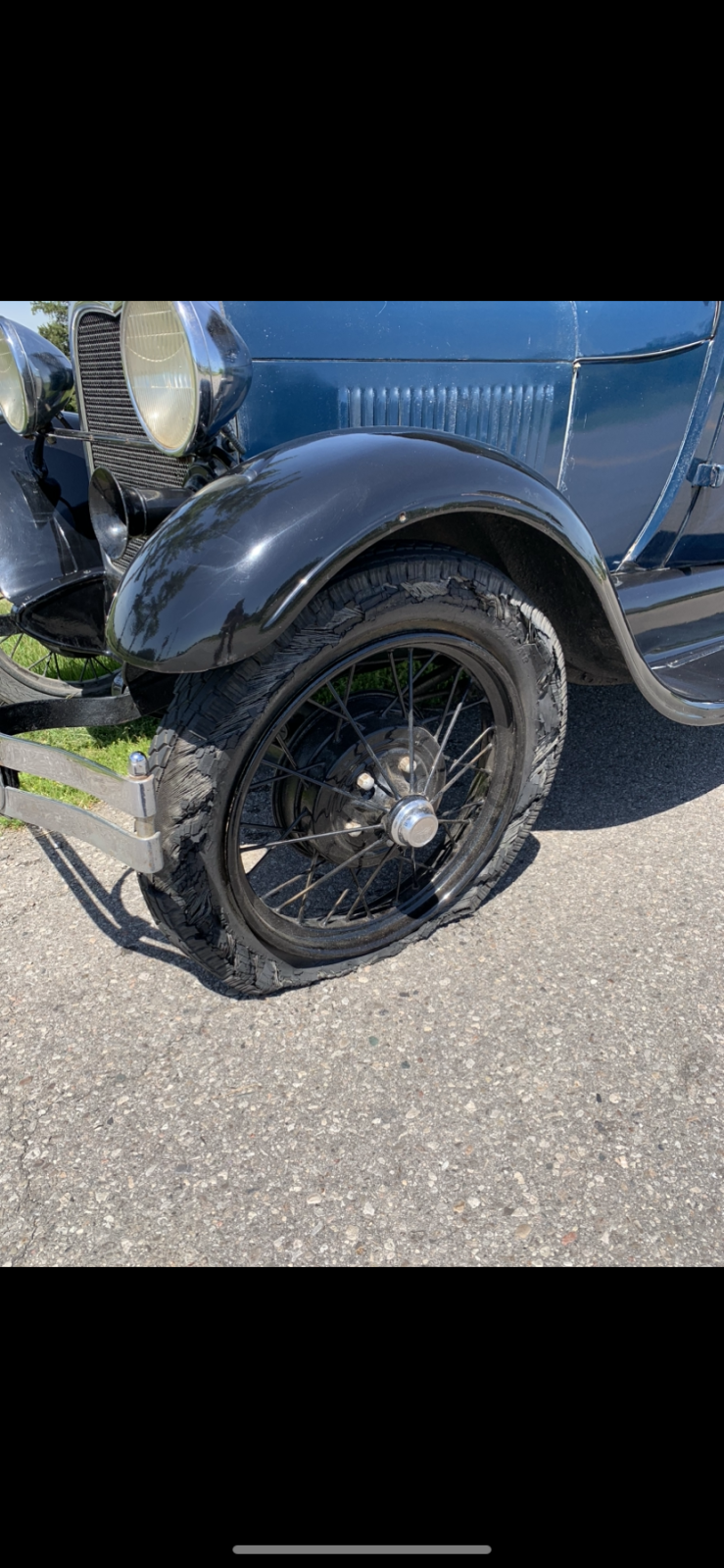

    My first trip in the car ended with me being pushed home by friendly strangers after finding out the gas tank was full of rust.
    2nd trip was a roadside repair after the old cracked tires exploded and then had a stud start spinning in the hub.
    3rd trip the car died while driving, got a friend to tow me home and I found out the fibre gear on the camshaft stripped a bunch of teeth.
    So a bunch of trips to the Model A parts supplier in town and an order from Coker tires I was ready to start driving and learning how to shift gears in this thing.
    I could elaborate on all these events but this is the HAMB, not Fordbarn so I’ll do my best to keep it hotrod related. (Not bashing Fordbarn, they’ve been good to me too). And if anyone has questions feel free to ask!

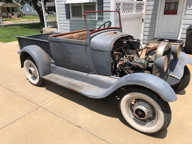

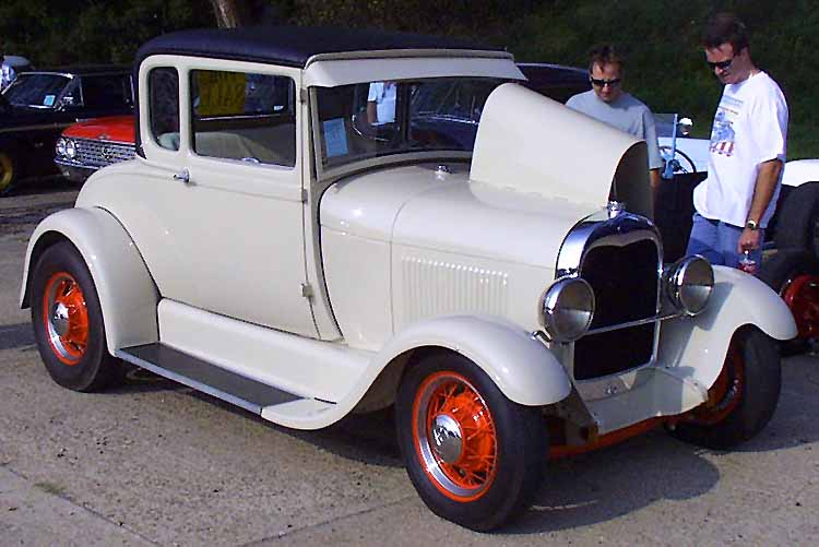

    Look into "Secrets of Speed Society" it's a group that hops up the four bangers. I had a 30 pickup with a B motor, Winfield head, Mallory distributor, Ansen manifold with a Holley 94 carb and V8 trans. Was a fun driver but still a 50-55 mph car after that you were winding it fairly tight, I'm a Model a person and starting on a 29 roadster pick up now. The plan is Model A motor with a Snyder's high compression head, modern distributor, downdraft manifold with a 94 Holley carb, dropped axle and 16" wire wheels. I've done four Model A's, a stock 29 coupe, my avatar 28 coupe with a V8 60 flathead, my 30 pickup and a 30 Sport Coupe with a flathead. I attached pictures of my A's, I sold the 28 coupe years ago and the 30 pickup a couple of years ago so still have three A's.

    Wow nice collection! I think if I had to choose just one it would be the closed cab pickup, I don’t see too many of those out and about.
    I’ve browsed the Secrets of Speed website, tons of cool stuff on there. It’s pricey, but it seems like they’re quality products made in the USA.
    I’m always on the hunt for parts for this thing. I think my next purchase will be a modern distributor. Lots of people on here have said that was the best upgrade for your money on the banger engine.
    Your V8 trans, is it mainly for smoother gear changes? Or can you get a bit more top end with that installed? I don’t necessarily want to go faster, but would like to do 50mph without the engine screaming at me. Thanks!

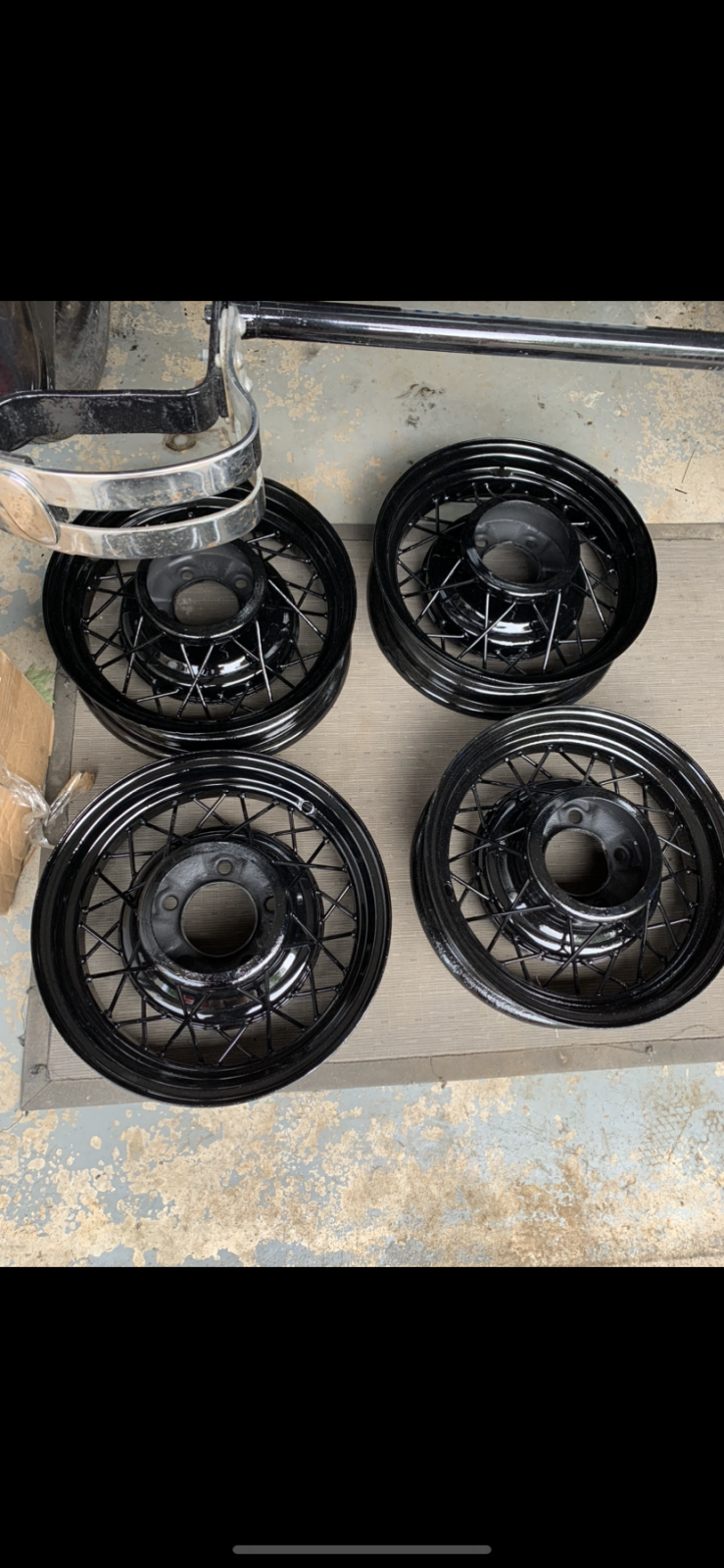

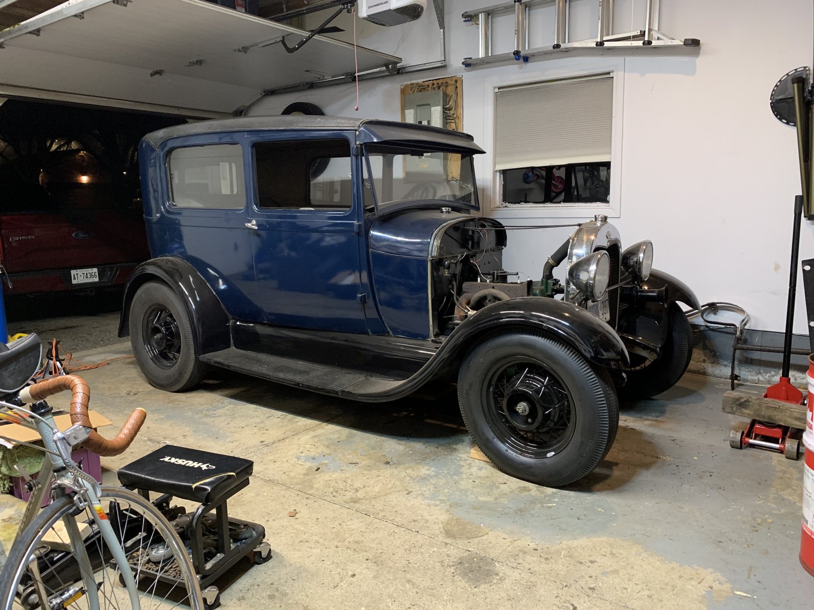

    When I blew the tires on the original wheels, I knew I wasn’t putting new rubber on the original wheels. I went back to the guys house where I bought the car because I recall him telling me he had a set of 35 wire wheels. He had barns and garages all over the property I had to dig through to find all four wheels but I found them. I dropped the wheels off to get sand blasted and painted. I ordered 7.50 rear tires from Coker and managed to find the front 6.00’s locally, however now that they’re installed and I’m driving it I wish I got 5.50’s for the front.. ah well, live and learn.

    Second and third are synchronized on the V8 trans where a Model A trans is straight cut gears, just a learning curve to drive the stock trans. With a 28" tall rear tire a model a is turning 2722 rpms at 60, I've had a stock A up to 70 but wouldn't want to run it there for long. A Model A is real comfortable at the 50-55 mph range, I enjoy cruising the secondary roads in a Model A

    Sharp sedan Mitch...big upgrade already with the rubber and rims...look forecast to the jouney to is it 41 or 47?
  15. ModelAMitch
    Joined: Jul 8, 2022
    Posts: 295
    ModelAMitch
    Thanks Stogy, the wider tires definitely give it a much nicer look and fills the fenders better.

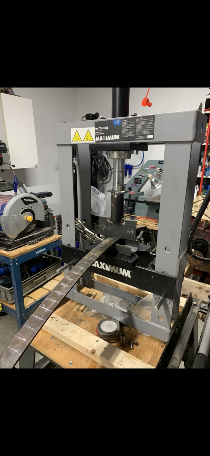

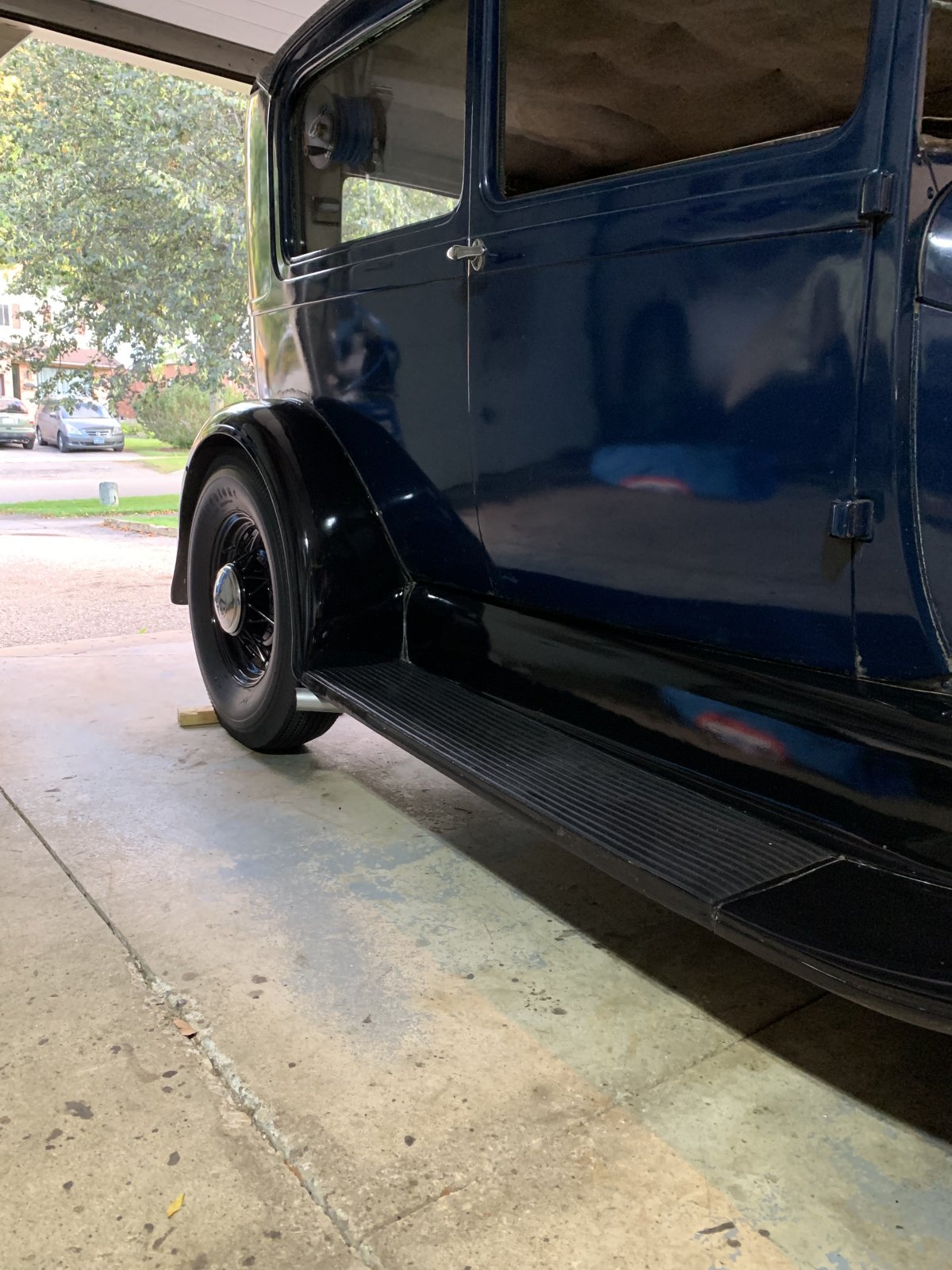

    I always lower all my vehicles, this was no exception.
    I dropped the front end and removed the spring pack. Took the pack apart, cleaned up all leaves on a wire wheel, chamfered both ends of all leaves and painted black. My dads got a press so I took the main leaf over there to reverse it. It was a long process but I took my time and managed to reverse it without breaking it. I forget now how many leaves I removed, but re ***embled with a few less leaves and the reversed eye main. Sat the front end down and it was looking much much better. However, I still have the “A” axle and the steering arms are clearing the oil pan by the thickness of a piece of paper. Ahh well…
    After the front was back together I did the same to the rear. Pulled the rear end, took the spring pack apart, reversed the eyes and removed some leaves. Good enough for now.

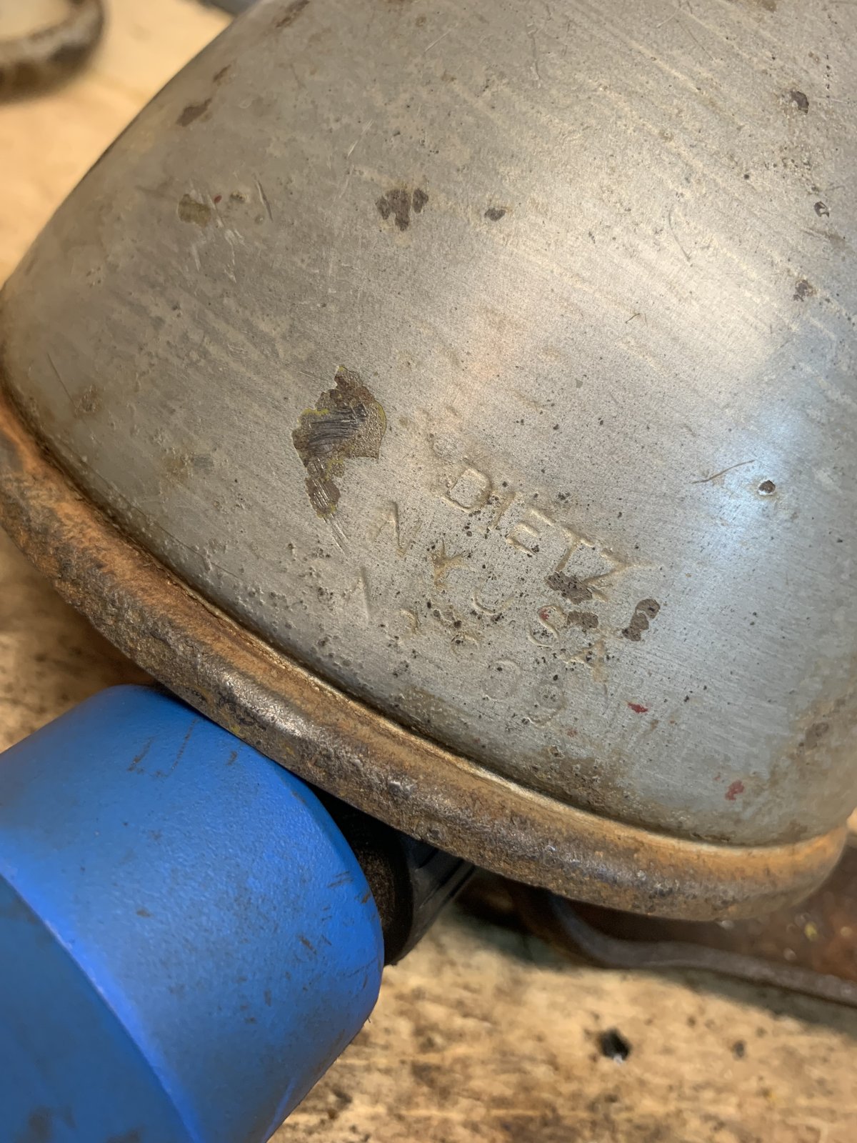

    I was at a swap meet and found this old light in a bag, guy said he didn’t know anything about it. Bought it for $10 and it sat on my bench for a week before I got to messing with it. I cleaned it up and was able to make out “Dietz No909 Made in USA”. I put power to it and it worked! I was surprised, thought that was cool. I tried researching the light, found some on eBay for sale for way more than $10, but I can’t find anything on what year it may have been made in. Maybe someone here will have an idea.
