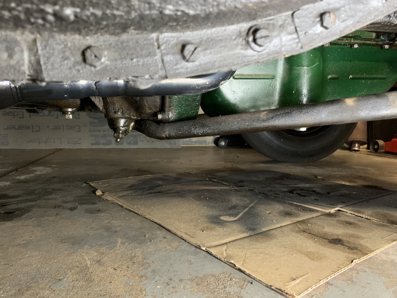

    I have a question for the HAMB regarding my axle I posted above. It’s a 32 replacement axle and I plan to install my original Model A spindles, splitting my original wishbone and run my mechanical brakes. The kingpin size is the same, I know I’ll need a 1/4” spacer for my wishbone. My question is with the spring perches. I’ll be using my original A front spring, will I be able to use my A spring perches? Or do I need 32 perches? I’ll be installing tube shocks as well if that changes anything.
    Thanks guys

    ModelAMitch
    Right now the wishbone is a hairs thickness from hitting the bellhousing. It probably does hit the bell housing as I'm driving down the road. When I put the new axle in it will definitely need to be split and moved to the outside of the frame.
  4. dwollam
    Joined: Oct 22, 2012
    Posts: 2,805
    dwollam
    The perch pin location won't change, just the spindle and wheel etc. Center stays the same unless you drop the spring more by reverse eye etc. Wishbone doesn't move much near the bell housing.

  5. ModelAMitch
    Joined: Jul 8, 2022
    Posts: 288
    ModelAMitch
    Great thanks Dave, I’ll try and use the perch pins I am currently using then. I took a photo of underneath the car to show how close the wishbone is to hitting. This is why I think I’ll need to split the wishbone if I go any lower, but this is my first time messing with early Fords so if I don’t need to let me know!

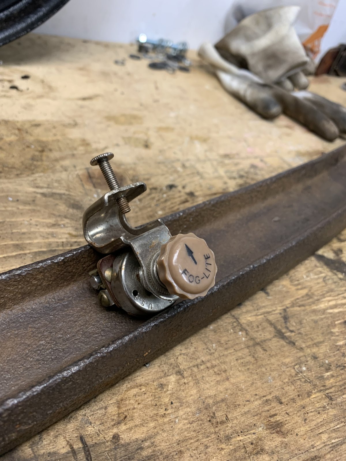

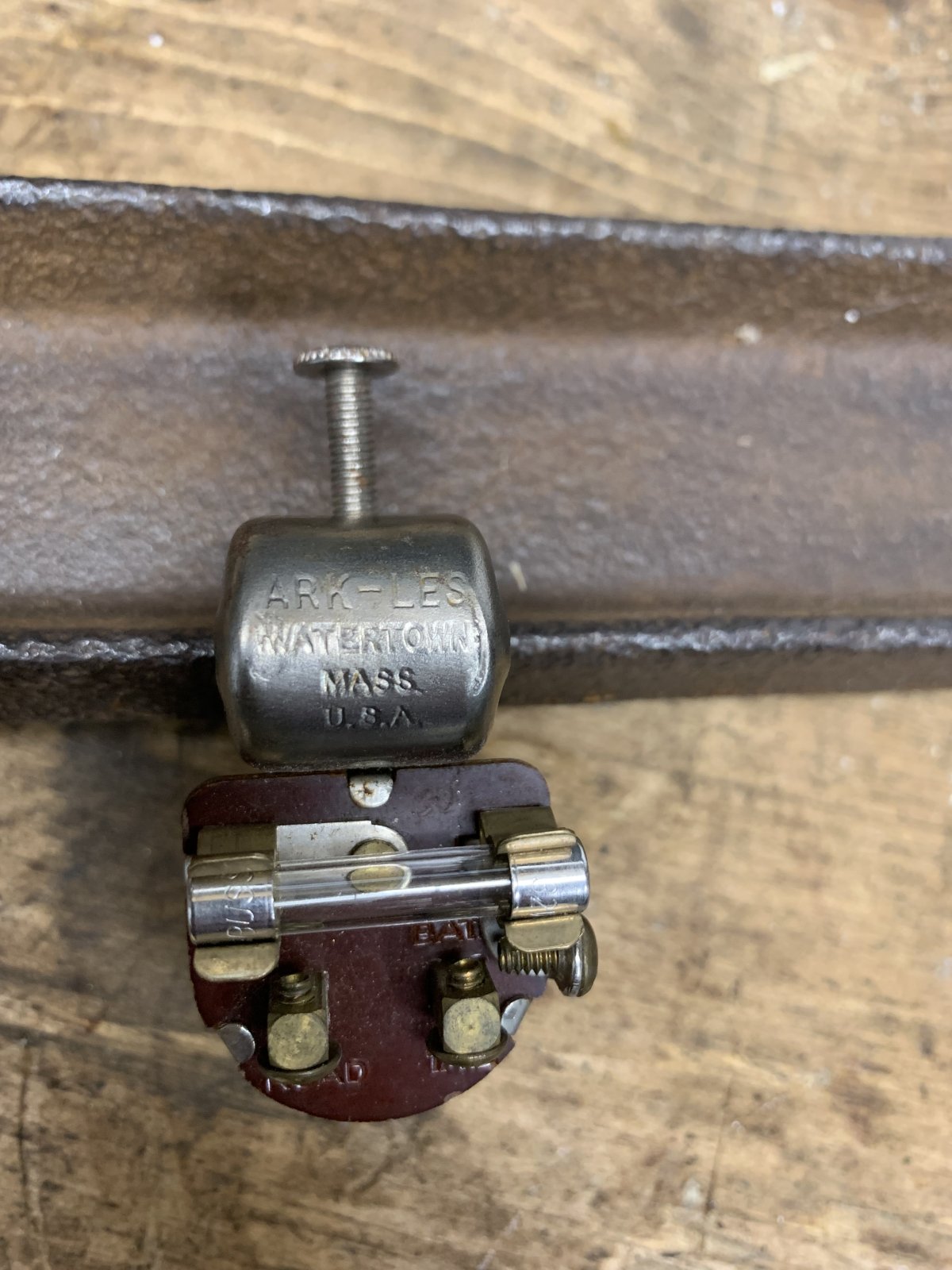

    I mounted the Dietz fog lamp, I’m trying to get some cloth covered wire to hook it up. Can’t seem to find a Canadian supplier and ordering something as little as wire is insanely expensive to get here from USA.
    I did find this cool old switch for when I do get the wire though, does anyone have any idea what year the switch may be from?

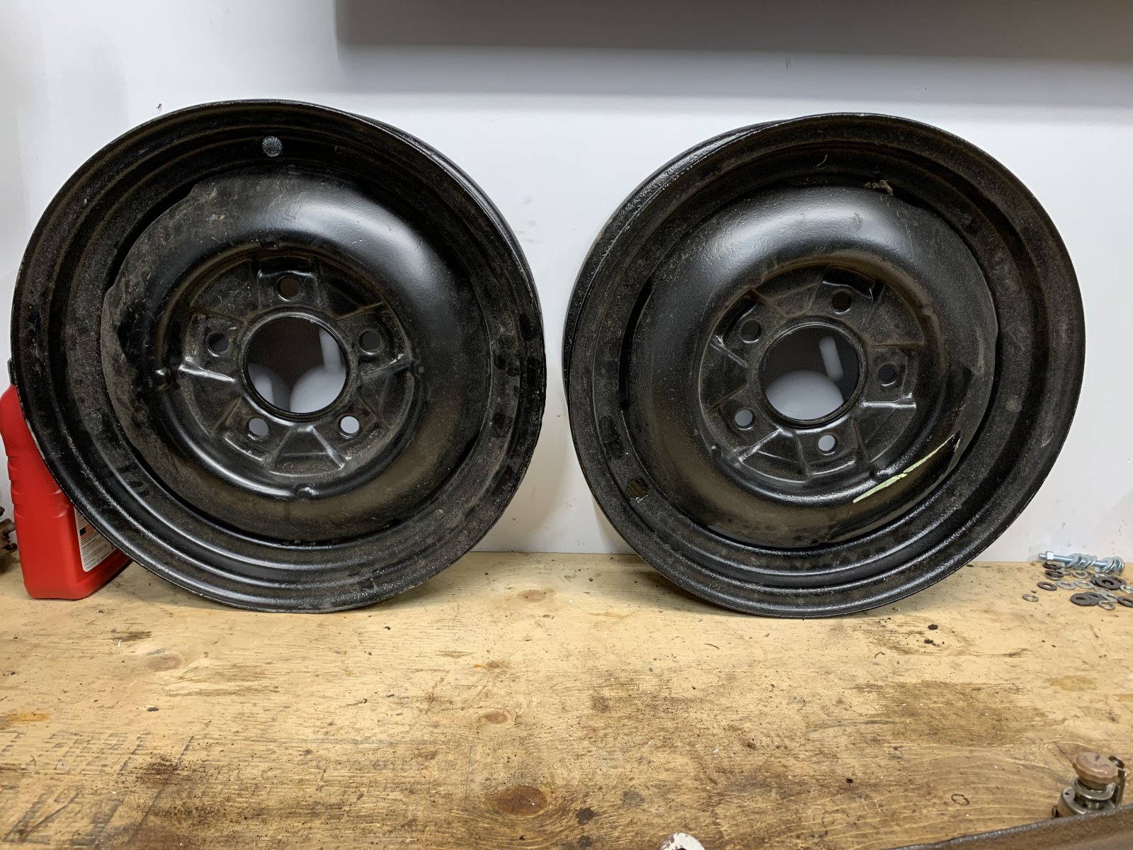

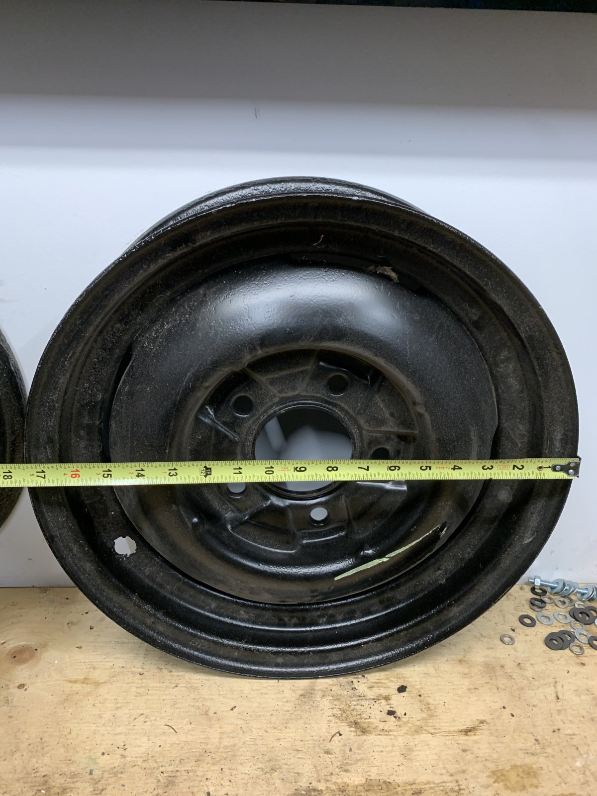

    I also bought two wheels, I believe they’re ‘40 Ford wheels. Could anyone confirm this?

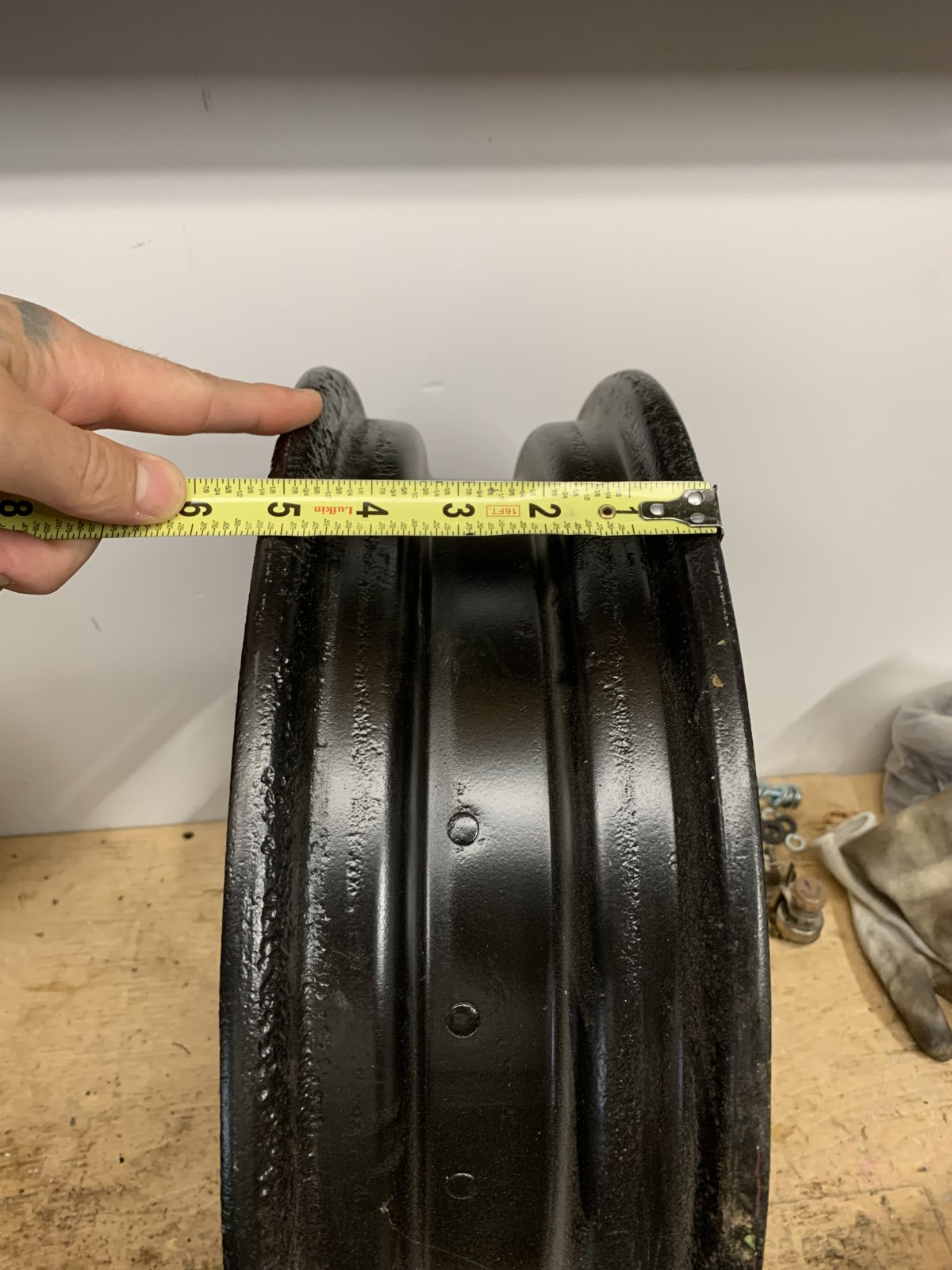

  8. 31Apickup
    Joined: Nov 8, 2005
    Posts: 3,639
    31Apickup
    On the wheels you measure with on the inside where the tire lip seals, looks like 4”, they could be 1940.
    Just Gary and Stogy like this.
  9. ModelAMitch
    Joined: Jul 8, 2022
    Posts: 288
    ModelAMitch
    Oh ok thank you, I didn’t know that!
    I’ll be on the look out for another pair of 40 wheels and then see if I like them better then the 35 wires.
    Stogy likes this.

    The 35's bolted right up. These 40 wheels will need that little ring/spacer I guess according to those links you provided. That's alright, I'm in no rush. I just like hoarding early Ford stuff now that I've been working on this Tudor. Eventually I want to do a much more in-depth build, I think a roadster. So I'm just collecting parts I think are cool or I may be able to use one day.

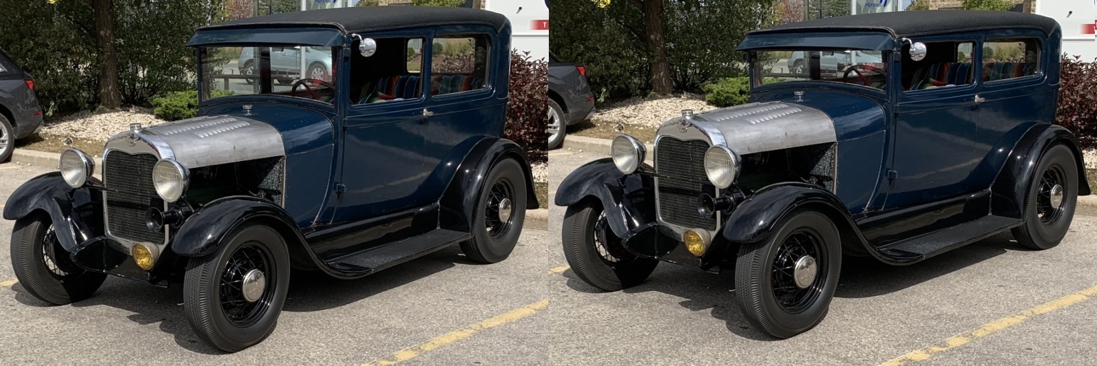

    Did some running around today. I can’t wait to get the 32 axle under this, I think it’ll sit great.
    I think it needs a chop though, start with 3 1/2” and see what it looks like. Likely end up at 4” though.

  15. dwollam
    Posts: 2,805
    dwollam
    '40 wheels will NOT safely bolt on although the bolt pattern is the same. Save the wheels for later when you decide to put '39-'48 hydraulic brakes on it. Then with hyd brakes, to run the wire wheels you need the thin spacers but not with '40 wheels.

    Thanks Dave for clearing that up. The plan is to hang onto them for the time being. Either use them later or on another car all together.

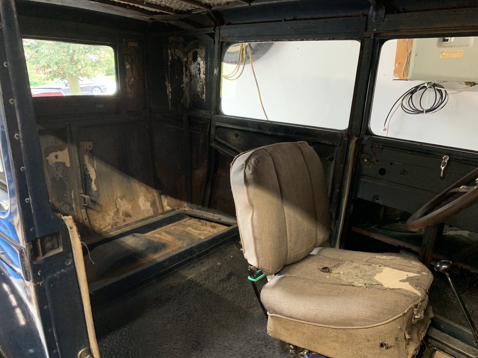

  17. ModelAMitch
    Joined: Jul 8, 2022
    Posts: 288
    ModelAMitch

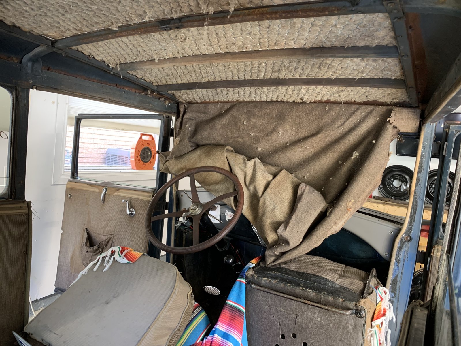

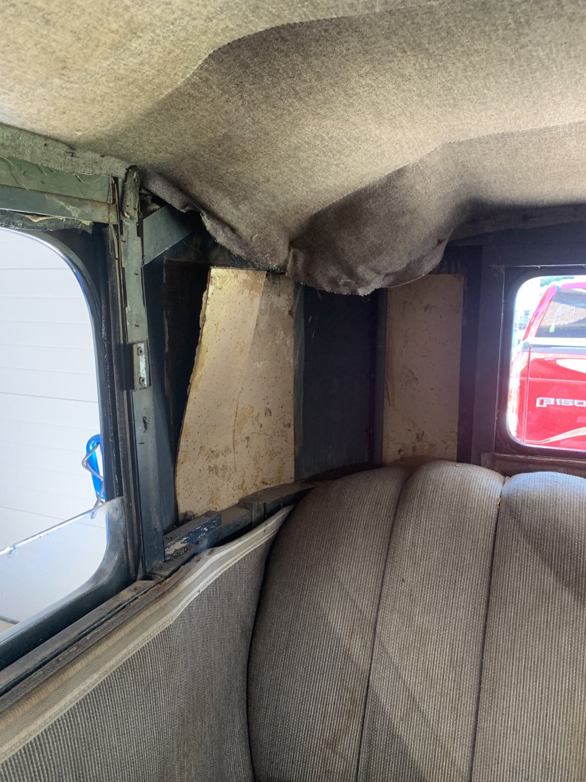

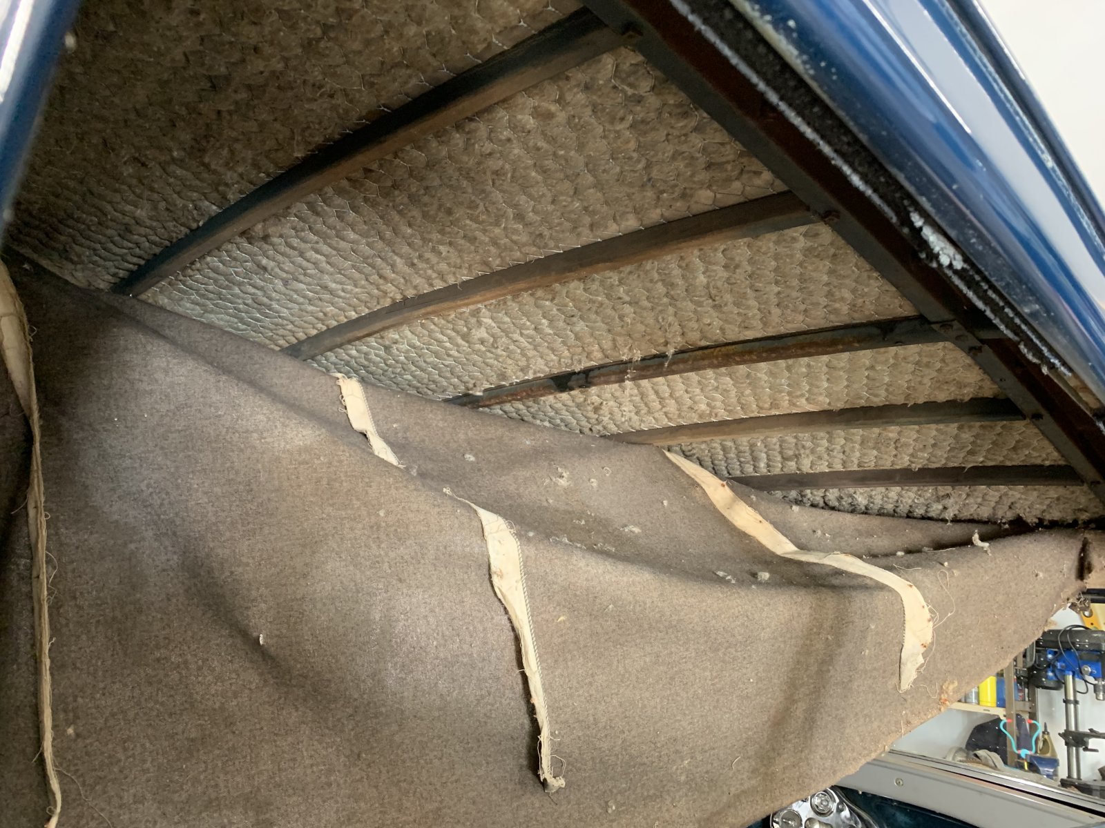

    Between work and house reno’s I managed to start removing the interior of the car, the first step to chopping the top.
    I’m hoping to not disturb the bottom half of the door cards, the car won’t be getting the interior done anytime soon, so trying to keep what’s there in tact.
    I haven’t removed the headliner yet, I peeled back a bit and seen some chicken wire holding up what looks like the blown in insulation my attic has.
    I don’t want to touch the vinyl top on the car, so if I remove the headliner, **** all the insulation out with a vacuum, would I be able to drive the car like that? Or does the insulation keep the vinyl roof from flapping around?
    Stogy likes this.
  18. RodStRace
    Joined: Dec 7, 2007
    Posts: 9,019
    RodStRace
    blacka.jpg Take a look at Paul Shin's Model A videos on youtube.
    He has one where he replaces the roof, and shows what is normally up there.
    How to install a new top on a Ford Model A
    The car is looking great, and I agree with all mods so far. I wonder about the chop, but this is probably one of the easiest cars to do, so the outcome is more likely to be positive.

  19. stubbsrodandcustom
    Joined: Dec 28, 2010
    Posts: 2,599
    stubbsrodandcustom
    from Spring tx
    I can say that you can space down the stock mount for the pivot ball but the thing to remember is arc of rotation, 1" at the front axle is like 1/32" movement there by the bell housing. Don't split the wishbones.... Work around it. The axle will retain all the geometry you have there right now just moves the kingpin bosses up to lower the car.
    Dig the car man.. Gota love banger A tudors!
    The 32 axle conversion to retain mech brakes...
    1932 axle
    1932 spindles.
    1932 spring perch for mechanical brakes.
    1932-34 kingpin kit.
    The v8 trans is overrated if you get driving the crash box down. I don't think I will ever swap over the banger to a v8 trans again. Downdraft intake with a good 2 barrel carb, mallory dual point distributor, and a 6-1 or 5-1 high comp head and let her eat. If you find you want more top end, I would suggest a 3.54 gear, I did the 3.27 behind my last banger car, it would fly at 75 on the highway but thankfully I had 100hp to pull the gear down low.

  20. nrgwizard
    Joined: Aug 18, 2006
    Posts: 3,042
    nrgwizard
    from Minn. uSA
    Stubbs is right. Won't need much of a spacer.

  22. alchemy
    Joined: Sep 27, 2002
    Posts: 22,762
    alchemy
    That is a regular bonafide 32 axle. It has the circle end to the web, which shows it was made by a kinda rare set of dies, but still a 32-produced axle. Some guys get all weird about calling 32 axles "heavy", and others get confused about the same-size but different-shaped 33-36 axles being used as replacements on a 32. But you have a real 32 axle, not a later replacement.
    I'm not a mechanical brake guy, but I do also recommend doing the complete 32 spindle/perch/brake swap like mentioned above. It would be a bolt on to the 32 axle with no pivot spacers required if you had used the A perches.

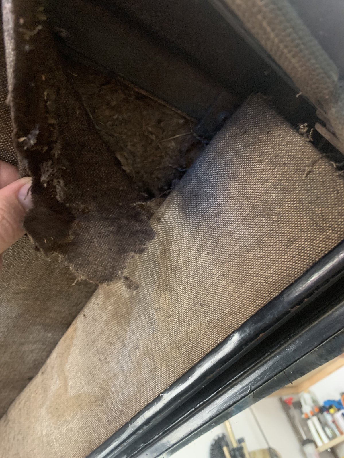

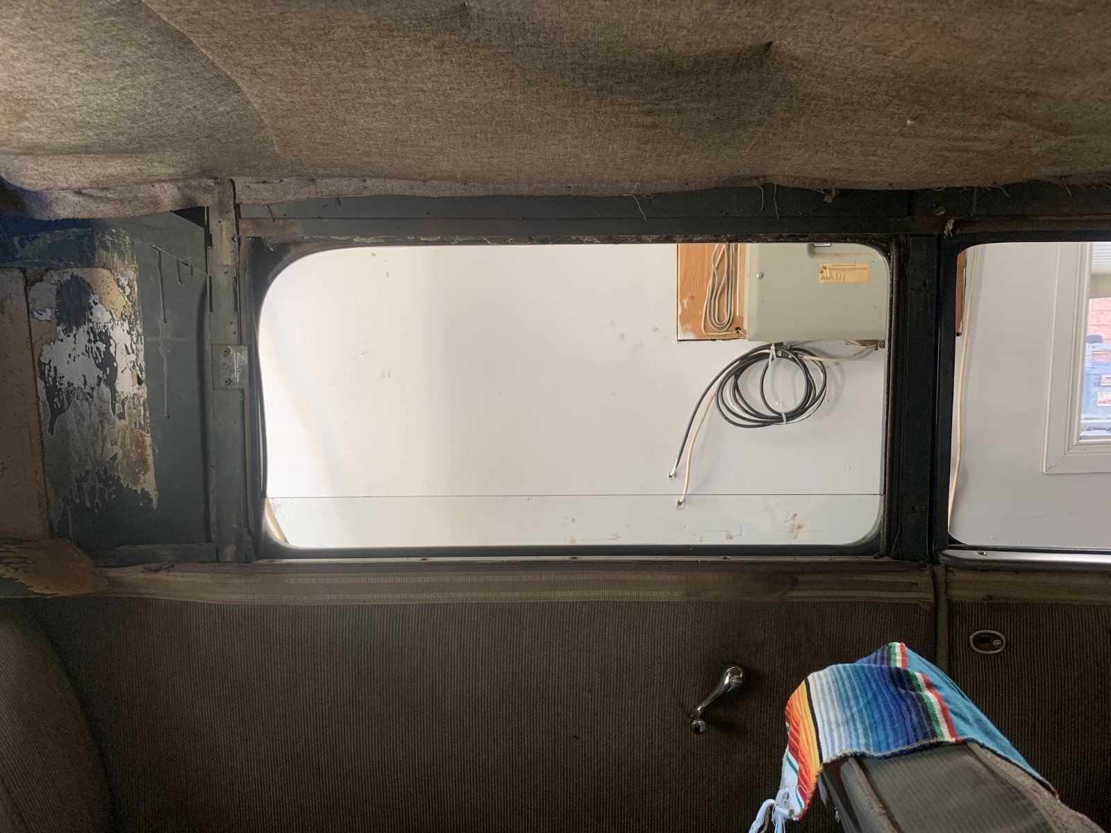

    Today I removed the headliner in the car. Little bit of a messy job, the dirt and dust in the headliner from over the years was plentiful. Surprisingly, it looks like the insulation material in between the chicken wire and vinyl roof will stay there. I picked off all the loose pieces, but the final test will be going down the road with the windows down.
    I was planning on leaving the rear side windows in during the chop, but they don’t roll down all the way and will be too close to where I’ll be cutting and welding. So next I’ll remove the door cards inside and get the windows out.

  28. 34 5W Paul
    Joined: Mar 27, 2020
    Posts: 437
    34 5W Paul
    from Fresno CA
    Something like this?

    I’ve pretty much got all the interior yanked out now. But a good welding blanket is something I don’t have and likely something I’ll need the more I get into this hobby, thanks!
    That is awesome, thank you for the rendering! I think just a hair less of a chop than what you’ve got there. It’s really really close though

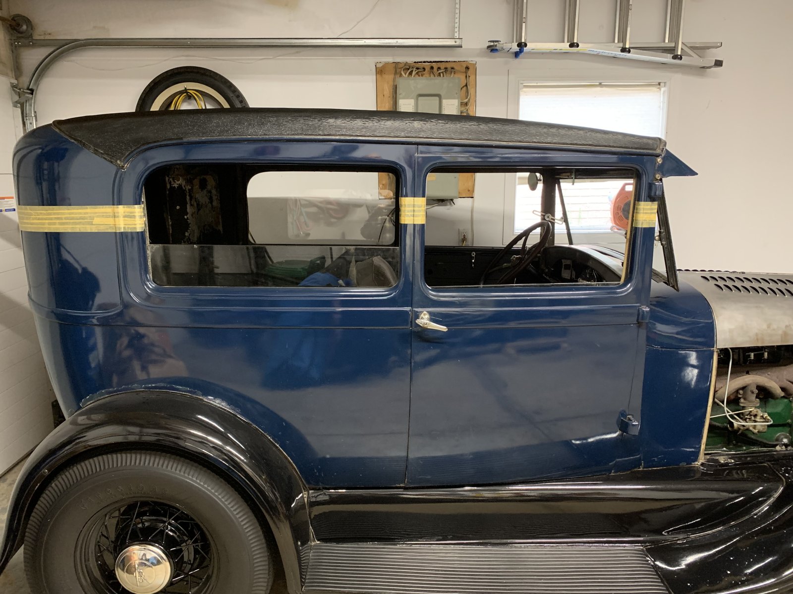

  30. ModelAMitch
    Joined: Jul 8, 2022
    Posts: 288
    ModelAMitch
    I got all the interior bits taken off. Just the drivers seat is left. I’m going to do the chop at my dads place, he’s got a bigger shop and better tools. However, he’s never done a chop before either so it’ll be a learning experience for the both of us.
    I have 3” taped up on the car right now, doesn’t look like it’s enough. But it’s easier to take more off then add. So I’ll cut 3”, put the top on and check it out. Maybe cut another 1/2”, then put the top on again. We’ll see.
