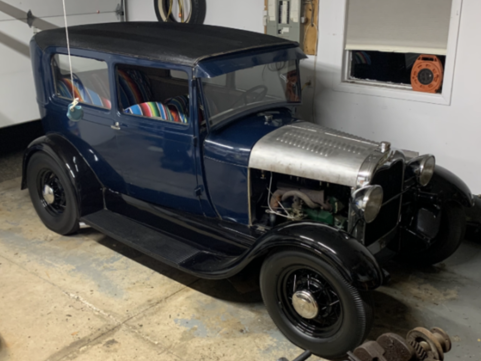

    Are you welding in X bracing? Taking the doors off?
  2. ModelAMitch
    Joined: Jul 8, 2022
    Posts: 288
    ModelAMitch
    I plan on welding in 1" channel from DS rear to PS front and another piece from PS rear to DS front. I think this should be suffice?
    One chop I was reading about, they had tacked the doors to the body, then cut the tacks afterwards. I sort of liked that idea, so I think that's the way I'll be going with it.

    I got the car to my parents place where I’ll be doing most of the work on it. I removed the windshield frame and rear window, rolled the rear windows down. I threw welding blankets overtop of the window Incase sparks make their way down and burn the gl***.
    I used 1 1/4” angle to brace the body. I made a large “X” and then one piece in the front keeping the “A” pillars in place.
    I tack welded the doors to the body because I’m chopping everything at the same time.
    I was extremely nervous, never have I done something like this to something this expensive. But after we cut it and got the top sitting back on the body I took a step back and thought how awesome it looks, it was worth it. However, I have some more grinding to do tomorrow to get everything sitting perfectly. I sort of want to take another 1/2” - 3/4” off the top. I like it right now, but I think a little more would be just right.
    What do you guys think? Little more? IMG_8176.jpeg IMG_8174.jpeg IMG_8183.jpeg IMG_8182.jpeg Or just right?

  8. RodStRace
    Joined: Dec 7, 2007
    Posts: 9,041
    RodStRace
    You are going to get opinions all over the place, so make yourself happy. I would suggest rolling back out of the garage and looking at it from a distance, though.
    Take one of the sections removed and see if a local paint shop can match it. And practice welding on the cut parts before doing the body.
    lumpy 63, Just Gary and Stogy like this.
  9. Stogy
    Joined: Feb 10, 2007
    Posts: 27,218
    Stogy
    Looks a happy medium to me...chopped but not steamrolled...good job Mitch...
    A Boner and SS327 like this.
  10. meteorpete
    Joined: Aug 17, 2007
    Posts: 58
    meteorpete
    I think it looks just right myself. Good job!
    Stogy, bymanr and SS327 like this.
  11. A Boner
    Joined: Dec 25, 2004
    Posts: 8,162
    A Boner
    I like it too…perfect!
    If you can, sit in it at seat height, and look out the windshield…Before you are tempted to slice it more.

  13. 05snopro440
    Joined: Mar 15, 2011
    Posts: 3,037
    05snopro440
    I like it as is.
