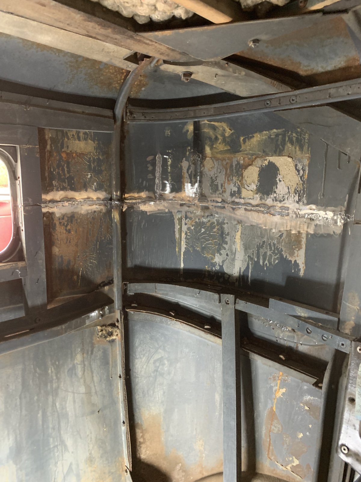

    I haven’t had much time in the garage recently, but today I finally made a little progress. Better than nothing.
    I took @alchemy ’s advice and removed the backer pieces I used when welding the top back on. A grinder, hammer and chisel worked quite well. Didn’t take as long as I thought. I then put some primer on the inside of my welds. It looks a little more cleaned up inside now.

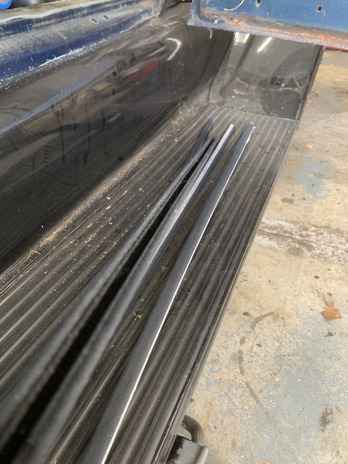

    Today I took one of the rear windows and regulators out. The metal channel on the bottom of the window was rotten and was preventing the regulator from moving all the way, makes sense why the window wouldn’t go down all the way.
    I also cleaned all the old rubber that the window rolls up into, that needs to be replaced.
    Then I removed about 1000 nails out of all the inner wood structure. Slowly making progress.
    Question for you guys - I was planning on purchasing new window felt from the model A supplier and cutting it down to fit the new shortened window openings. Is there a better way to do this? Is there a felt kit for chopped cars? Or a roll of generic felt that I can glue into place then drop the window in?
    Thanks for reading!

    I would look for generic window channel in the proper width, and cut it to length yourself. I think the A used a rubber top seal, but I would use the same window channel as the sides on the top. Just make sure you don’t glue the channels in too much in case you need to remove them later.

    Thanks @alchemy. I browsed online for some "C channel window felt" and I found a place that sells it by the foot, but doesn't ship to Canada.. I'll call around to local automotive window places and see if they have anything.
    Most of my online searches, they're products are for specific cars - which I dont mind, I can cut it up however I see fit. But its extremely expensive.. More digging to be done.

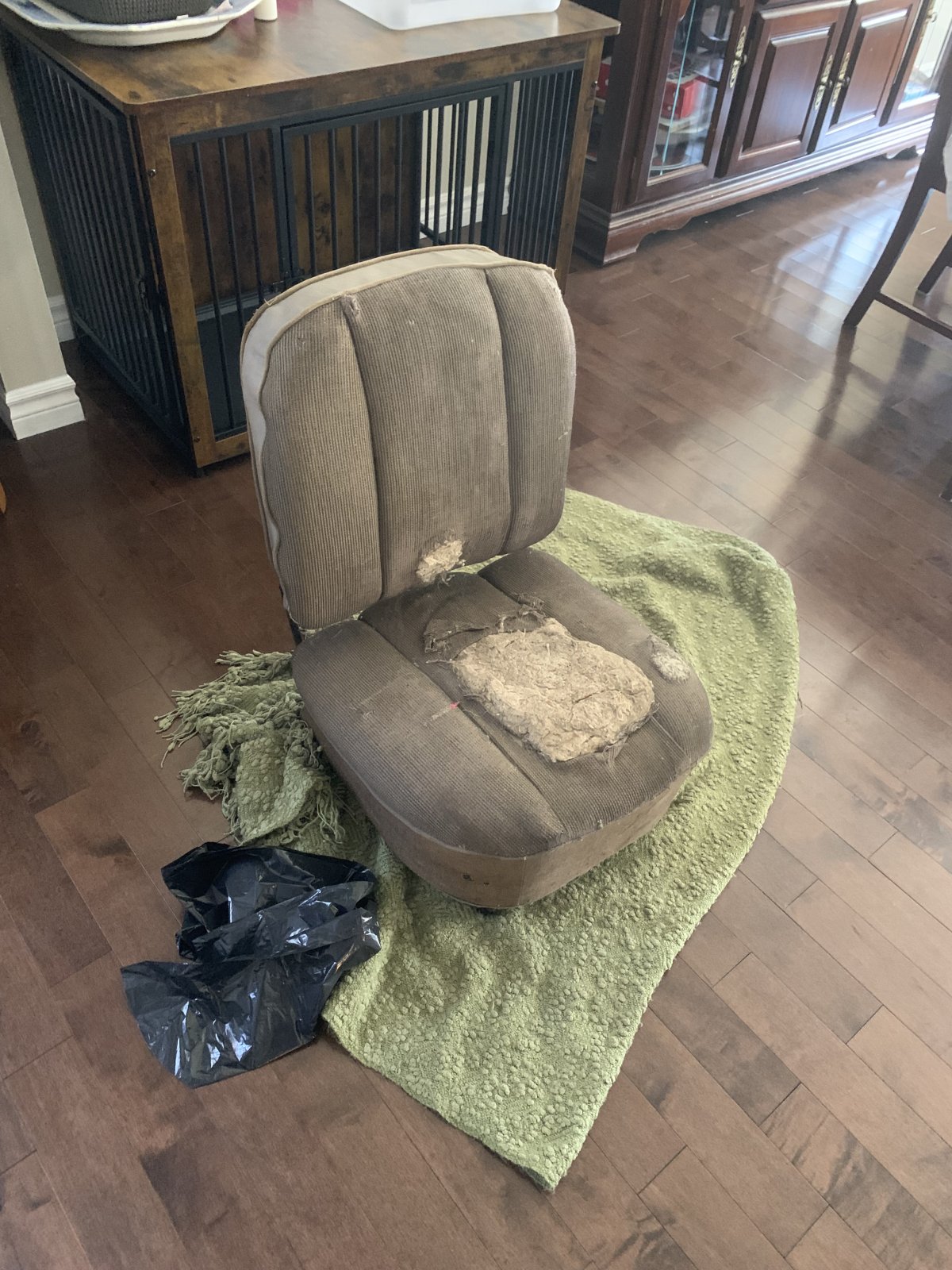

    While driving the car home after I chopped it I realized quickly I needed to lower the seats - could barely get in the thing!
    The other day, while waiting for parts to install the front end and ****on up the windows, I decided to tear the seats apart. I think I have an idea in mind as to what I’ll do with them.
