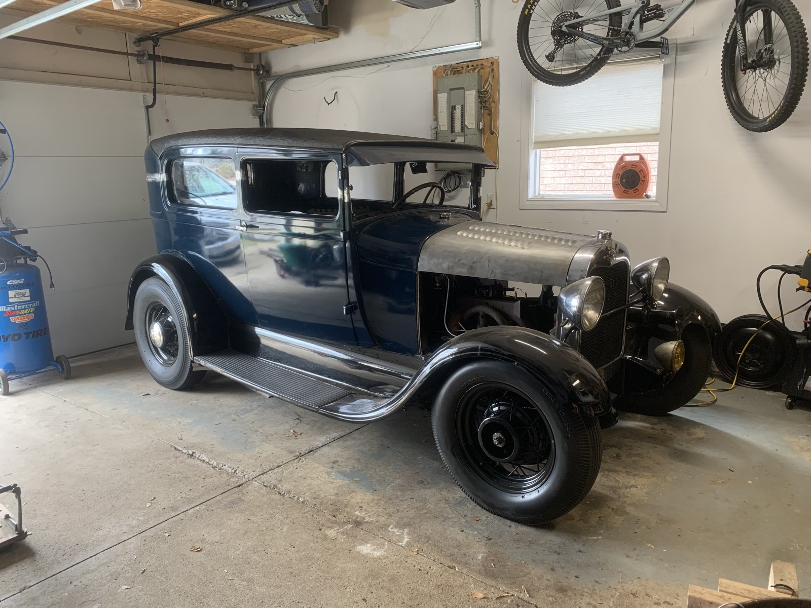

    I got the front end put back together and placed underneath the car. I have all the Model A parts on the ‘32 axle. I’ve already run into a few problems.. the drag link rubs on the spring perch. I’ll need to heat and bend the steering arm on the DS spindle. I will also need to modify the tie rod. Either put a bend in it, heat and bend the balls on the spindles upside down, or do something else I haven’t thought of yet..
    But I couldn’t wait and wanted to see the front end with the new axle under it. This is current ride height, in need of modification.. but it looks cool as is..
    It also doesn’t have a windshield or frame in the photo because I broke it.. last post..
    But I am finally tucking some tire under the front fenders, so that makes me happy.

  2. meteorpete
    Joined: Aug 17, 2007
    Posts: 58
    meteorpete
    Man, your car looks really cool Mitch. Love the blacks and blues. The wheels and tires. Everything.

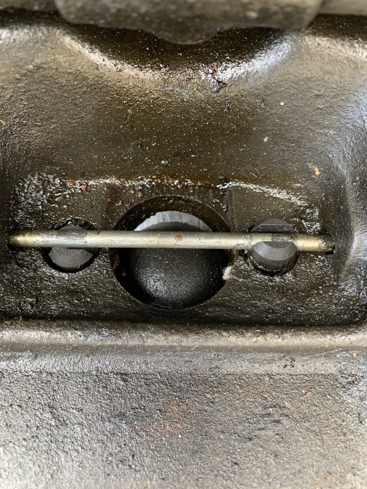

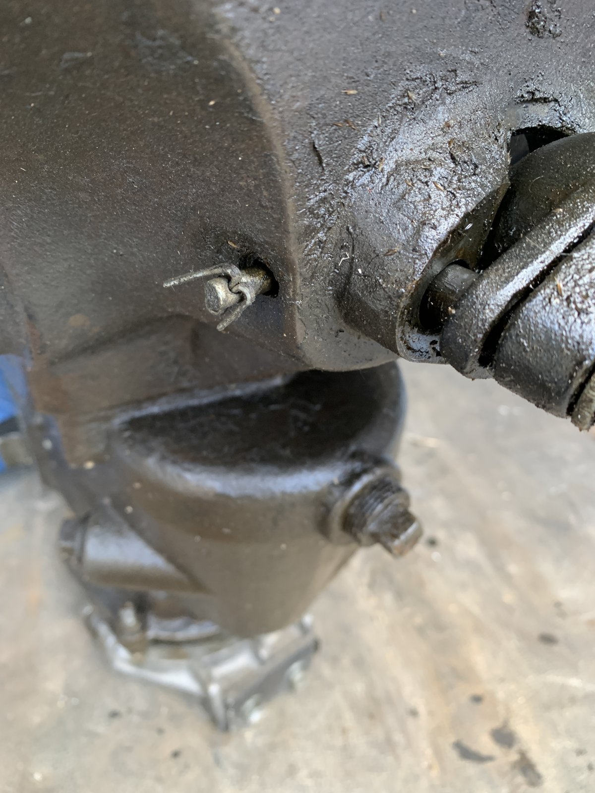

  16. ModelAMitch
    Joined: Jul 8, 2022
    Posts: 288
    ModelAMitch

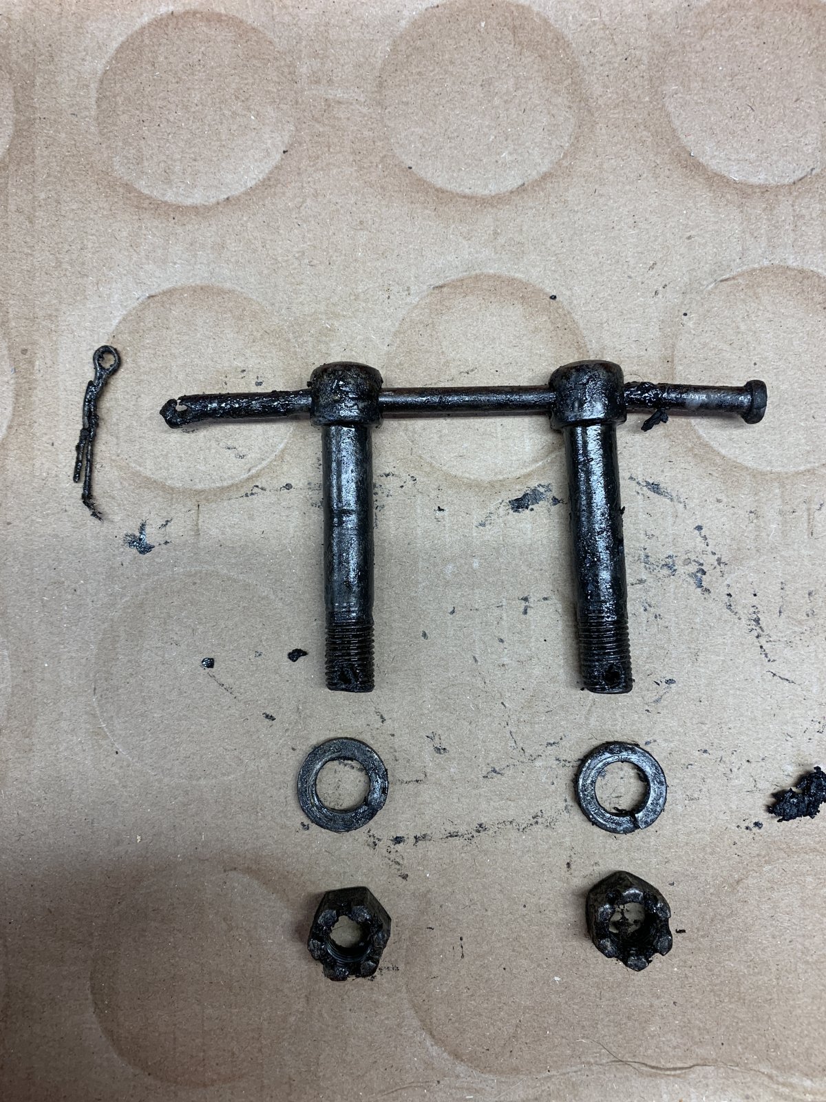

    I read the Les Andrew’s book a bit, he speaks about removing the wishbone and the radius ball ***embly. But doesn’t touch base on removing the studs.
    As you can see, there’s a small cotter pin keeping something attached inside the bell housing. Does that something secure the studs? Maybe that’s Vol 2 of Les Andrew’s books.. but as you can see from these photos, the studs are bent. Likely should be replaced. However, maybe I can get away without new studs and securing the new radius ball mount to the bellhousing? I’m going to buy some 3/8” plate and see what I can make up.
    LCGarage likes this.
  17. 4bangerbob
    Joined: Jun 29, 2013
    Posts: 152
    4bangerbob
    from AB, Canada
    There are slots in the head of the bolts that are extending out of the bottom of the bellhousing. By removing the cotter key, the shaft in which the cotter key is installed can be pushed out the opposite side of the bellhousing, allowing the bolts to move up. The photo below shows the bolts with the slotted head The are the bolts that are user to hold the radius rod ball plates.
    Speedy Canuck and LCGarage like this.

    It's possible to disconnect the wishbone ball from the bottom of the bellhousing and use a 2 x 4 between the wishbone and oil pan to hold the wishbone far enough away from the socket in the bellhousing to remove the retainer pin and the slotted bolts through the opening in the bottom of the bellhousing. The flywheel and ring gear don't leave much room inside the bellhousing to allow space for maneuvering the bolts up and our of their normal position. It would be necessary to fabricate or modify the existing bolts to make them long enough to incorporate a spacer above the wishbone ball.
    If you lose a bolt inside the bellhousing you will likely need to pull the rear axle in order to split the bellhousing and transmission from the flywheel housing to retrieve the bolt or bolts.
    Another alternative if you make a spacer would be getting the extra length needed by making "sleeve" nuts with internal threads that can be threaded onto the slotted bolts from below. Make the sleeve part long enough to get the extra length you need. The two nuts could be safety wired together in lieu of being able to use cotter pins. The bellhousing is designed to allow oil leakage from the rear main to migrate downward to lubricate the wishbone ball and socket, you should make the spacer to retain that feature.

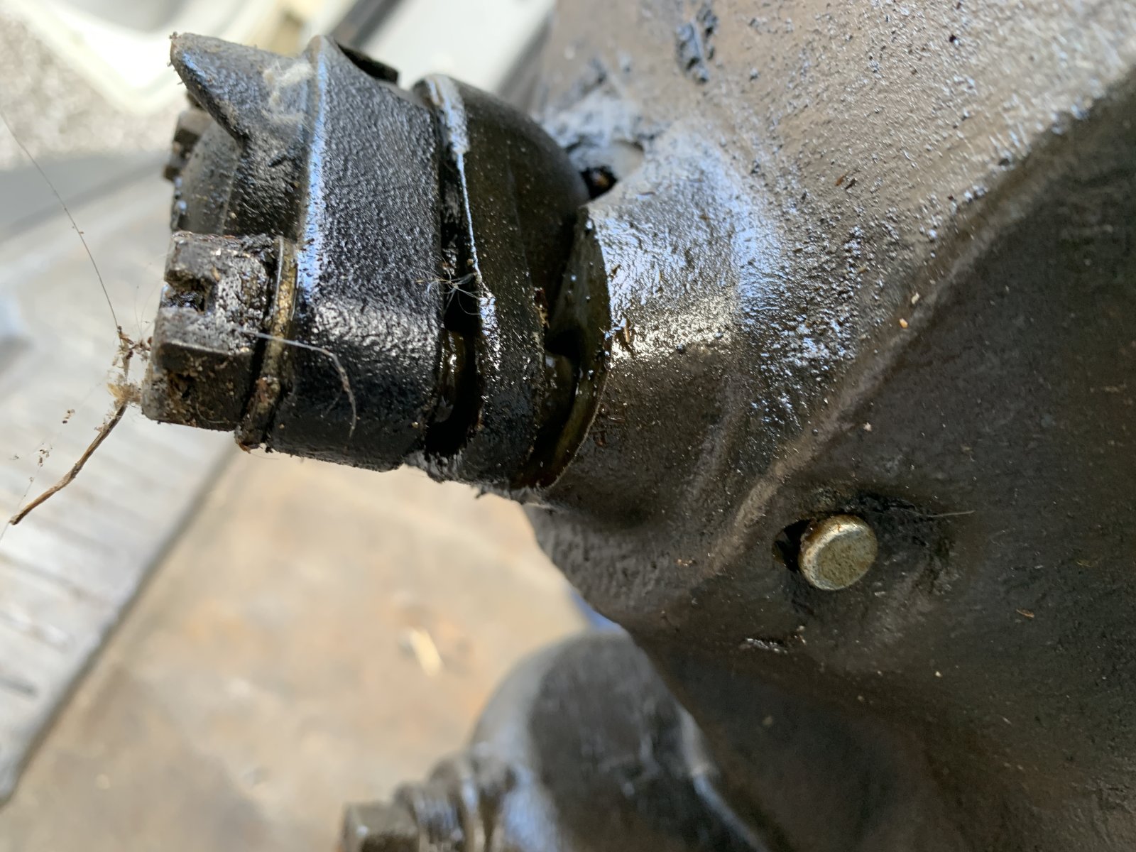

  19. meteorpete
    Posts: 58
    meteorpete
    Mitch - I have an early '28 and a '30 transmission in my garage. The first 3 photos show the '30 style that 4bangerbob mentioned and the last photo shows the early '28 style on my car. Not sure which hardware your '28 has but the photos show that you need to slide the "pin" out and push up the bolts and then bring down through the hole in the mount.
    Tim and Stogy like this.
  20. ModelAMitch
    Joined: Jul 8, 2022
    Posts: 288
    ModelAMitch
    Thank you all very much, great information! @meteorpete, your photos helped me envision what @4bangerbob was explaining. Much easier to see what needs to happen now.
    @5280A2 the sleeve nuts is a great idea. I think I’ll make a little cardboard template for my mount to see how things line up. Then proceed with the longer sleeve nuts to attach it to those fancy Ford studs.

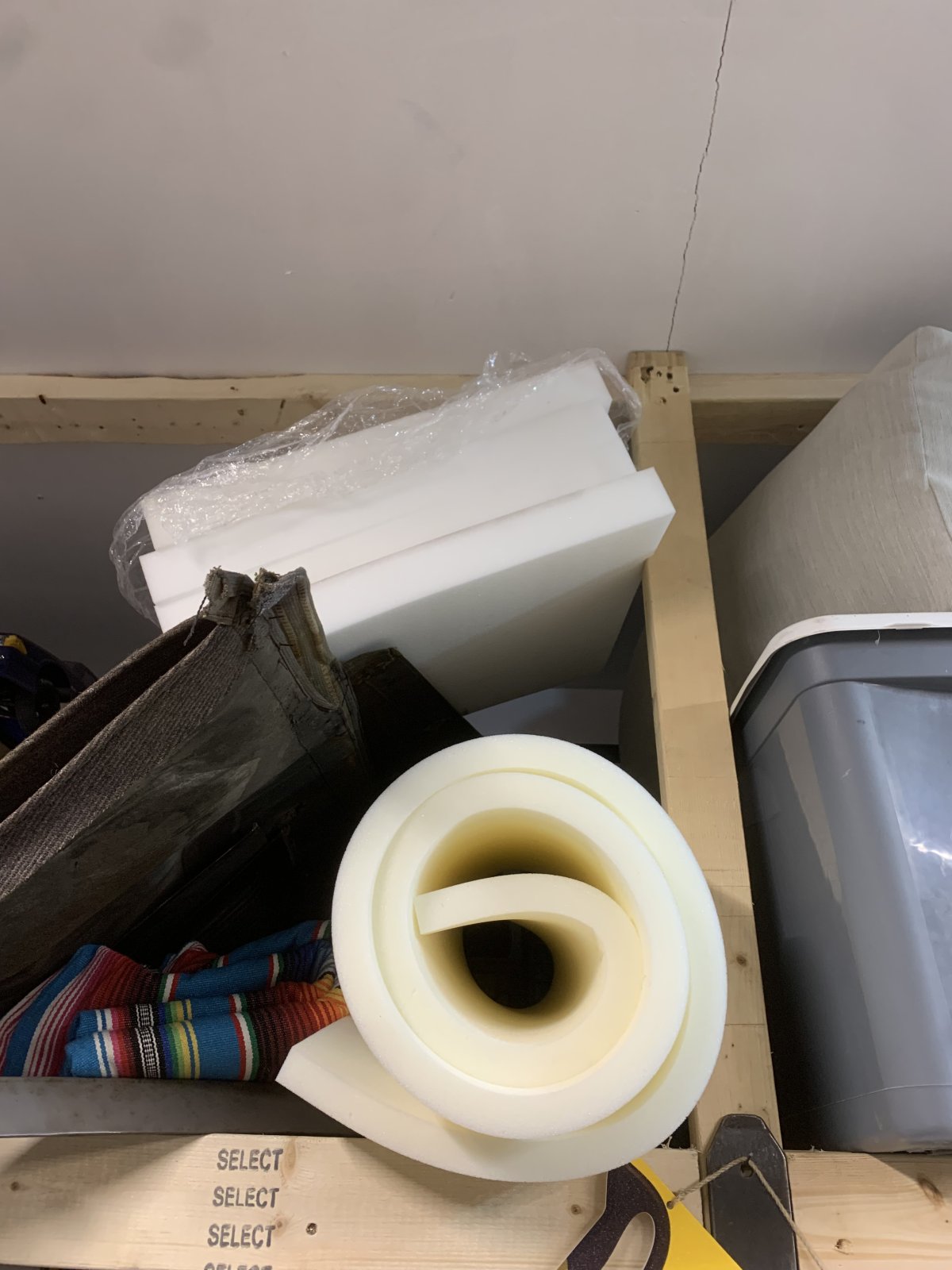

    This I didn’t want to have too many things on the go at the same time with the car. It becomes overwhelming. But everything I need to do right now, with the wishbone mount, I need to cut and make some brackets to attach the brake actuating arm to the perch pins. Everything involves cutting and grinding and since I work shift work, these two weeks I’m on day shift the only time I can work in the garage is after the kids are in bed. So I needed to start a quieter side project.
    I had the two front seats all ripped apart, I decided to order some foam for them. I got 2” high density foam for the **** and 1” foam for the back rest.
    I was planning on sticking with the theme of the build and using the blankets I had overtop of the seats last year to upholster my reconditioned seats.
    After shopping around, I found a Canadian leather supplier with what I thought was very reasonable pricing. I called them and asked what type I needed for auto upholstery since I’ve never bought leather and don’t know anything about upholstery, they were very nice and helpful. Tandy Leather is the name of the place. I started with one hide of black leather. I plan to do the front seats and get as far as I can with the rears. Then maybe buy more and re do the door cards.
    Tim, meteorpete and 05snopro440 like this.

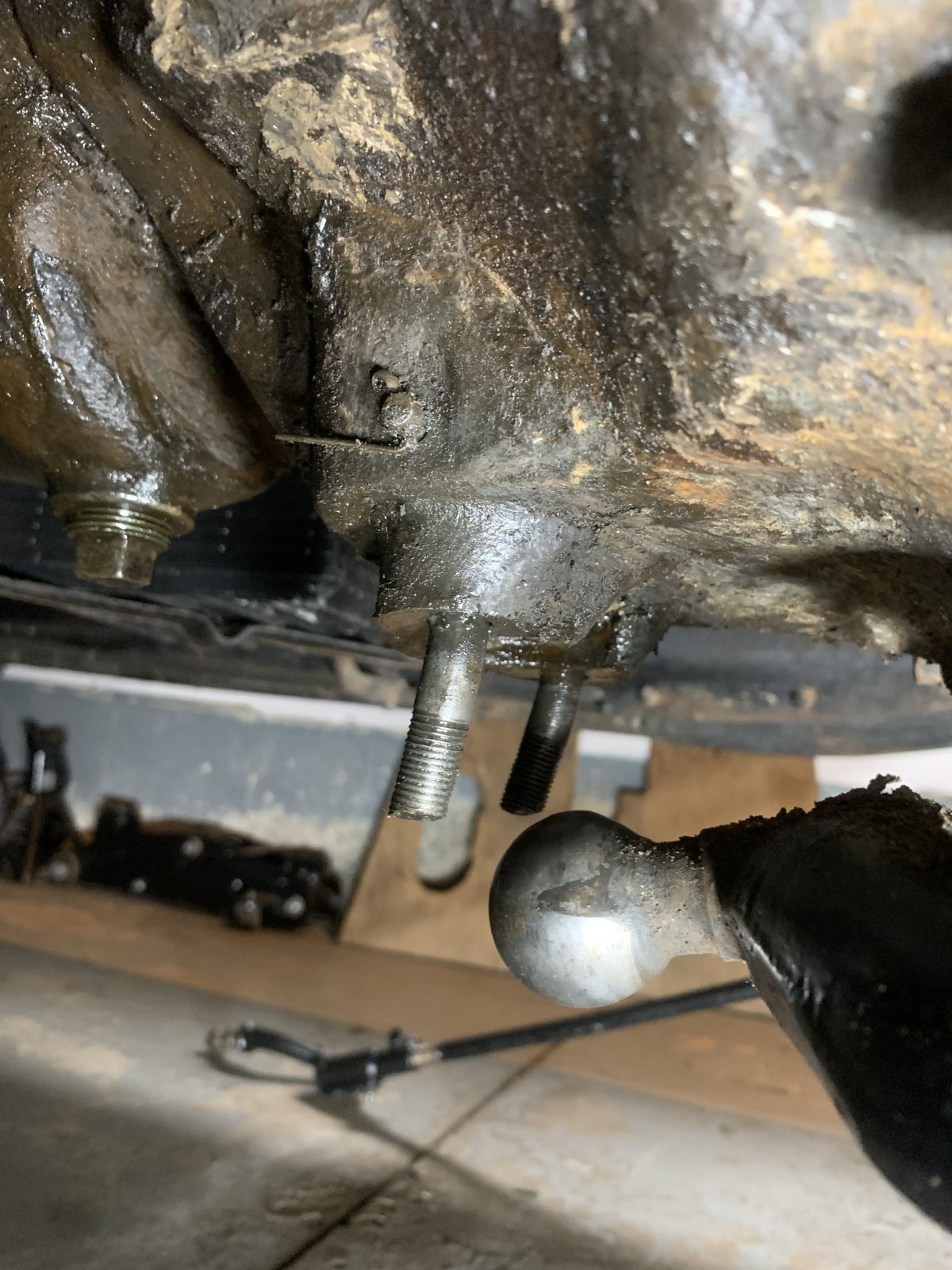

    I got out in the garage for a bit, I was looking at my radius ball mount and what I’ll need to space it down. My first try, I think I’m going to get some square tubing. A piece of 1”x 2” with a big hole in the middle so the top of the ball mount fits nicely inside. I’ll get two of those fancy radius ball mount bolts discussed above, and some sleeve bolts to connect everything.. maybe it’ll work?
    05snopro440 likes this.
  30. ModelAMitch
    Joined: Jul 8, 2022
    Posts: 288
    ModelAMitch
    On a side note, I got the old bent bolts out. In order to get my fingers in there to get the bolts out I had to remove a bunch of steel wool/old drain hair looking type stuff from the bell housing. Is it crucial that I put this stuff back in?
    Also, I was mocking up where the wishbone will sit and measured what size spacer I’ll need and noticed the bottom two bolts in the bell housing are missing..? I wonder why
