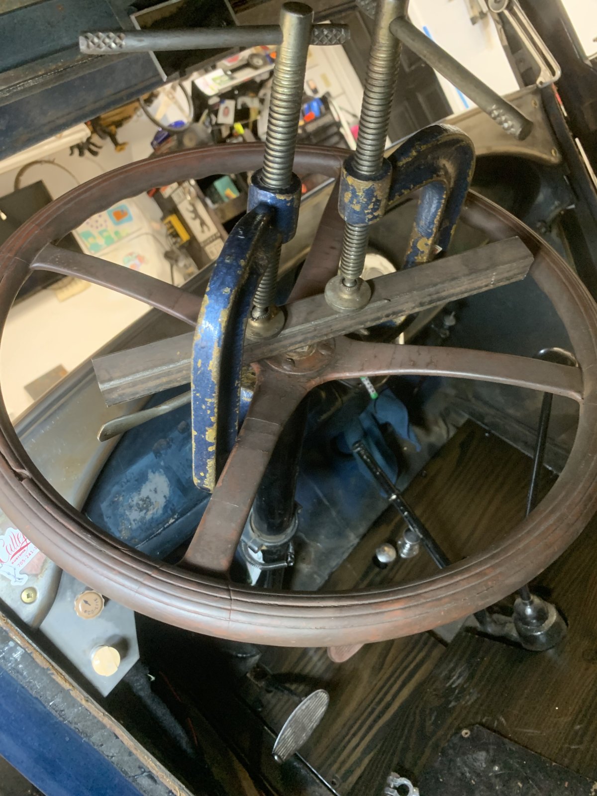

    I was running out of things to do, so I decided to remove the original red steering wheel. With the chop, the wheel is too big and not having a column drop makes it even more in the way.
    home made puller
    Tim likes this.

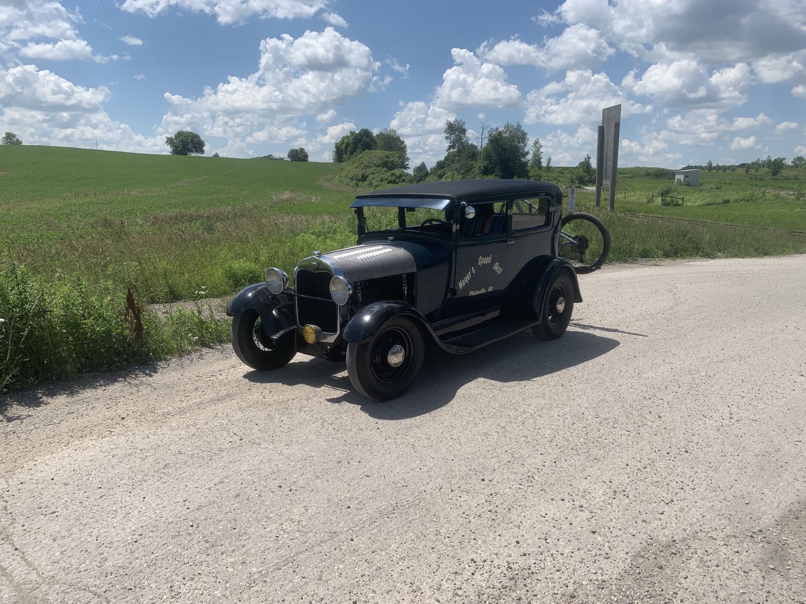

    I’ve always liked old hot rods with adverti*****ts on the side of them. So I’ve always wanted to letter my car, but never knew the right way to go about it. Finding a sign painter is difficult enough, let alone pay them to come paint the doors of my car.
    I found a vinyl cutter at work and managed to cut out some stencils I could use to paint the car. I’m not good enough on the computer to make it fancy, so I just printed out the words, cut them out, then laid them out on my coffee table and taped them together when I thought they were straight and even. Then transferred that onto the car.
    Probably could have been better, but could have cost more money as well.
    I used a can of Rustoleom enamel paint and a brush and brushed on 3 coats then removed the stencils before it dried.
    Meyer is my last name and the address is where my folks live. Lots of work has been done on my car at my dad’s garage and with his help so I wanted to incorporate that into the project.

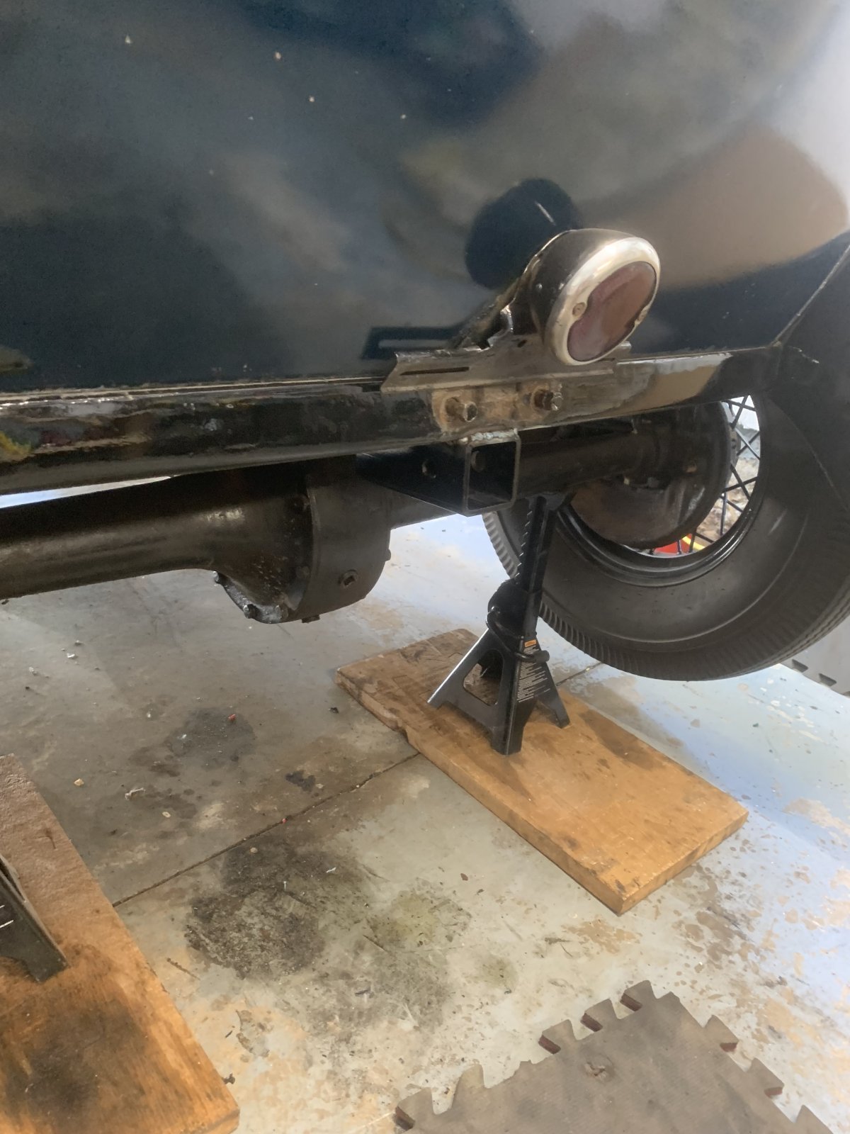

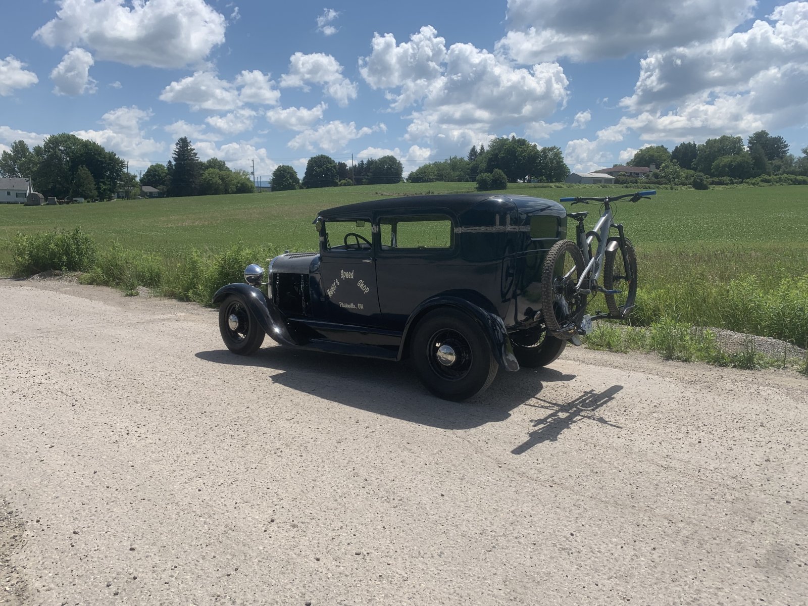

    I found a cheap bicycle carrier which got me thinking, how cool would it be to take the hotrod mountain biking? So that’s what I did.
    I welded a trailer hitch onto the back of the car. It’s covered by the license plate when not in use, and when I am using it I mount the plate on the carrier. It looks cool and works perfectly.
