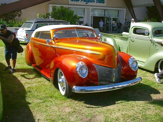

    Posts: 9,419
    DrJ
    This was a '40 Merc FOUR DOOR sedan when Brewsir started out with it.
    Just for some inspiration, see what's possible and "Go for it!"
