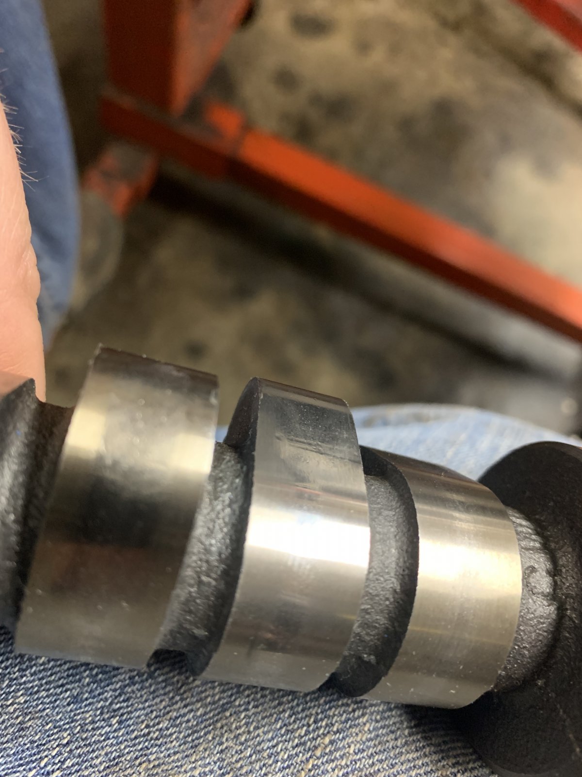

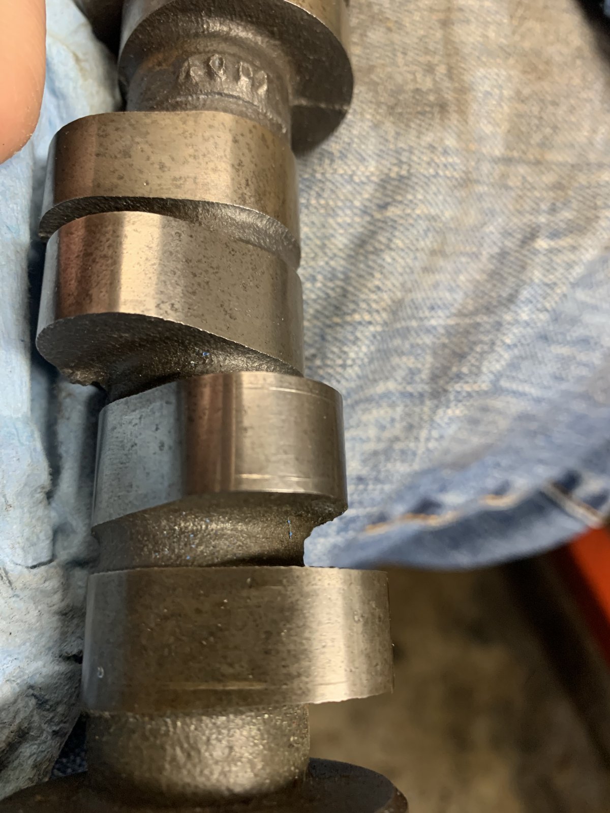

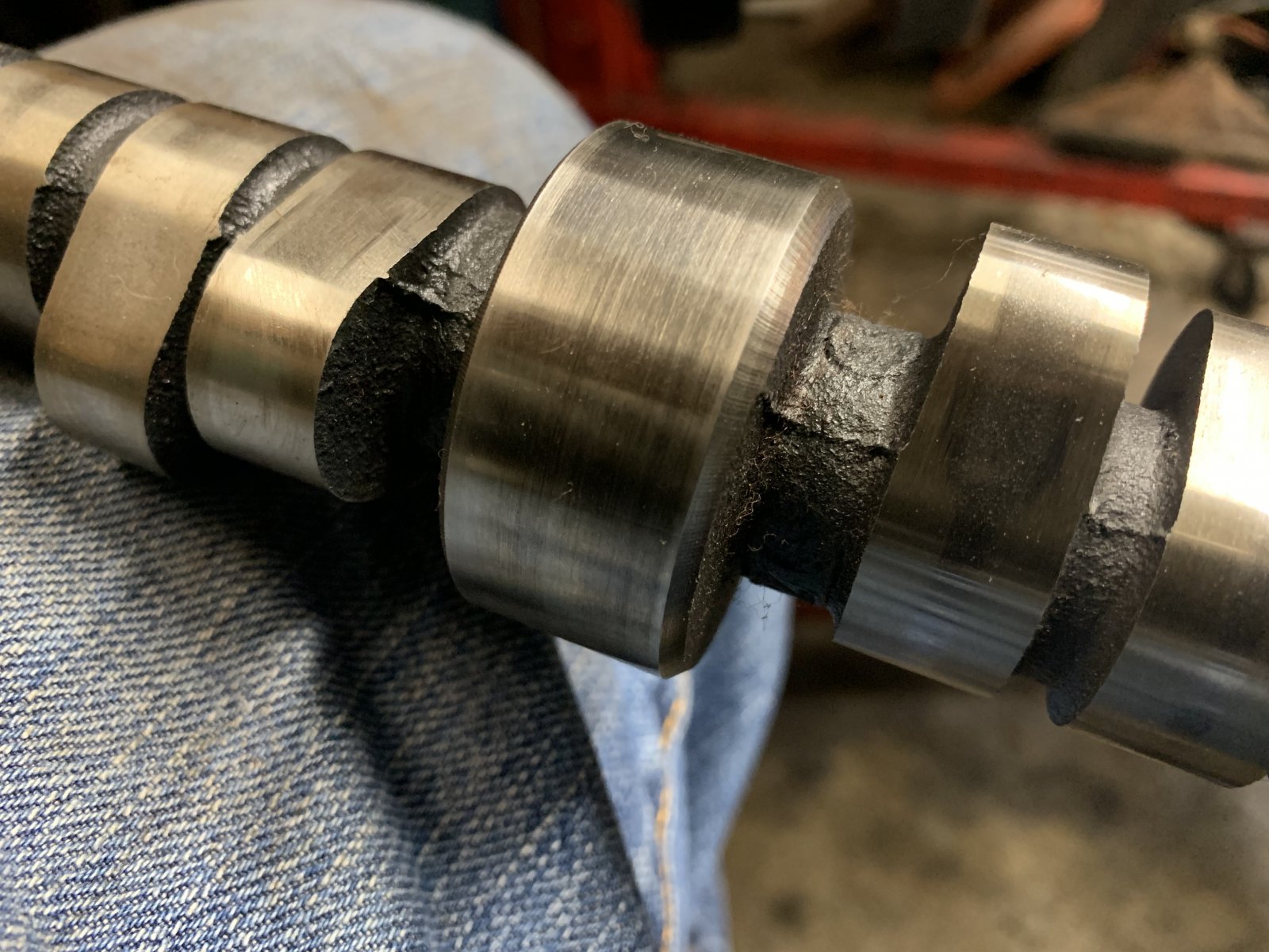

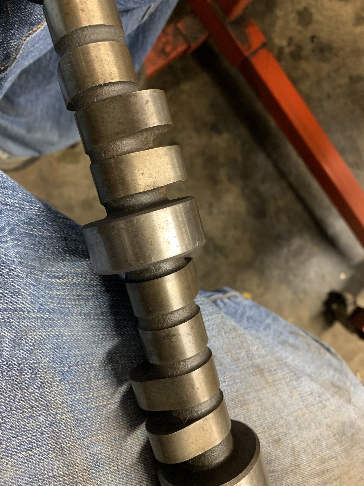

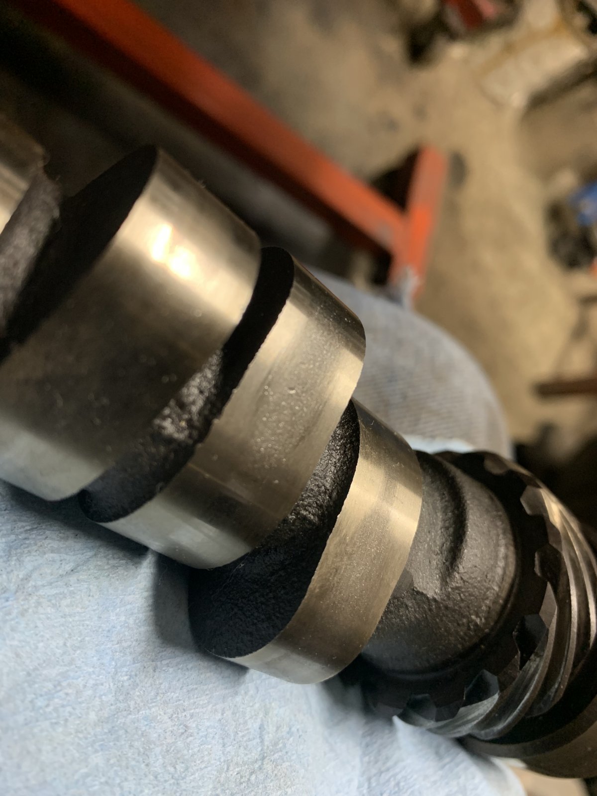

    I’m putting together a 350 using what I’ve got for my ‘60 El Camino to get me on the road until I can afford to properly build my tri power 348. I want it to hold together for like 2 summers…. 4 bolt block, .040 dished pistons, vortec heads w/ 2.02s, Chinese air gap intake, and a used Edelbrock 750. Big 60’s rams horns. Rings and bearings only, no machine work.
    Anyway, I’ve got two used Comp roller cams. I’ve read that roller cams can be reused. I’ve never messed with a roller cam before and I wanna play with one. I’ve also got a set of used Lunati solid roller lifters. They’re the pop up ones. Cam 1 is grubby and has grooves I can feel on the lobes so I figure it’s a no go. Cam 2 is in much better shape, but I can see discoloration/ shinny spots. I can’t feel anything. It’s a good grind too.
    Cam 1
    Cam 2
    683E782E-68F0-405C-B74A-D98BC2B6CEE2.jpeg EE6DFC3F-BD85-4870-9C8B-8CCEBAC683E9.jpeg 99168C14-6E4F-4FC1-A96F-B76C95391E2A.jpeg
    Can I get away with using cam 2? Can I clean it up somehow? Is this just dumb? I know I can alway buy a cheap flat tappet cam and move on, but this would be cool.

    They're both wiped. I used a cast core roller, just like the 2 that you want to use, from Comp once... ONCE!!! My results were more catastrophic. The roller grooves and galling on the lobes is a sure sign of a soft core, put 'em in the s**** heap. If you want to run a roller, run one that's been ground on a billet core, and don't run one that's been ground by Comp. Cast core cams are flat tappet cams. Sorry for the rant, but after my experience, I try to turn everybody away from those type of cams that I can, to hopefully save them the aggrevation that I went through. It cost me a whole damn engine! :mad:

    Can you? Yes. Should you? No! Both cams have worn the surface hardness and one lobe on #2 looks like it seized a lifter roller. They will run, but not for a long time. And while running all the metal that will wear off will contaminate the engine. So if the rest of the engine is a throw away, go for it.

  7. Cam 1 looks better then cam 2
    but that’s not saying much.
    if you only want this engine to last a couple seasons a cam is cheap .

    But if your set on saving your sheckles then cam 1
