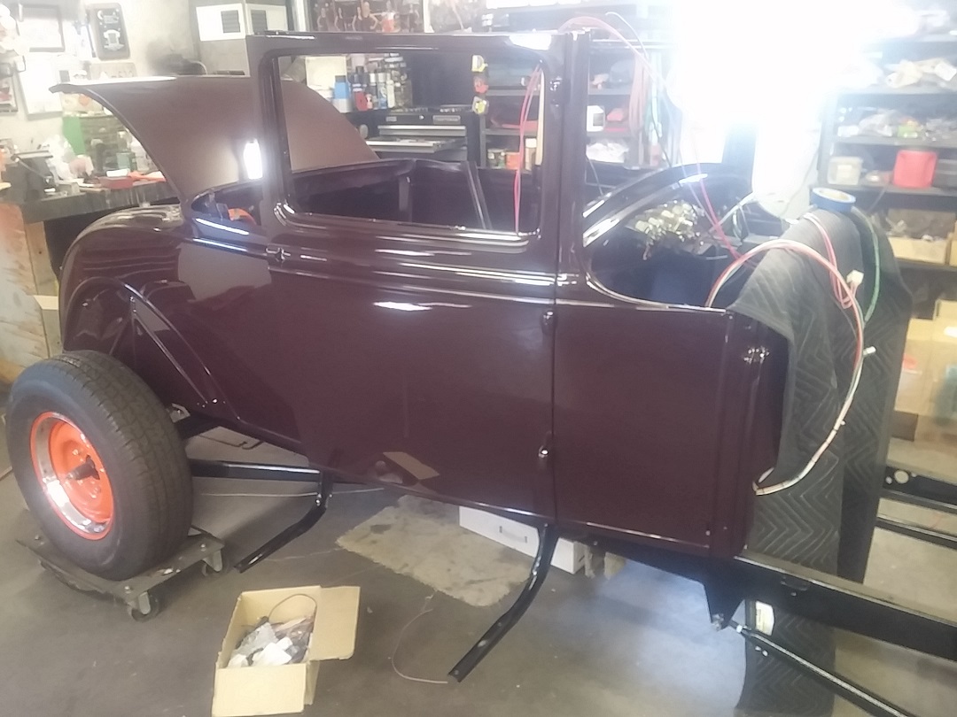

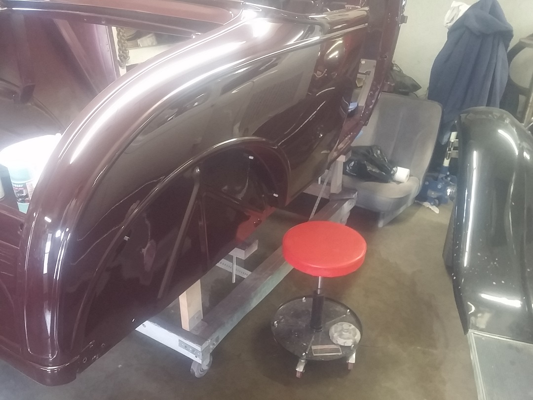

    I used 1500 and then 3000 wet and then 5000 wet on my DA to take out the scratches before I buffed. I was taught years ago to use lots of water, we used to keep a hose running on the area being sanded, messy but cuts down on problems. PPG Concept single stage buffed a couple of days after it was shot.

    I've wet sanded paint applied by others, scary stuff since I have no idea how many coats of paint were applied. No matter how nice you wet sand, the scratches and orange peal in the primer always show after buffing. So IMO your paint is only as good as the surface of the last coat of primer

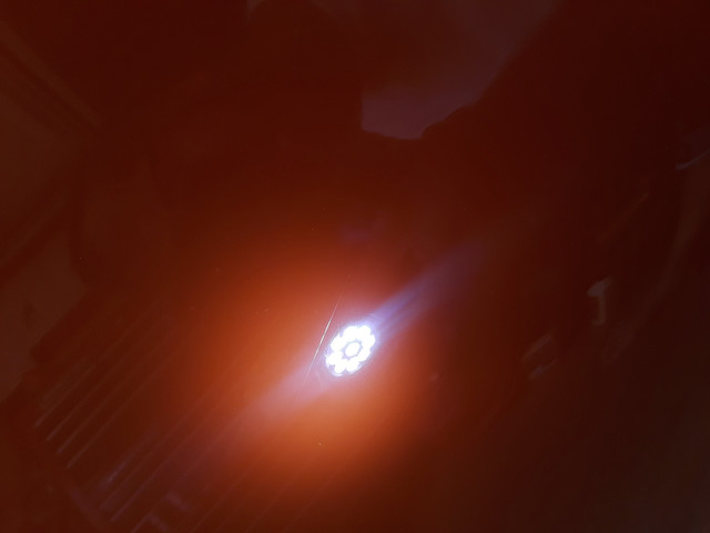

    ^I was under the impression 3M was respected in the autobody industry and considered "quality" paper. Im using the "polish" specific line of 3M
    I mean the paint looks great to the naked eye...if you aren't LOOKING for defects but once I hit it with the flashlight the scratches can be seen. They are hard to get on camera but heres a little bit of what im dealin with.
    and heres what it looks like overall.

    I cant remember what final grit I used for the primer it was so long ago. I used Eastwood Polyester Primer. I wanna say 320 or 400
    then resanded the color with 600 after my first coat had about 743 runs from painting in low temps LOL (but hey, I learned and didn't do that again)
    BUT
    I think my problems have been solved. I just don't think my buffer RPMs are accurate. I finished the testing I started lastnight. Used V32 on Wool and cranked the RPMs to "2400-2800" and it took all but 2 scratches out. (the other scratches came out aswell after some light sanding)
    im thinking "2500" on my rotary is more like 2000 and that was giving me the false sense of "these scratches cant be taken out by a rotary"
    I finished wooling the roof and im happy with how its looking now. Waiting for my towels to dry and then im going to refine it with some foam on the DA
    I know people wouldn't notice the scratches if I didn't point em out but im using this car to learn so I figured id better work it out instead of saying "meh...its OK"
