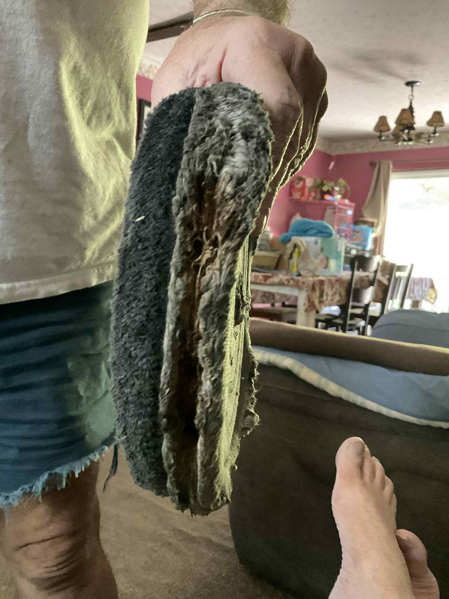

    Any of you guys that buffs parts to a high luster, ever have a wheel catch on fire!?
    I don't mean flaming like a bon fire. Just slinging off bits of hot coals.
    I have been buffing since the mid '80's, and NEVER had a wheel catch on fire!
    Wore several wheels down to almost nothing. Had little (normal) smoke coming off the wheel while buffing. Had to get my motor fixed three different times. (would not start two different times, and stalled out while applying rouge once) but never had any kind of actual fires! Motor gets warm, never hot enough to cause a fire!
    I was buffing several pieces of 3/8" 304 stainless rods to make exhaust hangers, and suddenly, little bits of hot coals started slinging off! I shut the motor down, and used my gloved hand to "pinch" all the little coals I could find imbedded in the wheel. Then started buffing again. Suddenly more hot coals started slinging off! I shut the motor down, quickly took a wrench used for wheel changing hanging nearby, ripped the wheel off, ran outside and throwed it in the rain barrel.
    Soon as the sun dries it off tomorrow, I'll put the wheel back on and see if anything happens, finishing up these rods, acorn nuts, bolts and washers.

    Joined: Oct 22, 2012

    Ok, update. I put the wheel back on the motor right after wifey took this picture today. Rouged it up real good, and really pressed the work in against the wheel as hard as I could. Trying to see if I could deliberately cause a fire! Could feel the heat through my gloves, had a good bit of smoke. Stopped when I got the piece polished. NO fire, hot coals, nothing! By the time I got the piece I just polished on the table and my gloves off, the wheel had cooled down, to where I could hold my bare hand on it for a little bit.
    So I don't know what caused the "hot coals". Seems no one else does.
    I am NOT a professional! Sorta self-taught through "trial and error," what didn't work and what did work. Plus what others had told me to try or do.
    Makes good sense to "rake" the wheel after polishing different metals. I was never told specifically to clean the wheels after different rouges and metals. I did anyway. I made a "rake" out of barbed wire fence staples. Seems to clean the wheels all right. Cleans up the br*** and copper residue left on the wheels.
    The lack of rouge comment. I sorta thought I used too much rouge. If I polished a washer, a acorn nut, or a bracket. I rouged up the wheel did the polishing, then inspected if I needed to do some more polishing. If I needed to buff again, I would rouge up the wheel ever time. Wifey bought three big bars of rouge from amazon around July. Right now, I have just about used up the first bar. Every year, I would go to Carlisle, I would buy $50 worth of those big bars of white rouge. Use to get 'em for $8-9 a bar. Now, I think she apid $15 a bar through amazon.
    Any more "tips and tricks" I need to know about? Thanks.
