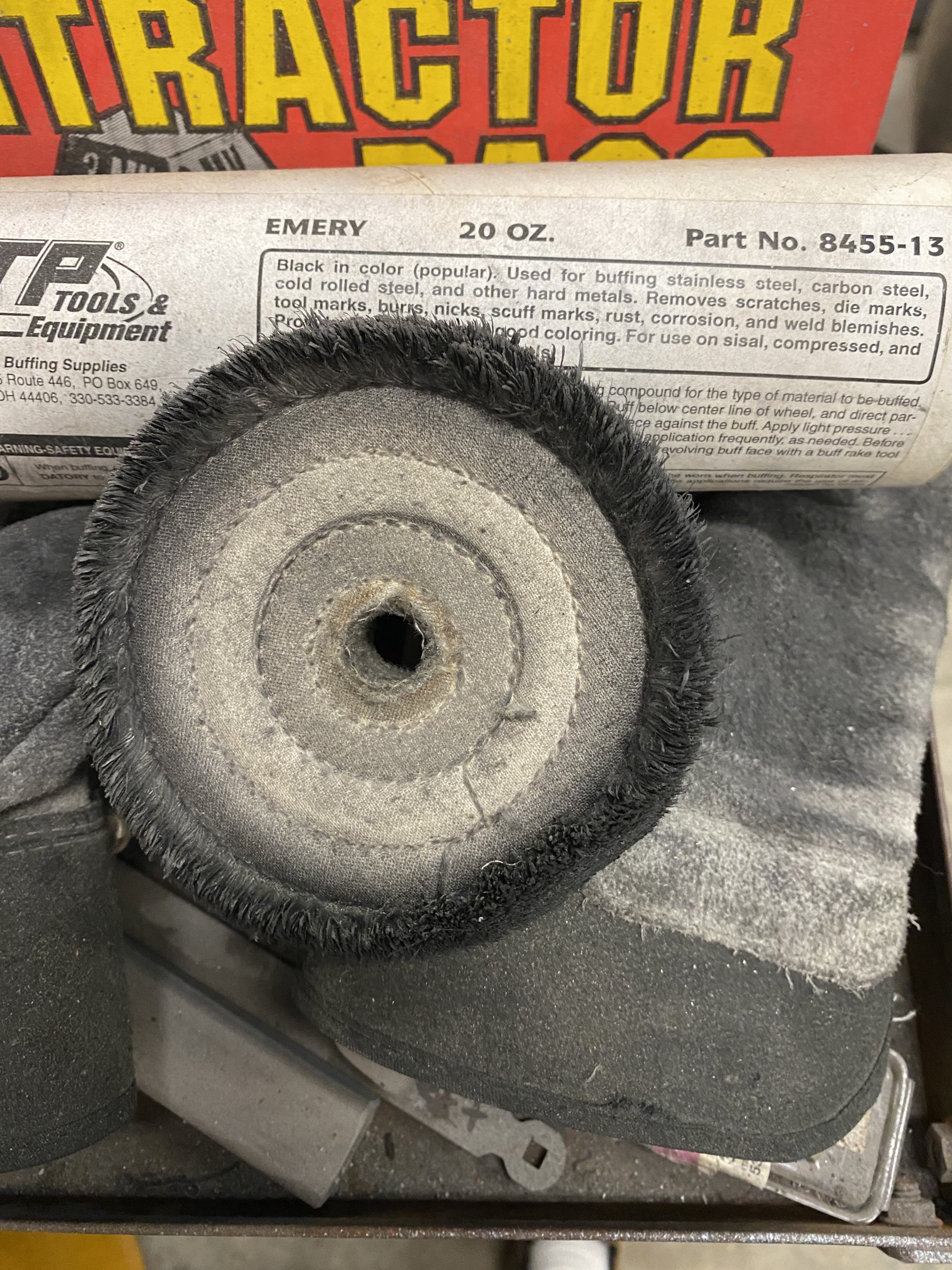

    for cleaning buffing wheels. [.ATTACH=full]6518331[/ATTACH]
