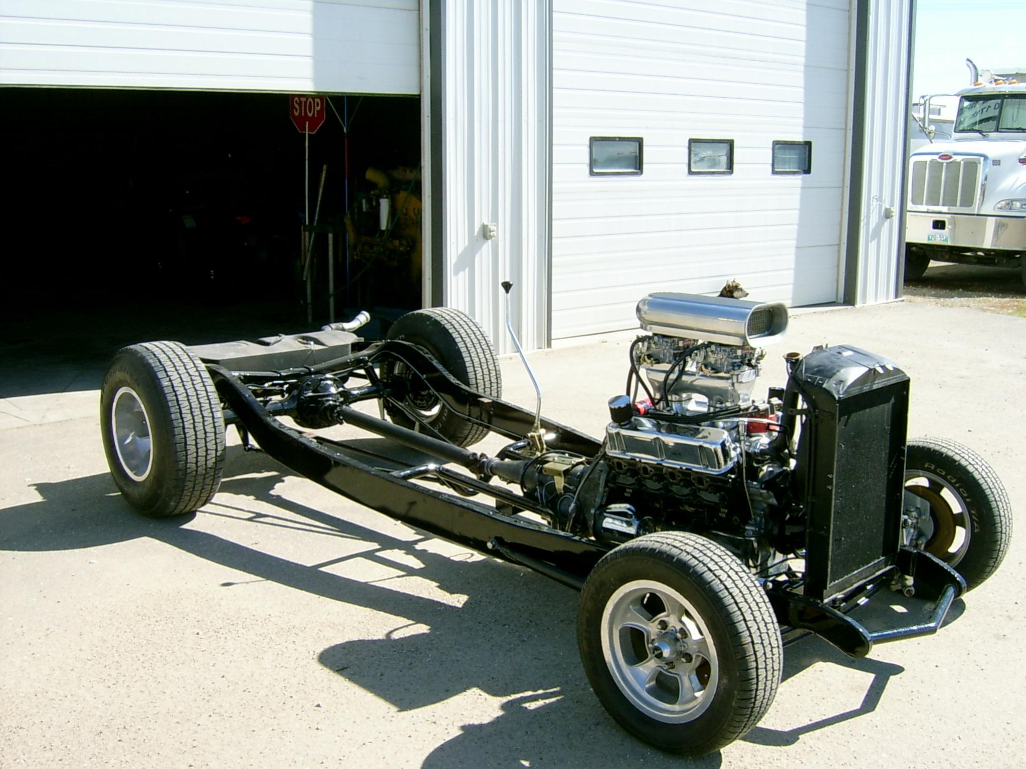

    Hey, just wondering if anybody has any info that can help me out? I have a 34 ford pu with a 8" rearend, buggy spring with a triangulated ladder bar set up and a pan hard. My problem is when I step on it hard it wants to change lanes and feels like the rearend is twisting, it handles good around corners and rides okay. I do not have any preload on the pan hard bar. I run regular shocks aswell. Is there any way to keep this from happening? Thanks

    SHOW US SOME PICTURES TO SEE WHAT YOU GOT. Knuck From Indiana.

    x2, pics will tell the tale of why the rear is steering the car.

    no spool or locker, everything seems tight and it was worse with no pan hard bar. truck 014.jpg

    Sorry, these are the best pics I got right now and it does not have the pan hard bar installed in these pics. Thanks

    Not sure on the squat, I assumed it was twisting and that was why it seemed like it was changing lanes. Does the look of this set up look okay? What should I check? Thanks again

    carefully put a jack under the rear diff yoke, and slowly jack upwards and see if there is any obvious deflection (simulating some axle wrap up) I would start there. And a pic of your spring perches on the axle may help us out as well...
