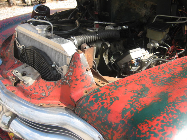

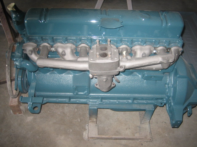

    A 216/235 has the rear of the head real close to the firewall and the Buick is two cylinders longer so some surgery would be necessary even if the radiator is moved to the front flange of the core support. The other route is to trim the upper radiator air baffle all the way to the hood latch plate but the core support must be reinforced. Pics of Buick engine and a 54 AD with a Duramax diesel--both are LONG.

    MO54Frank and tb33anda3rd like this.

    Damn Ben,
    You still have sharp eyes for an 82 year old but did you notice there are no hold down nuts on the valve cover studs; it's just setting on there to keep the dust out until someone returns my engine lift bar.
