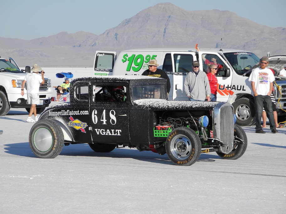

    There is a model A with a Buick 8 that runs at Bonneville. It has been considerably stretched. Also a '32 that looks nearer to stock, but I have never looked into the cab to see what that looks like. I would never consider putting that engine on an original model A frame. Other than that it sounds pretty cool.

  25. RichFox
    Joined: Dec 3, 2006
    Posts: 10,020
    RichFox
    You ask. I deliver. This time anyway.
