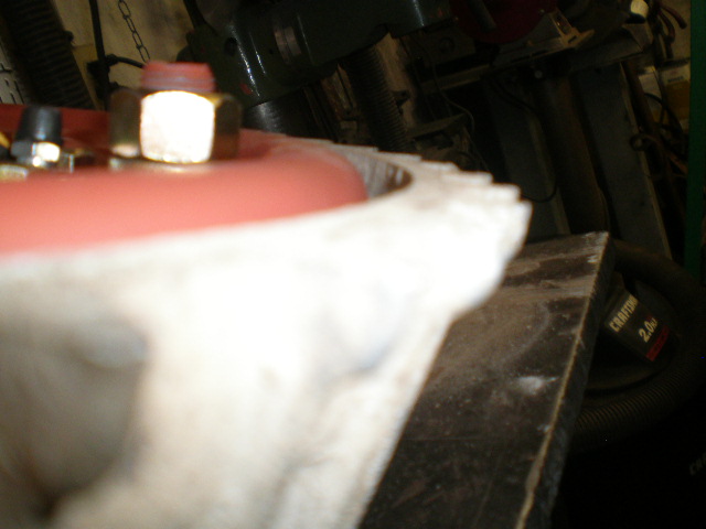

    A buddy of mine did the machine work to register the Buick drums to the Ford hubs. He had hoped to find a chunk of pipe that was close to the right size to make the job a little easier but ended up using aluminum stock. The drums should be registered to the hubs, NOT the studs, so you don’t need to be concerned about the orientation of the drums and the hubs in the future.
    After cleaning up the snouts on the Ford hubs, he bored a hole in the aluminum stock for a light press fit on the hubs, then turned the ODs for a tight slip fit to the holes in the Buick drums. He trued up the mating surfaces of the Buick drums and the Ford hubs and turned the OD of the hub flanges to fit the recesses on the inside of the Buick drums. The register rings were installed with Loc***e Spherical Parts Locker. I am running 16” steelie wheels so I wanted to keep the 5 ½” Ford bolt pattern. Pilot holes were drilled in the Buick drums to match the pattern with the final sizing waiting until the studs were installed so the holes could be machined for a nice slip fit.
    http://www.sunbunnybrown.com/detailshop/HAMB/hubBack.jpg
    I had used a BFH to knock out the Ford studs and the Buick drums were ~3/16” thicker than the original Ford drums so new longer studs were needed. I have seen suggestions to use NAPA 6411145, 6411138 or Dorman 610-132 studs. At 1 29/64” overall, the NAPA 6411145 may be a little short for good lug engagement, and all of these studs are larger in diameter than the originals and require machining the holes in the hubs. You can get original style studs from Mac’s for about a buck and a half (Mac’s 68-1107). At 1.56” overall (original studs were ~1 3/8” overall), the studs were plenty long to use with the Buick drums (six full threads of engagement with 16” Ford rims). They were a little loose in hub bores so we knurled them and installed them with Loc***e Spherical Parts Locker. After the studs were installed, the holes in the drums were machined to their final size.

    It turned out to be a whole lot trickier than I was expecting to ensure that you have full contact between the linings and the drums when you get into all the combinations of spindles, backing plates and hubs- And I never even got into the aftermarket stuff!
    Thanks for the spell-check on LeSabre and Invicta. I have noted the corrections in my original post. Now that you mention it, I remember those ball bearings when I pulled the Invicta drum. I also remember the left hand spindle nut being REVERSE thread. I beat on that ****er for ten minutes before I thought to turn the wrench the other way!
    I compared my early and late drums and as near as I can tell, the castings are identical with the exception of the early drum having a wider machined surface/shallower recess to accommodate the 2 1/2" linings. Otherwise, they are the exact same thickness, diameter and have the same size hub register hole. The machined area for the hub on the inside of the drum is about 1/8" smaller in diameter on the early drum and may require machining a little too close to the bolt circle for inside the drum hubs.
