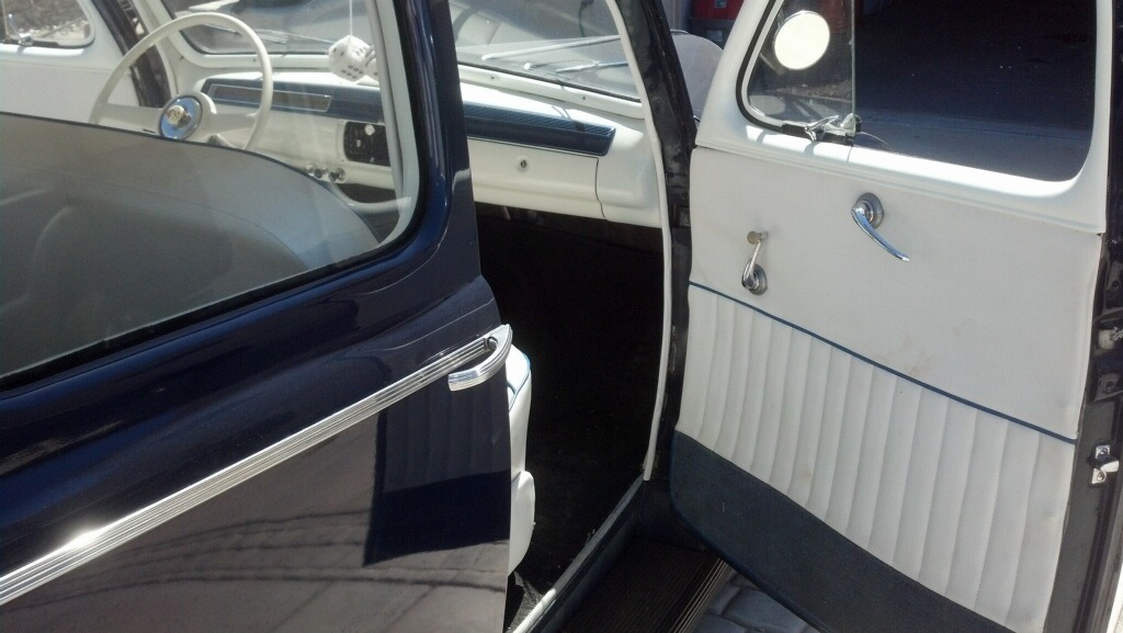

    I'm trying to buy a ford with a Buick v8 transplant. Trouble is the guy is horrible with pictures. Any idea what Buick motor this may be. ImageUploadedByH.A.M.B.1395775252.554362.jpg ImageUploadedByH.A.M.B.1395775266.917738.jpg

  9. better round up a friend from the forum and have him go look at it. Looks awful dusty. Stored outside???? Something does not sound right to me and I agree with 49ratfink!
