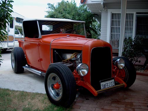

    Here's a not too clear or light pic of a 350 in a home brewed roadster pickup.
    It has a big cam, too big really, but it runs good.
    That and the headers along with the stock 4 bbl are it and it'll fry the tires all the way the freeway onramp.
