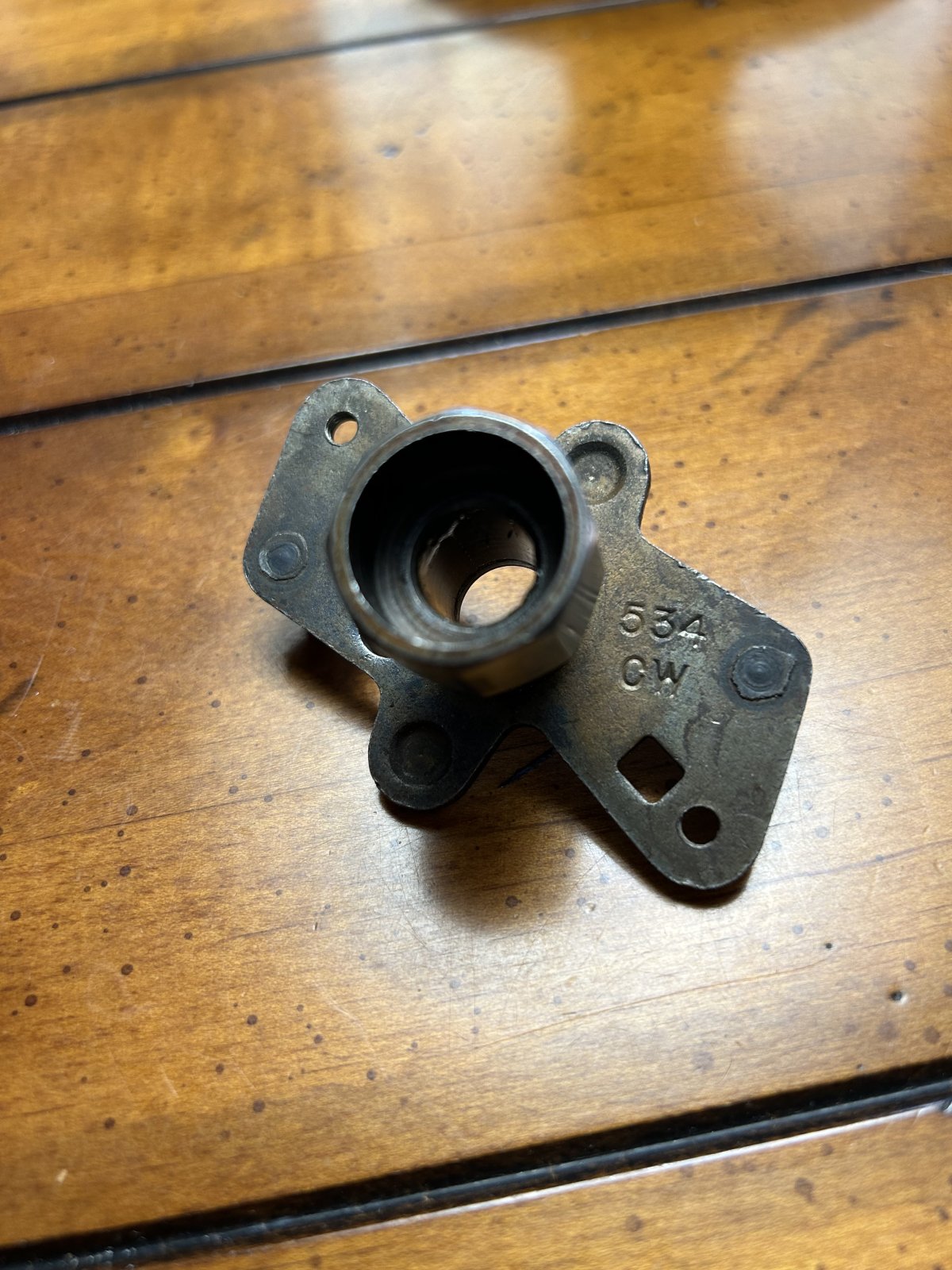

    I bought a ‘70 Chevy 350 years ago that came with a Delco distributor with the following information stamped on the advance ***embly-
    On Delco advance ***emblies the 534 means 34* mechanical advance and that cam is for a distributor that rotates CCW. Chevy distributors turn CW using a CCW advance.
    The engine came out of a car that ran at Raceway Park, a 1/4 mile bullring south of Chicago in Calumet Park, IL. Was that advance ***embly changed to “lock” the advance where the mechanic wanted it? It’s a long shot but in 66 years of existence could your advance ***embly have been switched?
    pprather, Johnny Gee and squirrel like this.

    ^^^^^ Better way of explaining what post #31 was getting at.
