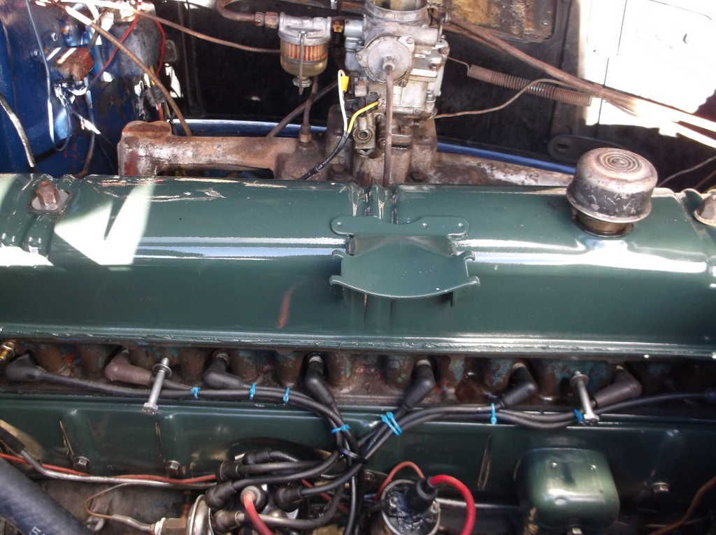

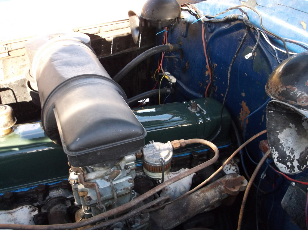

    DSCF1779-001.JPG DSCF1770-001.JPG DSCF1775-001.JPG DSCF1779-001.JPG DSCF1770-001.JPG DSCF1775-001.JPG much apreciate the insite.after spending most of my sunday,sittin around in my underwear,watching football,i decided to go,at least bolt it back together,so it was in one piece.and at least i could short the sol. to start it.so for the hell of it,after instltn. i tried it,and worked better than new.i swear shes like cristeen,talk nice ,rub her a little and she fixes her self.that being said,ive had the fear of god ,put in me,and im about ready to go buy a 6v battry.like i said ,id sure hate t screw up the pedal starter.im not sure what gears are there,but it feels good at what i think is about 60 or so.but we all know ,people will kill you for only going 60,in a 55.seems to like gas a quite abit aswell.im thinkin it could pull 3.2 or so ,w
    ith no problems.seems to have crazy torque.hows yous feel??
