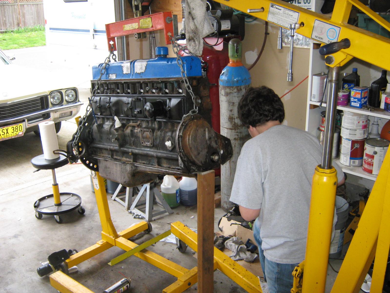

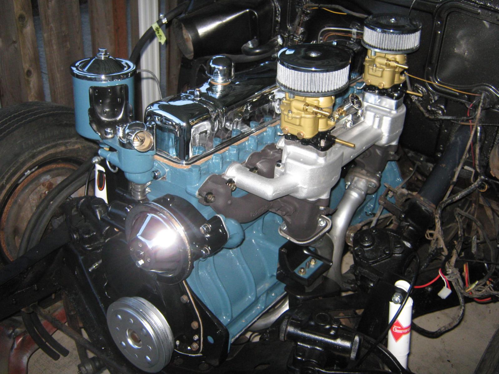

    I love my Buick and the straight eight is always a great conversation piece everywhere I go, so I thought it was only fitting to make the big O'chunk of iron presentable and clean off sixty years of grease, oil and grime. Also chose to add a little flavor, found a 41-42 compound carb/exhaust set up to put on it. So here are some pics of the event to date. Its almost ready to go back into the frame rails. I keep posting as I continue.

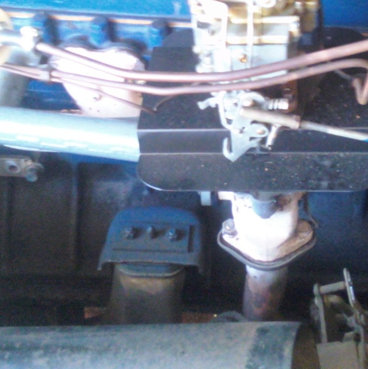

    Buicks are great. Yours is a nice-looking car. Good job on the engine. Is the exhaust gonna clear the motor-mount? As far as I've heard, the '41/'42 exhaust wont clear the driver's side motor-mounts on later cars.

    Yeap, already modified the motor mount tower on the frame and also the bracket on the engine.

    Here is a before and after pics on the modified engine mount for exhaust clearence.

    On the exhaust on my 53, we crossed over below the trans, but mine is a 3 speed so my tranny is smaller. I wonder if you could cross over just behind the tranny just below the torque tube. I should have my car in the air in the next couple of days, I can take pics if you like.

    I noticed that while on the engine stand, you still had the hoist chains on the block, was that safety move, that big 'looonnng' straight eight almost looked like it would have tipped forward without the chain?
  17. anythinggm
    Joined: Dec 1, 2007
    Posts: 445
    anythinggm
    from Oregon
    Yes it was a necessity, the engine is to long and heavy to be on the engine stand alone. To much forward weight. I had to use a 2x4 at the front of the oil pan to the floor for support when I took the cherry picker away.

    looking good when just finshed geting my ladys buick running today, im doing the brakes in a week and then it will be on the road. the intake you have is thats a aftermarket one right??, i hav acess to geting a factory dual single intake for the straight eight, i was told that it was a police addition package. shes looking good man
  20. anythinggm
    Joined: Dec 1, 2007
    Posts: 445
    anythinggm
    from Oregon
    My set-up is a stock factory from a 1941-42 Buick 248. But I ditched the strombergs for the Holley 94's

    Sorry I didn't get back to you sooner with these pics, I forgot all about it till today, they are a little dark but it the best I could do with the lighting I had. Hope they help

    Thanks for the pics, that was helpfull. I ordered 30"in Smithy's and have a appointment to have the exhaust done next week. I simeesed the holes in the Xmember to match the drivers side. I had to ditch the original dynaflow trans cooler that was mounted on the side of the trans, so there would be room for the pipe to run down that side, I will just put a generic cooler in the front of the radiator as its replacement. Getting closer to having it back on the road.

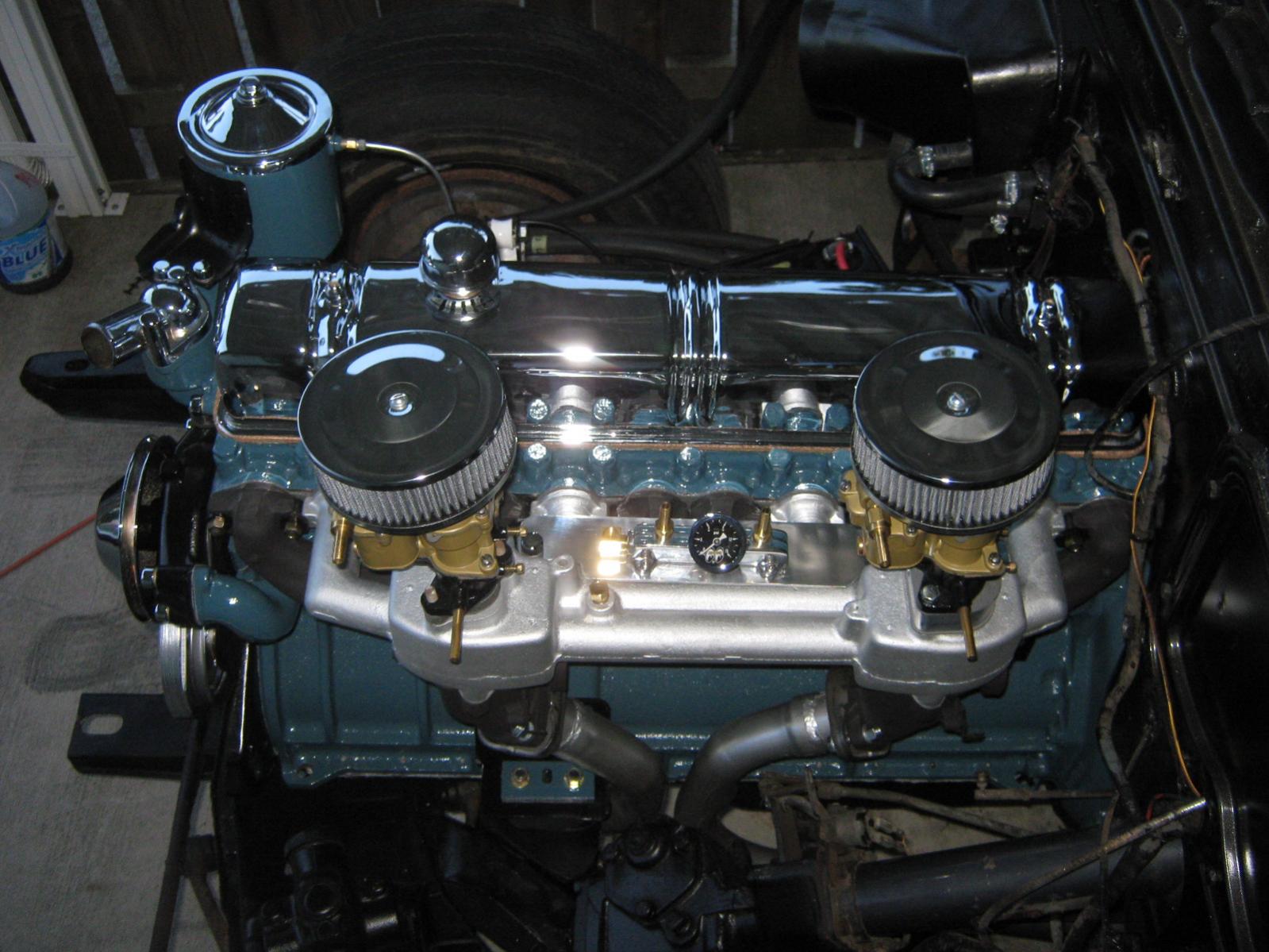

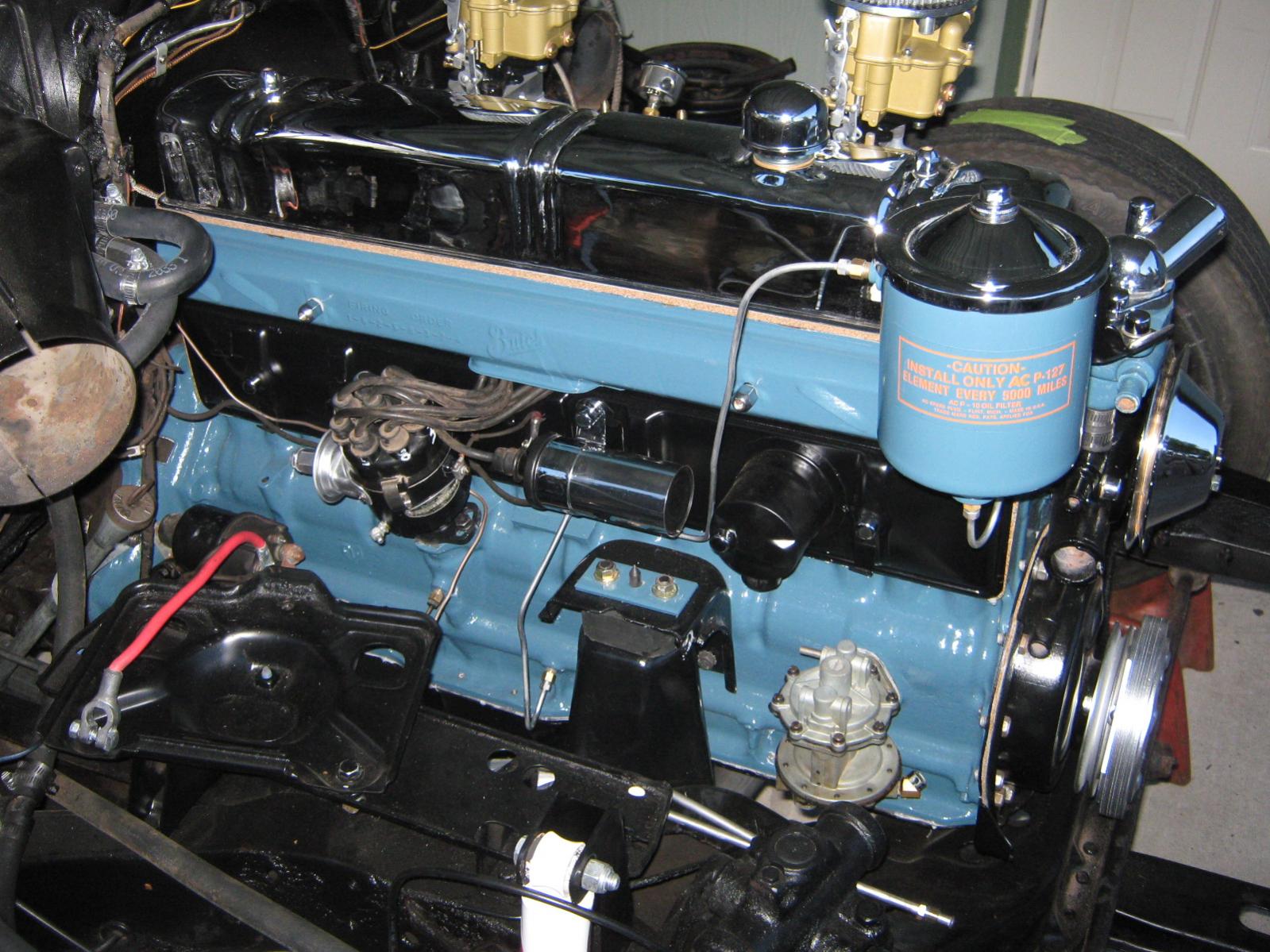

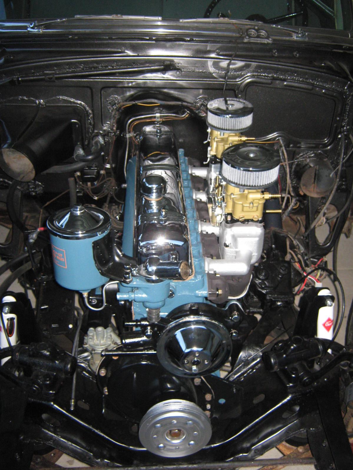

    Been working on this project some more, getting closer to firing this thing up, just picked up my chrome stuff from the chrome shop today. Here are some new pics.
