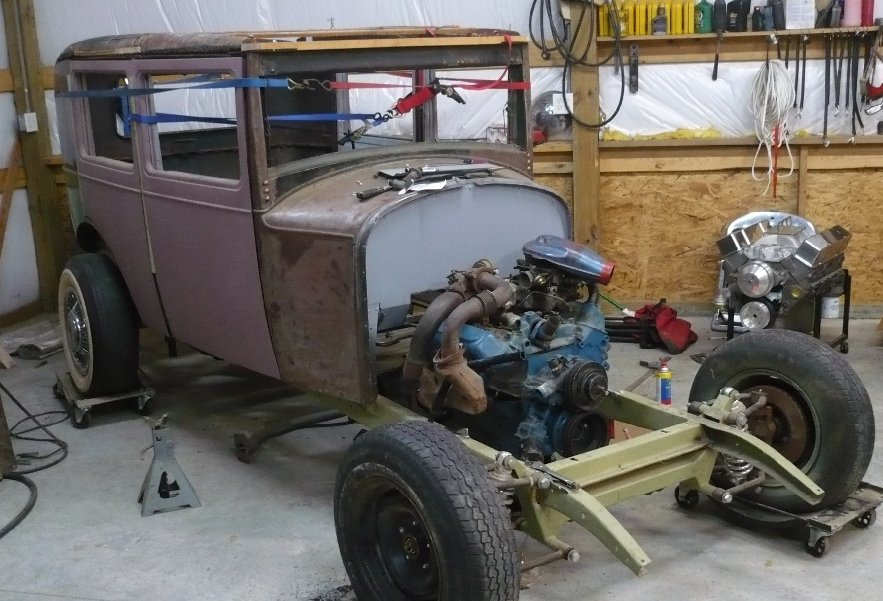

    I am looking for any pix of the 79-80 Buick V-6 that has been used in a streetrod or on the drag strip. Still working on the '28 essex and need some ideas for the exhaust and set up.
    Dan
