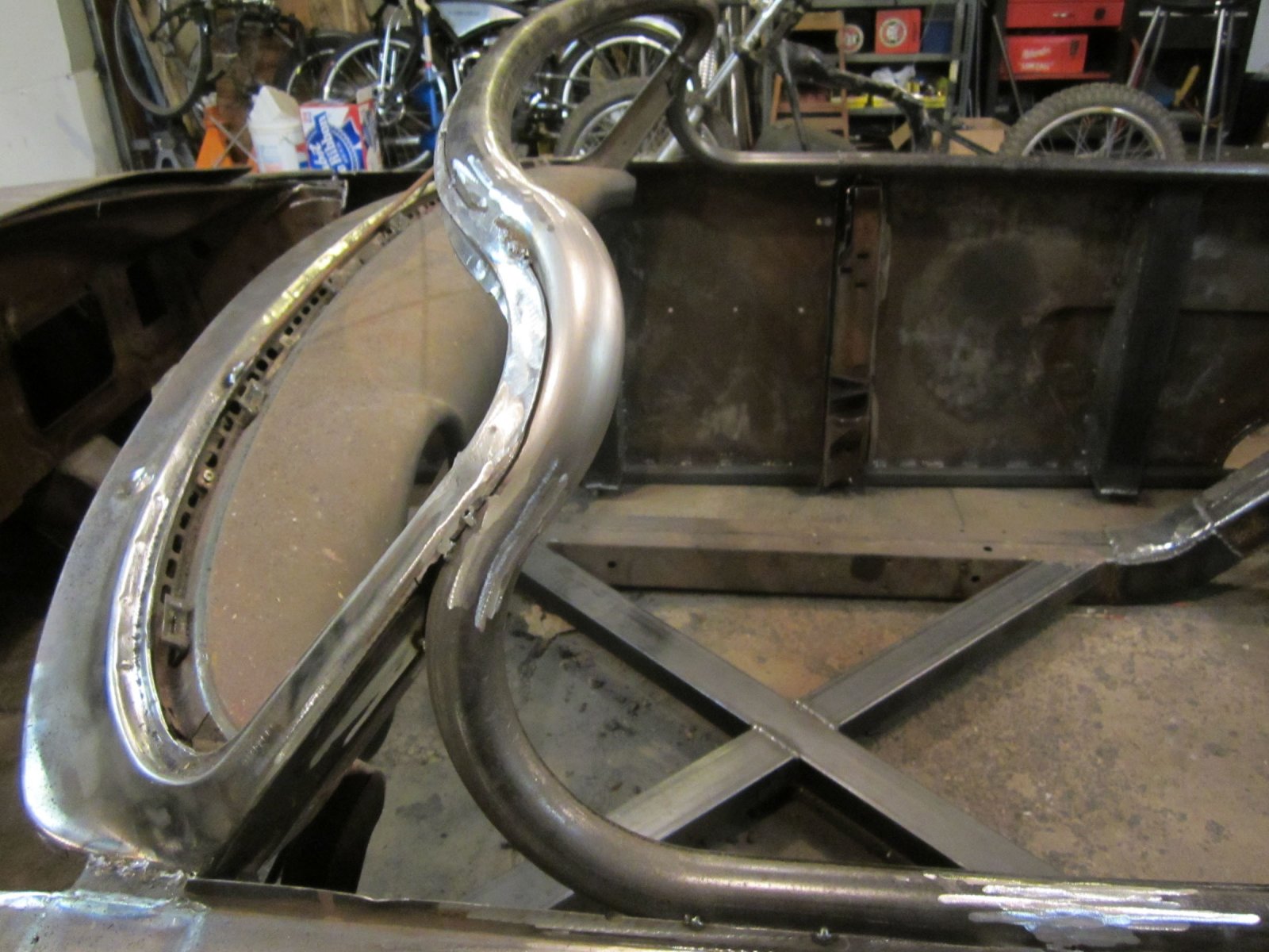

    Wastelander
    This is the perimeter tubing done. I had to use exhaust mandrel on the tightest bend. IMG_1361.JPG

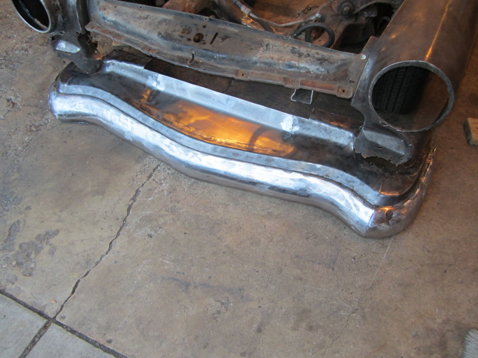

    Wastelander

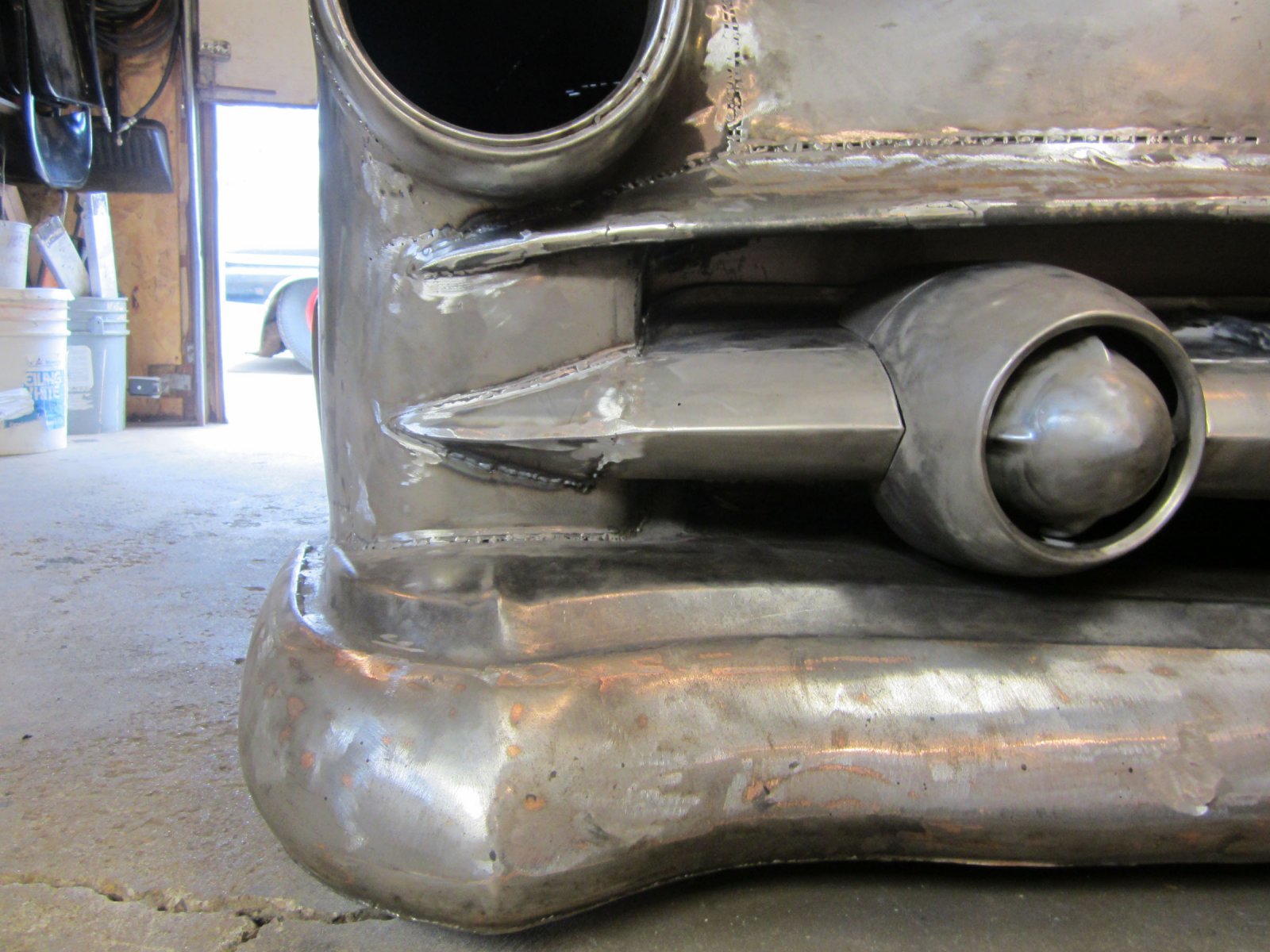

    Wastelander

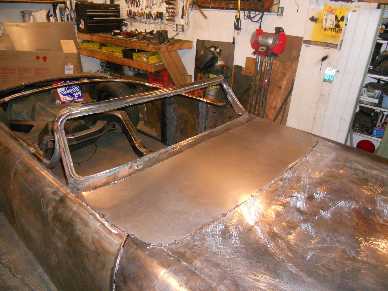

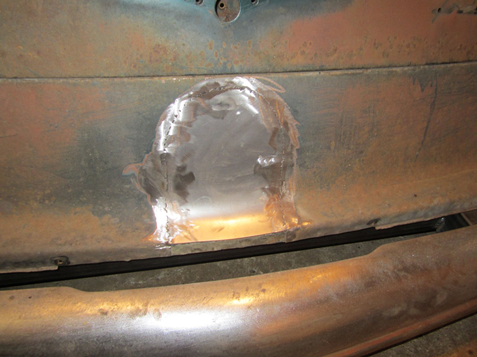

    Wastelander

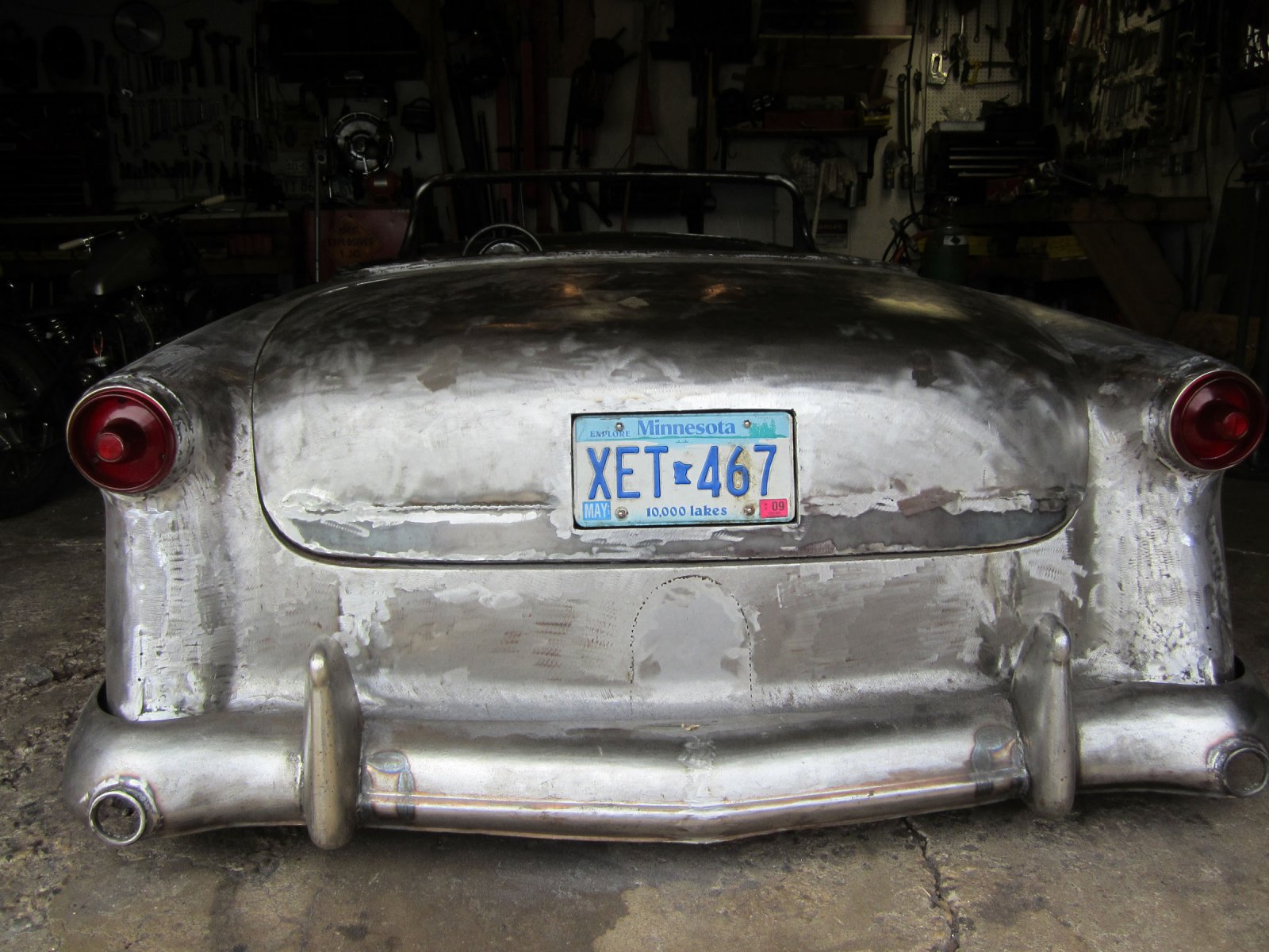

    Wastelander
    I recessed my licence plate into the trunk lid. It is also the latch for my trunk. IMG_2198.JPG

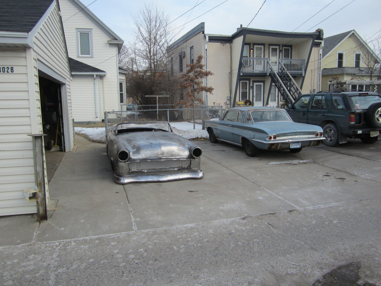

    Wastelander
