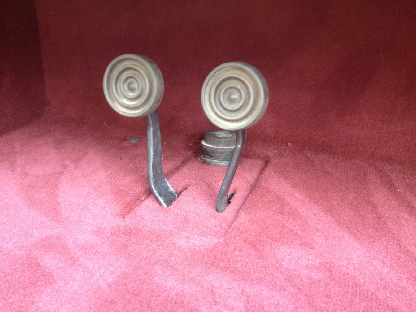

    I converted a '62 Ford hanging brake/ clutch ***emble to an under floor master. I can't open my hood to check the brake fluid. It remains part of the frame and comes out through a hole when the body is removed. I can pull my body off and not ave to mess with my throttle cable of brake lines. This was a TON of work. IMG_2669.JPG

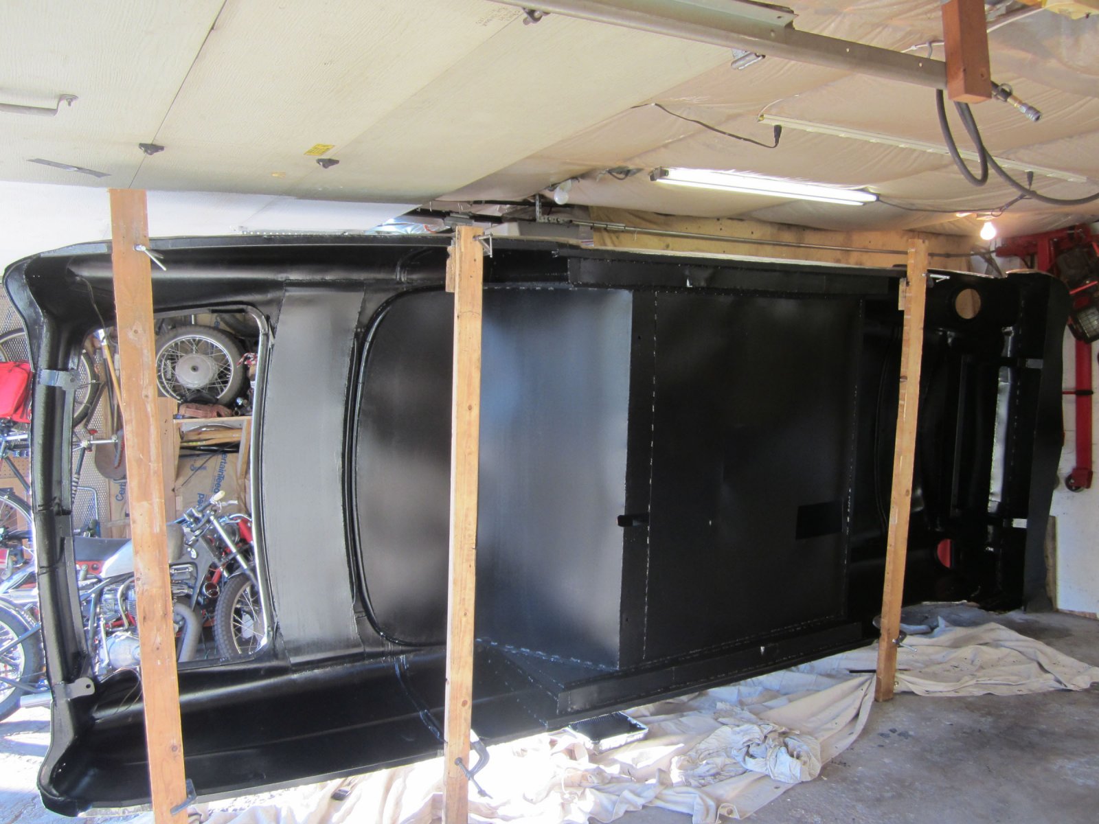

    October 2013. Body is back on it's side. The welding never ends. IMG_2701.JPG

    I coated everything you can't see in a thick coat of implement paint. IMG_2706.JPG

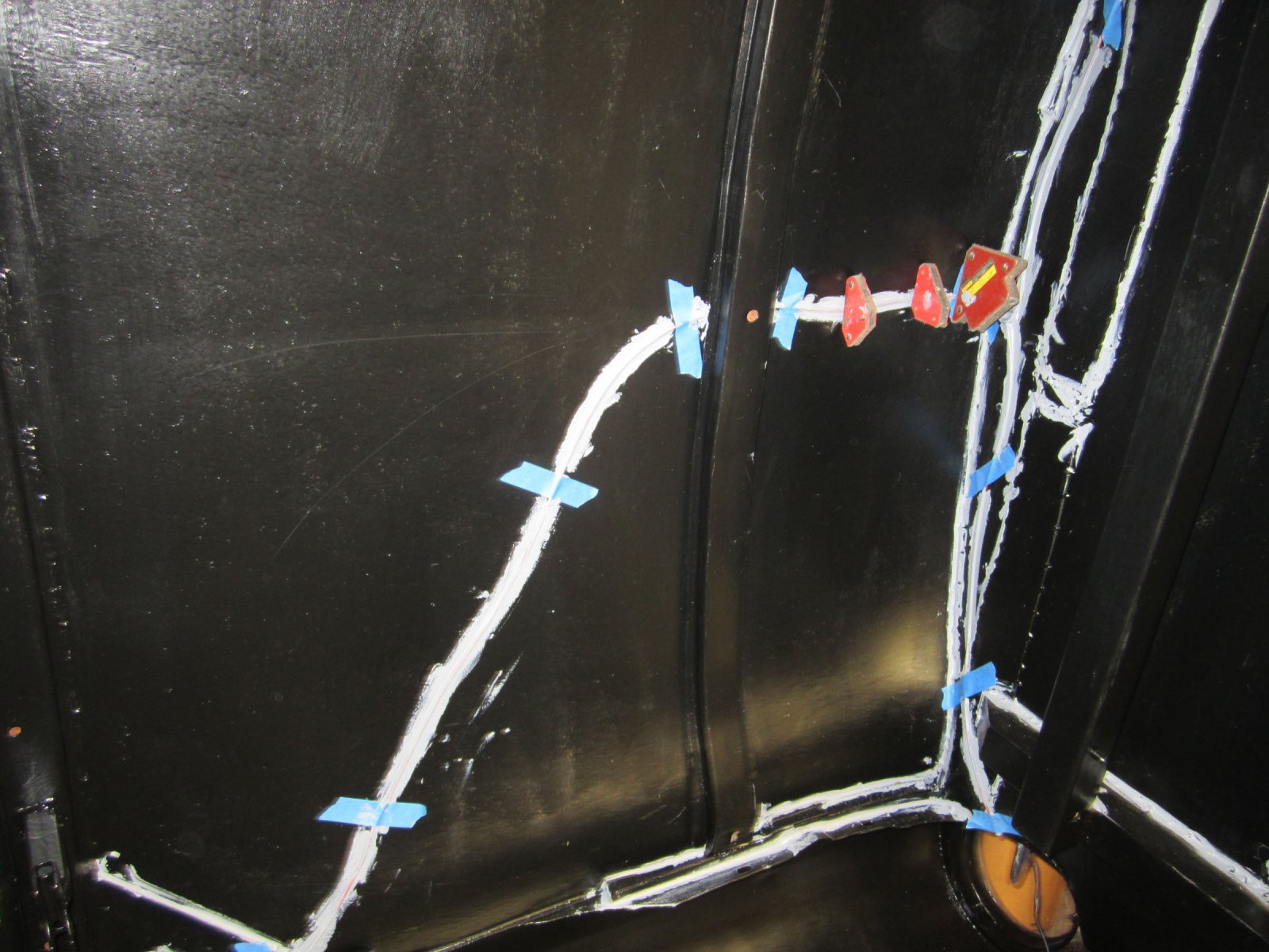

    I glued the wires for my headlights and taillights directly to the body with seam sealer. IMG_2717.JPG

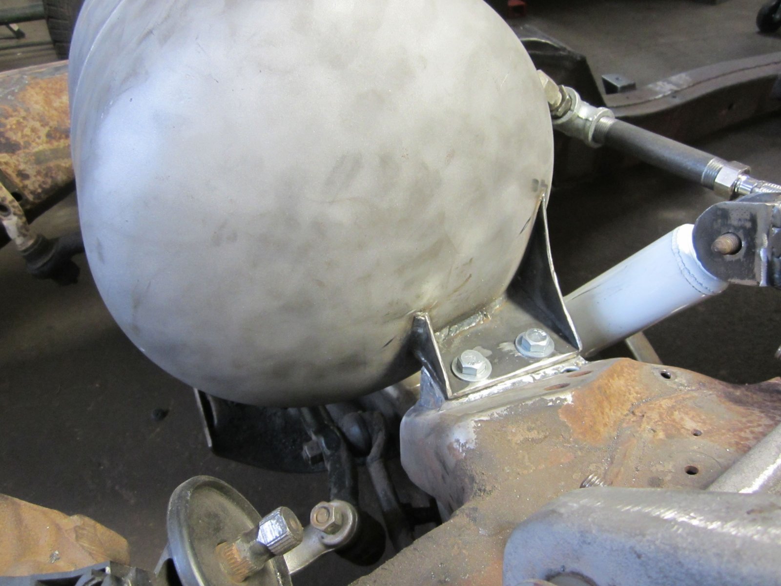

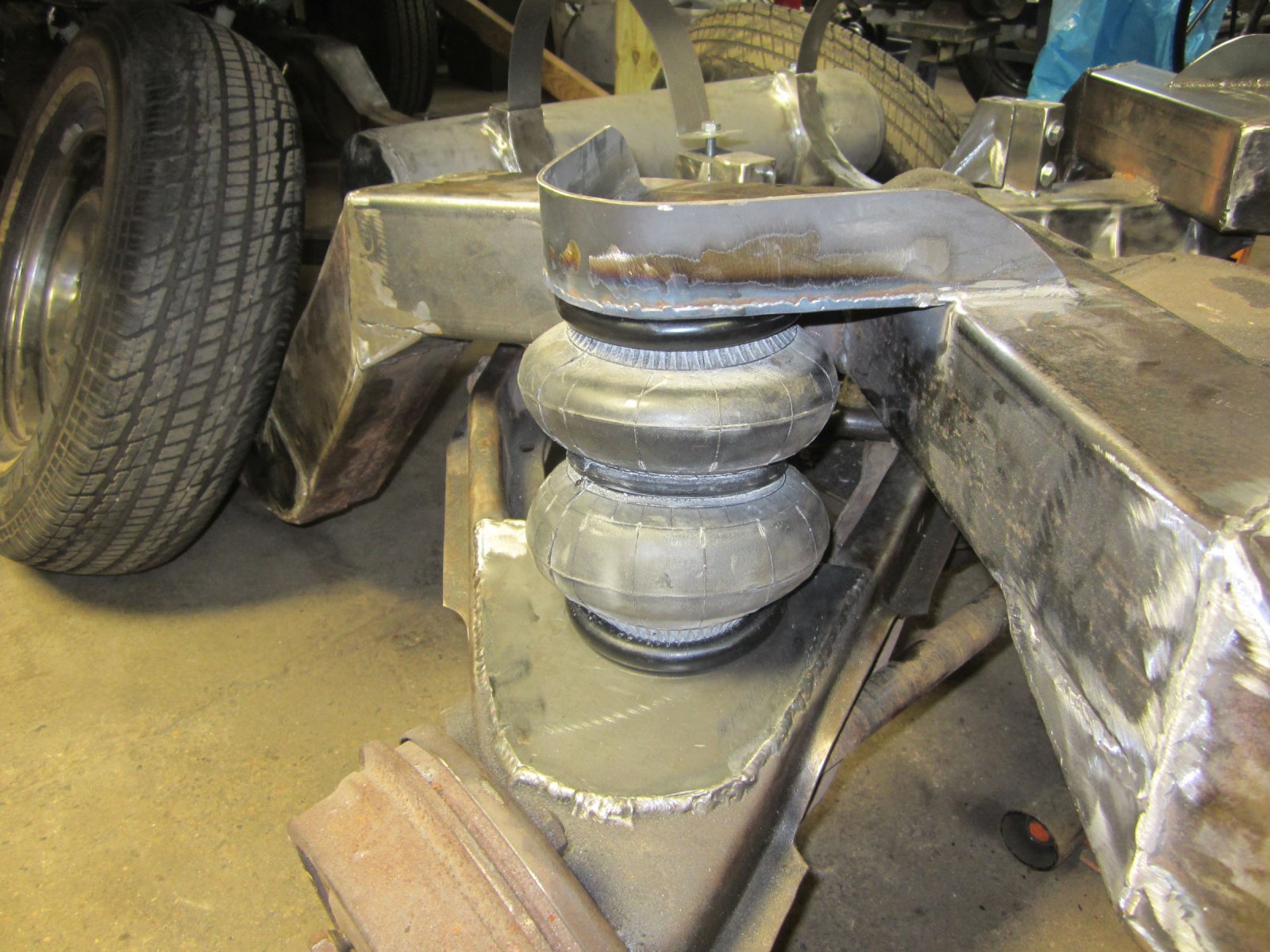

  10. Wastelander
    Joined: Mar 3, 2010
    Posts: 92
    Wastelander

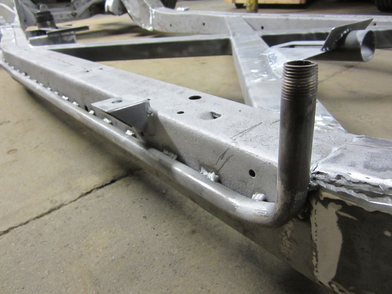

    My air lines are 1/2 inch black pipe welded directly to the frame. IMG_2847.JPG

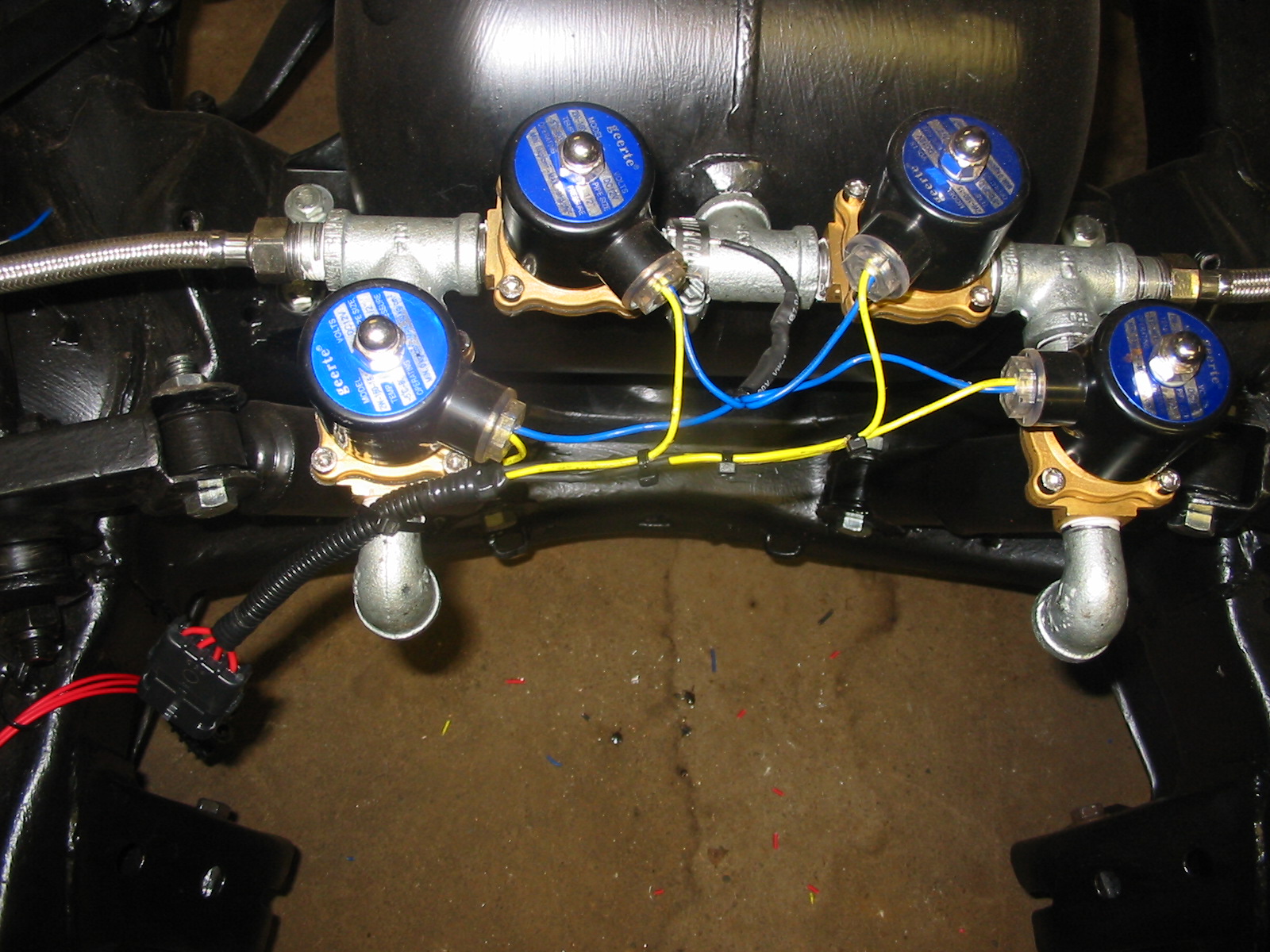

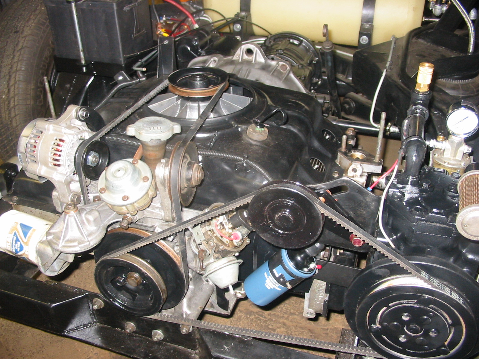

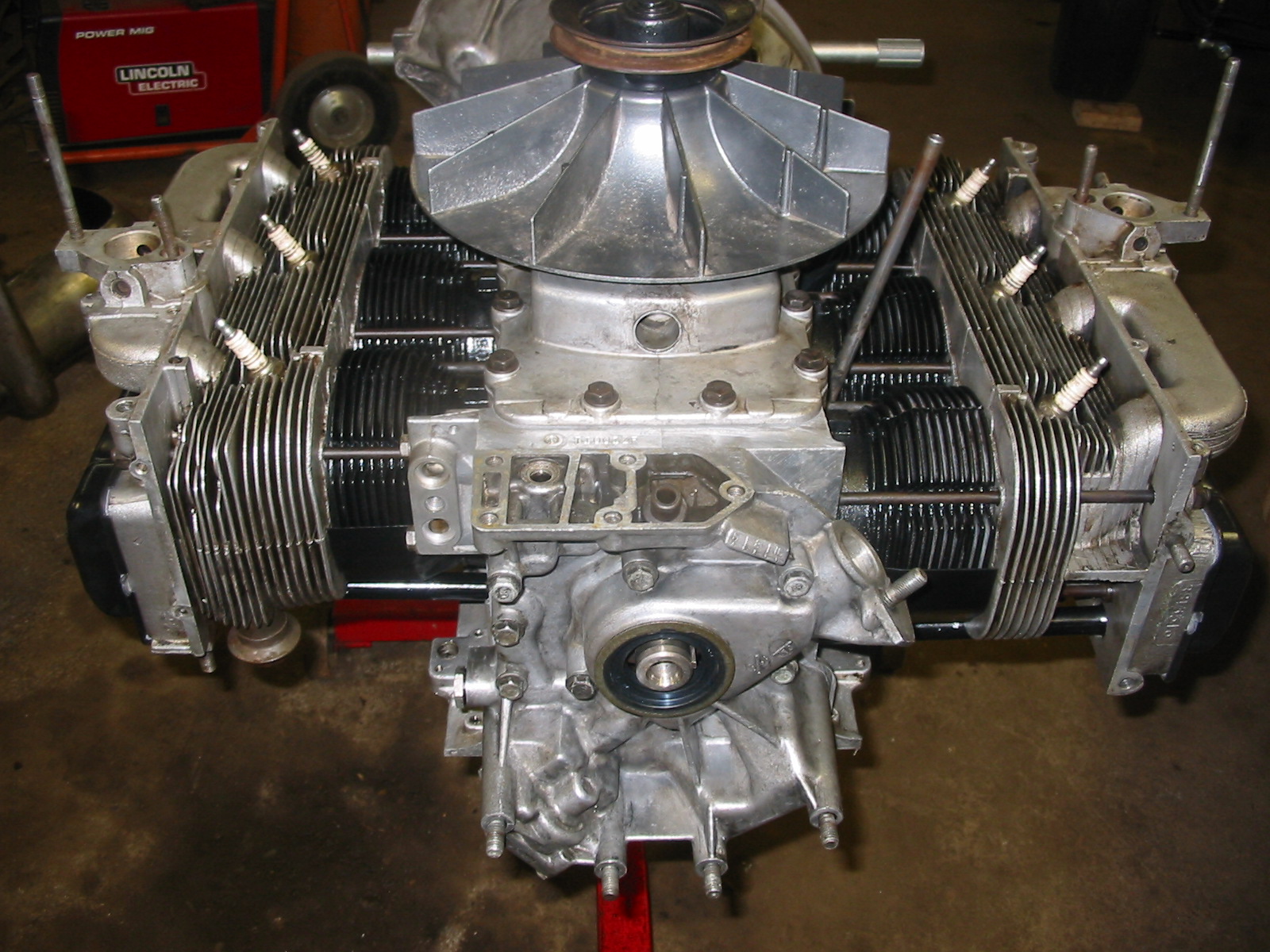

  17. Wastelander
    Joined: Mar 3, 2010
    Posts: 92
    Wastelander
  18. Wastelander
    Joined: Mar 3, 2010
    Posts: 92
    Wastelander
  19. Wastelander
    Joined: Mar 3, 2010
    Posts: 92
    Wastelander
    BradinNC and kiwijeff like this.
  20. Wastelander
    Joined: Mar 3, 2010
    Posts: 92
    Wastelander

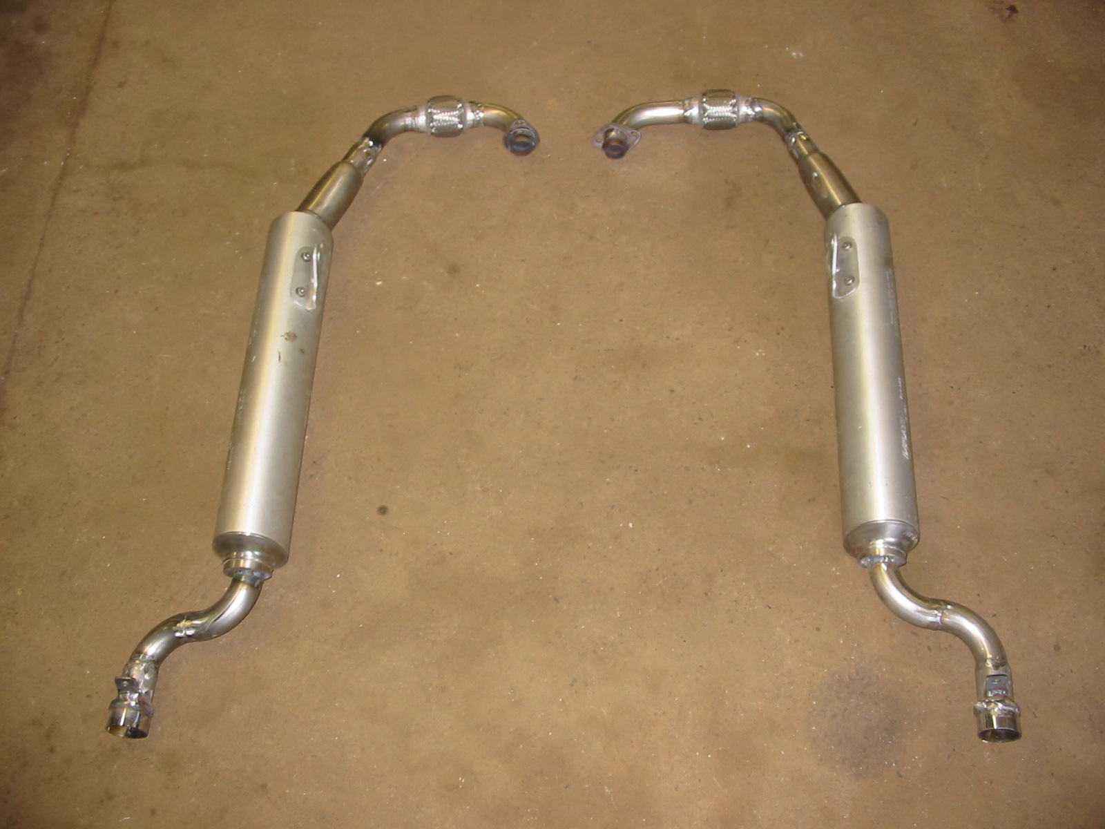

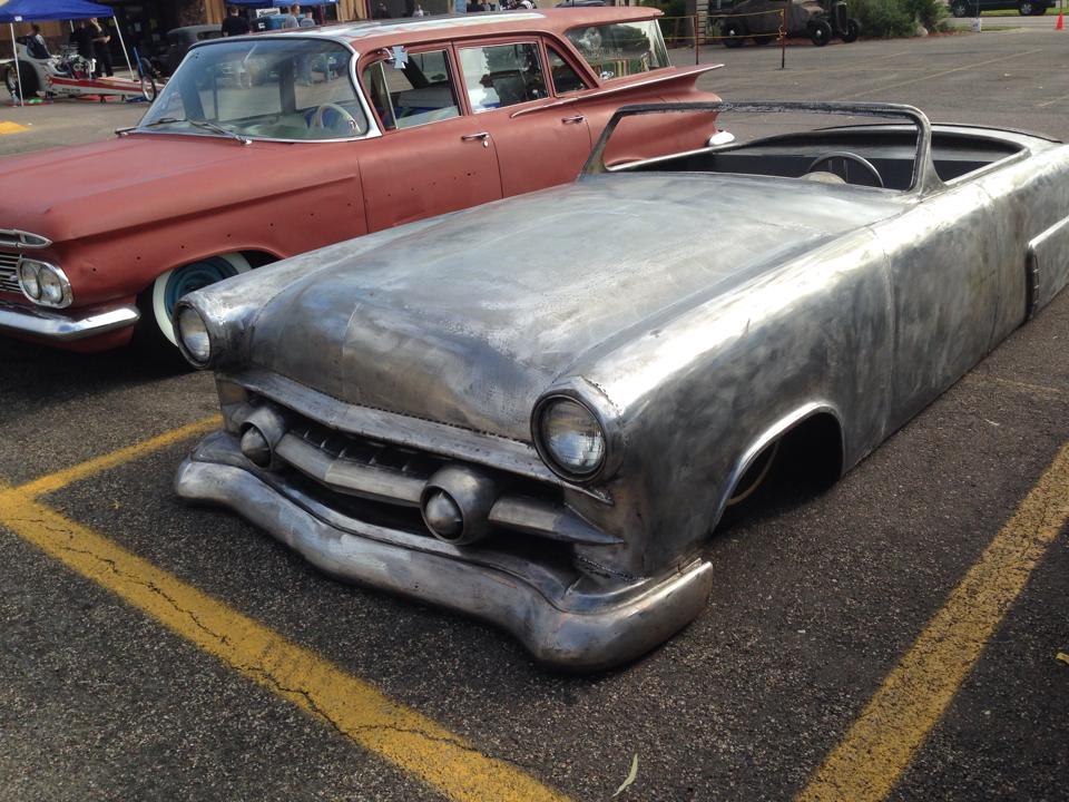

  22. Wastelander
    Joined: Mar 3, 2010
    Posts: 92
    Wastelander
    August of 2014. It made it to it's first car show in bare steel with no windshield. 10620721_10202655413210526_1137109188213773546_n.jpg

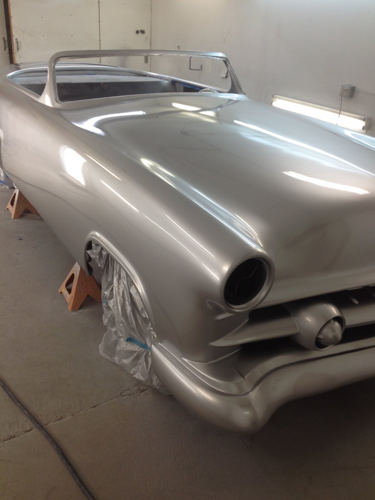

  24. Wastelander
    Joined: Mar 3, 2010
    Posts: 92
    Wastelander
    I painted it House of Kolor Orion Silver under the very close supervision of my friend Courtney. IMG_0077.jpg

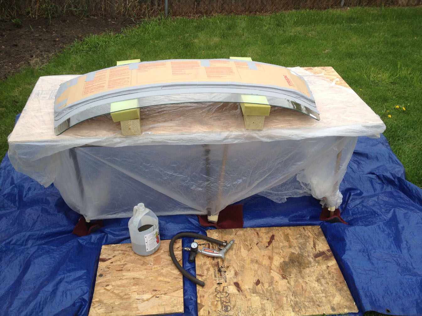

    I chopped my windshield with a sandblaster and a roll of gaff tape. It took forever but it worked. IMG_0294.JPG

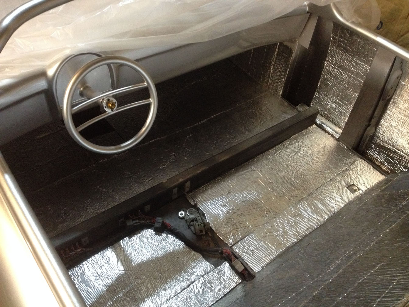

  27. Wastelander
    Joined: Mar 3, 2010
    Posts: 92
    Wastelander
