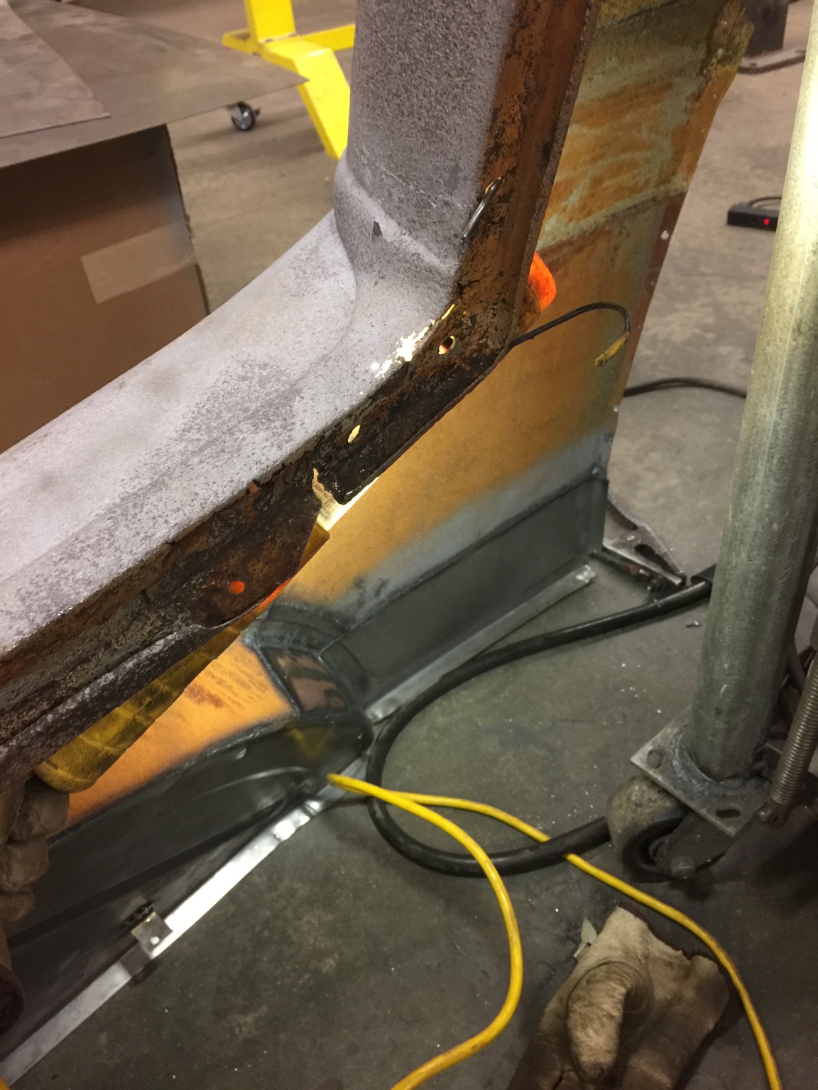

    Great job, thanks for the close up of the rear corner. Did you pie cut it to make it fit ? Also, how did you get the body lines straight? In the back side shot it looks way off but the front, it's lined up. Hammer and dolly ? Thanks for helping someone who's learning [emoji106][emoji41]

    I took the first pic from behind to show just how far off it was. I then cut the entire patch vertically and added 3/16" strip and welded it back up. It is amazing just how far off things are. I sometimes wonder what dies people use to make these things.... If I had a lot of time I would spend some time making new dies and forms. I have too many things I never get done so this would be bad thing to take on! :)

    I haven't been able to work on the coupe for about a week due to my son's sports schedule. Finally had a couple hours so I went up there and took some more small bites off of the beast.
    There were some Swiss cheese spots on the transition. You can see light coming through the bad. I made a piece and put through the stretcher until it fit just right. Welded it in and am pleased with the results.

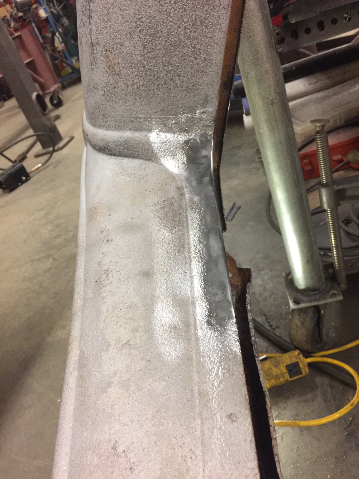

    Had a few hours to play this evening. Did some more patching and welding up small pin holes.
    After that I made some drip rails. Was my first go at it but they turned out really well. Kinda tricky as they have a compound curve. I have a ring roller so it made things go smoothly. Hope the pics explain things. [​IMG][​IMG][​IMG][​IMG][​IMG][​IMG][​IMG]

    I was curious how people were transitioning the flat wheel well patches to the curved upper part.
    Sub'd
  20. jackalope
    Joined: Mar 11, 2011
    Posts: 692
    jackalope
    I actually made some pieces where there is the radius by hammering them and then m***aging them smooth. My wheel wells were roached beyond what the new wheel well covered.
