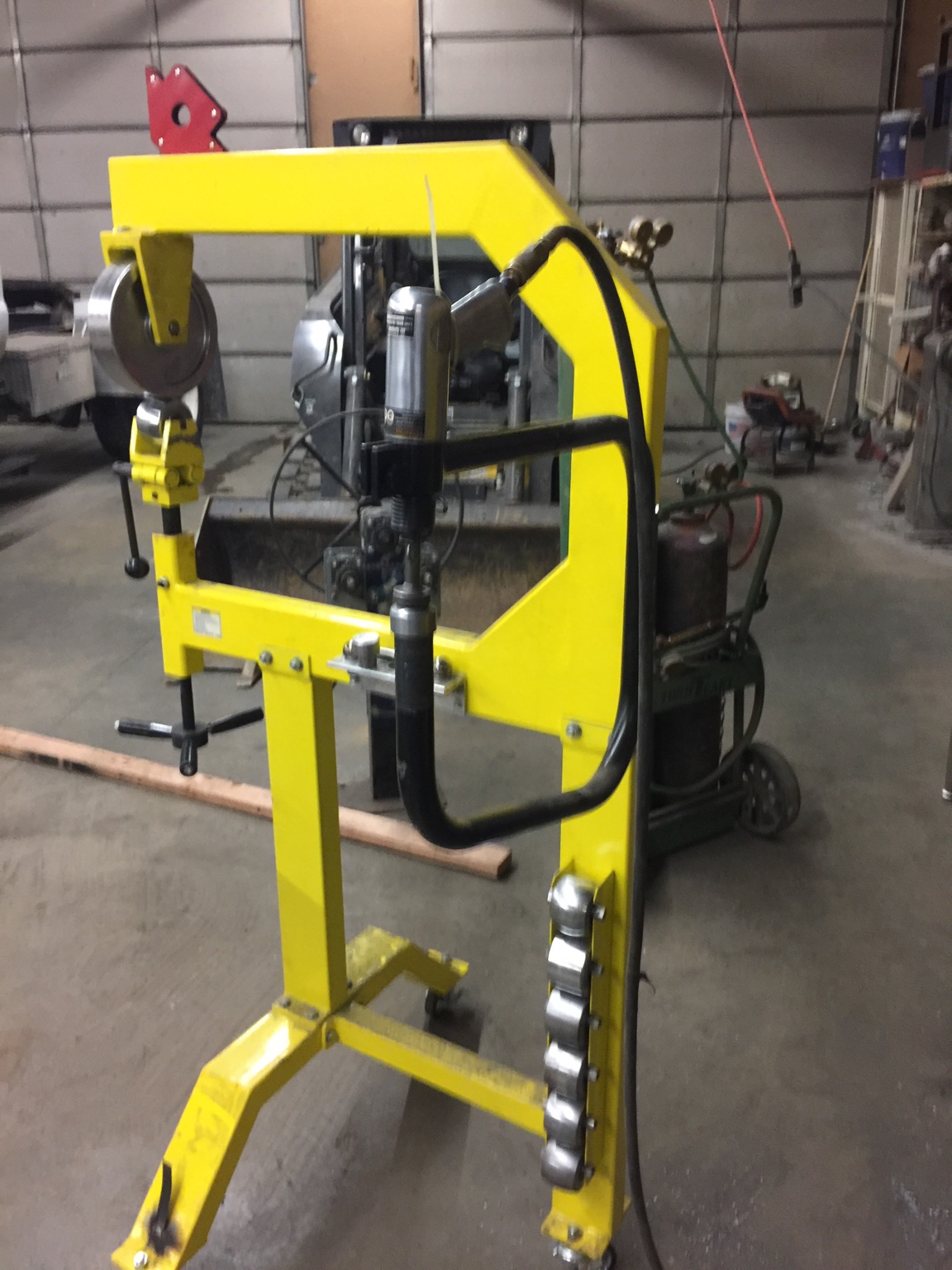

    Buddy of mine sent me a quick clip he snapped. I didn't know he was doing a video but, hey. Here ya go. Using the homemade planishing hammer.

    I've heard that mig welds can crack from hammer welding. Is that true with planishing after the mig weld has cooled? I guess I should have asked if you are mig or tig welding the panels?

    If a MIG weld can, there is no reason a TIG weld wouldn't either. Metalurgically speaking the alloys are the same. There is no reason a different process would cause a problem. Work hardening DOES happen with anything for the most part. So, if I were to tig the panel with the same alloy and hammer, I would expect the same work hardening. Cracking CAN happen with anything if you push it. I have no cracks.

    One other thing that some may say that cracking can happen is because with MIG, there is considerably more deposit material than say a TIG weld. Hammer a spot weld from a MIG more and the "dough" squashes flatter and wider and eventually splits when there is nowhere else to go. I typically grind my MIG tacks relatively flush and the hammer the outer areas flush with the mating panel.
