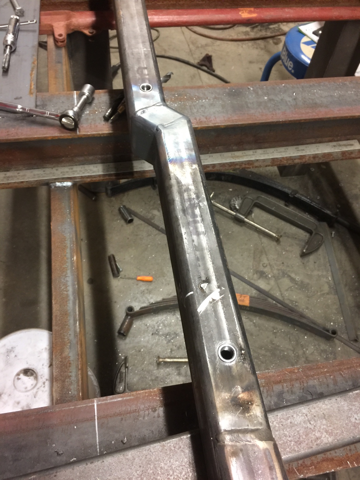

    Above are some adjustable radius rod ends I bent up. Tube is 1.0" x 0.25" wall tapped with clevis ends. I used some old British Ford Radius Rods I got from Ty Johnson on the HAMB. I cut the original attachment points off and used my tube ones in place. [​IMG]
    I gussets them but don't have any pics that I can find but I know I took some. I will post up when I find them.
    Obviously the suspension will ride below the driveshaft which will be make for one heckuva armrest!

    These radius rods will also receive a thorough beefing up after they are welded up. Going to be under quite a bit more stress than they were originally intended to be under! Also, because the configuration is quite curvy, they will see additional stress.
    [​IMG][​IMG][​IMG]
    The axle will ride where the hoop is in the fenderwell.

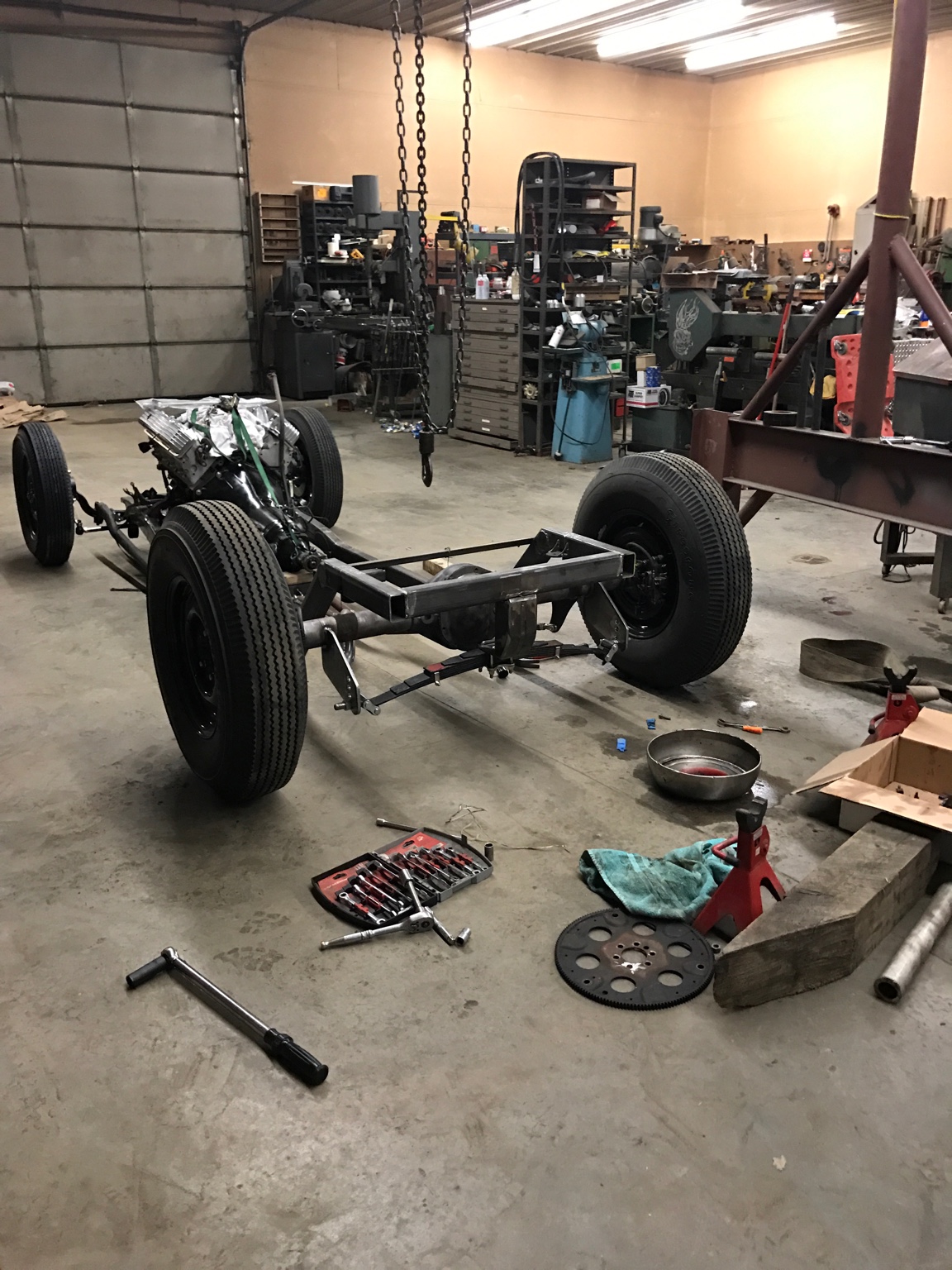

    I haven't updated in awhile as I been tied up with my sons sports. Finally got to the shop and made some headway.
    Got my axle shafts back from re-splining and got me a roller, finally!!!
    I'm really glad I opted for the adjustability with the rear suspension. Everything sits exactly as I had hoped it would but couldn't be sure until I put some weight on it. [​IMG][​IMG][​IMG][​IMG][​IMG][​IMG][​IMG]
    Second picture up you can see where I reinforced the radius rods. I added piece of 1/2" solid round welded the full length of the radius rod. While this should certainly strengthen things, I don't expect them to be nearly as strong a a piece that is straight. I will also be welding in a slight gusset at the axle RR mount.

    Suspension cycles very well. Surprising it works like I planned but I guess taking your time and actually doing some figuring DOES pay off.
