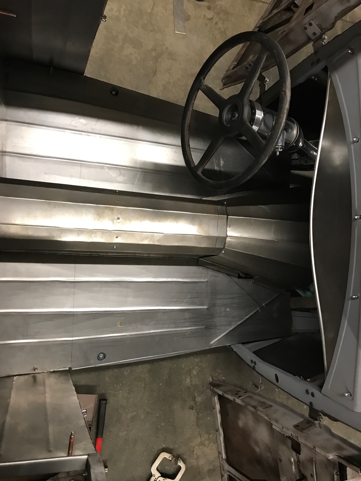

    Decided to pull the drivers side floor pan out and remake it. Didn't like the fit. Then, after I was happy with it, I got on with making the backs and 1/4 window sides. Everything interlocks with flanges so the pans are nice and solid. [​IMG][​IMG][​IMG][​IMG]
    I'm going to try and make the toe and kick panels this evening or maybe some simple door panels.

    Not a whole lot of change but did get the last panels (toe and kick) in and some temporary door panels just to help hide the ugly for now. [​IMG]
    They all interlock with flanges and fit like a puzzle. I pulled them all out and getting them back in was fun but all fit right. Should make for a quieter and more solid ride.

    Slight update with steering. I needed to take out the toe panel on driver side as I had my steering column going in at too steep of an angle given my seats will be low. I then brought the column out a little higher in firewall and I am much happier. Also machined a piece of stainless rod for the double D shaft. Voila, turns power[​IMG][​IMG]
