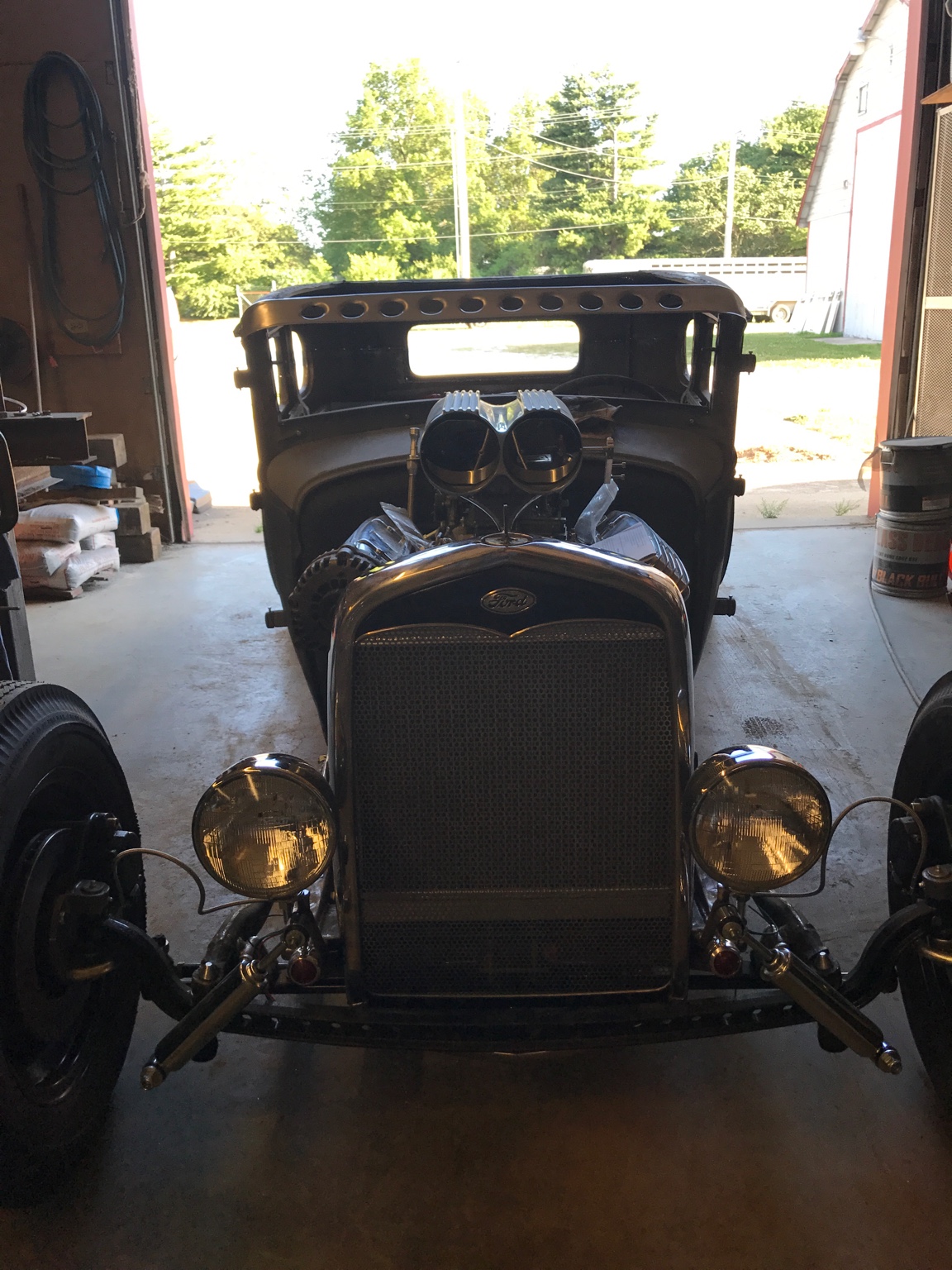

    I got the radiator mounted inside the shell and also get the headlights mounted. Redid the turn signals and they are now below.
    Then I started working on the deck lid. Skin had some bad spots so I am patching it up and will ****on it up in the next few days or whenever I can get back in the shop. For now just pics of the front
    [​IMG][​IMG]

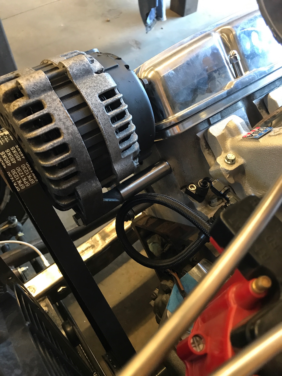

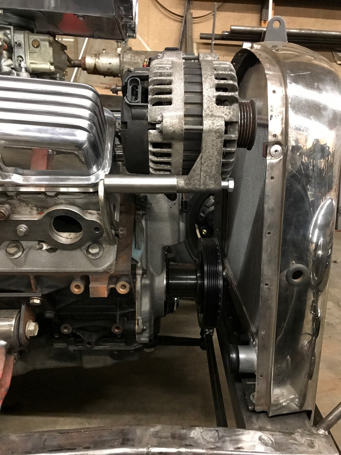

    I've been trying to help my dad with his 64 vette. Therefore not much time with mine. I have, though, been trying to mock the alternator and make an adjustable bracket. Here's what I have thus far.
    [​IMG][​IMG][​IMG]
    It may not show much. Basically it is going to have a pivot point and the other end will travel in an adjustable arc. It will also have a turnbuckle tied into the adjustable arc and anchored on the other end to provide tension duties. Should work well.

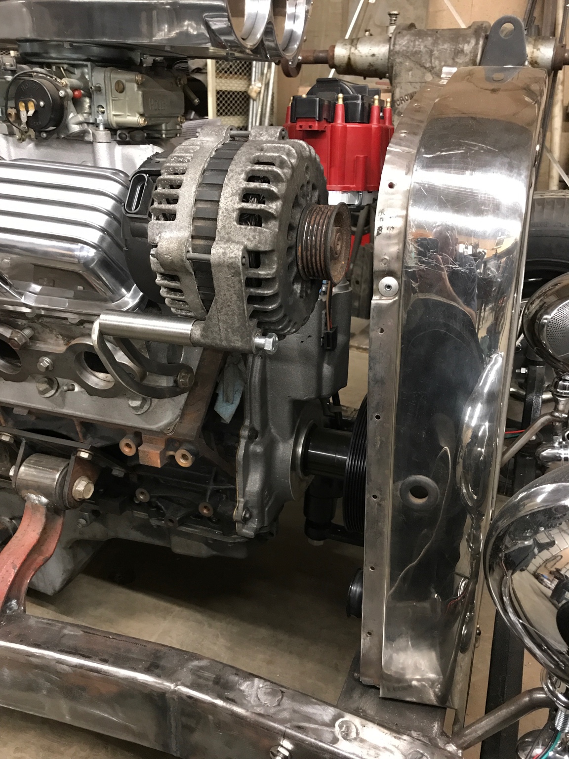

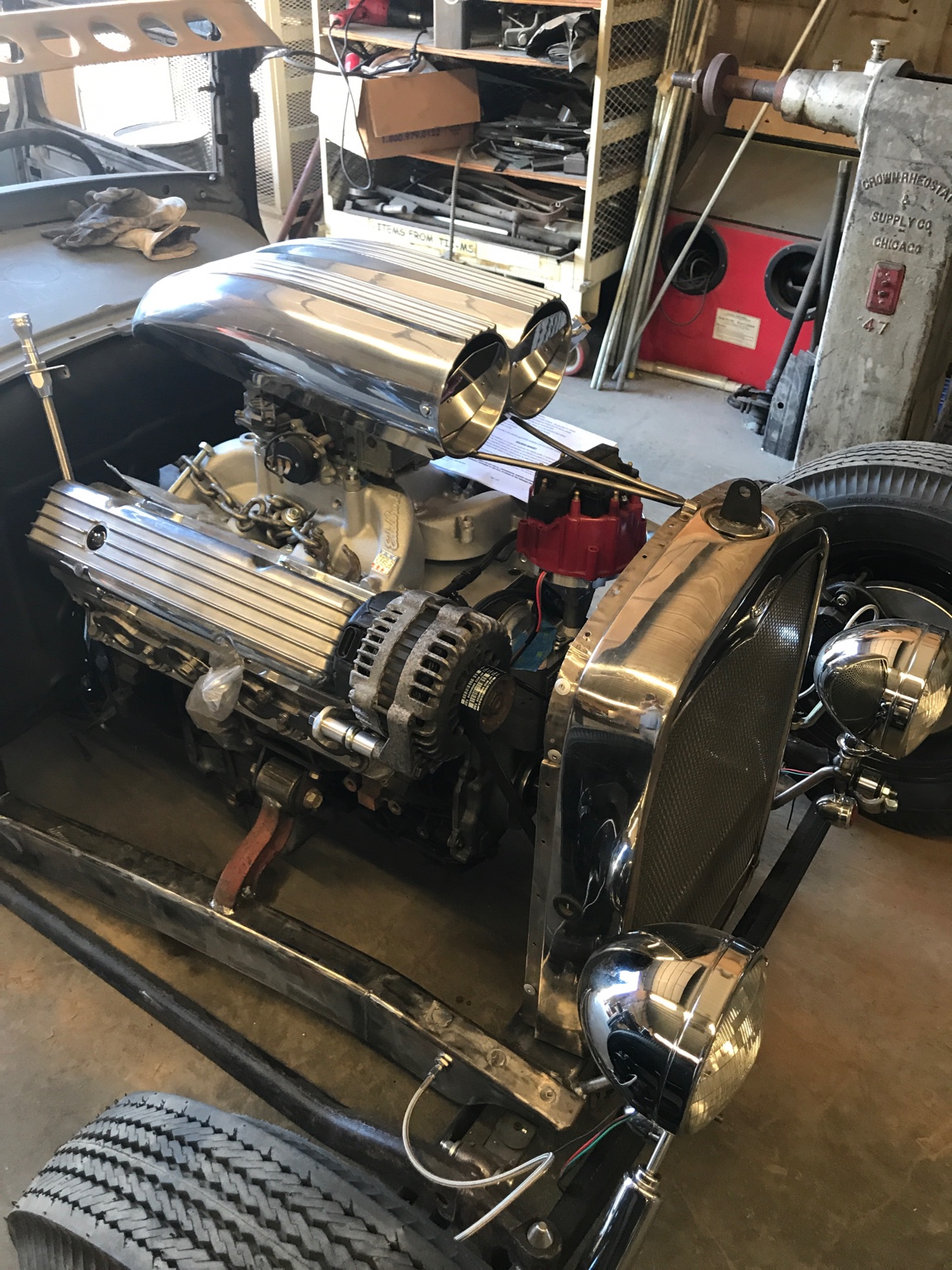

    Had a couple hours to play around. Remade the alternator bracketry. Also got the fan installed with a smidge of room to spare.
    I then made a support brace that holds the radiator in place. It mounts to the underside of the air intake. That was the only place it would work and still retain the lines I wanted. [​IMG][​IMG][​IMG][​IMG][​IMG]
    Next step is going to be headers.

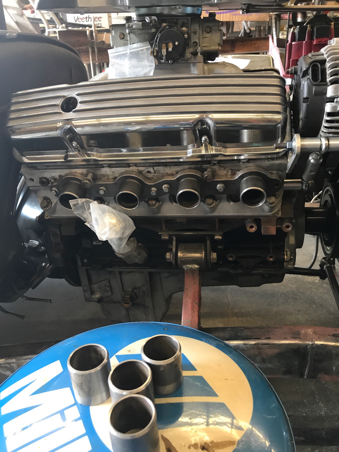

    I did get started on the headers.
    [​IMG][​IMG][​IMG]

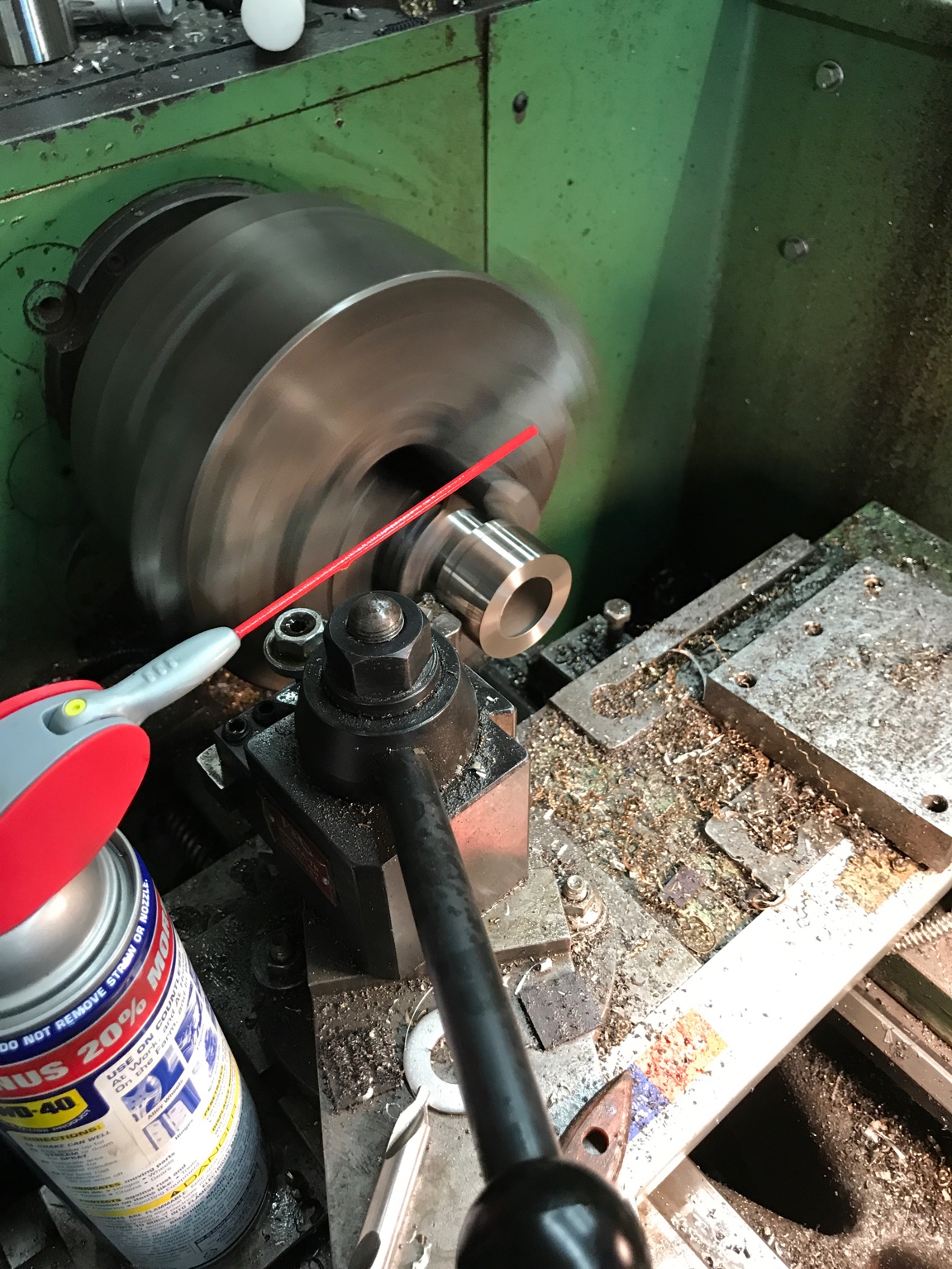

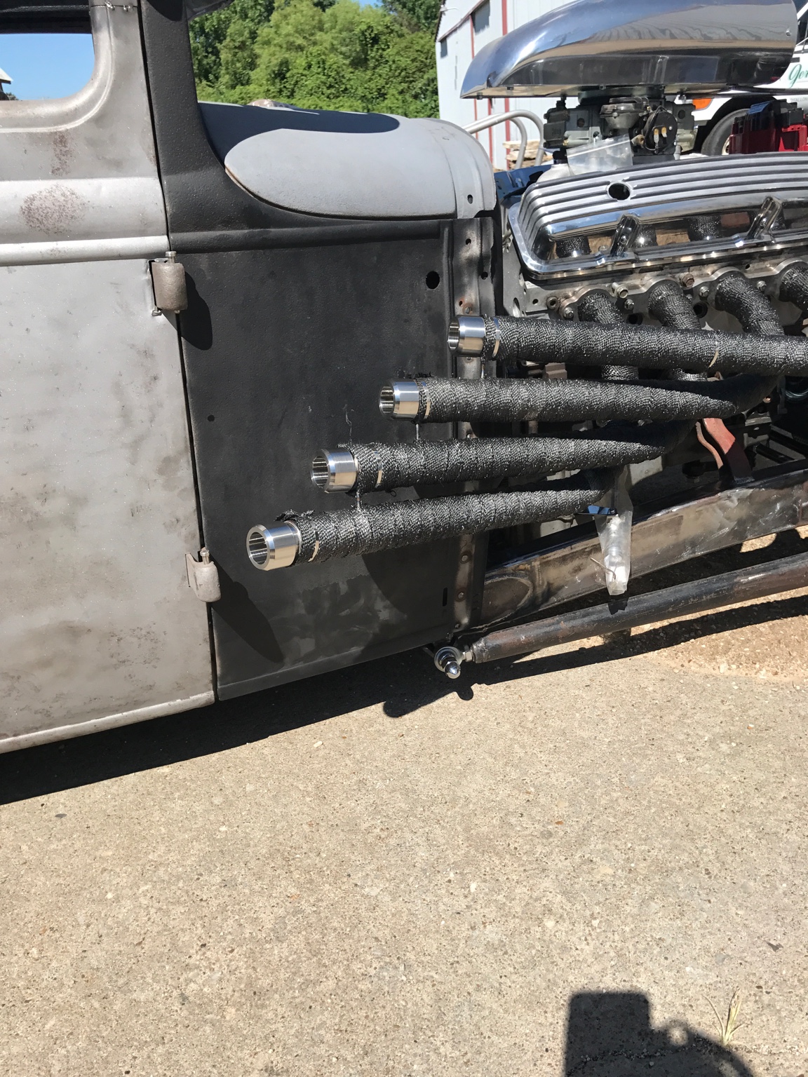

    Decided to wrap the headers since I didn't use SS. Just used what I had and they turned out pretty good. I then machined some end inserts out of SS to give the pipes some contrast.

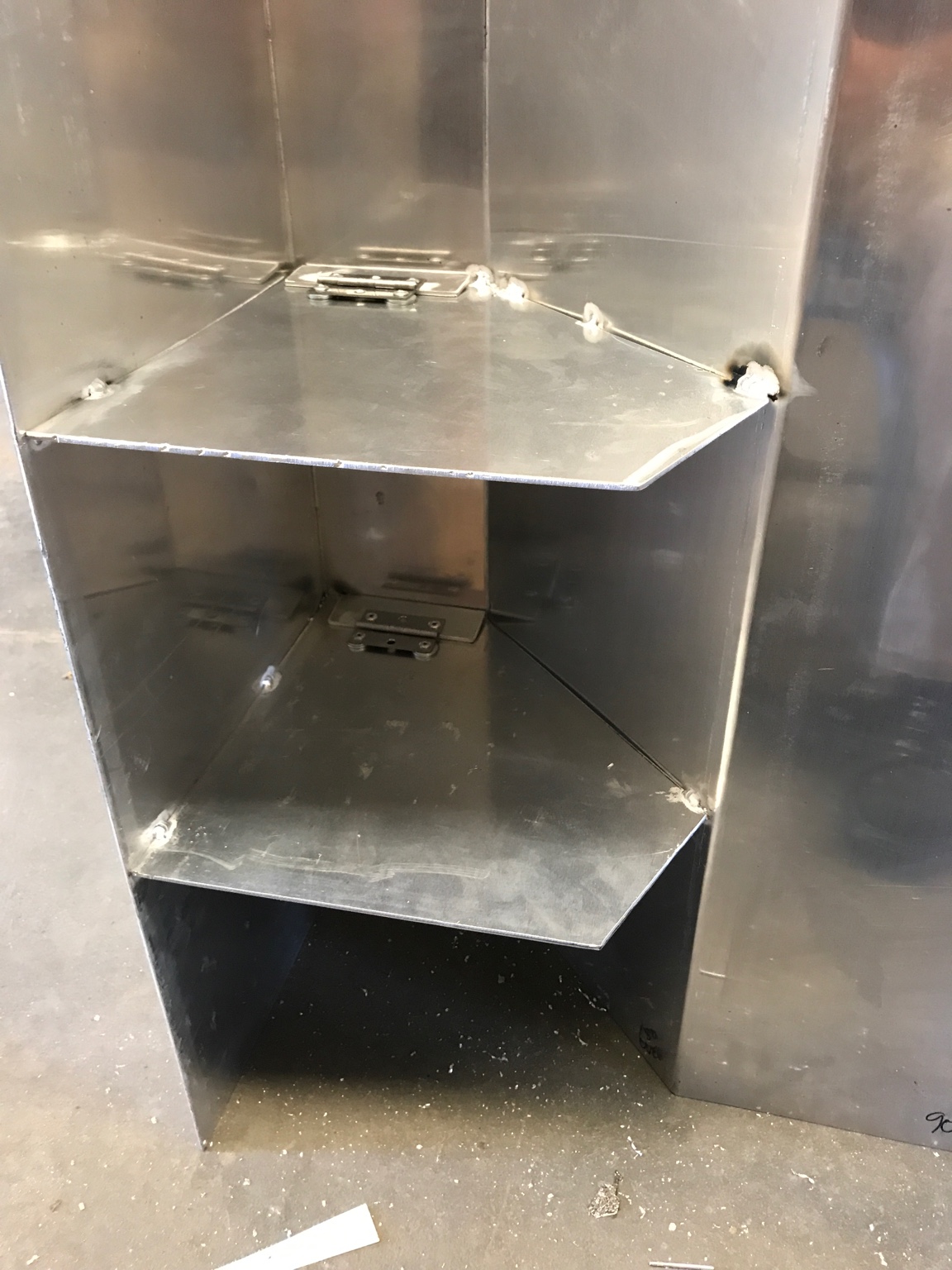

    I also made a "trap door" for the MC in the floor pan. Just need to cut the floor pan out to fit.

    Then I made a trap door to access the master cylinder. [​IMG][​IMG][​IMG]

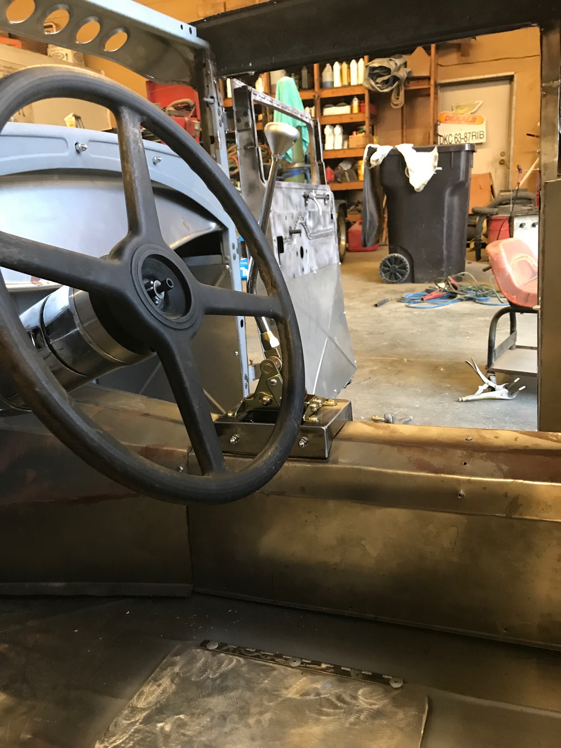

    Had a couple hours to get some stuff done at the shop. Made a little "saddle" for the Lokar shifter to sit on. Shifts nice and smooth.
    Also some poser shots of headers from above. Obviously need to adjust the toe in at some point[emoji50]
