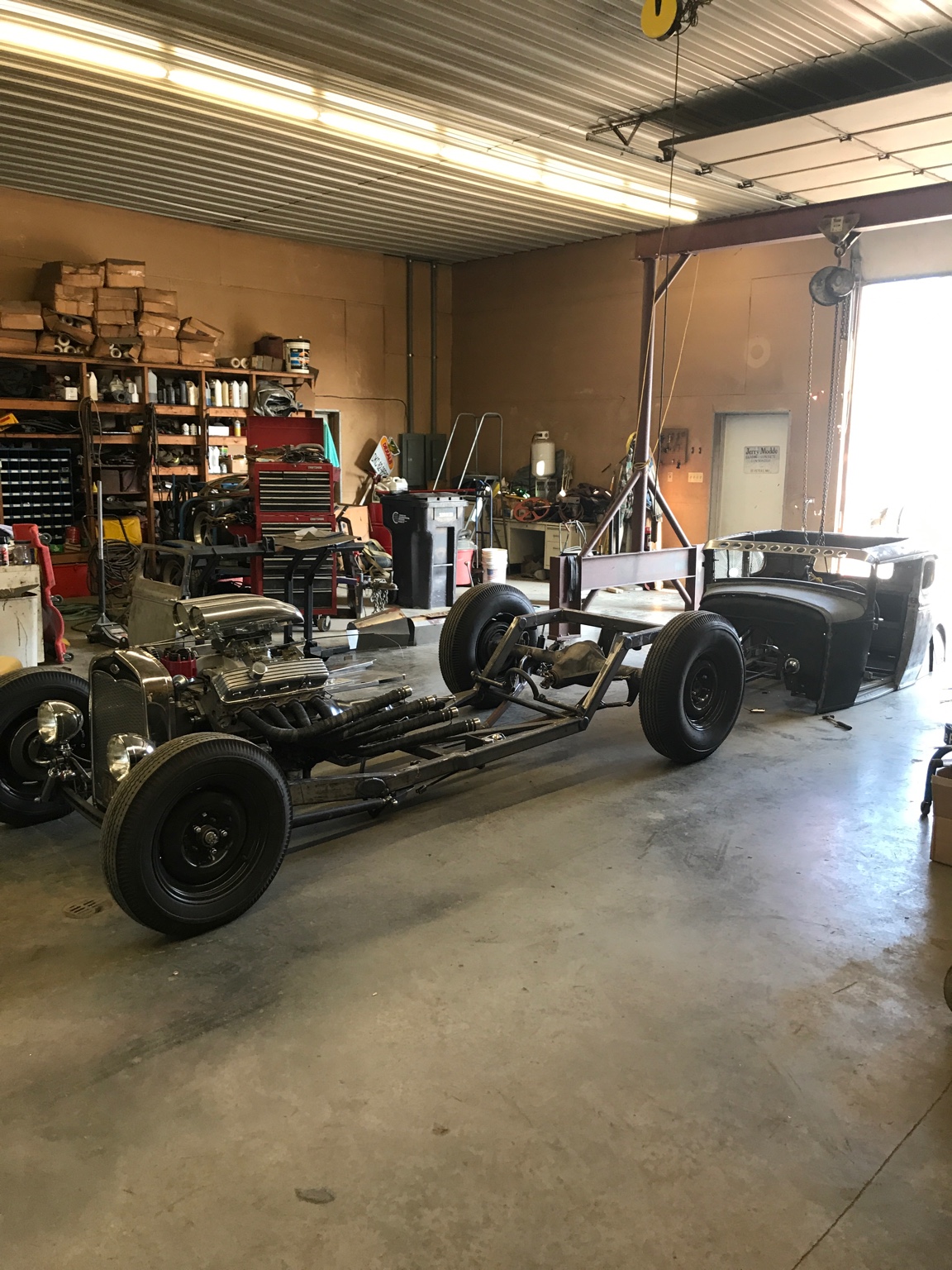

    Had a couple hours to play around so I pulled everything apart. Body's off, engine/trans out, and frame is just a roller.
    Going to start heading towards the finish line. It's a ways off but getting there.
    Put a new oil pan and starter on. With this motor I have some challenges with the water pump and routing the cooling lines. This set up requires a remote pump. Because this is not HAMB appropriate I will leave it out. If anyone is curious or wants to know more, PM me.

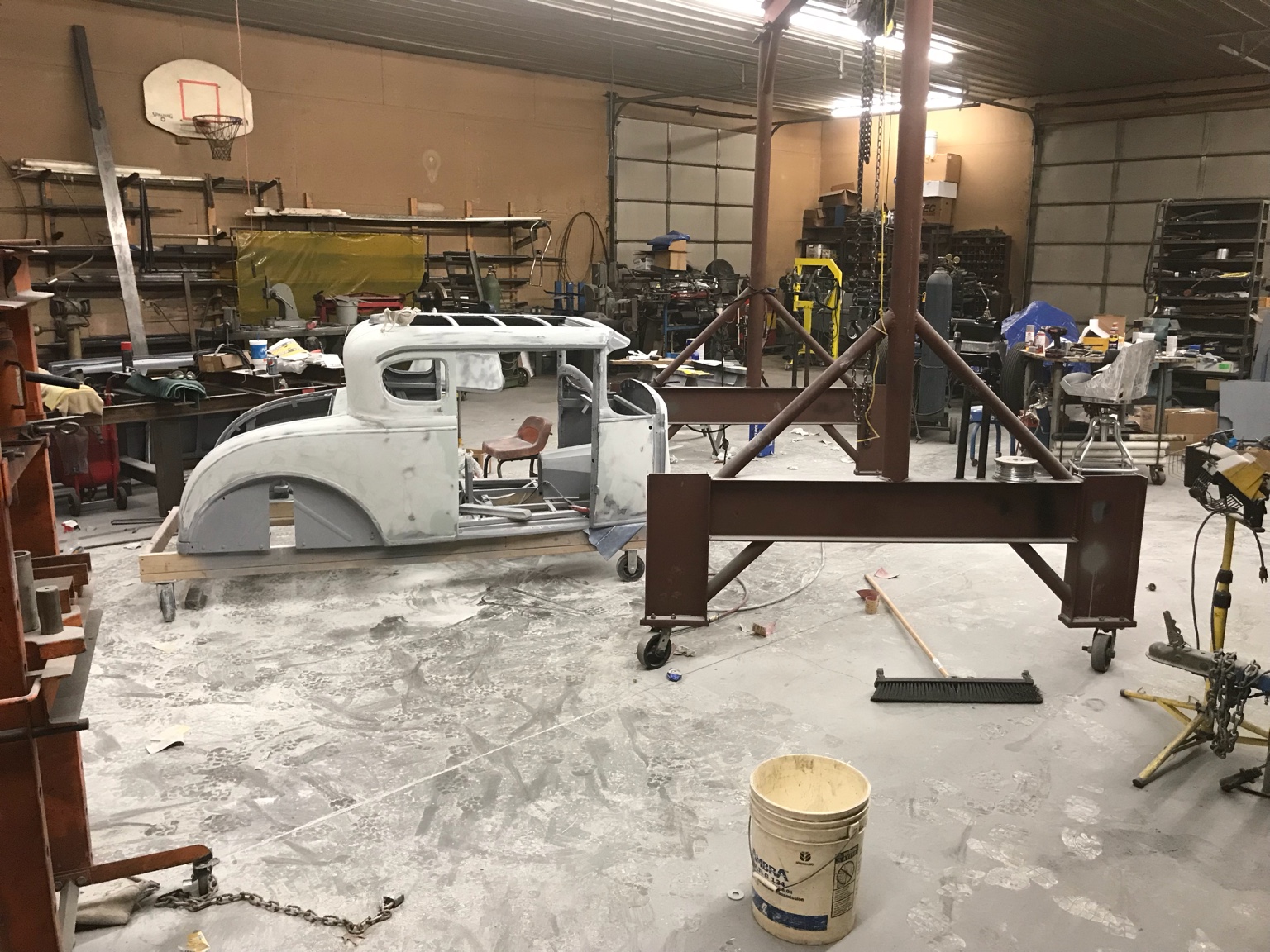

    Been awhile since an update. Pulled everything apart. Body, ch***is, engine and all components are apart. Spent about 13-16hrs building a cooling system for the water pump. Then media blasted everything except the body and prepped it for primer. Primed most of it this evening. Here are the fast forward pics. [​IMG][​IMG][​IMG][​IMG][​IMG][​IMG]

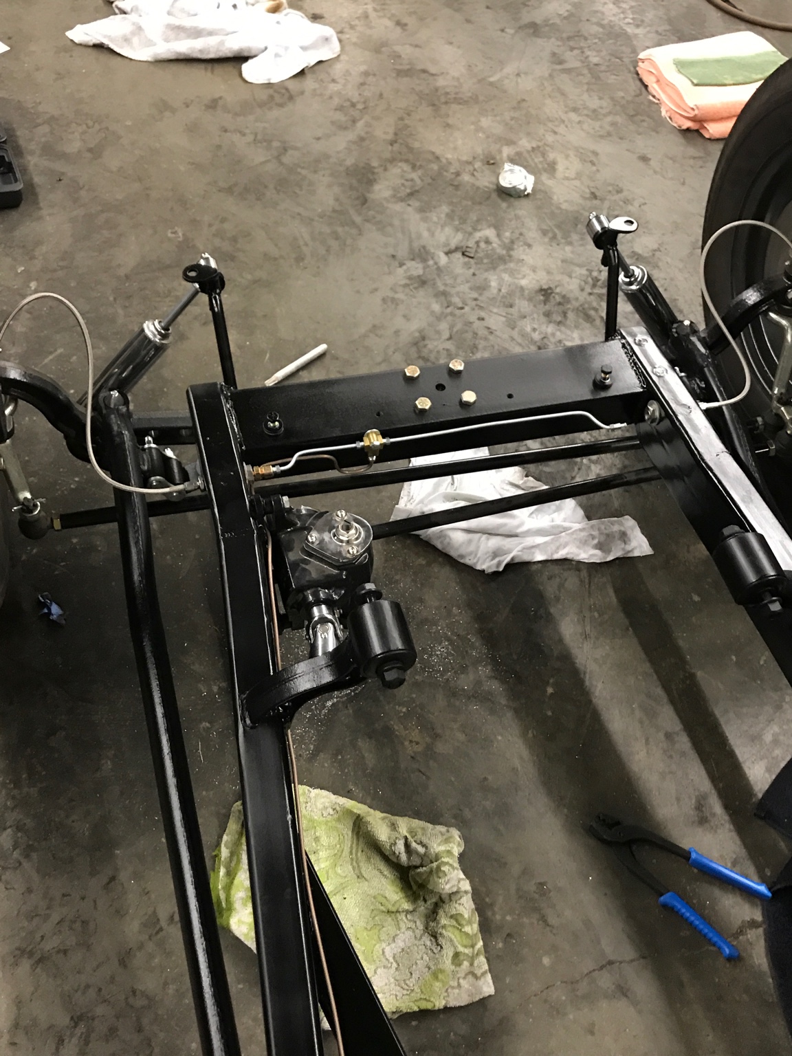

    Here is where I left off Saturday. Just started plumbing the brakes. Ran out of a part I needed and stalled. Plus I had a party I had to attend.
    [​IMG][​IMG]
    Sent from my iPhone using The H.A.M.B. mobile appi know in that last pic the steering geometry is not parallel. That is unsprung. With engine sitting in there the suspension and steering are all parallel.

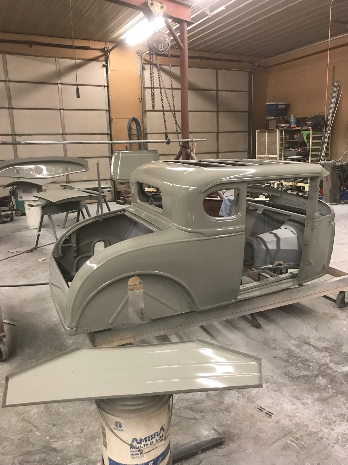

    It is hard to tell, but the color is much greener that the pic suggests. It’s almost a pale olive gray. I’m very happy with the color. I may add some accent black in places but for now I’m good. It laid down very good. I am no body or paint person. First go around but I’m very happy with the results. [​IMG][​IMG][​IMG]

    It is. Single stage. It’s a Mercedes Gray with something else added. It looks so much better than the pics.
    It’s dark now. I just hope it looks like what I hope it’ll look like in the sun[emoji15]
    If it doesn’t, **** it. I’ll re do it or just not give a ****.

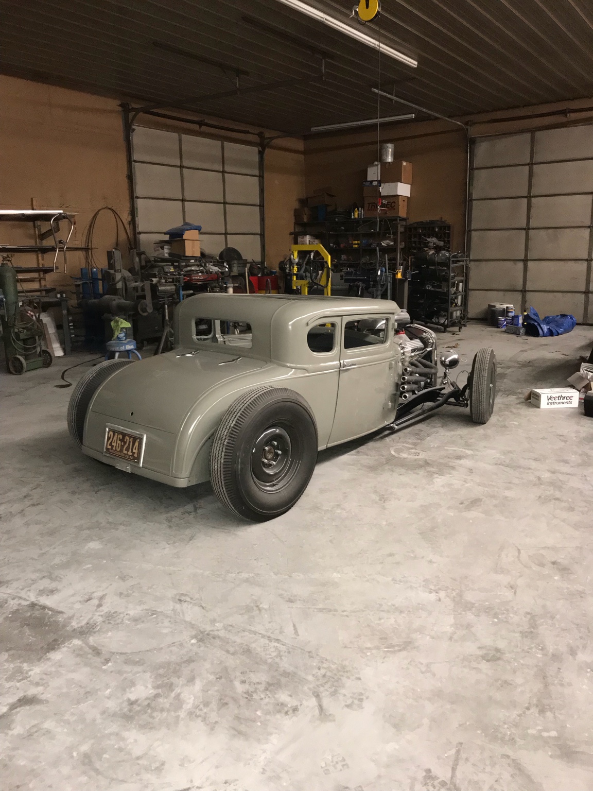

    Had to drop the body on and see it. I really wish I could get it out of the shop and in the sun. The light really make it look light. I’m happy with the results and will commence with wiring before too long. [​IMG][​IMG][​IMG][​IMG][​IMG]
