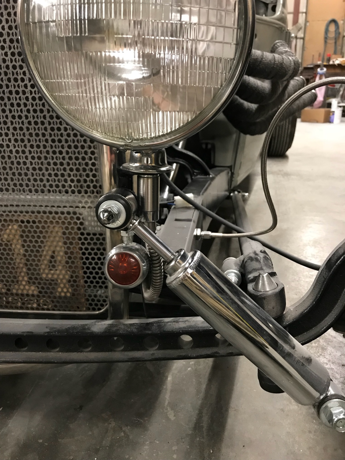

    Well, said I was going to start on the wiring but I had something I needed to clean up. The 1/2”x13 threaded light stud for head lamps is very ugly. I machines a threaded adapter to use with some vintage SS wire loom. [​IMG][​IMG][​IMG][​IMG]
    I think it looks much better than the exposed threads.

    How did you drill holes through the headlight mounting studs for the wiring?
    How do you aim the headlights?o_O
    Thanks!
    Dino 64 and jackalope like this.
  17. jackalope
    Joined: Mar 11, 2011
    Posts: 692
    jackalope
    The mounting studs already had holes drilled when purchased. Adjustability is via the swivel mount at the base of the light which also allows you to “nod” them up or down. Cheap lights but they do the trick.
    Hope that answers your question. If it did not just holler.

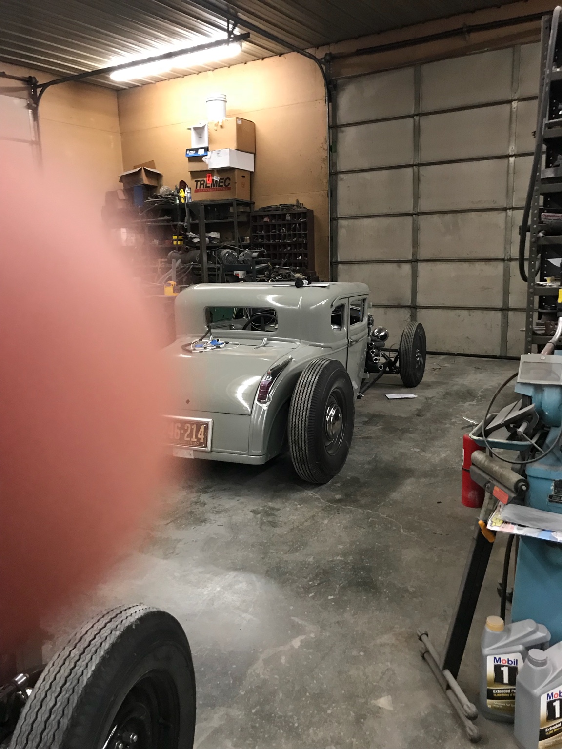

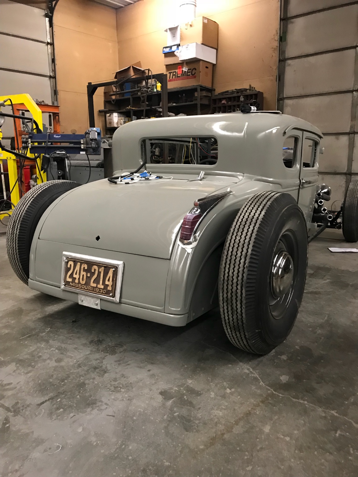

    In between wiring, a LONG time off working on her (holidays), and getting back to work, I have been him-hawing back and forth which tail lights I was going to run. I wanted something that was fitting but I **** at designing anything. At first I thought 49 Dodge or Oldsmobile taillights could look good. After some talking with friends they easily talked me out of that idea and now I am back to 59 caddy taillights. They will be mounted low between tire and body.

    I like ‘em ! [emoji106]

    Not a bad look! Crazy how the curvature fits the body.
    Certainly makes it uniquely yours.
