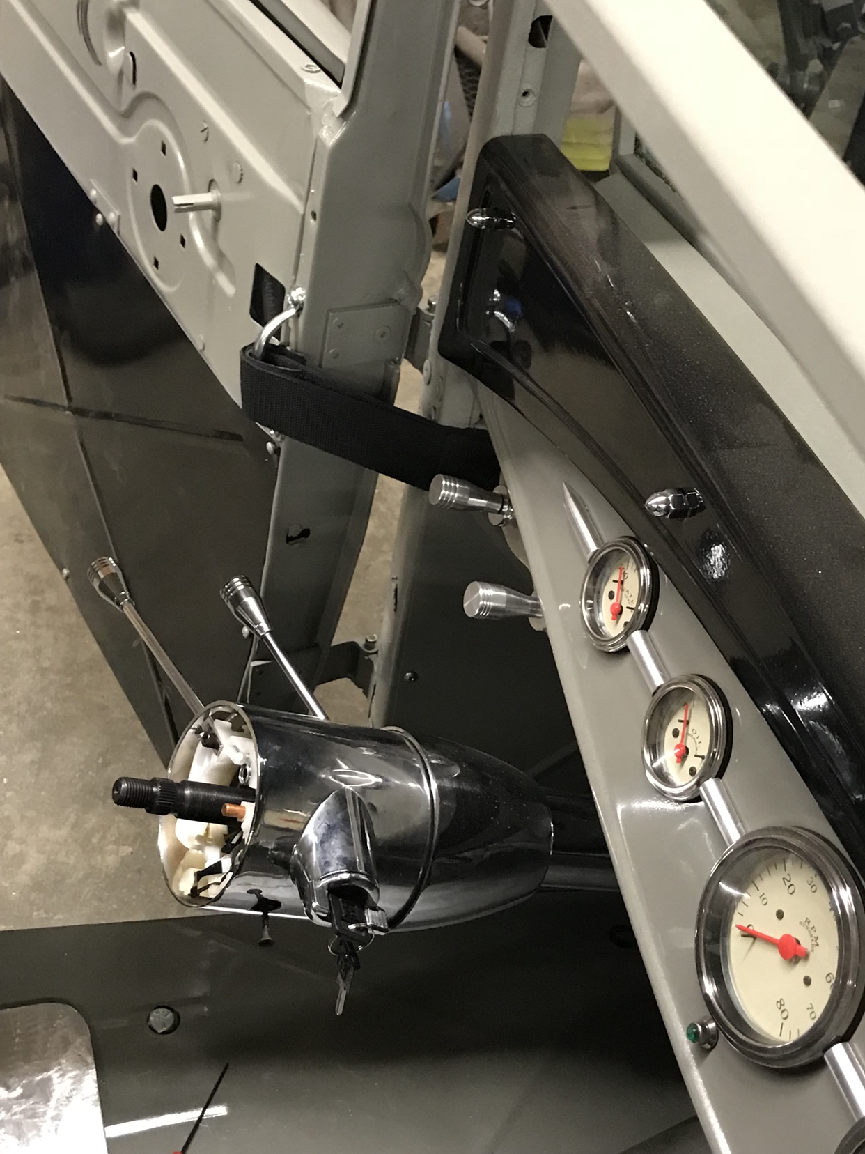

    Going with the 59 caddy. I figured a little less is actually more. The caddy ones take up the small space between wheel and body and mimic exhaust.
    In the pic they are not level as they are sagging. I am painting and then going to level ‘em out.

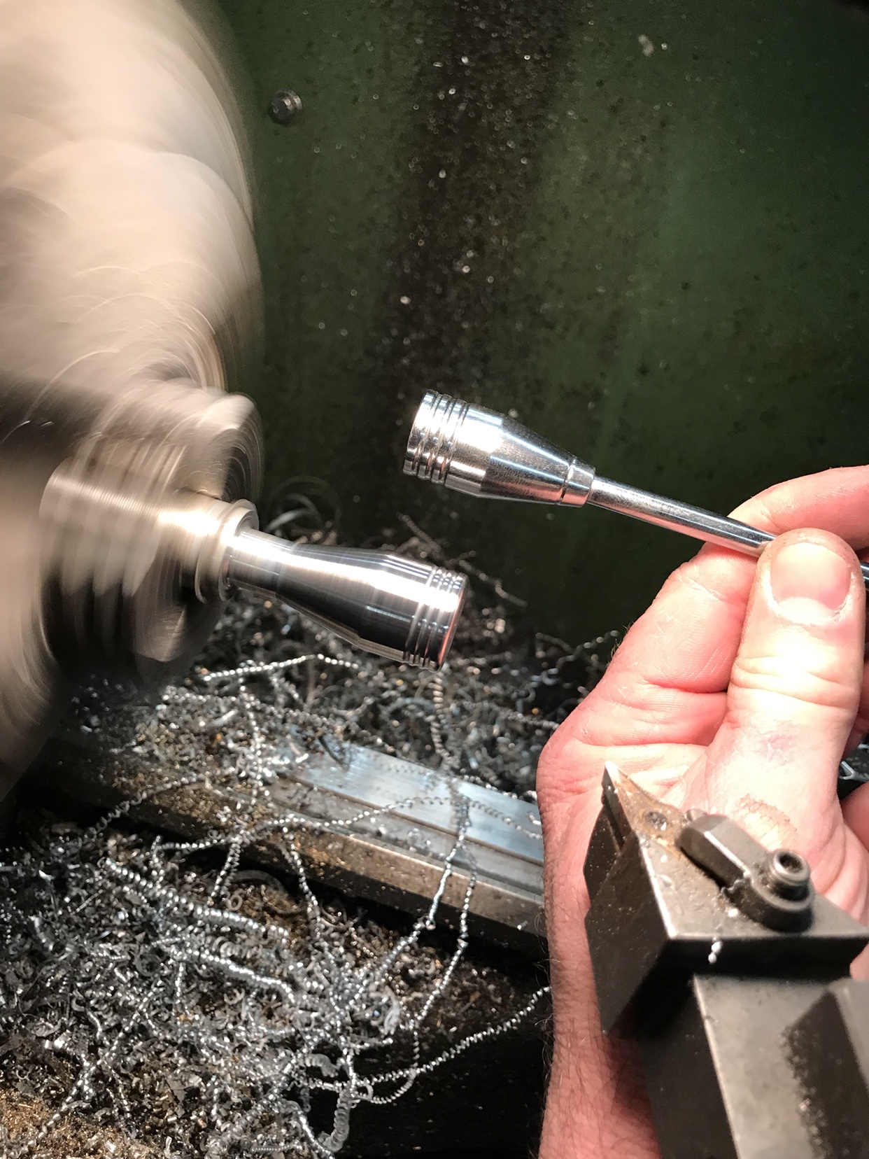

    Also had a chance to make some pull knobs so that everything matched. [​IMG][​IMG]

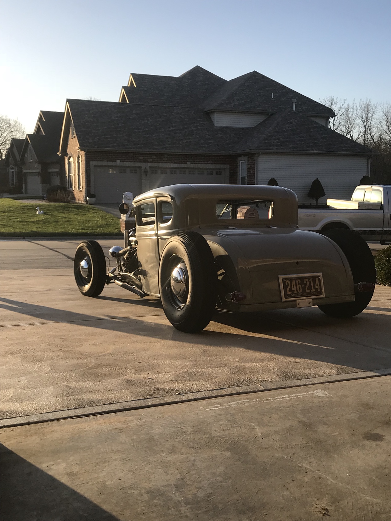

    A couple pics of the coupe that finally made it home on the ONE decent day we had. [​IMG]

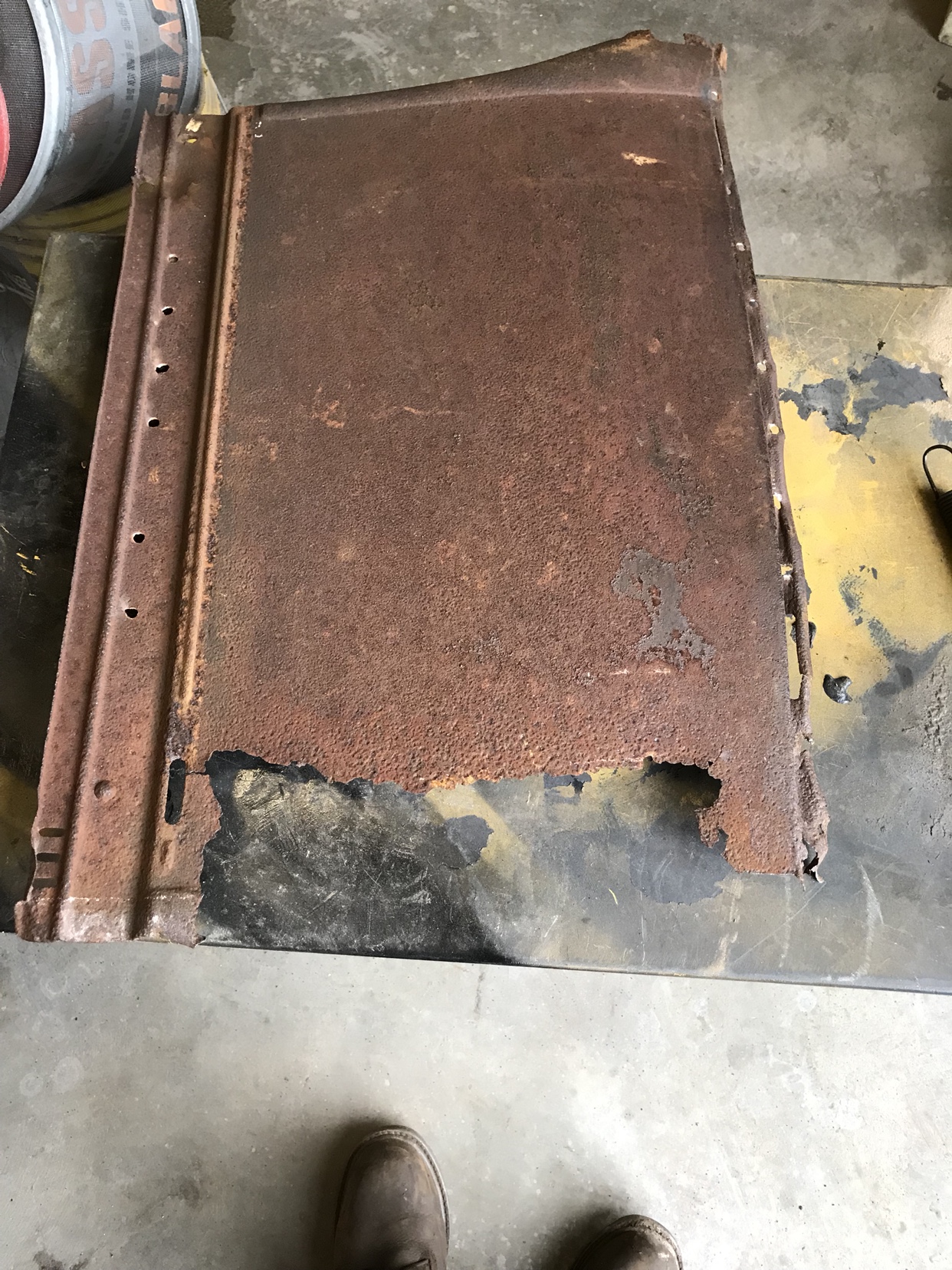

    Also got a start on the next project. Build #3 I need to find a name for it. It’ll be a separate build soon to come.
    And the buried coupe that I drove all the way to Colorado for has perfect patch panels.
