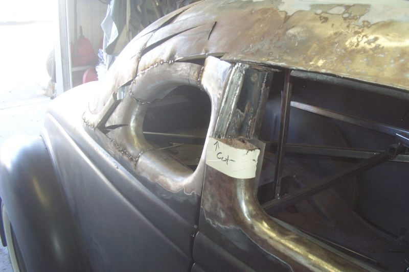

    must admit im quite surprised as to how good the back actually looks with such a heavy chop. keep up the good work and the pictures coming!

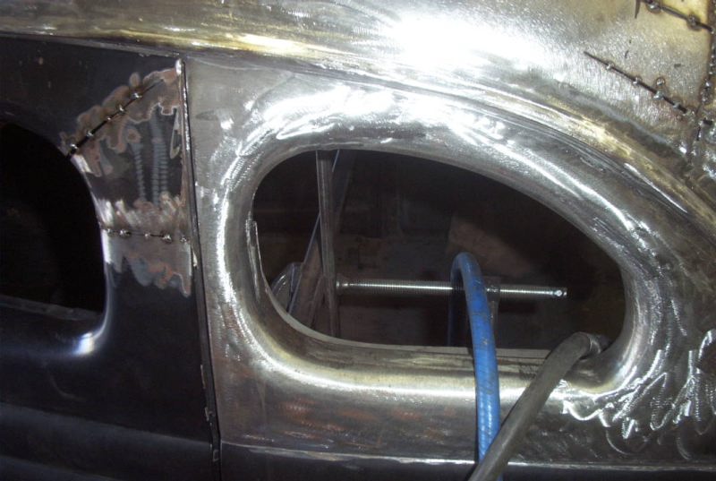

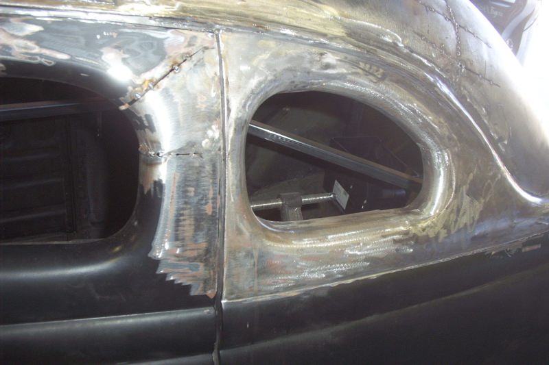

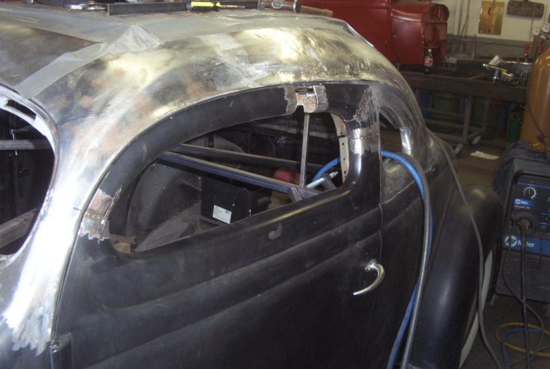

    We got a lot farther on the chop today. We got the quarter window on the driver side ****oned up and started on the driver door. All in between cleaning up the shop for our open house on Sunday. Thats it for now here's the pictures. Thanks Scott

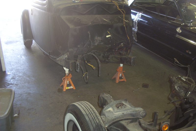

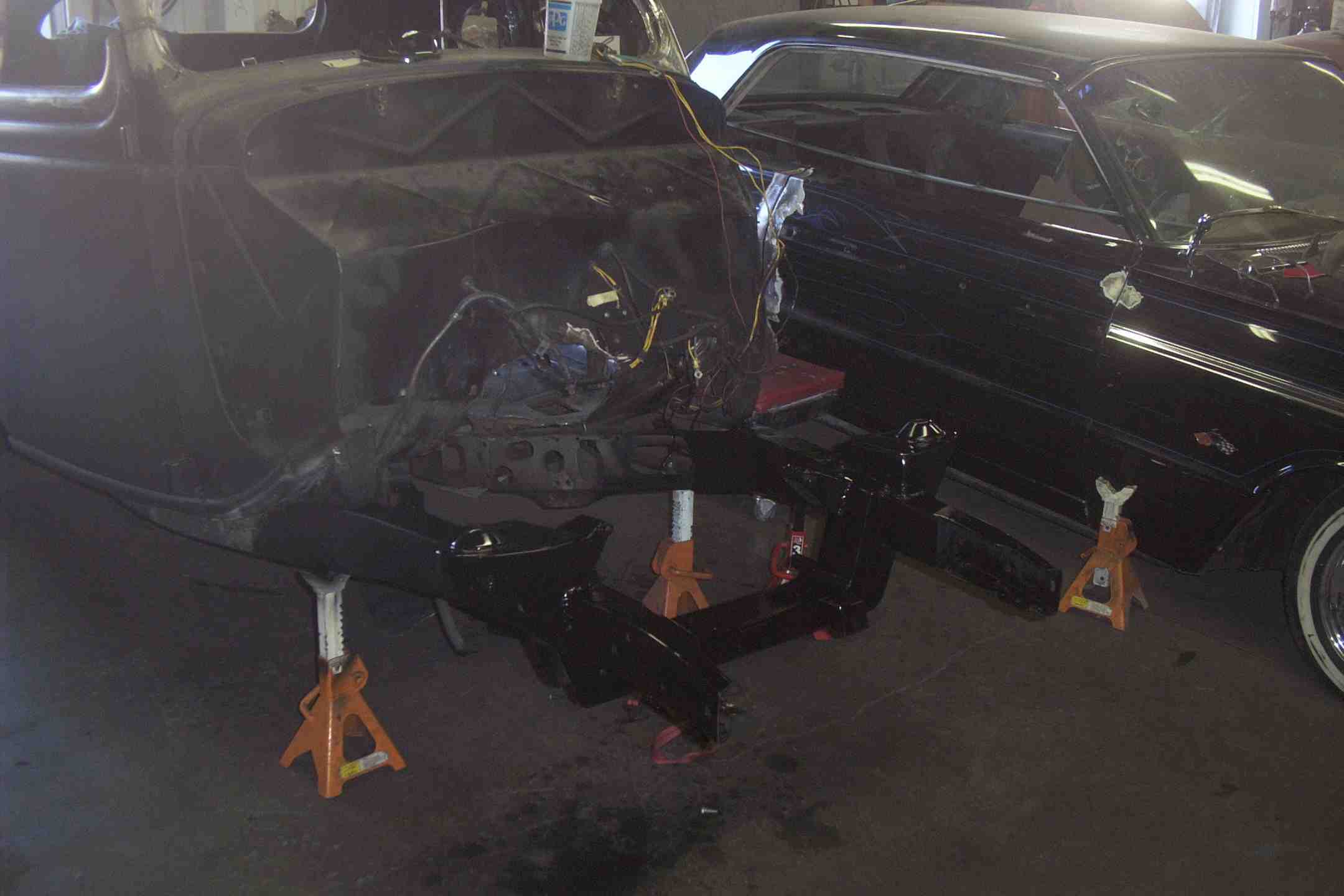

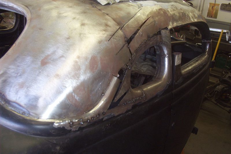

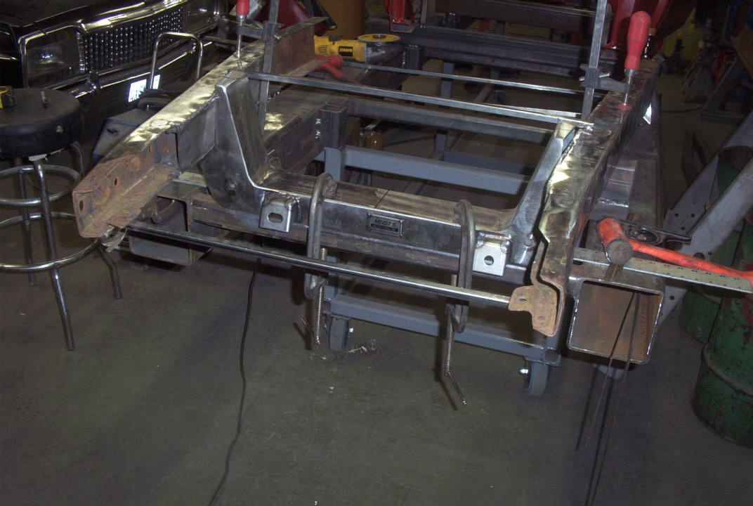

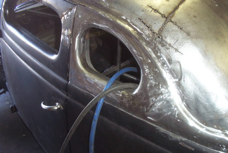

    We got alot done over the weekend and monday. The driver side of the quarter window is finished and the right side is about 1/2 way done. Sunday we had our open house it was cool we had a good time i will do anouther post about that though.
    Today I tached in the new crossmember in the new frame. Than cut the camaro clip off the old frame. The rest of the day was spent gringing and fitting the two frame sections together. So tomarow they should be one again. Thanks Scott.

    just a question, but, is the rear window getting chopped a little?..... I'm not questioning your design, I think it's a cool idea to have a rear window in a chopped car that you can see out of. but since the other windows are so obviously heavily chopped, that stock height rear window seems a bit out of place....... I know this reads a bit uppity, believe me I'm not trying to be that way......

    Yes we are plaining to chop the rear window. But I wanted to have all the outher window openings finished up be for I decided how much. I want to cut out around 2" we will see what looks the best. Thanks Scott

    Most likley we will have to some thing about the wirring. It looks like they were having a sale on yellow wire when you look under the dash. All the brake lines to the front have to be done. We are planning to replace the fuel tank and the line looks a little crusty. So yes to all of the above. Scott

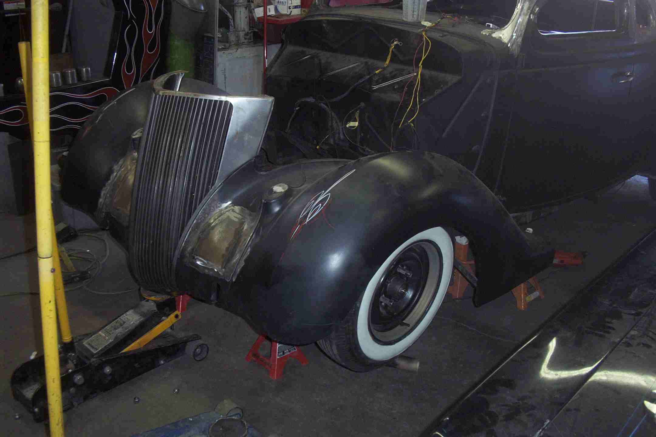

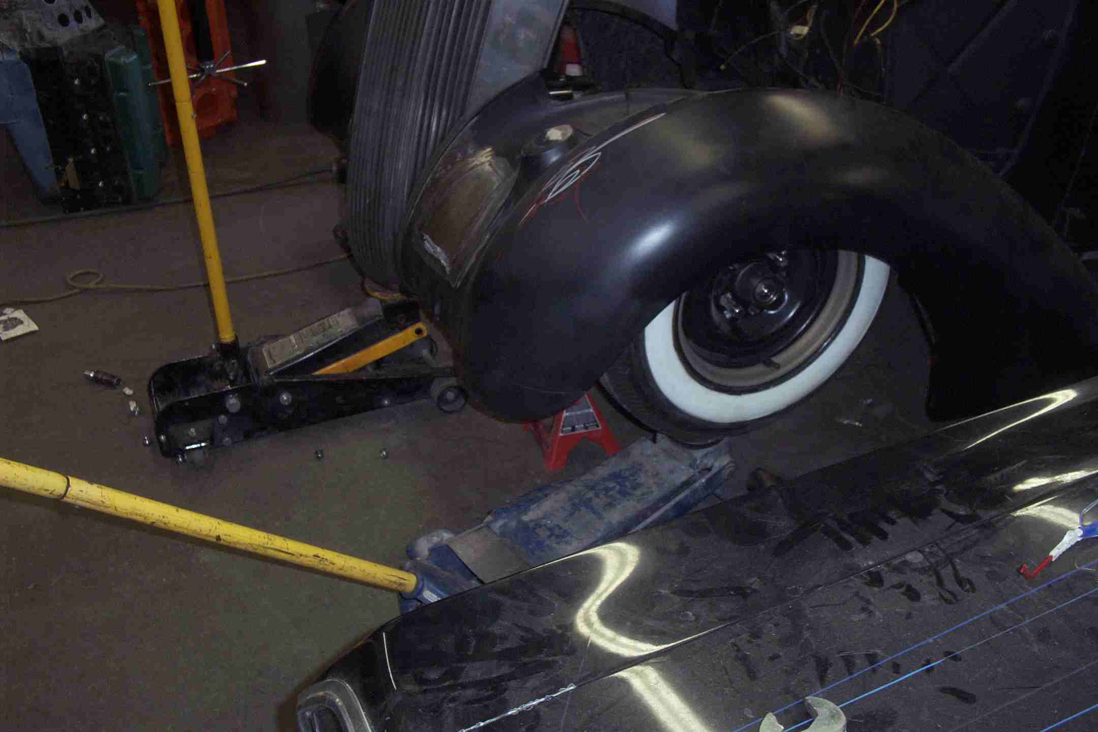

    Today I welded the front clip back on the car and checked that it would go low enough. Phill worked on the pasanger side of the chop. the chop is getting close to done we hope that not much later than monday we will be on the garnish mouldings. Tomarow I will be on the motor and trans mounts and finishing up the front end. Thats it for tonight. thanks Scott

    There was a camaro subframe in the car. So I had to cut that out. Because the car would not go low enough. Scott

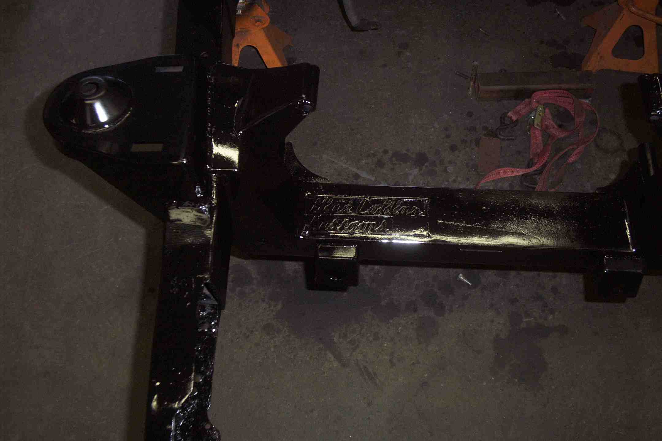

    here is todays pictures. we got the front end and motor mounts finished. Tomarrow Phill should be finishing up the chop. I will be on the c notch and four bar set up.I think we are right on track to finish by Paso. Scott
