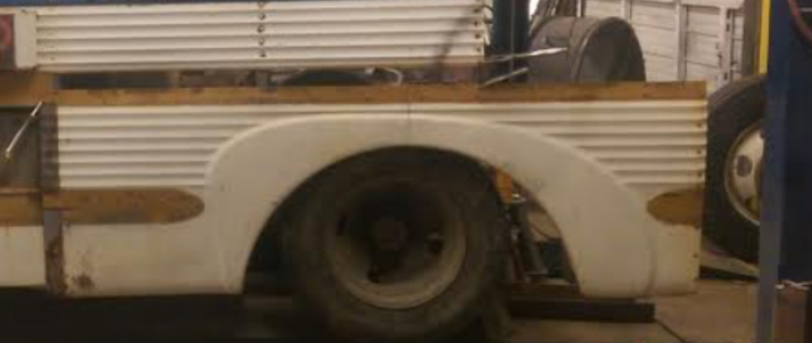

    I see that you also shortened between the back and the wheel opening...
    Did you have the high school army help you?
    I'll probably be by myself again,just my gantry,cherry picker and basic tools..

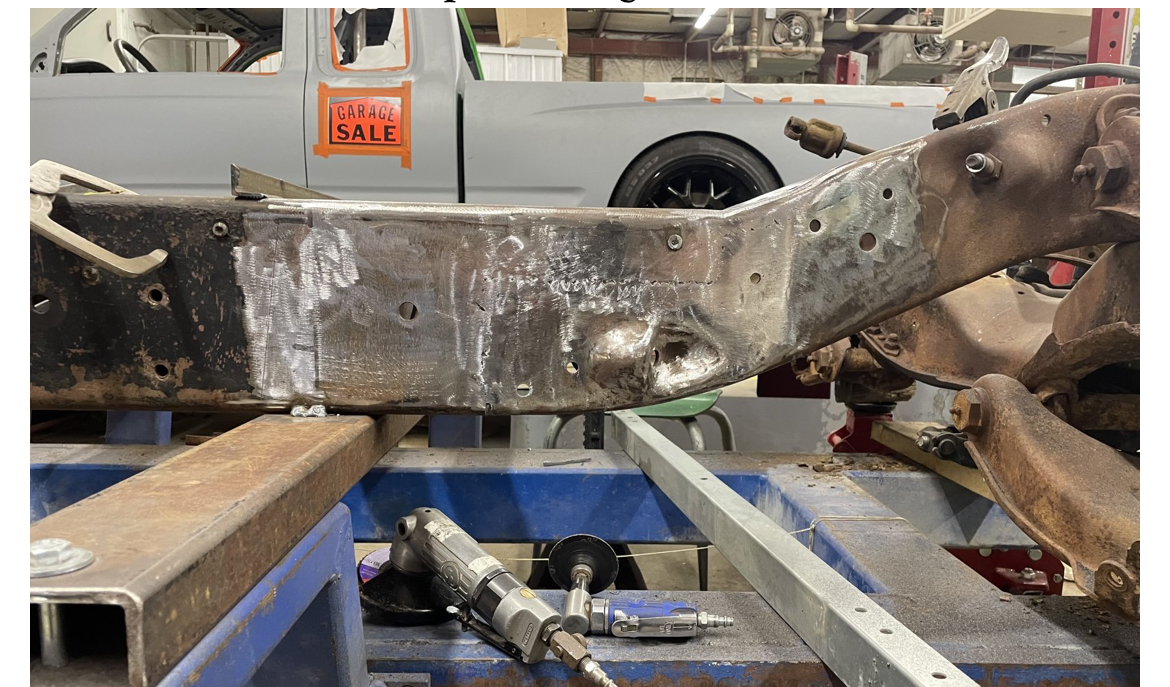

  11. Here’s a c10 graft to a 57 Chevy van ch***is
    Will plate the inside.
    The c10-c30 ch***is are 34 inches wide at the cowl area. Makes an EZ graft on an old ch***is.
    The track with is probably a good bit wider than stock on your bus though.

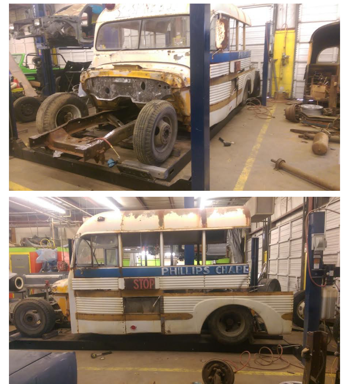

    Ours stayed on it ch***is. So that helped a lot. We chose cut locations, removed the not wanted section then the ****.
    It all went back in factory seams. We removed the factory wheel tubs as well. once the body was put back together we made tubs and the rear floor from new 14 gauge. Also built the floor around the frame notch.
    we put the floor back together like the factory. Just with the step and deeper tubs

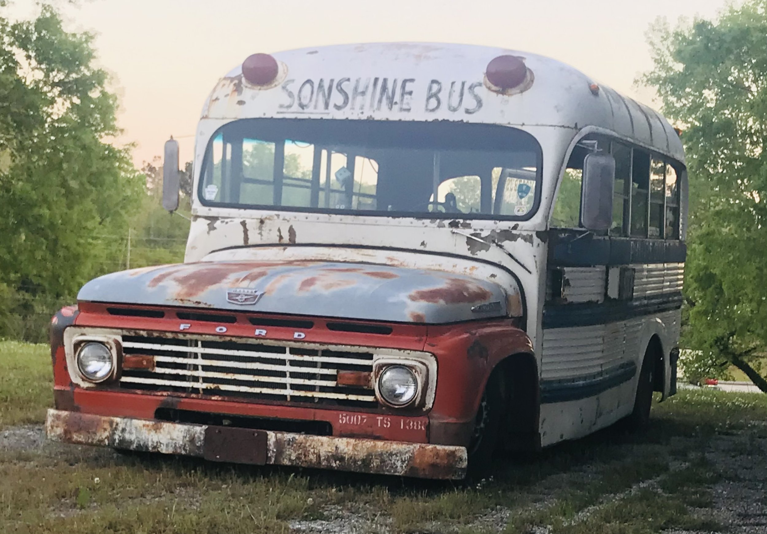

  23. Front suspension on mine is Zd 4 inches into the floor.
    3 inch drop spindles and one coil cut.
    Add that to the front tire diameter difference and repositioning the front bumper. My fenders were 3 -4 inches higher than the bus body. So we extended them down along with the bumper.
    The front bumper height is 14-16 inches lower than stock
