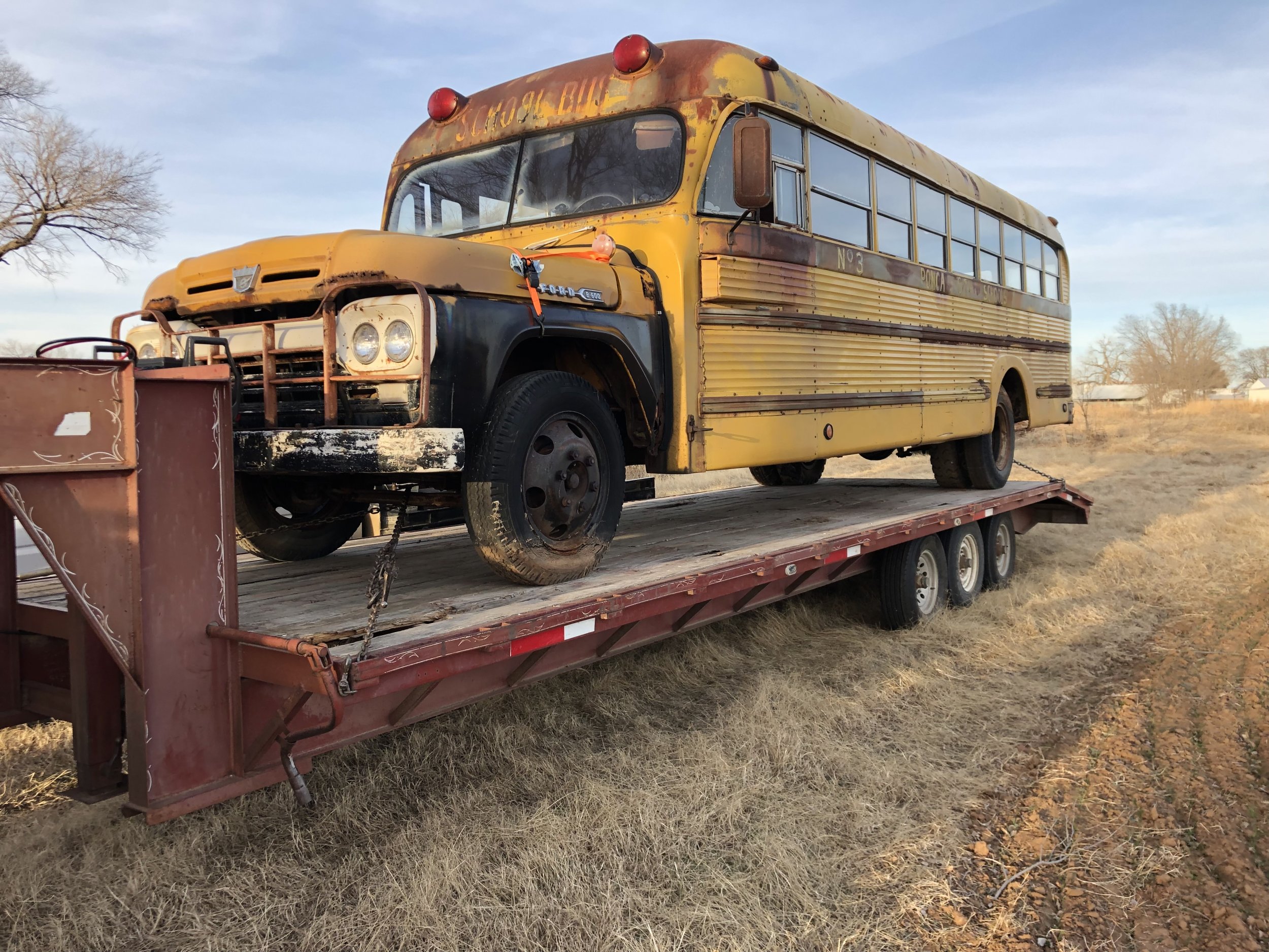

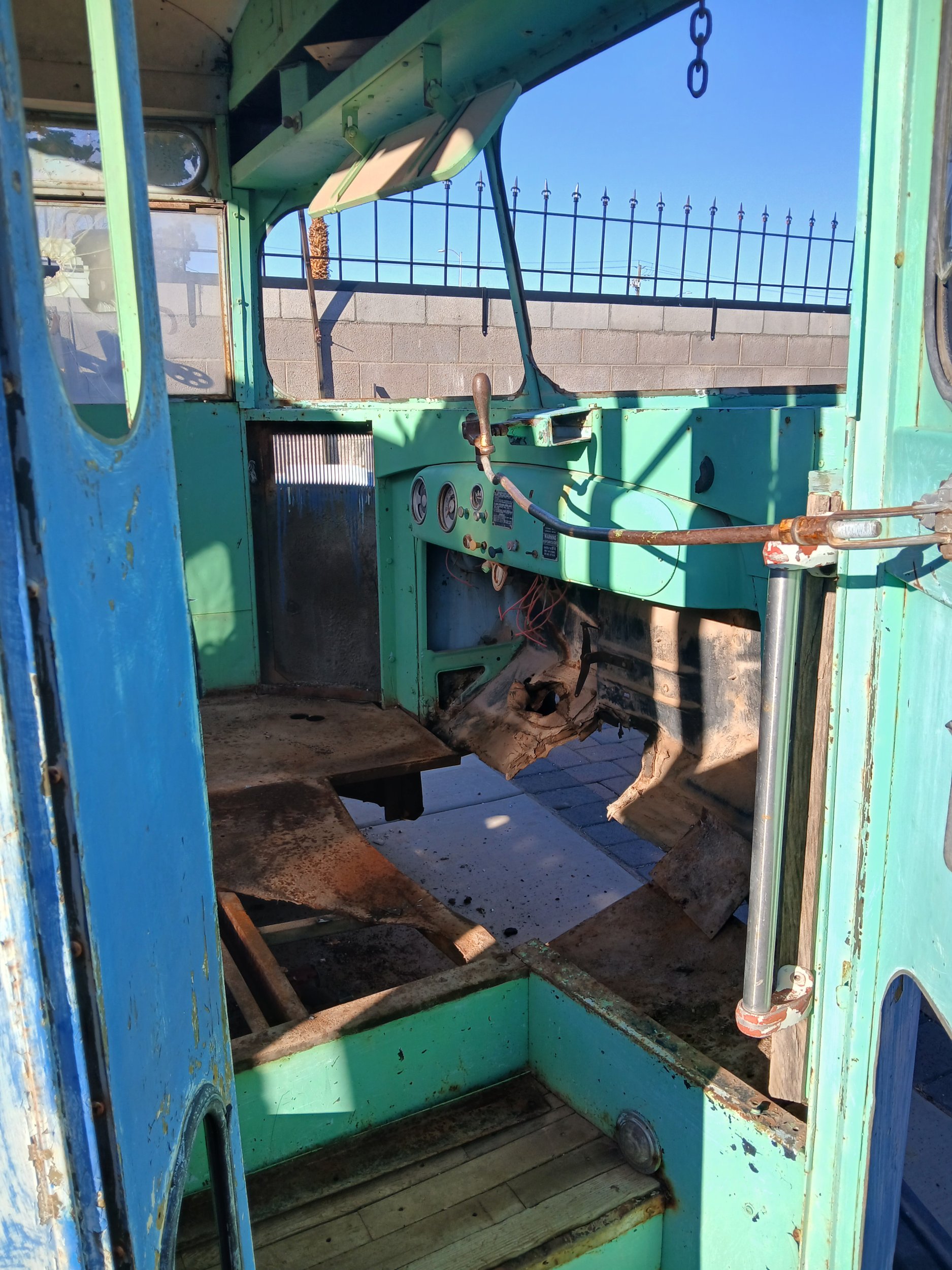

    IMG_0512.jpeg I hauled this home a few years ago. Saved it from the s****per . I missed two shorter mid 1960’s IH buses . Had big plans but things changed

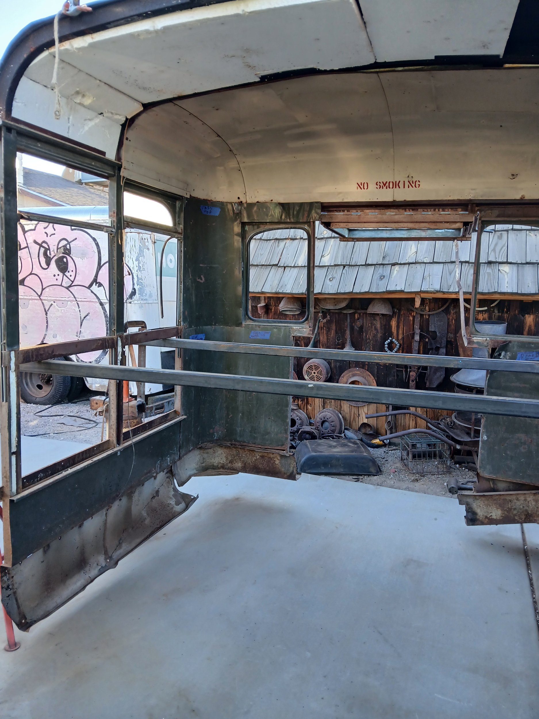

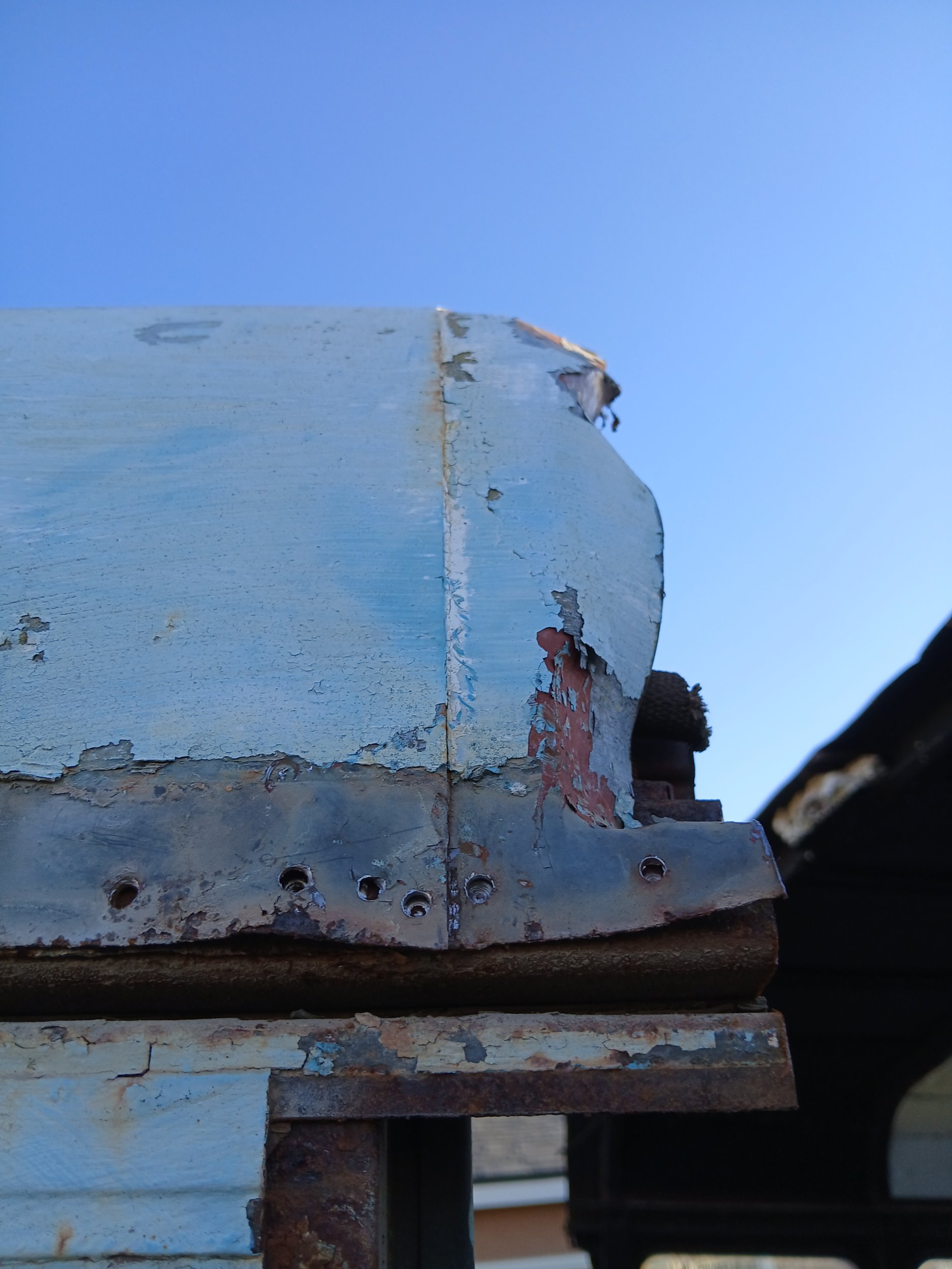

    Do you recall if the upper shell was spot welded?It was a major B.i.tch today,between rusted clutch screws and some Vegas heat.
    I had to make a special tool since all my cheap clutch bits were pure shiiiit..
    Anyway,little wins in this upper hill battle. 20251008_165711.jpg 20251008_165702.jpg 20251008_171507.jpg

    Do you recall if the very top sheets are spot welded to each other all along this seam? 20251008_171508.jpg
  10. Mine were riveted but the drip rail was welded
  11. iwanaflattie
    Joined: May 14, 2011
    Posts: 4,190
    iwanaflattie
    I found tons of little spot welded around the seam,im not looking fwd drilling those mofos out.

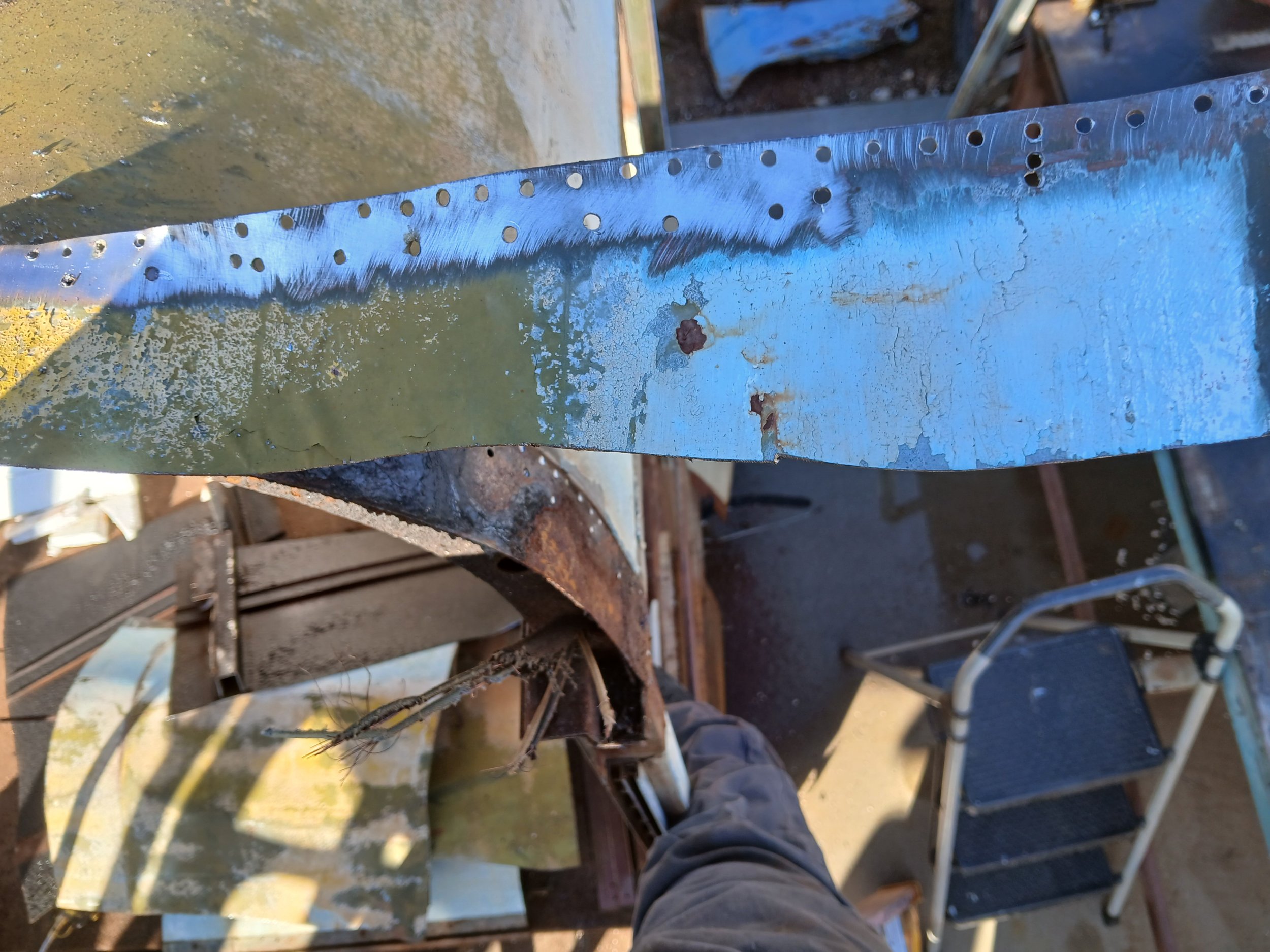

    Here you can see how many little *******s I have to drill,to get the roof panels.

    I didnt know that about them buses,it's only taking 10 seconds per,there's just lots of them..
    How long does that stay sharp??
    I always used screwdrivers or paint s****per/cutting tool
    Sharpone and Okie Pete like this.
  16. I’ve had great luck with mine.
    Drill the center of the weld, bust loose with this chisel.
    Super thin. Less metal distortion

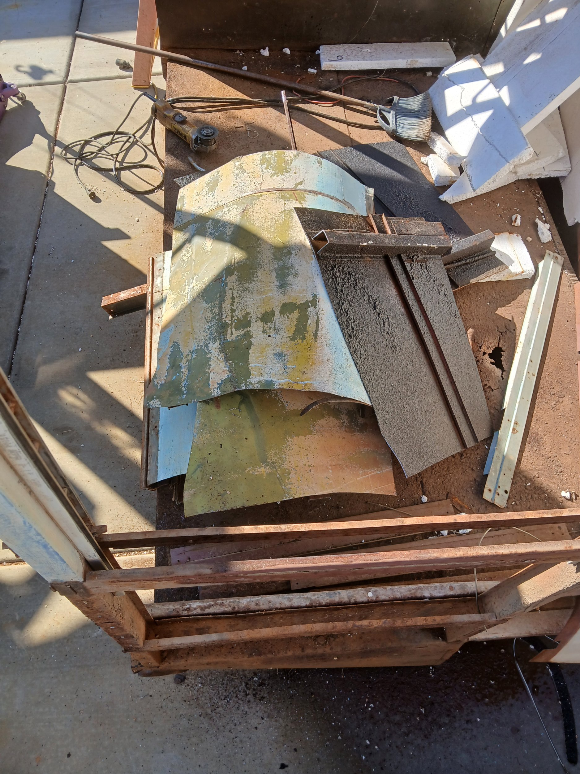

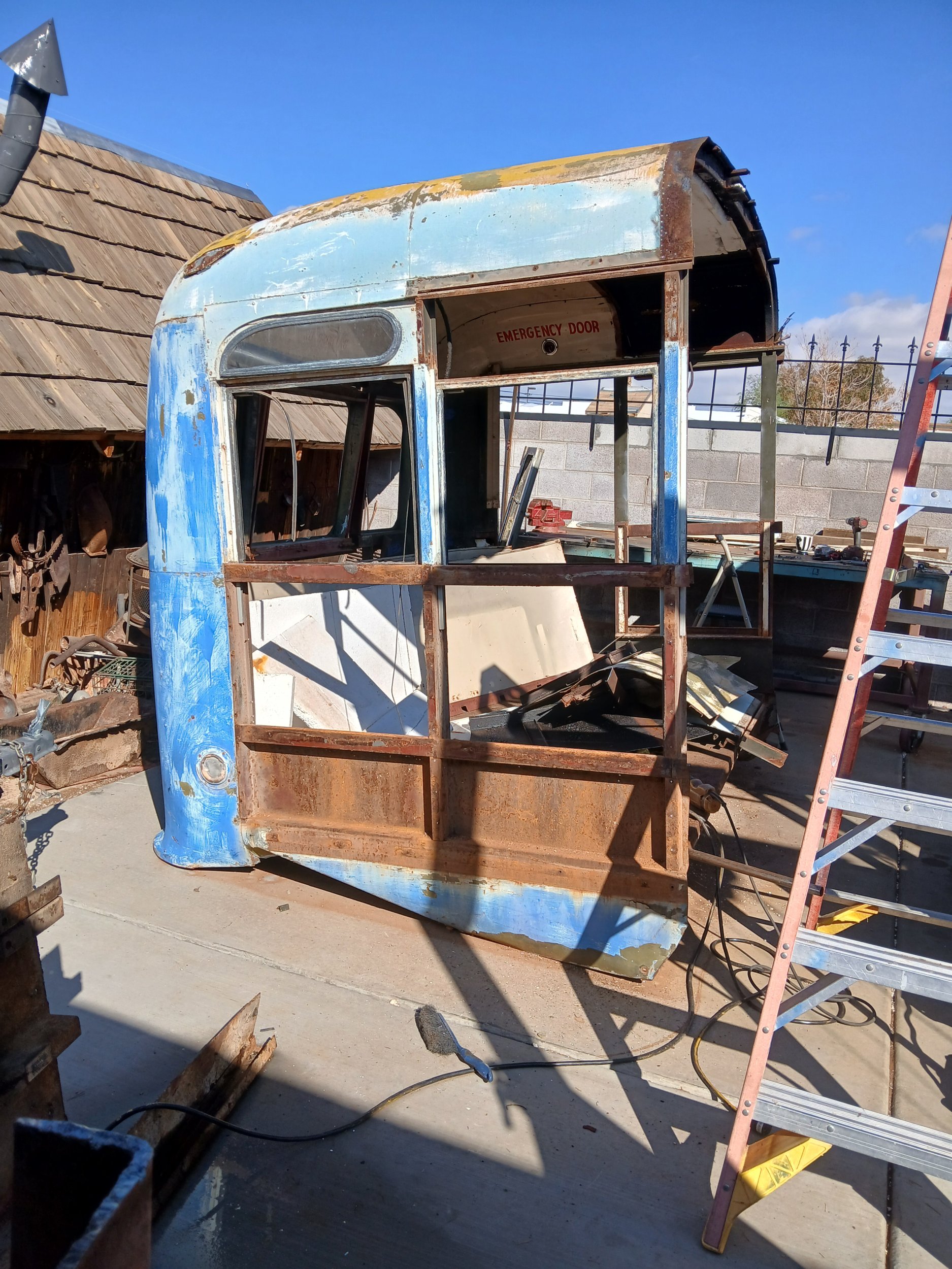

    I was able to remove the piece of roof panel where it was cut and over lapped the next roof panel.. 20251011_095250.jpg
    Yesterday I cut it off before the rain started.
    The day before I had to make my own clutch screw bit..
    I just ground off a random bit to size and I built an extension to a 1/2 ratchet(1/4 socket to 1/4"to 3/8"adapter to 1/2 adapter)
    Hammered the custom bit to the clutch head,insert ratchet,kept pressure tighten really slow,break rust then back really easy..it worked awesome...
    It was in a really tight spot where 2 screws hold the panel for the top oval windows.
    Most of the little windows and most of the full windows are out..
    This is gonna be expensive on gl***..

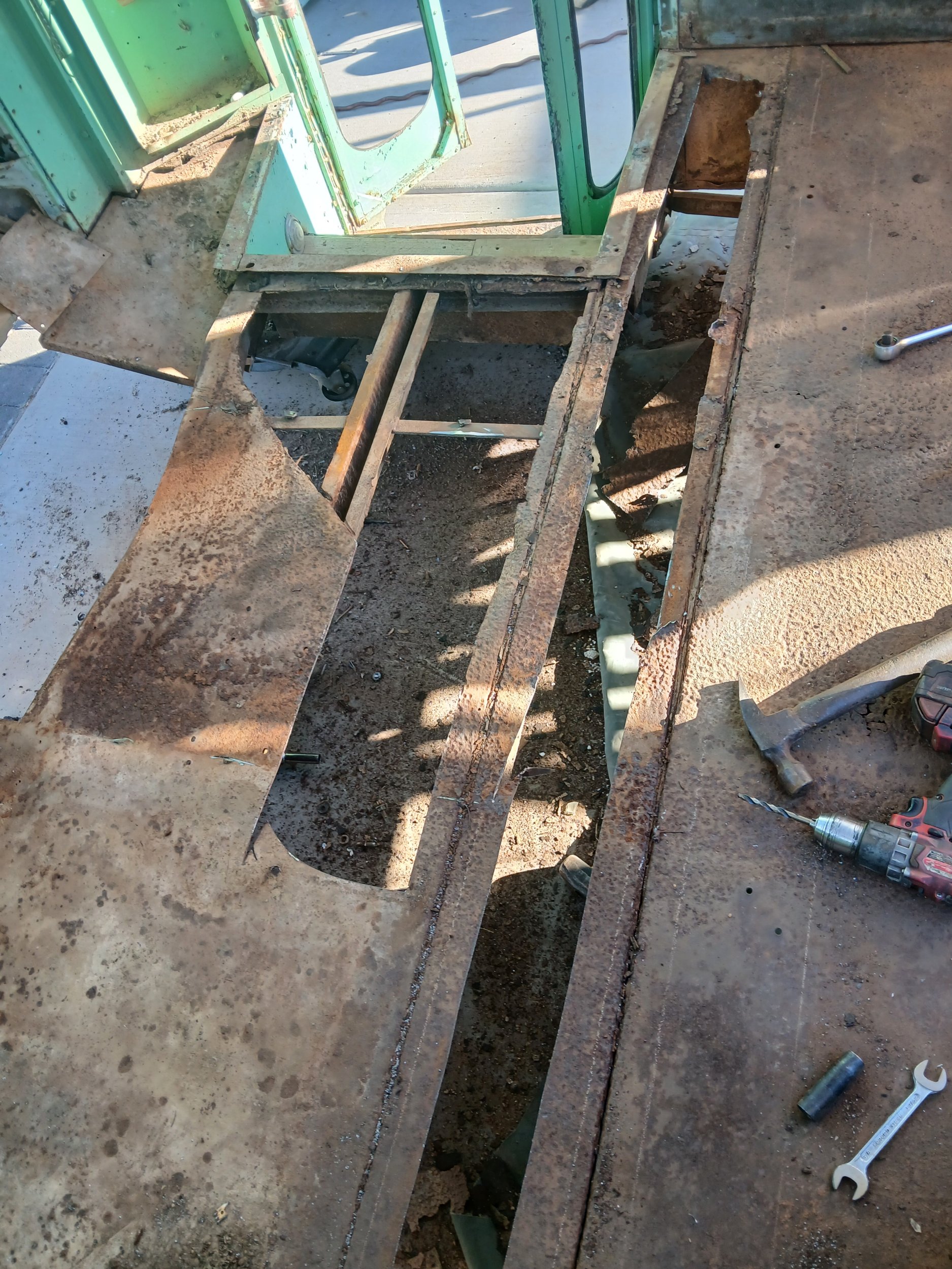

    20251011_163247.jpg 20251011_163219.jpg 20251011_163215.jpg 20251011_100942.jpg 20251011_163159.jpg
    I cut some of the floor off to access the bolts that sandwich the floor panels..
    Tightening the 3/8" bolts till they broke work best...some I cut the nut in half,some I had to drill the bolt head off..
    A nightmare of a job.
    Its all gonna get new metal...
    I haven't decided on using the same method or doing square tubing with aluminum plate to cut weight or reuse the c-channel with new steel panels sandwiched like factory..
    I'd hate to drill the rusty panels off the channels...
    Maybe new steel.
