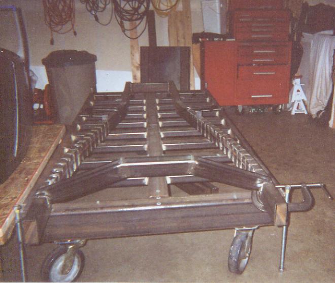

    6x6x.250 square tubing with misc. crossbraces that bolt on.
    First pic is set up for subframes. Put the car in the jig with the tires in the big c channels. Level it, cut frame, intstall new subframe withe the wheels/tires and weld away. Wheel base stays the same, no guessing.
    Secondpic is on engine stands for welding frames.
    Best thing about this setup is I can take it apart and stack it next to my garage...

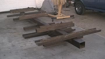

  8. The tables are really nice to work on however I like the open style. Preferably on that has a perimeter and you can tack cross braces in for the application you are working on. Also think ahead and make it bolt together - for the hobbyist it is the only way. Then you can knock it apart and store it out of the way.
    FWIW [​IMG]

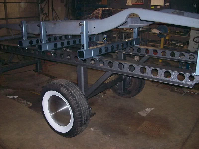

    i'm not sure if i ever posted pics of this but here is as good a place as any. GMgrunt and i built this past winter for our pal Denny Lesky at the Ionia Hot Rod Shop. Jeff did all the presision work and i did most of the torch and grinding work. we lost count of how much time we had into it but we had a ball doin it and it was for one of the nicest and most talented guys i've ever known so neither of us minded one bit. besides, it's not like we each have a half dozen of our own projects we shoulda been working on instead :rolleyes:. LOL
    as you can see we got just a tad bit carrier away. all the steel we sourced from Denny's stash or the local scrap yard. we added a detachable axle and tungue so it could be moved around or out of Denny's tiny shop or even hauled to car shows to display their wares.
    last i heard it was being used to restore the chassis for some old car that will be displayed at Pebble Beach or something. have'nt been there in a while, i need to make a visit real soon.
    OH YEAH. the white walls are the old white letter tires that were on the axle already. we just ground down the side walls just like we learned on a HAMB tech post from the past.
    enjoy...
    the "stations" are all bolt on and these particular ones are designed to fit 32 Ford chassis. we started another set of stations for 33/34 frames but left them for Denny to finish when he gets time to build a 33/34 chassis. universal "stations" could be built or the can be removed and replaced with a plate of steel or plywood and it would make about the worlds heaviest dinner table :D.
