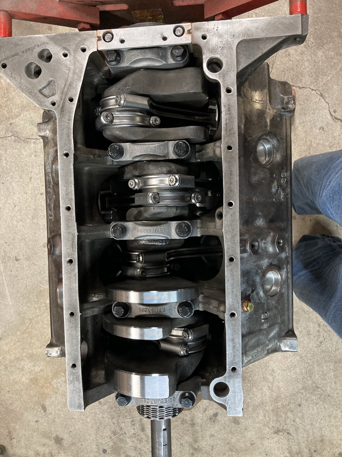

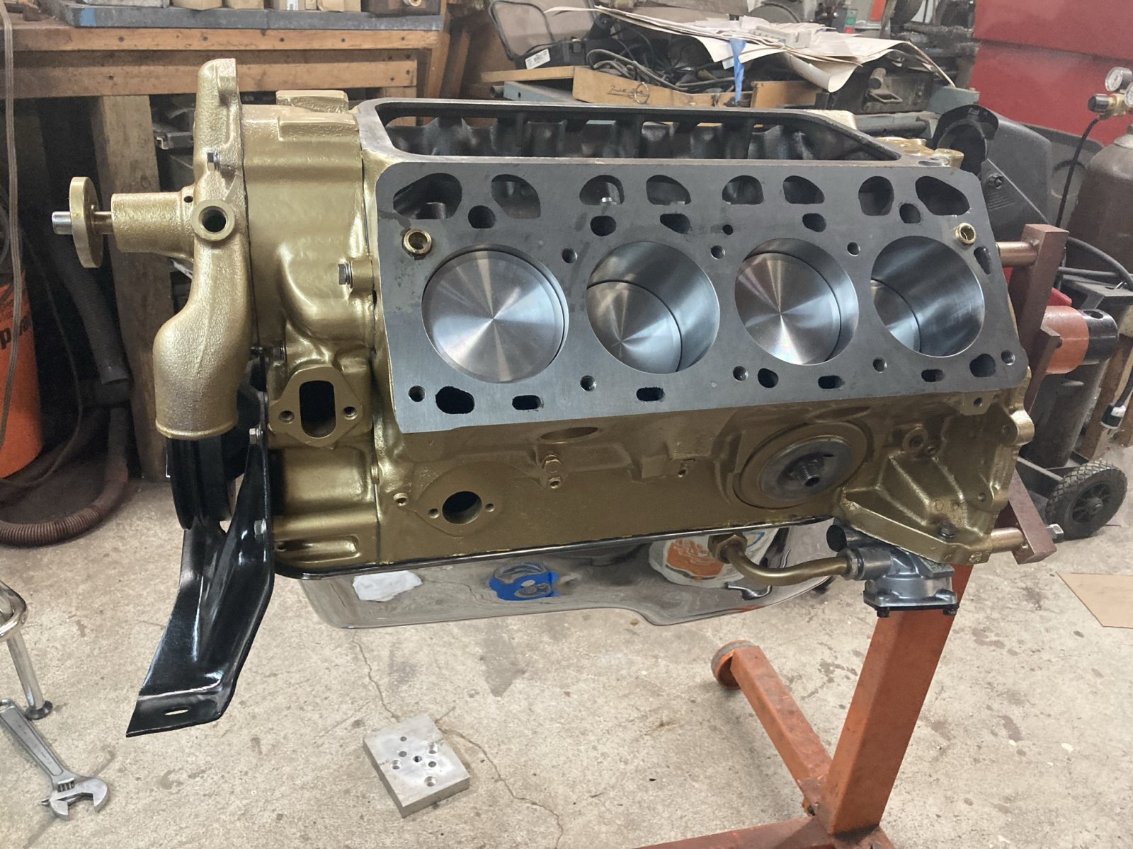

    So it’s time to build the motor for my Model A Coupe project. I have been into 50 years starting with my 57Tbird in 1972. So I’ve been collecting parts. Found a forged truck crank about 10 years ago sent it to be cut for Chevy rods then to be nitride. High nickel 1959 292 ultra sounded for core shift and then .060 over block bored to .090 for custom pistons on narrowed Manley ls Hbeam rods completing the lower end. Heads with stainless valves and hardened seats.

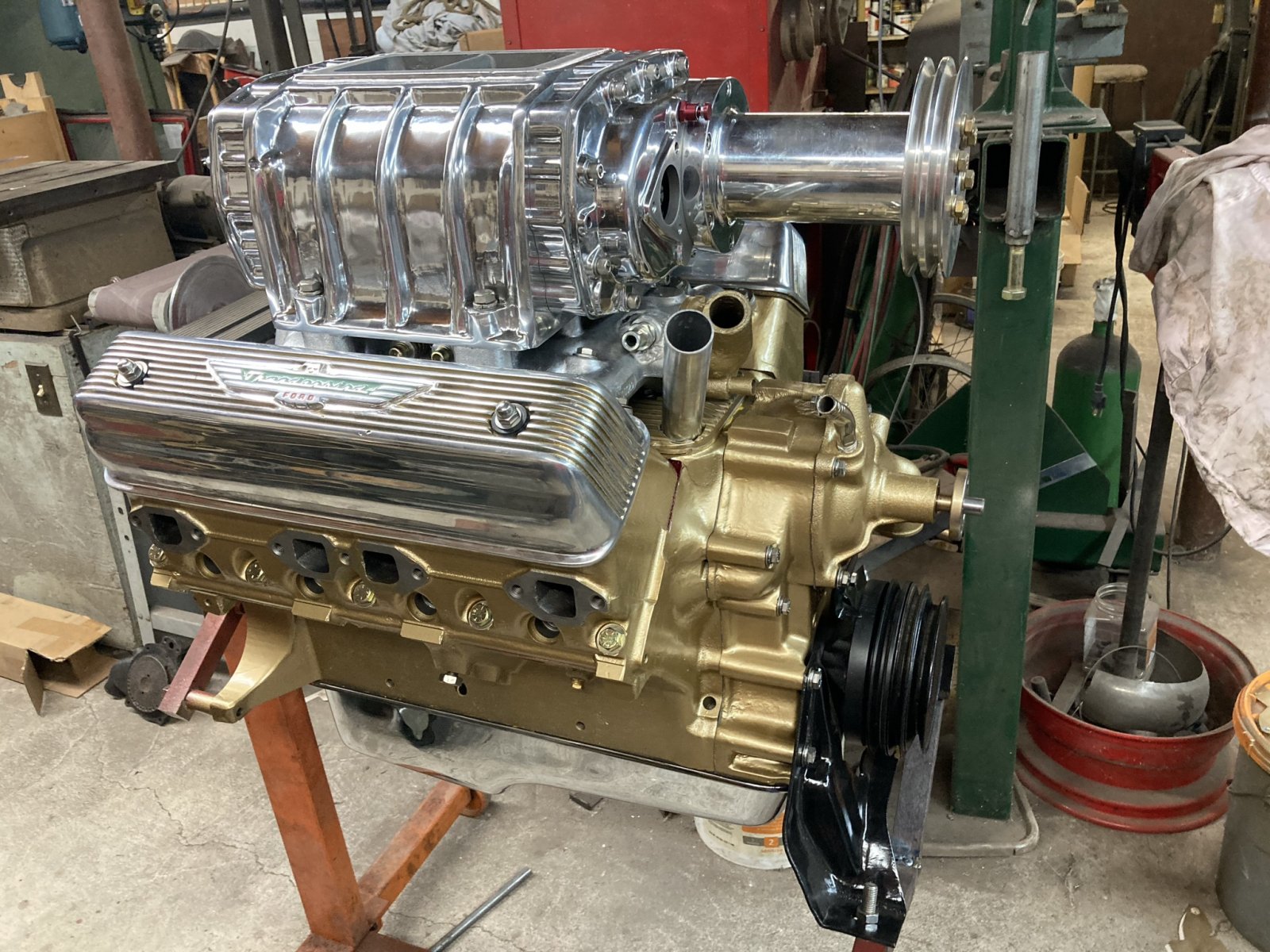

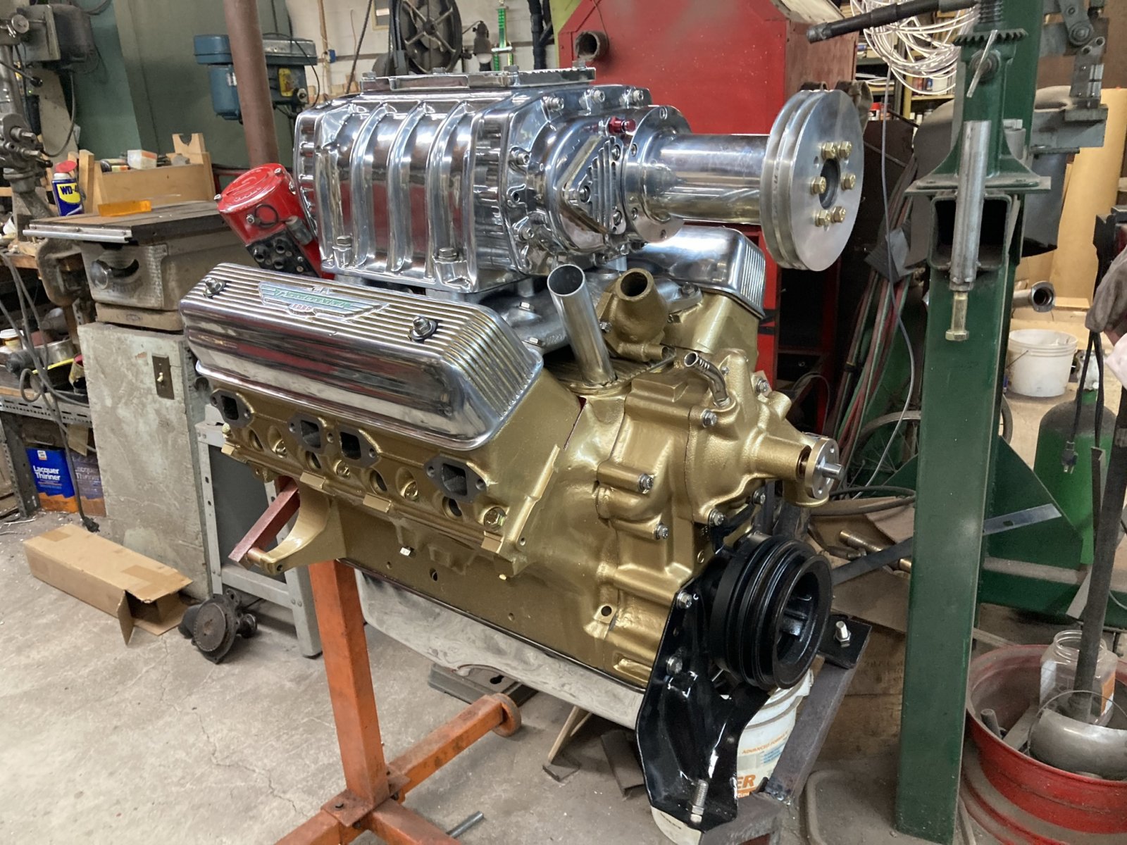

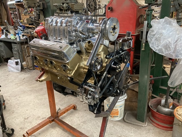

    Was lucky enough to get a blower manifold from Australia YBloke. Polished 471 B8FBCE5F-E08B-4C64-AD06-B63ACC385FEA.jpeg

    Next the Grant Flame Thrower

  8. loudbang
    Posts: 40,348
    Are you underdriving that supercharger? That pulley looks rather large. :)
    Sharpone and Deuces like this.
  9. famdoc3
    Joined: May 14, 2010
    Posts: 99
    famdoc3
    Not under driven. I’m running 2 v-belts off of the crank pulley which is essentially the same size (a little over 6 “). Working out the details as I go. It’s an adventure. Thanks for looking! MIKE

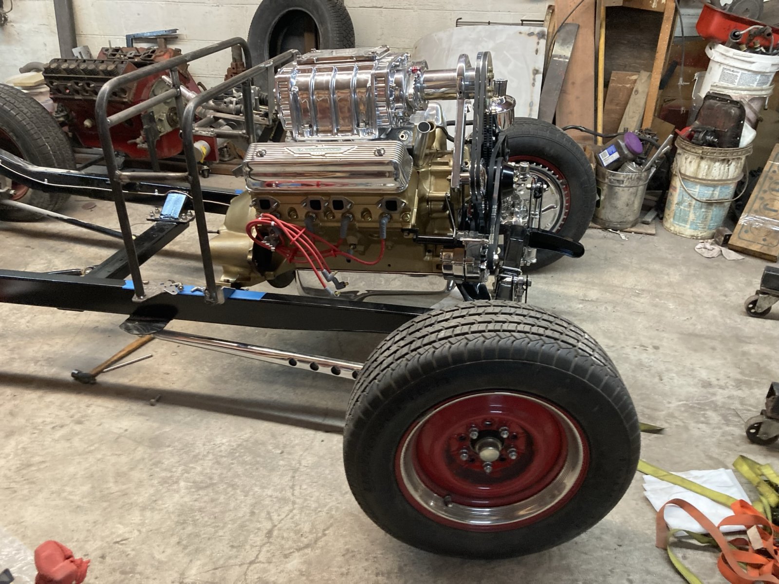

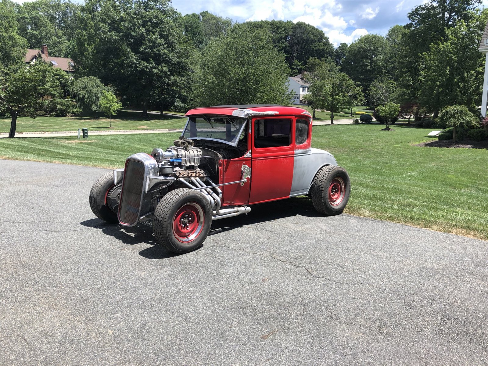

    Here’s a picture of the mock up before it went to the machine shop. Bit by bit it’s getting there. 64BC91F9-884F-4940-B8AA-931830A4774F.jpeg
  12. famdoc3
    Posts: 99
    famdoc3
    Wheel are for the mock up only. Plan is for 35 16”wires.

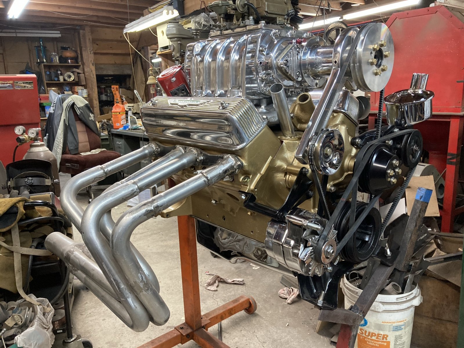

    Progress is being made. It gets better and better. Front drive system coming together. Power steering worked out. Still no fluids yet. Distributor to get new points and then set up on the machine before final installation and wires to make and install plugs. MIKE
  15. y'sguy
    Joined: Feb 25, 2008
    Posts: 813
    y'sguy
    from Tulsa, OK
    Love it, which heads and did you do anything to them?

  17. famdoc3
    Posts: 99
    famdoc3
    Heads are 113s with hardened seats and 16 stainless valves cut for real seals. Thanks for looking . MIKE

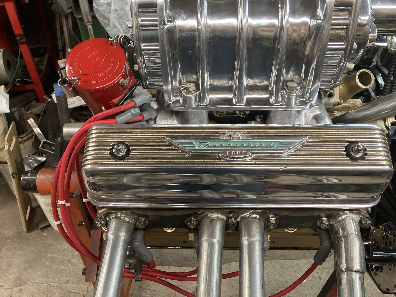

    Latest distributor in and plug wires made

    Mike, what steering box are you using with that cowl steering? Fantastic job on that 292!

    Steering is a custom stock car power box made in Pa. don’t think timing should be a problem the distributor cam moves to adjust the timing not only by moving the distributor, we’ll see how it works out soon when it gets to the dyno.

    Nothing like a Y block. The T-Bird valve covers have to be about the best looking valve covers ever made. New Eng in Car3.jpg

    Put the motor in the frame have to run it to break in the cam and check it for leaks. 6DE3C25A-DAD3-4057-B6D6-DFDC42C97D11.jpeg

    Needs some open headers...;)

    Open headers coming soon. Maybe tomorrow. Stay tuned. MIKE

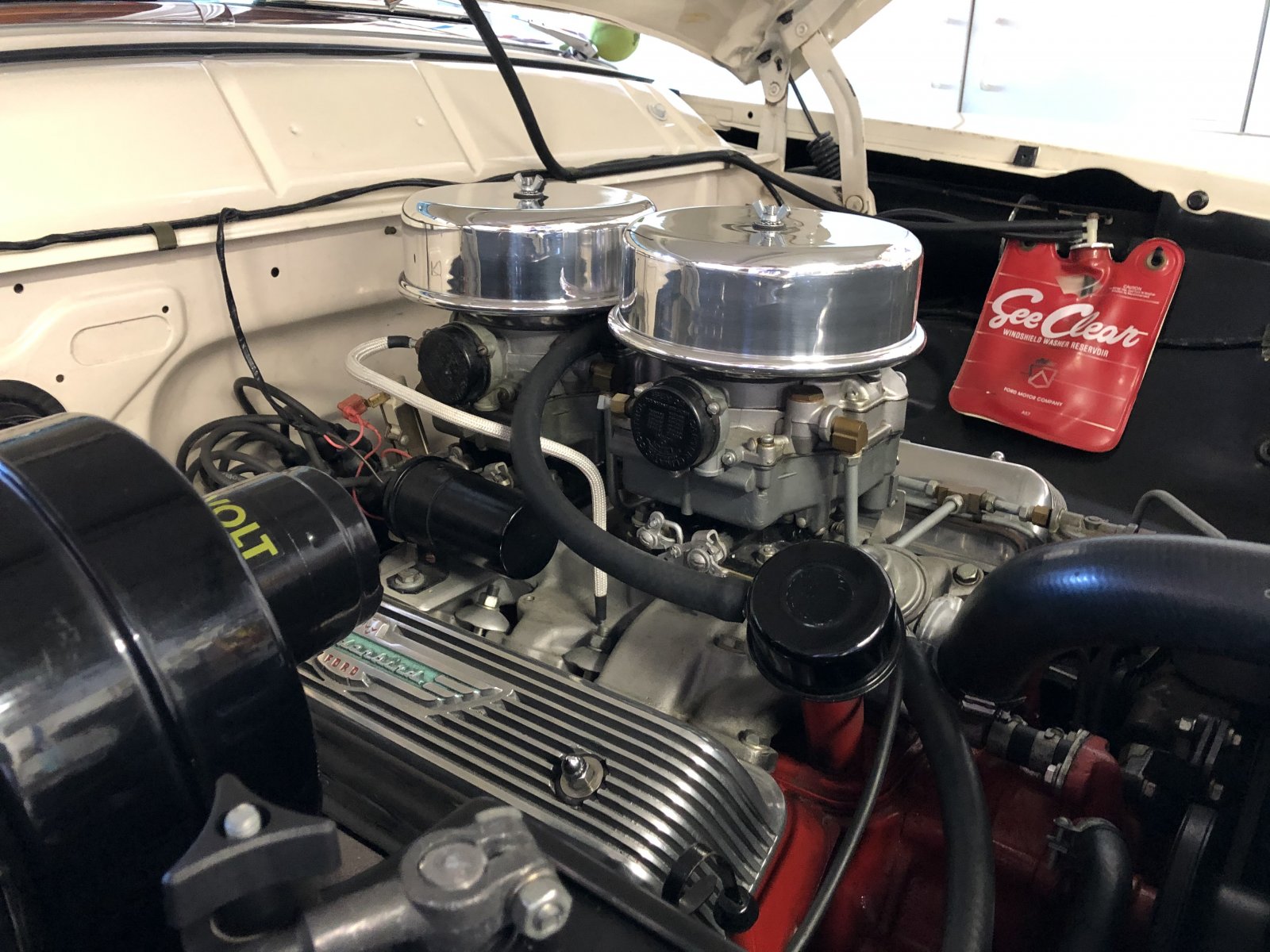

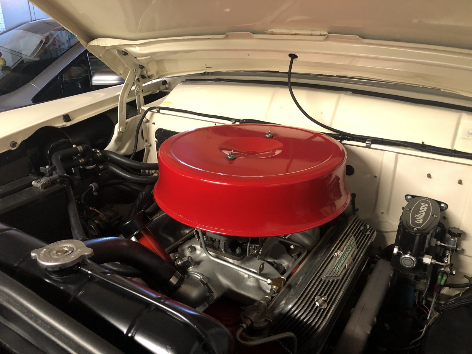

  30. jimmy six
    Joined: Mar 21, 2006
    Posts: 17,252
    jimmy six
    If you can’t get a blower …. the next best has always been dual quads..even if you hide them under a 1956 Purolator NASCAR air cleaner 48580F31-E062-457B-9242-CA618B9F2654.jpeg 5BAB18DD-0CFA-4947-B2E5-FF9BF99AD124.jpeg
