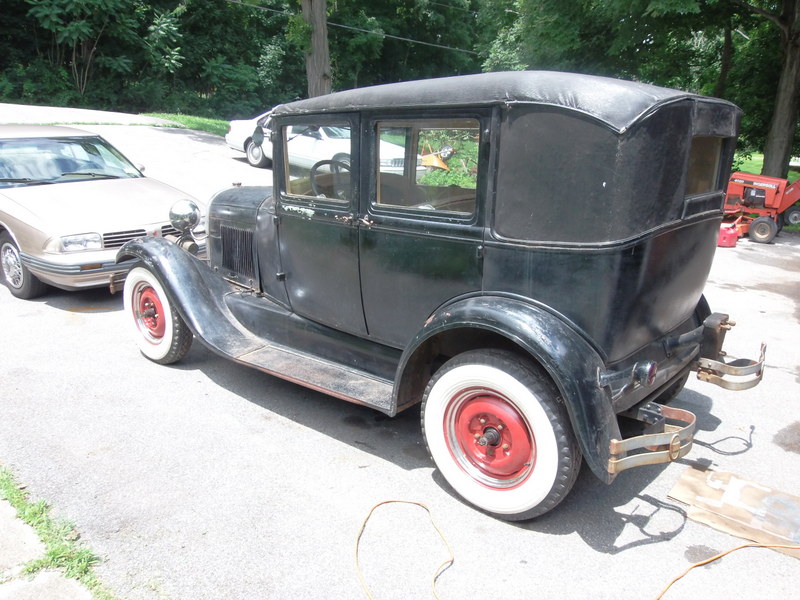

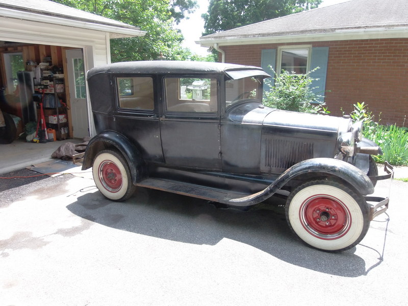

    This particular body style of Model A has always intrigued me. A '29 hood and grille and a '30-'31 cowl. Do you know the story about this? I'd like to find out.
  10. Gary, I am no Ford historian, but I'm told this is a Briggs body.
    Ford built the ch***is, engine, fenders etc, which are '29.
    Then it was sent out or a body by Briggs came to the factory and was installed.
    There are many detail differances. I don't know them all.
    The cowl is definately different. the front window doesn't push out.
    The dash is shaped differently, and the back is blind.
    Can't help much more.
    Let's not hijack this thread.
    PM me if you want more info.
