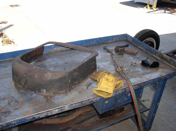

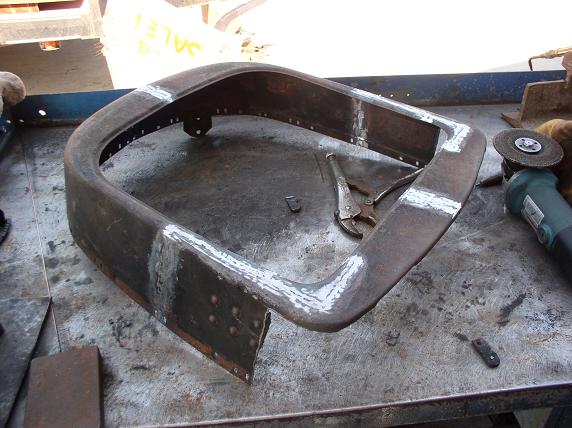

    today is day, uh...twelve, yeah, day twelve in the modified build.
    today I welded up the Studebaker grill shell I sectioned yesterday.
    I used a Victor torch with a single ought tip
    just like in the fifties, bro..
    here's the tacked together shell

    Paul
    Editor
    here we are, welding proceding nicely
  3. Paul
    Joined: Aug 29, 2002
    Posts: 16,860
    Paul
    Editor

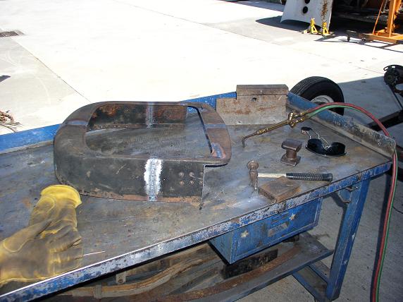

    when I sectioned it I made it 2" narrower by taking the 2" out of the center.
    this left a couple high spots where the stock badge attached and at the radiator fill area.
  4. Paul
    Posts: 16,860
    Paul
    Editor
    I heated these high points to a dull red, set down the lit torch and knocked them down
  5. Paul
    Posts: 16,860
    Paul
    Editor
    and welded them up

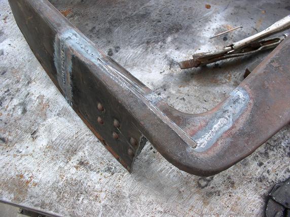

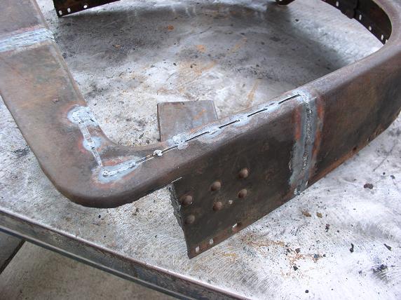

    in my haste yesterday I left myself a couple gaps that kinda pissed me off,
    on this side it was about an eighth inch wide so I just welded it up, slowly
  7. Paul
    Posts: 16,860
    Paul
    Editor
    the other side was a little wider so I made a patch out of some of the left over scrap from the section
  8. Paul
    Posts: 16,860
    Paul
    Editor
    and welded it in
  9. Paul
    Posts: 16,860
    Paul
    Editor
    then ground the high weld material down inside and out, and worked the metal with hammer and dolly to get it relatively smooth
  10. Paul
    Posts: 16,860
    Paul
    Editor
    and hit it with the sanding disc and checked the work

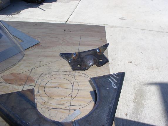

    today is day thirteen of my modified build.
    I am not convinced today’s fabbing will net optimum results, geometricaly speaking that is.
    I built a mount to accept the pivot ball that I removed from the front wishbones and will weld to the rear wishbones.
    I cut the socket from a stock '34 K member and fabbed up the rest.
    the potential problem is in that I will have to drastically shorten and pull the bones together to make the connection, and the ball ends up being about four inches in front of the front U joint.
    here are some in progress pictures..
    I think they speak for themselves..

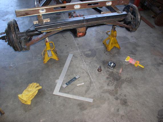

    here is day 14 in my modified build series.
    today I bit the bullet and hacked the bejeezus out of a real cherry '36 rear wishbone [​IMG]
    I shortend them, angled them in and down to attach to the new receiver socket using the pivot ball cut from the split '36 front bone.
    I got the driveshaft back today too..
    first I got the frame and axles square and level
    front;
  19. Paul
    Posts: 16,860
    Paul
    Editor
    and rear

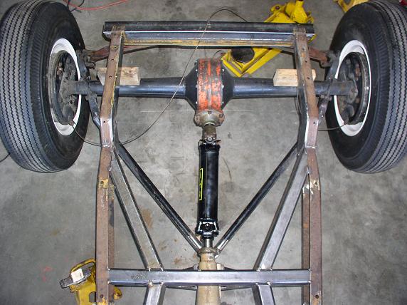

  25. Paul
    Posts: 16,860
    Paul
    Editor
    side view showing some pretty drastic angles
  26. Paul
    Posts: 16,860
    Paul
    Editor
    and one from above

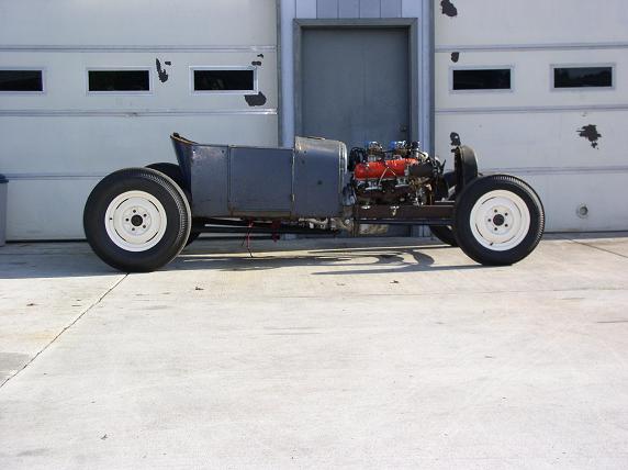

    this is what it looked like just before the rear bone installment,
  29. Paul
    Posts: 16,860
    Paul
    Editor
    and here it is with the frame and engine/trans raised an inch each..

    ok, one last picture before I get back to it,
    although the angles are vastly improved as you can see, and I do think will work well,
    now the whole car sits a little higher then I originaly intended..
    I'll play with it some more before I weld it up, maybe give it a little more rake..
