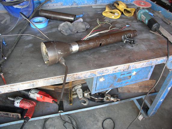

    then measured the collumn, it gets 9-3/4" taken out of it
  11. Paul
    Joined: Aug 29, 2002
    Posts: 16,860
    Paul
    Editor
    so I took it all apart and cut it too

    welded the shifter tube and collumn back together
  13. Paul
    Posts: 16,860
    Paul
    Editor
    reassembled the collumn

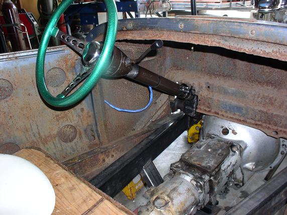

    put the collumn on the box and shaft, put the wheel on and clamped it back in the car for checking fit
  15. Paul
    Posts: 16,860
    Paul
    Editor
    I used a chunk of angle iron to clamp to,
    I will make a new bracket to accept both the box and wish-bone end,
    but you can see it will all come together nicely

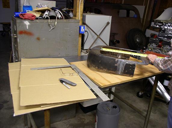

  18. Paul
    Posts: 16,860
    Paul
    Editor

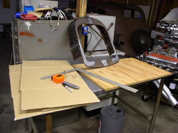

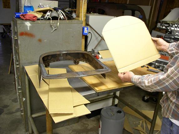

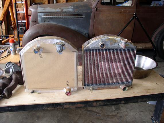

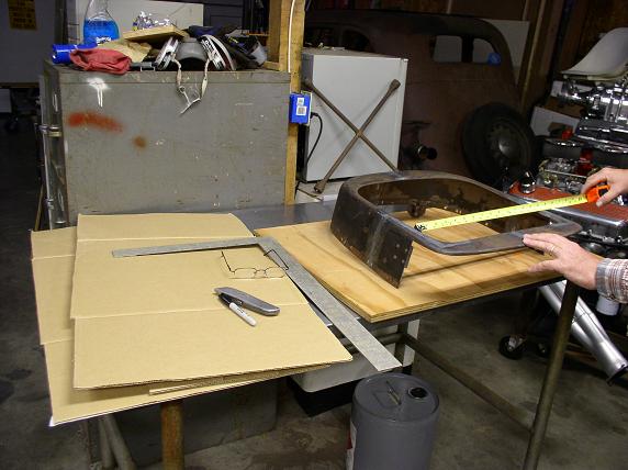

    making a pattern for the radiator shop...
    check the fit of the shell
    take measurement of shell
    cut cardboard front pattern
    duplicate for back, cut sides and tape it all together to make a box
    check fit

    pattern is done,
    tomorrow I will take it to the radiator shop

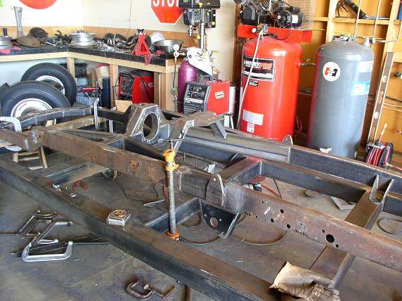

  20. Paul
    Posts: 16,860
    Paul
    Editor

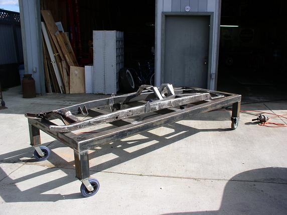

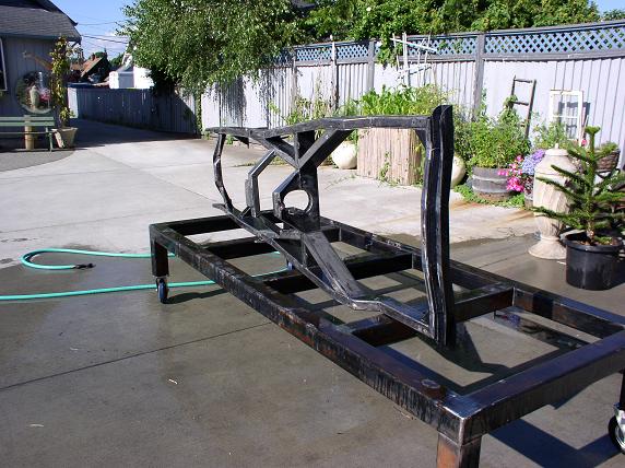

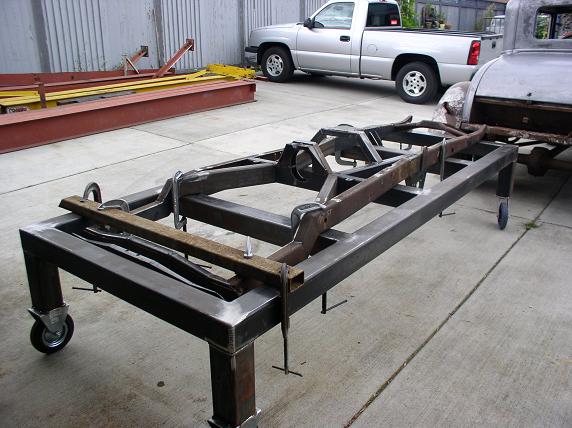

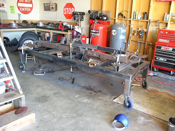

    it's been about 14 months since I really had any time to work on the little car
    yesterday I pulled the frame out from under her and started welding it up
    the new frame table works!
    not much to show right now, but here it is assembled and the frame on the table
    the rest of the parts are tucked out of the way, here's also the Stude motor in pre op with the other patients
  21. Paul
    Posts: 16,860
    Paul
    Editor

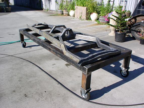

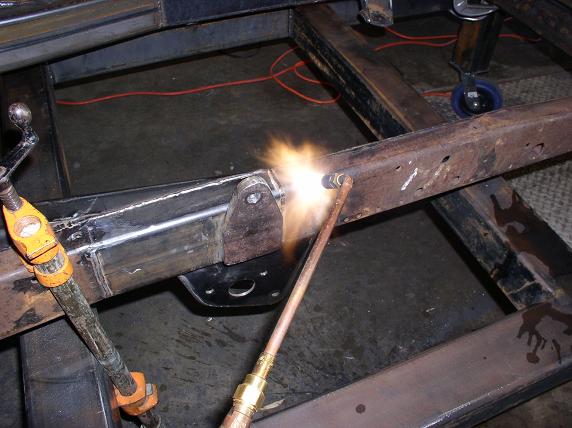

    second day went a lot like the first
    continued welding on the frame,
    when I unclamped it from the table after the first day of welding one corner lifted about an eighth of an inch,
    it actually had a bow in one rail where I had welded the steering box mount,
    so I clamped all four corners nice and square and put some tension on the offending area.
    with a little carefull application of heat I pulled it back into shape and let it cool over night.
    just a few more hours of welding and it'll be time for reassembley

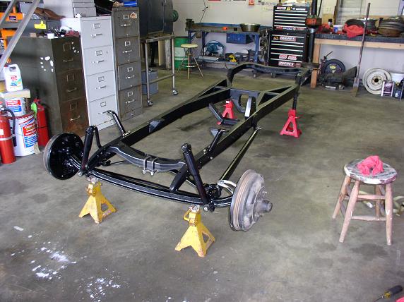

  22. Paul
    Posts: 16,860
    Paul
    Editor

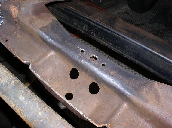

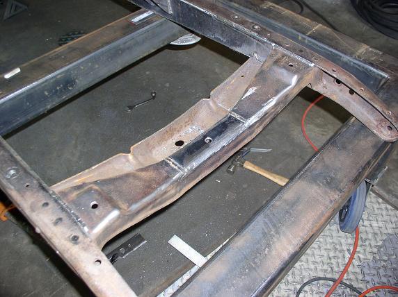

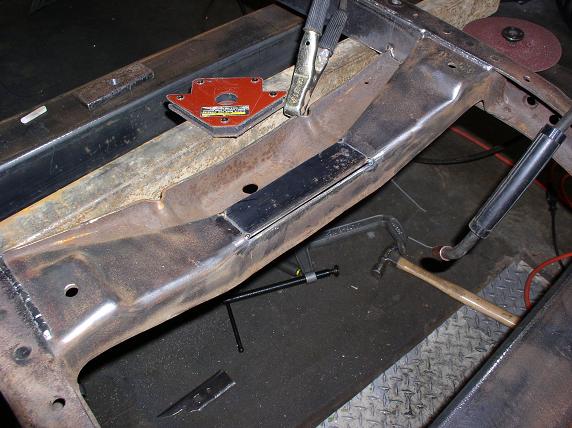

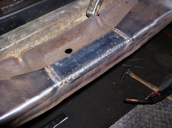

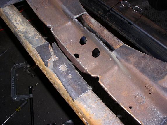

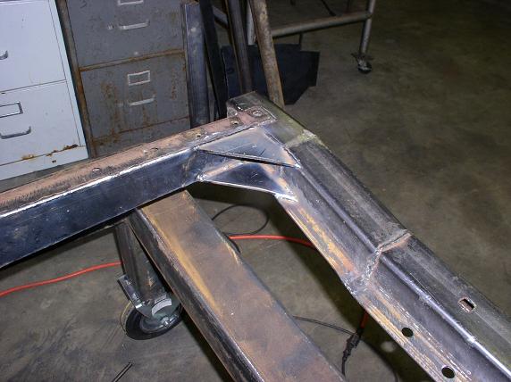

    yesterday with all the major welding done on the frame I finished up the few little things and got it ready for paint
    here's the cracked front cross member,
    cut out,
    patch tacked,
    patch welded
    and dressed and drilled

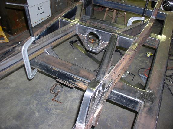

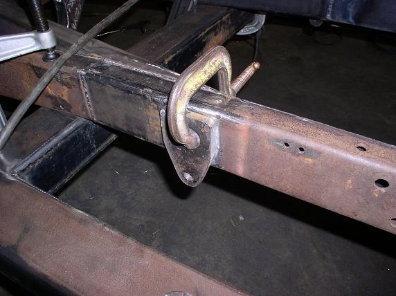

  23. Paul
    Posts: 16,860
    Paul
    Editor

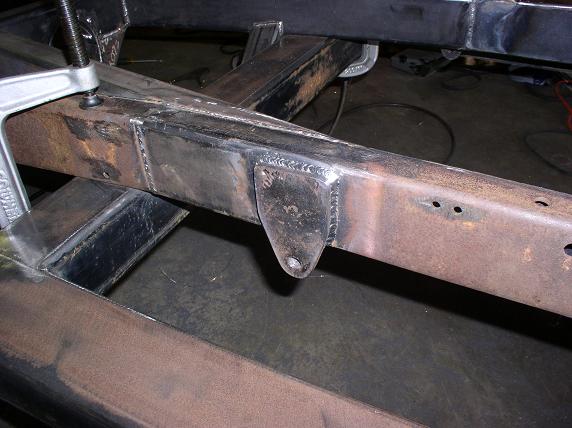

    here's one of the bone tabs clamped
    and welded
  24. Paul
    Posts: 16,860
    Paul
    Editor
    corner gussets

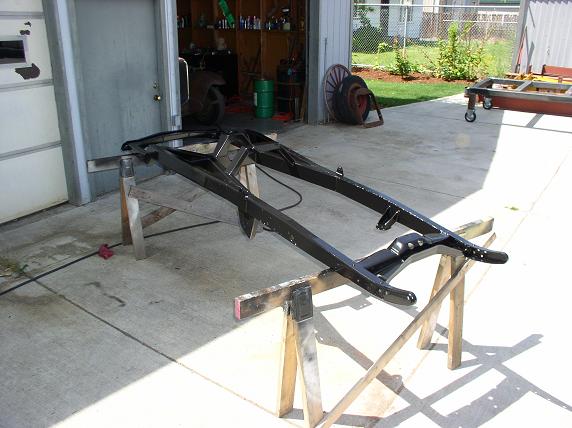

    and outside getting cleaned up
    knocking down the rust
    metal prep
    and paint ready!
  26. Paul
    Posts: 16,860
    Paul
    Editor

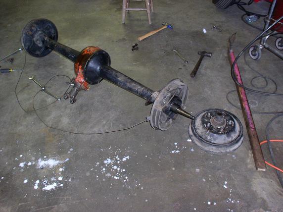

    got some POR15 on the underside, while it dries I'm going to try to set up my rearend per the-rodster's tech thread :)

    yesterday seemed like a lot of nothing..
    couldn't come up with shim gaskets for the banjo,
    got some on order, should have them by Wednesday..
    anybody in the Seattle Tacoma area have them on the shelf???
    so I spent most of the day cleaning and painting parts.
    why does painting take so long?
    a car could be built a LOT faster if you didn't have to clean, paint and wait for it to dry...
    this morning I start reassembley :)
