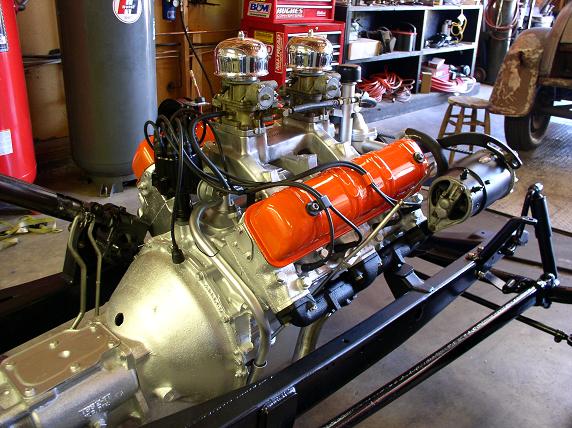

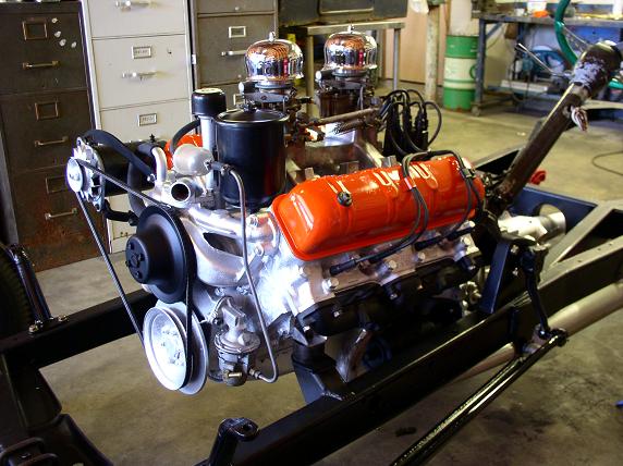

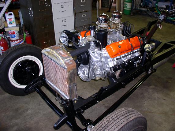

    not much to show today, just some more assembley
    on the motor..

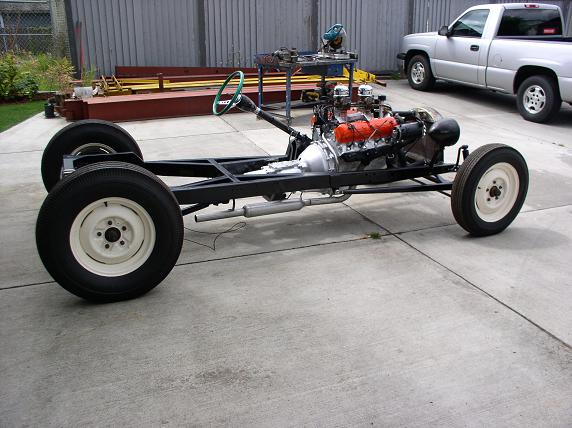

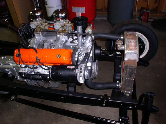

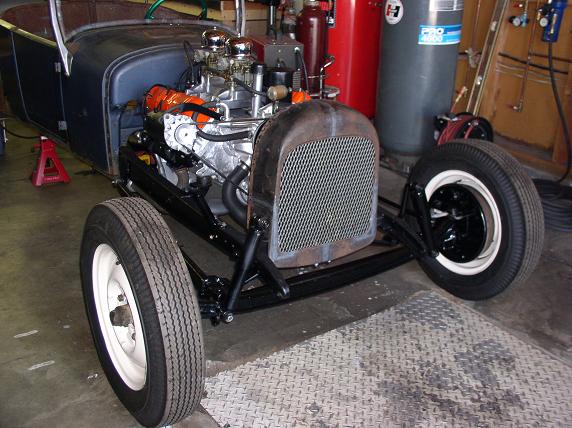

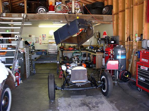

    she's slowly coming together,
    got the radiator in position and mounts tacked, I want to get the body and grill shell on and aligned before they get welded solid to the tank. the mounts will be bolted to the frame with rubber isolators to absorb shock...or thats the plan.
    found a couple hoses to fit, filled it with water, fired the motor up and let it run for about twenty minutes, radiator cap off and little 12" electric fan pulling air she never boiled over.
    one freeze plug needs replacing but no other leeks or drips. so far.

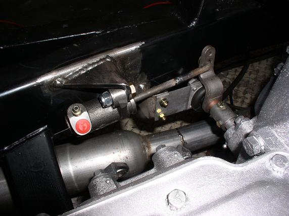

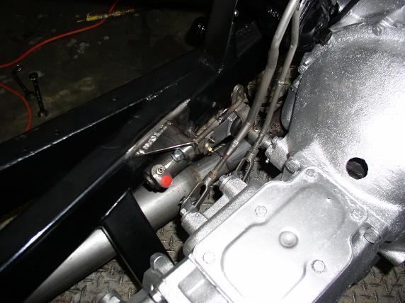

    yesterday mostly mundane tasks
    I did put together the clutch linkage though,
    I altered the stock stude bellcrank, mounted it and the new slave cylinder

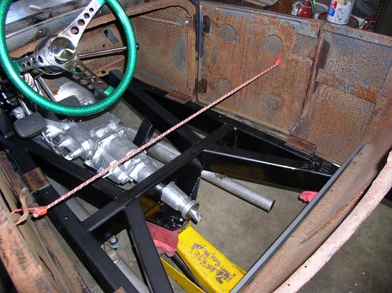

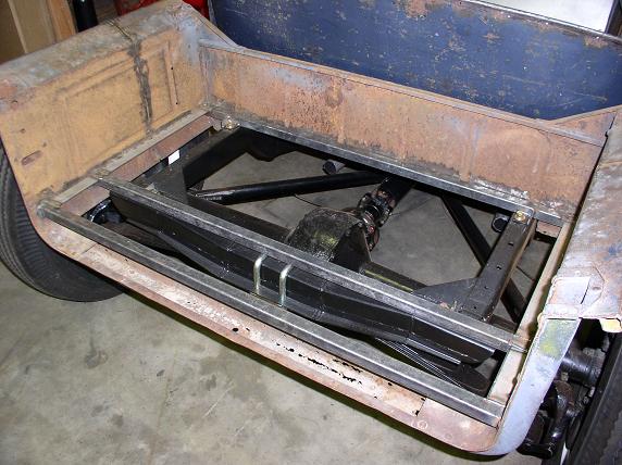

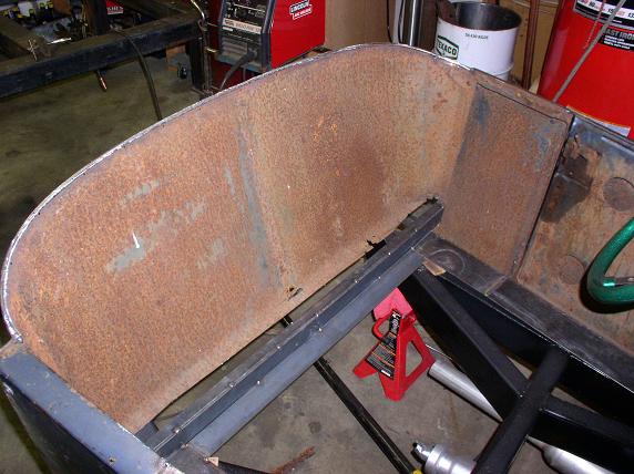

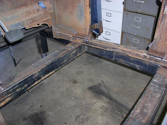

    yesterday I started in on the channel, subframe and hammered a patch in the skin..

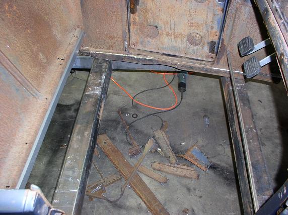

    Editor

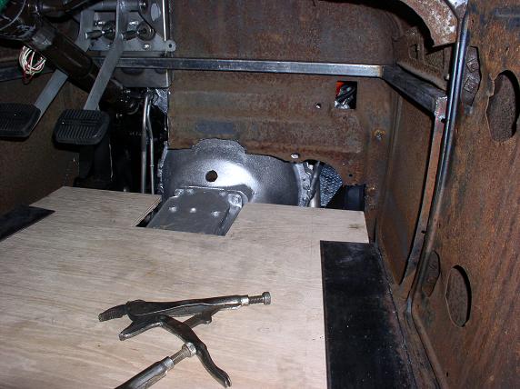

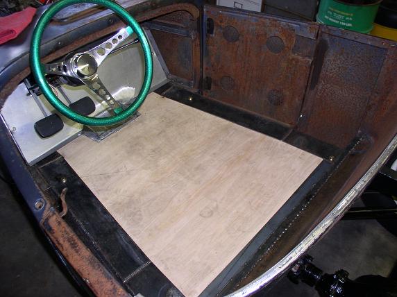

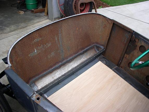

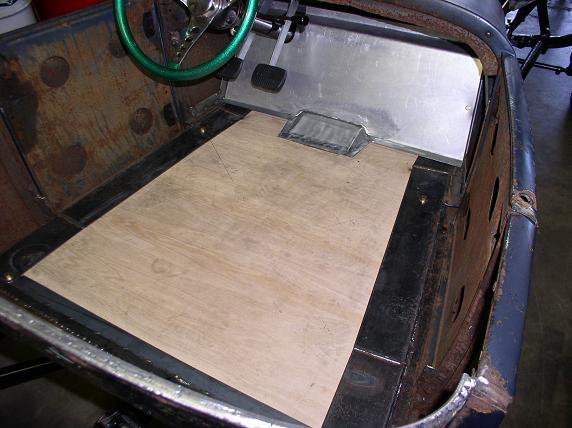

    started back in on the floor, got a piece of p'wood hacked to fit, gunna sandwich it between the body and frame,

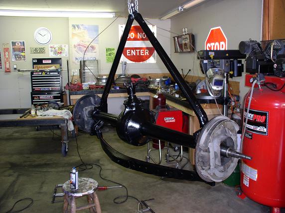

    and the phone rings, my differential gaskets finally came,
    when I get there the guy admits to having a set on the shelf all the time,
    just not in the computer! doh!
    so I did the disassemble reassemble routine a half dozen times and got it feelin pretty good
    stuck it under the car :)

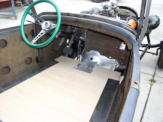

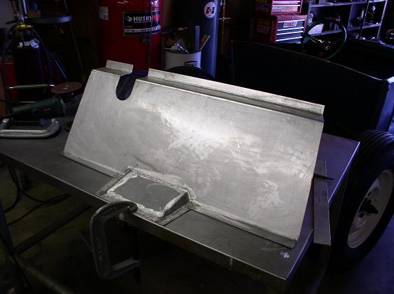

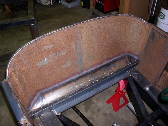

    got back to the floor, moving towards the front
    started bracing the firewall to handle the swing pedal setup,
    and fabbed up a panel to close the gaping hole at my feet..
    still need a few more braces and flanges to attach and close the deal...
    then I can bolt the body down

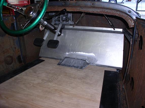

    continued closing up the floor at the foot and firewall
    the body is now bolted to the frame.
    today I get to go back to work so progress will have to happen after work and weekends,
    still a ton of work to finish but,
    it doesn't need much for it's first run around the block.

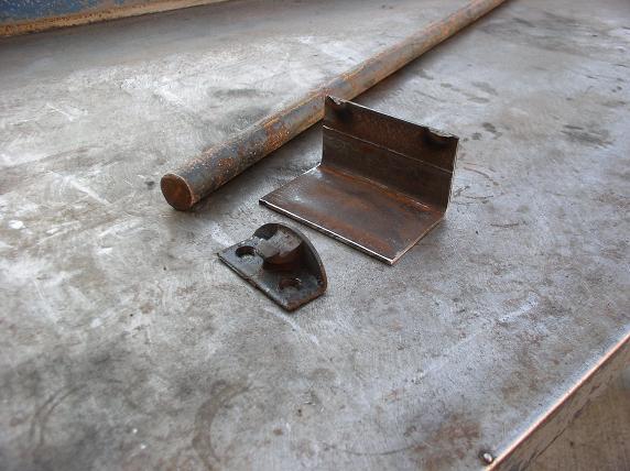

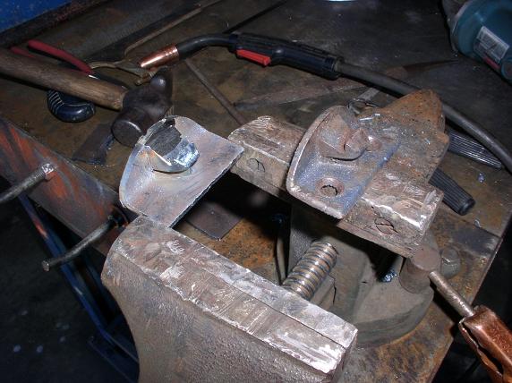

    I need another strike plate, latch catch, thingy for my '27 T Touring
    if you got an extra...:)

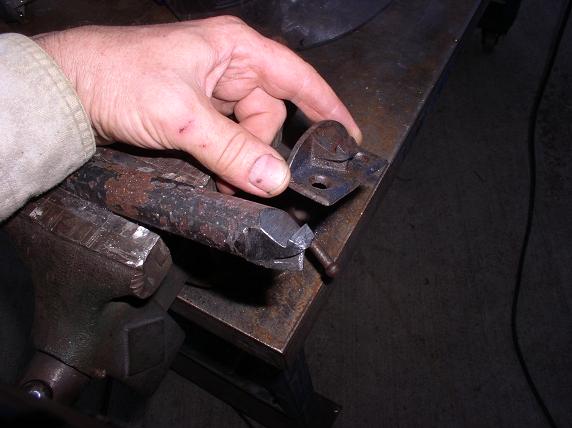

    in the meen time I need to keep my doors closed but only have one, so I made another for temporary service.
    I took a bit of round stock and whittled the hook part
    and a scrap of the corner of a piece of square tube I had laying around for the flat part and made one.
    first the original I used for a pattern,
    the materials
    and the roughed out shape

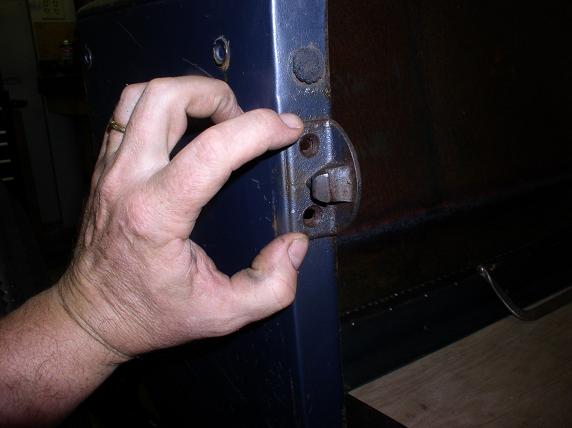

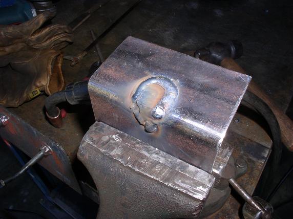

    then gouged a ragged hole, threw some goobery weld on it and roughed out the flat stuff to shape..
  14. Paul
    Joined: Aug 29, 2002
    Posts: 16,860
    Paul
    Editor
    and finally, drilled and countersunk the holes, and bolted it in place..

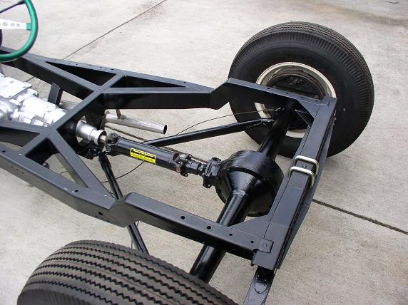

    U joints are not a big deal, when you get your shaft made tell them what your two yokes are and they should be able to set you up.
    in my case the stock rear joint on the Stude shaft was an exact fit for the open banjo, I just had them cut the shaft to fit and bought two new replacement joints.
  16. Paul
    Posts: 16,860
    Paul
    Editor
    it's an old Ansen swing set made for the two three bolt Ford masters, I didn't get an ID on the exact application for the cylinders other than that they are Ford, all 1" and the clutch master has no residual valve, the slave is connected to the altered Stude clutch arm..

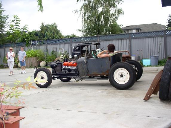

    Editor

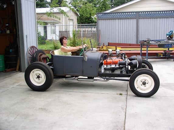

    this is a monumental post for me
    this is to state and record the first time my little car has moved under it's own power.
    I hot-wired it and ran off the battery, couldn't wait to get wires in it.
    after initial fire-up all seemed great, so I headed out the driveway and down the block, before I made it to the end of the block I noticed I was leaving a trail..
    turned around and when I got home saw I had lost a freeze plug (the same one I had just replaced) :rolleyes:
    put a new one in, topped off the water and headed out again.
    this time I drove for several minutes, staying close to home, all seemed great, NO bump steer, tracked straight, brakes straight, brake pedal right at the top, no appearant over heating, all good!
    went back to the house, took the nephew for a short romp around the block, everything was great!
    came back grabbed the camera and headed out again.... barely made it to the end of the block and she cut out. I had to push her home.
    dirt in the tank clogged the pre pump filter, swapped it and the after pump filter and it'll idle, and run rough at mid throttle but I must have fines in the carbs... I will go through them tomorrow and get a few wires strung..
    not perfect but she ran great, she drove nice, and stopped good too.

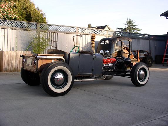

    Paul
    Editor
    how she looks now

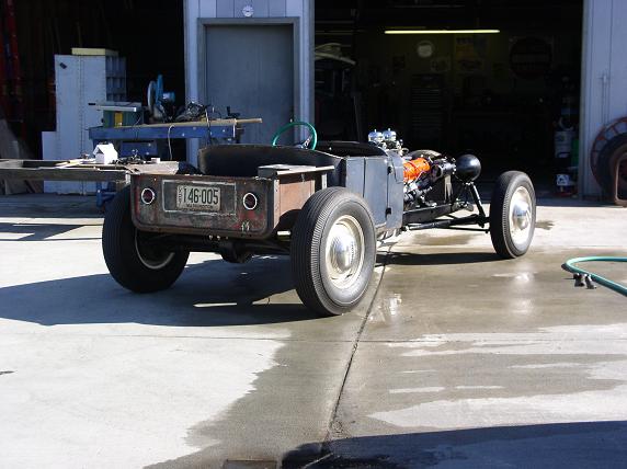

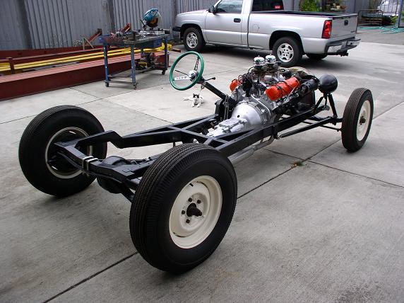

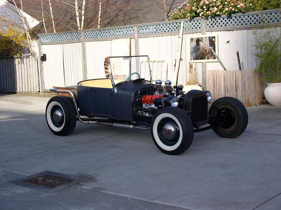

    a few changes since this thread left off,
    swapped the Studebaker engine for a '50 Olds 303 with 4-71 blower,
    the transmission is also now '50 Olds (stick)
    and the rear is an early Ford truck 9",
    dash, gauges, upholstery, wheel and column swapped too
    all in the name of fixing what aint broke :rolleyes:
    so it goes...
    now I'm swapping the stock '36 axle for an old dropped and filled axle I had laying around
    just to give it a bit more rake..
    it's all fitted and rolling
    but waiting on a couple parts, perch bolts,
    destroyed one pressing them out
    and shock mounts,
    I had welded mounts to the old axle,
    'don't know if I want to weld on this one..
    jury's still out on that one..
    but it should be out and about again soon
