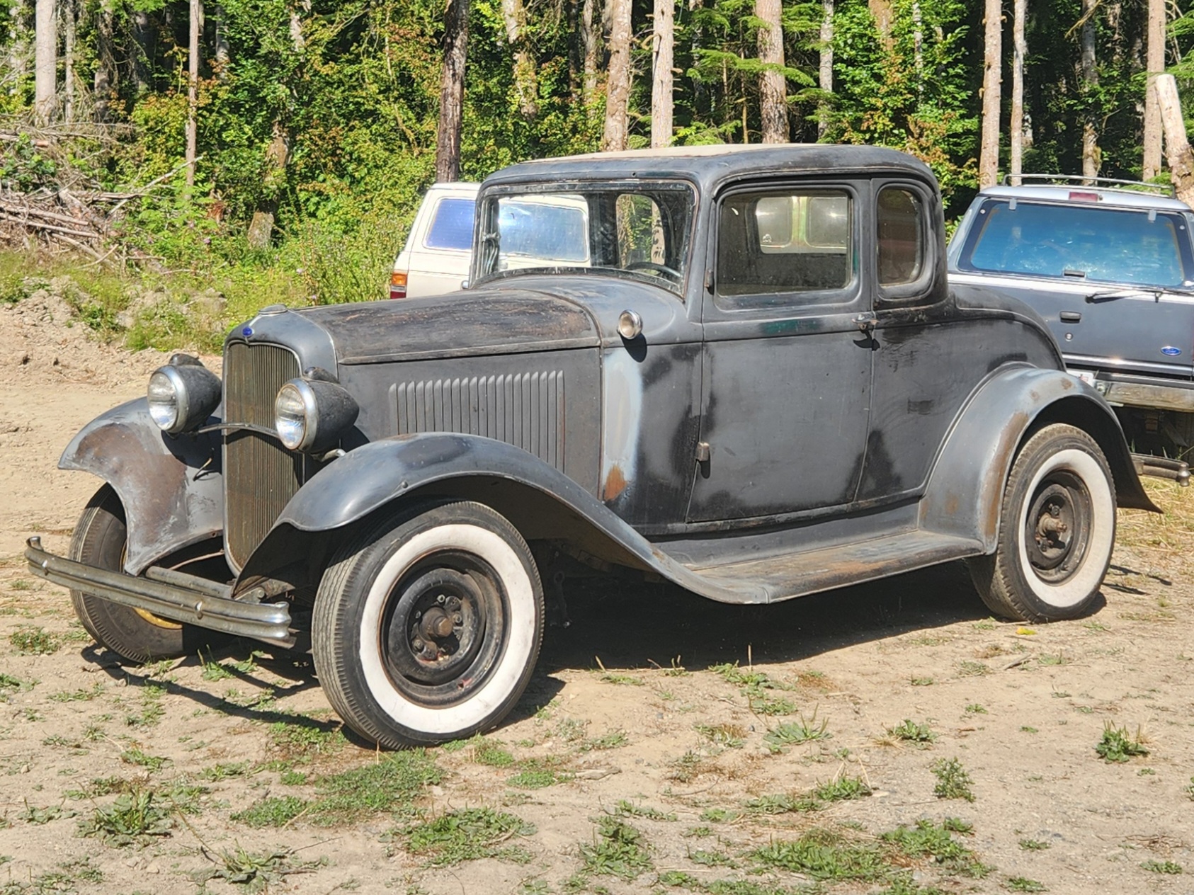

    We got this sweet 1932 Ford 5 window coupe here at the shop. It spent most of its life locked up in a warehouse in the Portland area.
    Unfortunately shortly after it arrived...I tore a tendon in my left leg. So I've been healing that for the last 2 months.
    But recently I got cleared off of the crutches. So, I'm back at it. Look out world!
    My first goal was get the car apart. I pulled the hood, grill, radiator and headlights. Then I got the car up on jacksstands.
    I've been evaluating the car, its got some hidden issues. But it's overall a very solid car. And it's way nicer than my 32....

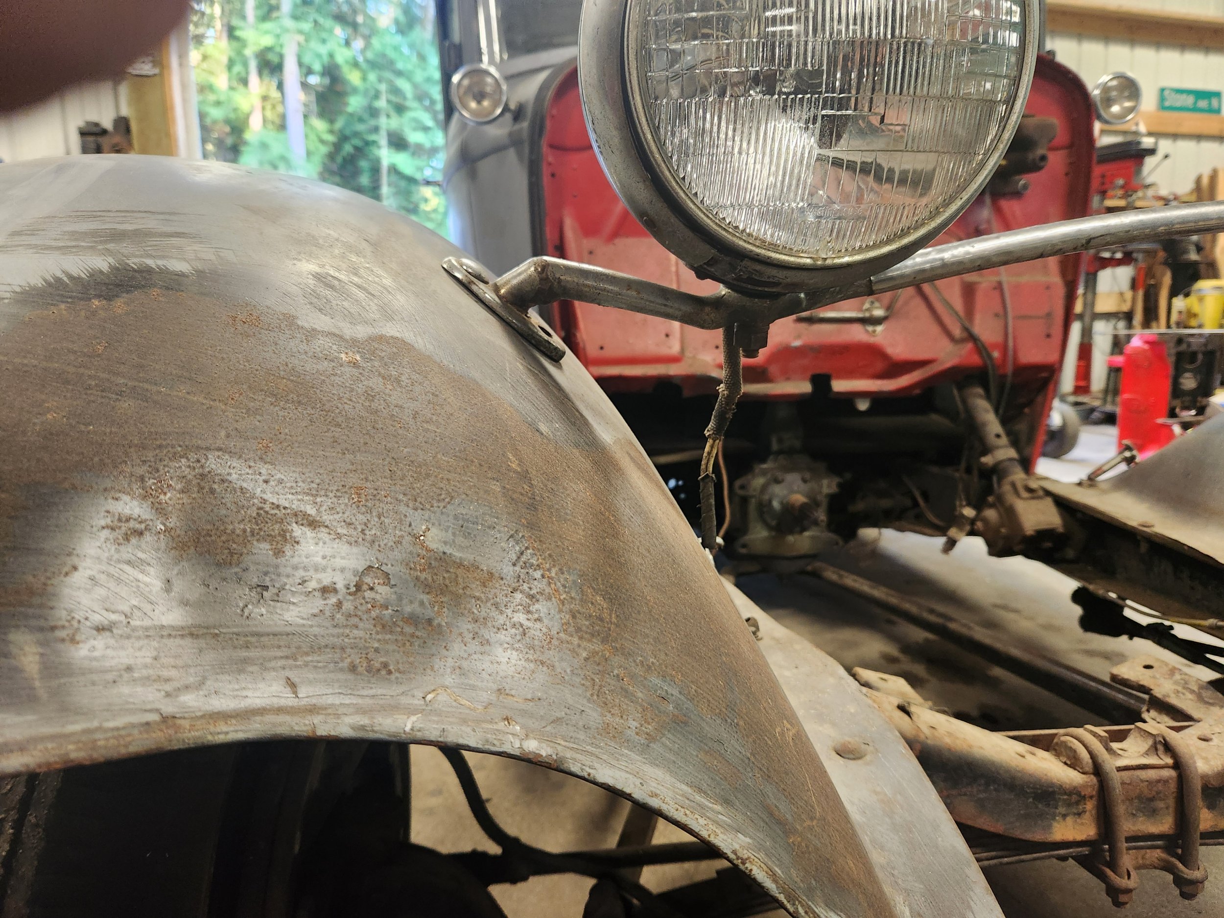

    Secondly the dropped headlight bar. You say this car has been tucked away since 1958 so the dropped bar must have been a thing before that. Any idea when they came into fashion?

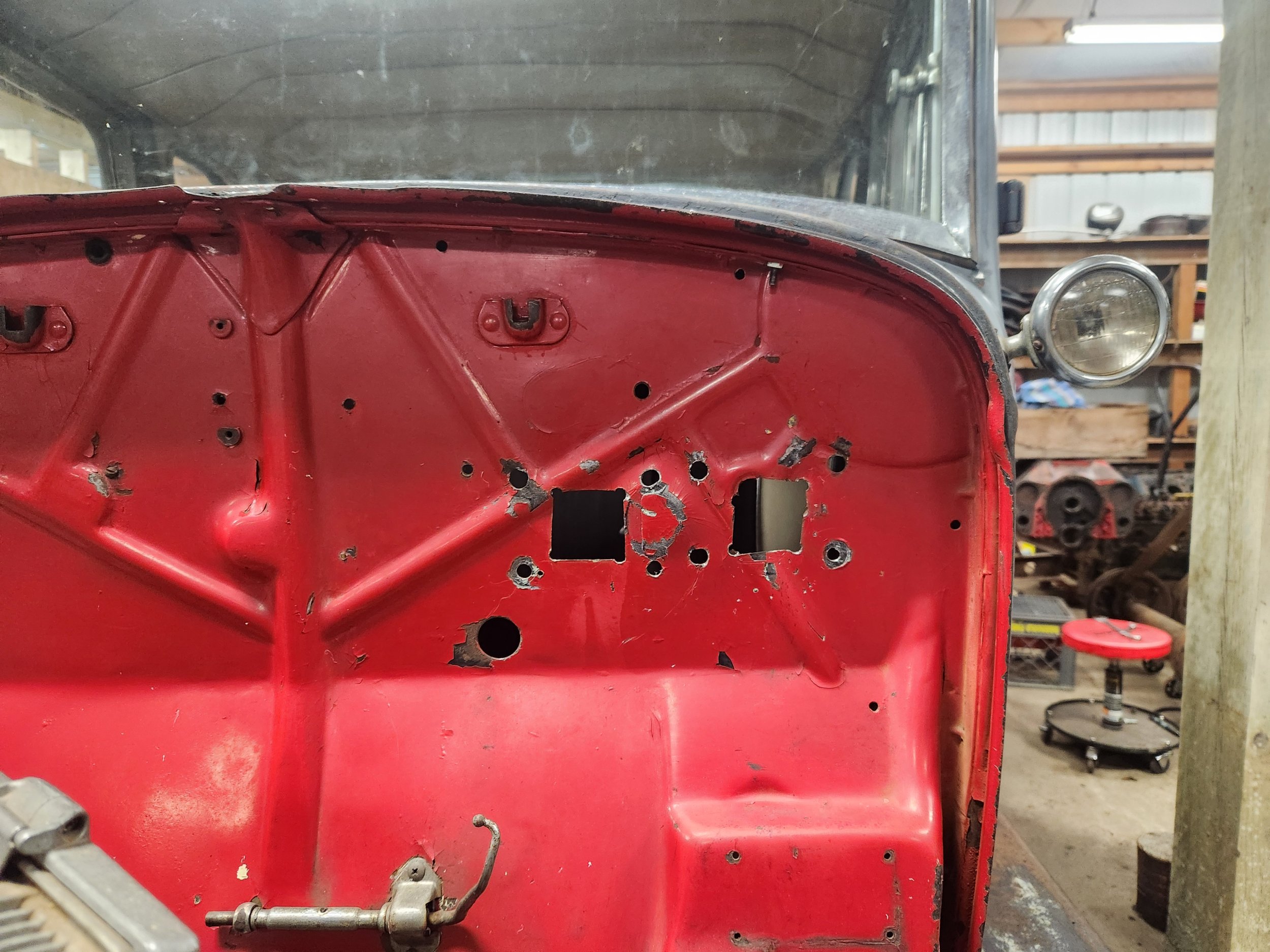

    Look forward to the build. As for cowl lights on 5 windows, one of my books mentioned they were available on them new as an accessory. Plus on a 90+ year old car who knows what occurred during all those years.
    RodStRace and Hitchhiker like this.

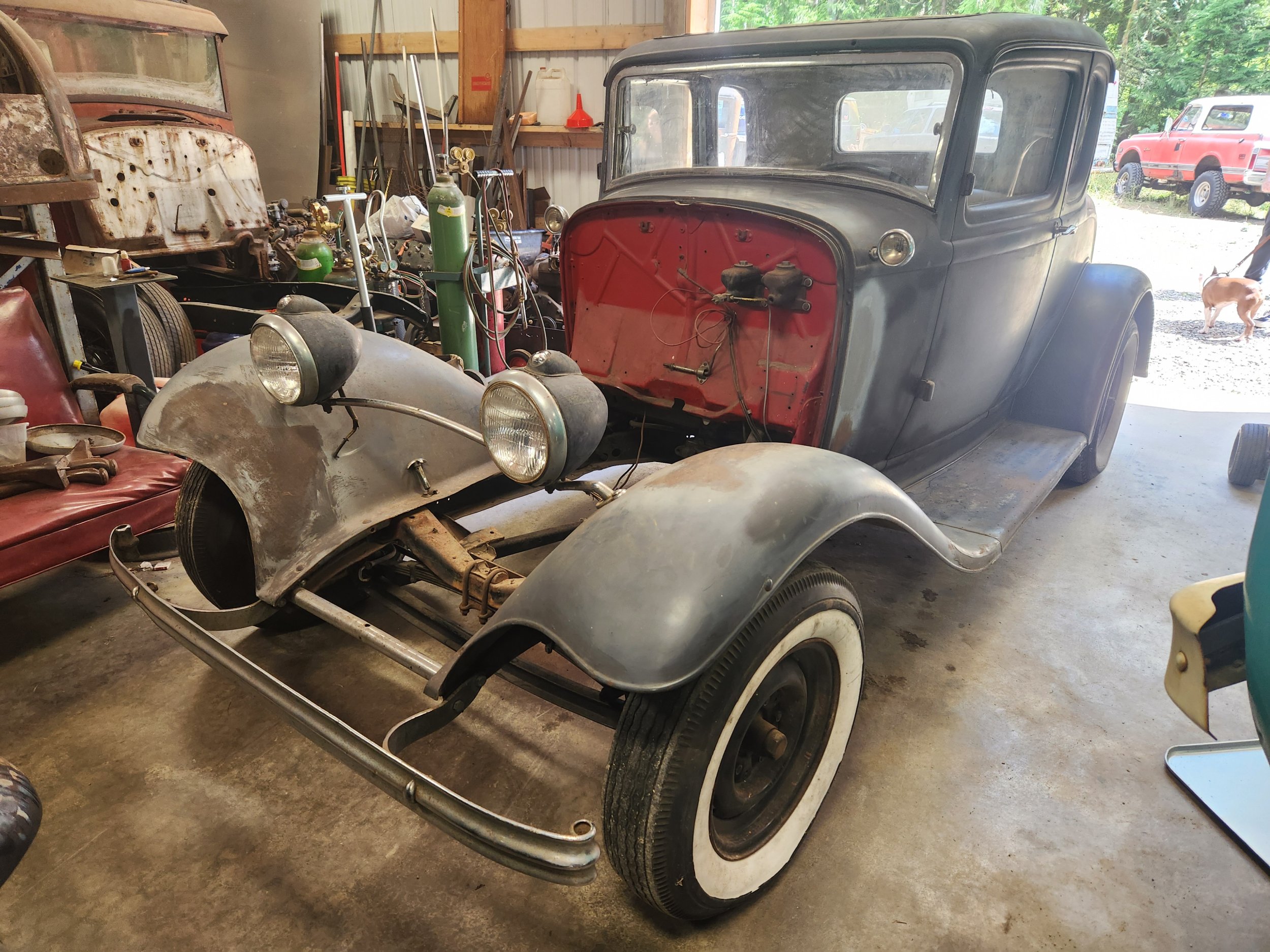

  6. I don't know about the cowl lights. Honestly, I'm not super versed on the intricacies of 32s. I better read up!
    The headlight bar is pretty crude. It's a cut and welded drop. Not heated. One of the reasons for looking for old picture. I'd love to know when it was done.
    The plans call for preservation of the car as best as possible. We're trying to preserve as much "as-is" vs. Tearing the whole thing apart. Car is getting a flathead again. Hopefully hooked to the 37 packard transmission. Maybe a slight height adjustment in front. Nothing crazy. Just cleaned up as best as possible. Kinda "budget build" as much as a 32 can be....lol

    Dig the rig! I'll put a vote in for leaving the cowl lights. I have them on my 34 (parking and turn signals) and people tell me they can see my flashers for a mile. Not right on every car, but since you are going for a preservation rather than salt racer, I think they belong.

  9. The owner likes them, and the plan is to make them into turn signals. This car will be a driver, so some touches like that will add some safety.

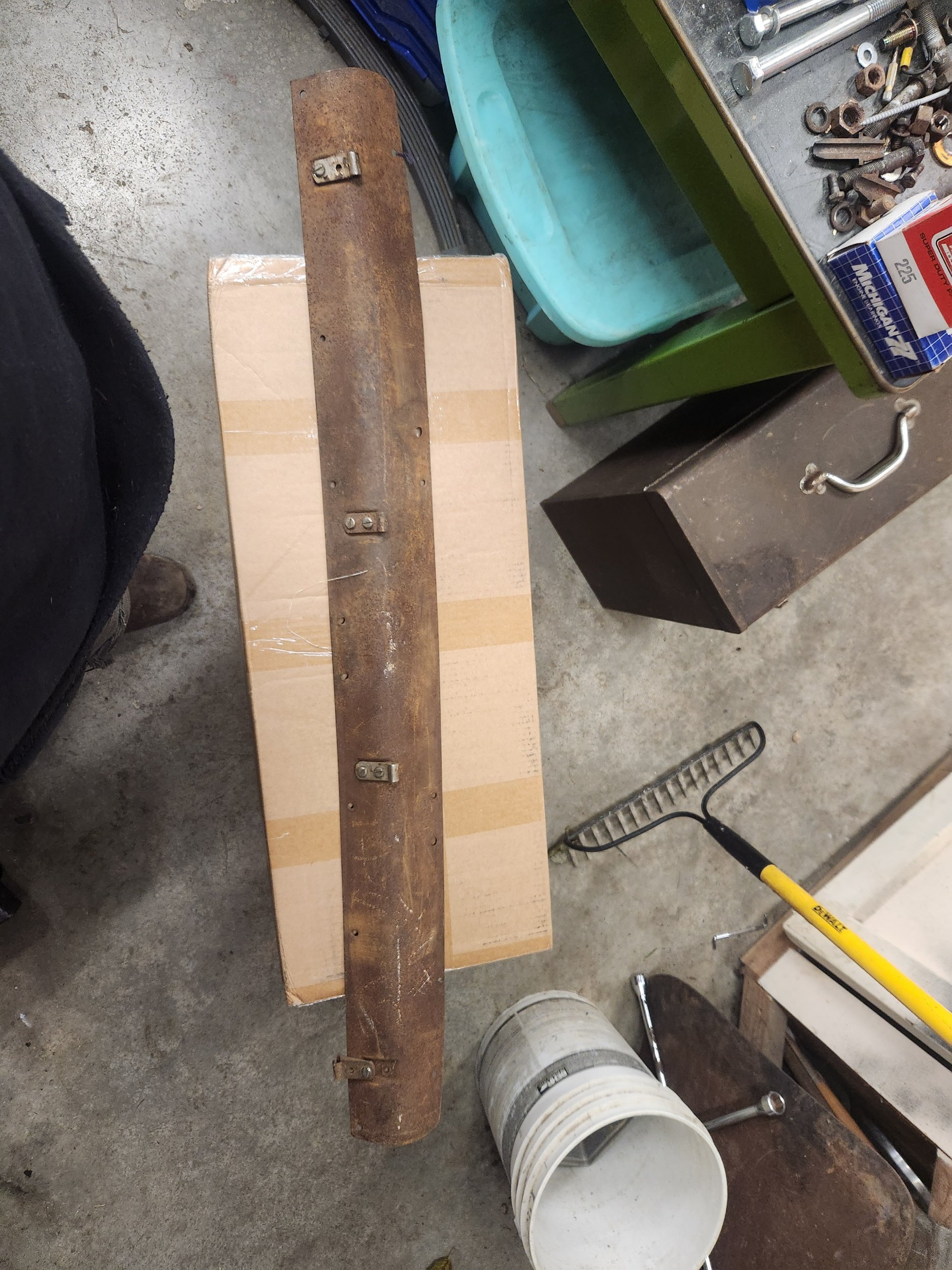

    Next I found a front splash apron with almost perfect patina to match the car.
    I also had this rough front crossmember that I will use to repair the one in the car.
    Still can't believe the splash apron. Such a lucky find. I traded a couple things I had to get it. He understood why this car needed it.

    my standard coupe had recesses either side ( internally) where we drilled a pilot hole and then drilled them out to fit reproduction cowl lights, to use as indicators.
    I had always understood the 5 window coupe came in a deluxe version including cowl lights, but from my time on this forum, I think that I may be wrong and they were more likely just an accessory as stated above.

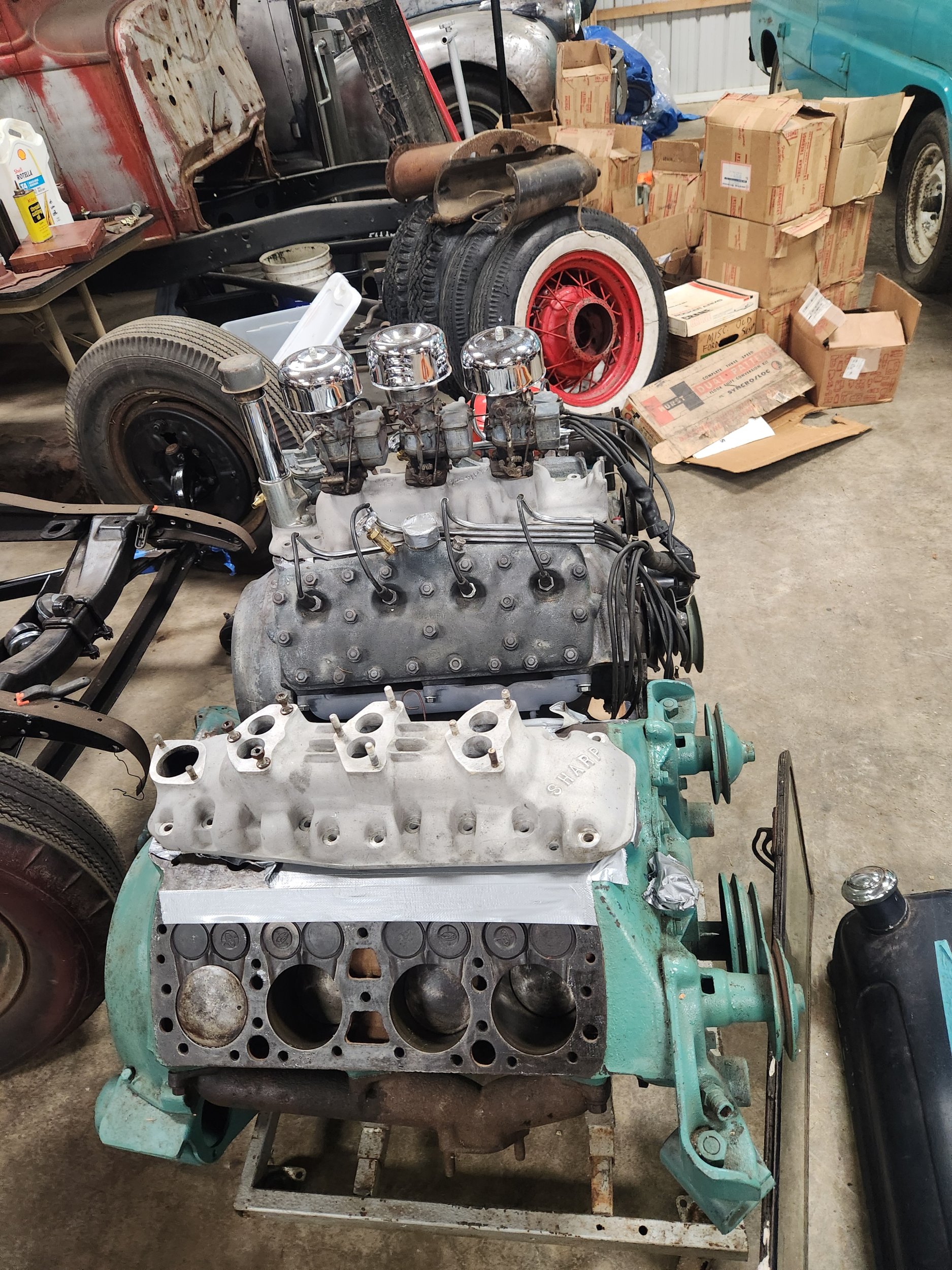

  13. I'll post a bigger update tonight, I'm still on the way home. But this is what I went and grabbed today.
    Been inside since the 60s. 59AB style block 3 3/16 bore. 4 inch merc crank. Wild reliefs. Adjustable lifters. Had a Sharp 3x2 on it...which i got also.
    Old race car stuff I assume. The 32 will be the perfect home for it.

    That flatty is bad-ass!
    Hitchhiker likes this.
  15. alchemy
    Joined: Sep 27, 2002
    Posts: 21,779
    alchemy
    I’ve never seen reliefs like that before. Wonder why it has late water pumps?
    41 GMC K-18, Kiwi 4d and Hitchhiker like this.
  16. I know! I had to have it as soon as I saw it! It's super cool.
    Neither have I, definitely interesting. I wonder how much it hurts flow, if anything? I'm assuming it's worse than a regular relief. But who knows? ... as far as the pumps, I wonder about that too. I'm assuming it was in something interesting. It has a 8ba timing cover and distributor as well. I was kinda guessing he wanted the easy distributor access for a racecar? Unfortunately the long time owner has passed away. So I didn't get to pick his brain.

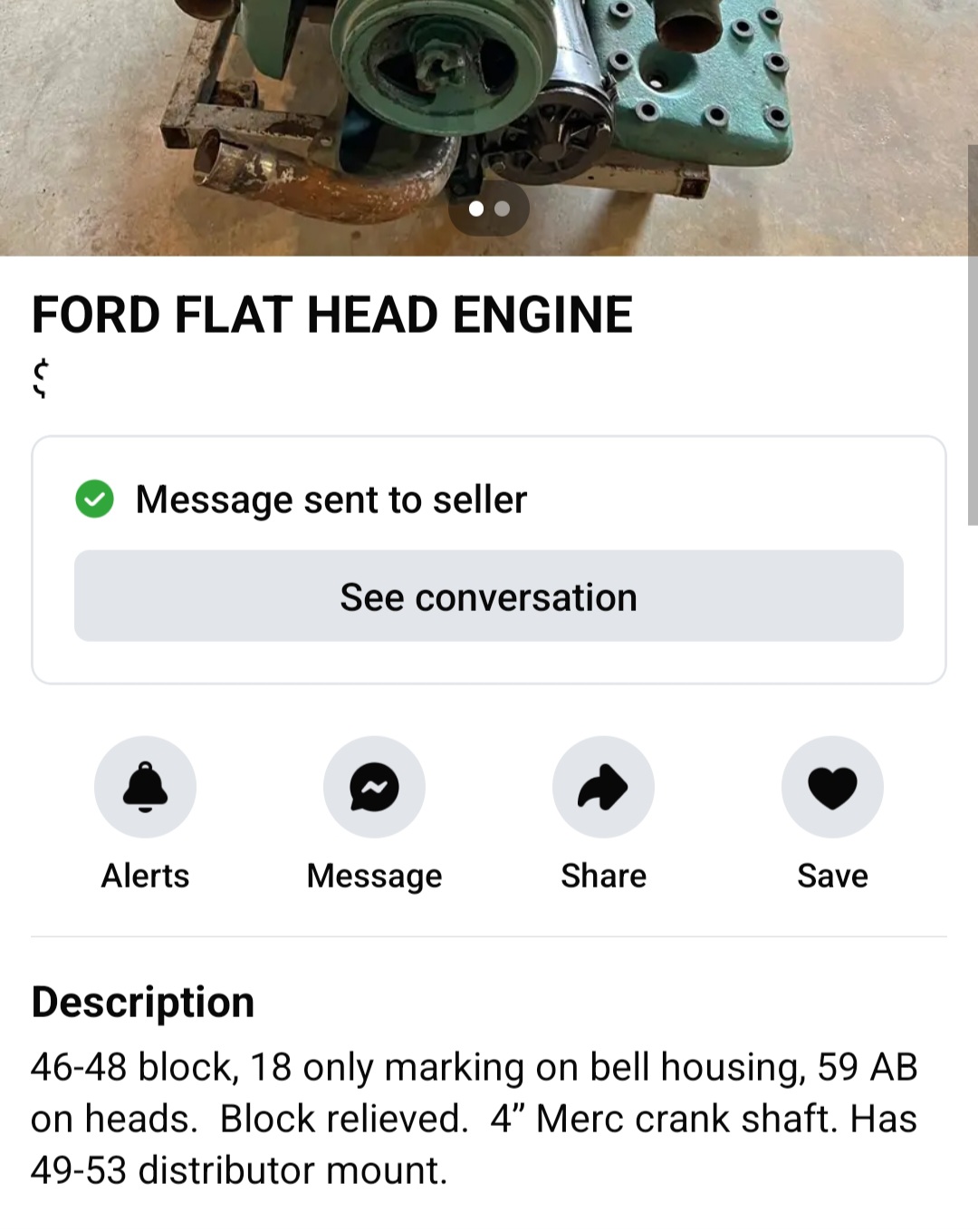

  17. So here is the story on the engine and acquisition.
    I've been looking for a suitable engine for the car since it got dropped off. The car actually came with a 8ba, with some decent new Offy stuff. It's a good engine, but not the "right" engine for this car. It just wasn't special enough. I know that sounds weird, and maybe I'm weird. But the car was telling me what it needed...and it deserved something REALLY special.
    My list of requirements was rather long, and thus made finding the engine I want a little difficult.
    59AB engine
    4 inch crank
    Relieved(hopefully factory)
    And obviously something that hasn't been stored on the bottom of Puget Sound.
    I had a couple leads on stuff but nothing I felt like dropping money on or driving to California for.... They were options. But considering my left leg was screwed, I could barely walk, my truck being a stick shift, and the seller not wanting to ship?... A California trip was a no go for me.
    Then I found this ad on Facebook marketplace
    As soon as I saw it, I had to have it. It was exactly what I wanted. So I fired off a message and went to bed.
    Then...nothing. the next day. Nothing. no reply message. No call. The next day, same thing....
    ... but the ad was still up.
    I figured, "hey, he's an old guy. He probably doesn't spend every waking moment on social media. He'll get back to me soon."
    So I waited and waited and pretty soon a week or so had gone by. Still nothing.
    I was looking at his Facebook profile. Day dreaming of buying the engine I wanted so badly. When I realized I knew him and had his number. He's a pretty big 1940 Ford guy, and I'd run into him when I was living on the peninsula.
    So I go digging, find the number, and make the call. I get his son on the phone, and the owner is in hospice, dying of cancer. Shit. That fucking sucks... big time.. My own father having passed 8 years ago from cancer. The last thing I want to hear about is ANYBODY dying of cancer. Fuck cancer. Iykyk.
    Obviously, at this point. I'm not gonna push them to sell me the engine. No big deal. A man's life ending, is far more important than an old ford engine.
    I do ask if they'll take my number down, and if/when things settle down to give me a call. And give them my respects and figure that's it...
    So I resume my search...if not a bit half heartedly. And assume I won't hear back.
    A bit of time goes by. A week, maybe 10 days?
    Then I get a call from one of the sons, asking if I am still interested in the engine. The father had passed and they wanted to help their mom get rid of the rest of his Ford parts.
    Of course I still wanted it, I said my condolences at his loss and we set up a time to come over.... Which was today.

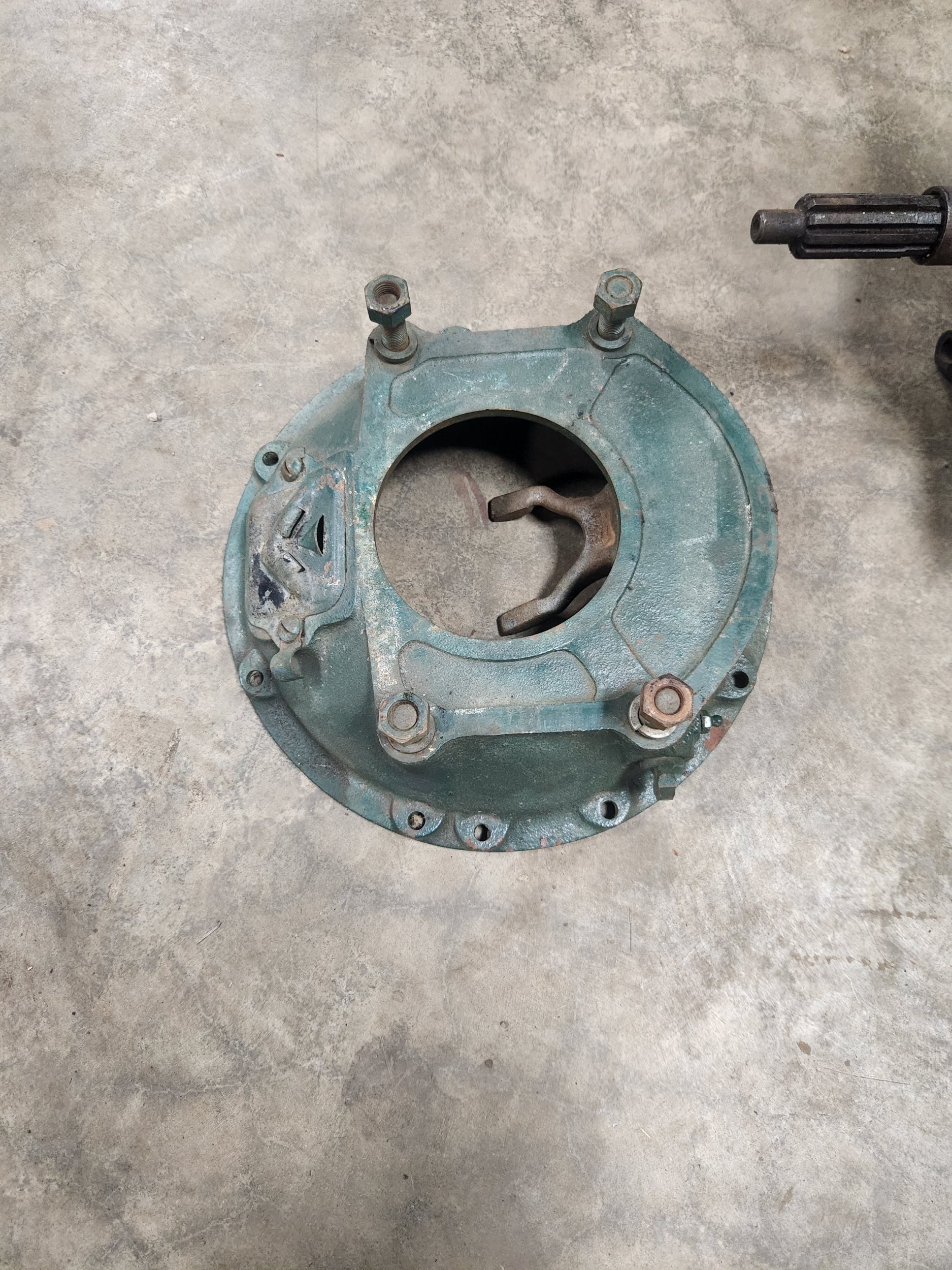

    This is the engine as it sat. Pretty much everything I wanted! But...of course there is more.
    I ended up buying 2 engines, and some old intakes! ...basically a bunch of stuff! I had to make a run to the bank as I stupidly only brought money for the green engine! What was I thinking?
    The block letter Sharp intake came on the green engine in the 60s when Ed bought it. I was able to purchase it along with the other stuff pictured.
    I'd love to know some history on the engine!
    So all on all, it was a pretty good day after a few weeks of nail biting.
    I'd like to thank the Swan family for selling me this old engine and Ed Swan for saving it for me all these years!
    Rest in peace, Ed. She went to a good home!

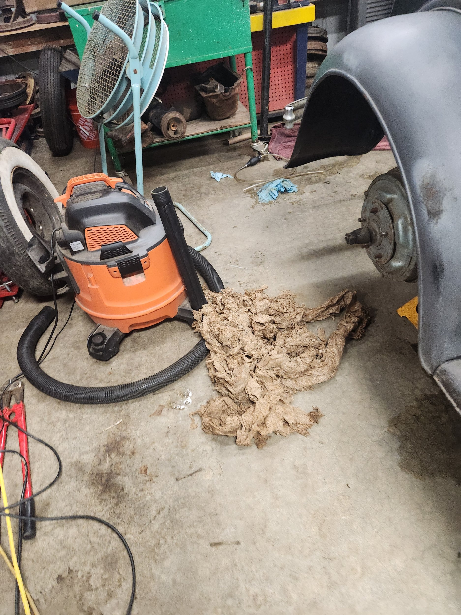

  18. Started pulling this "stuffing" out of the deck lid. Probably asbestos. Decided to pull the lid for cleaning and for better access to the trunk. The bolts holding the deck lid on were likely not correct and the lid was very floppy. Something we'll need to fix in the future. 20241107_143916.jpg
    Here is the stuff coming out.
    I've also washed and hand scrubed most of the frame from the k member forward. Just trying to get all the grease off everything and have a clean slate.
    and I started pulling stuff that isn't staying. Like wiring. Old brake lines, master cylinders and pedals. The pedals were only bolted on at the firewall....I'm starting to understand how polished aluminum firewalls became popular to put over butchered originals. Nothing beats a stock firewall for me. So we'll be repairing this one.
    Hopefully I'll have a video out this weekend that covers this more in depth.

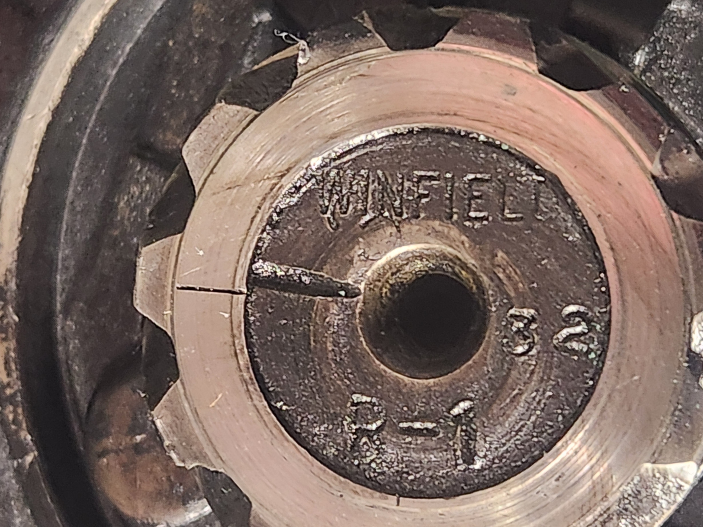

  19. Pulled the timing cover....
    finding a Winfield cam was a nice cherry on top.

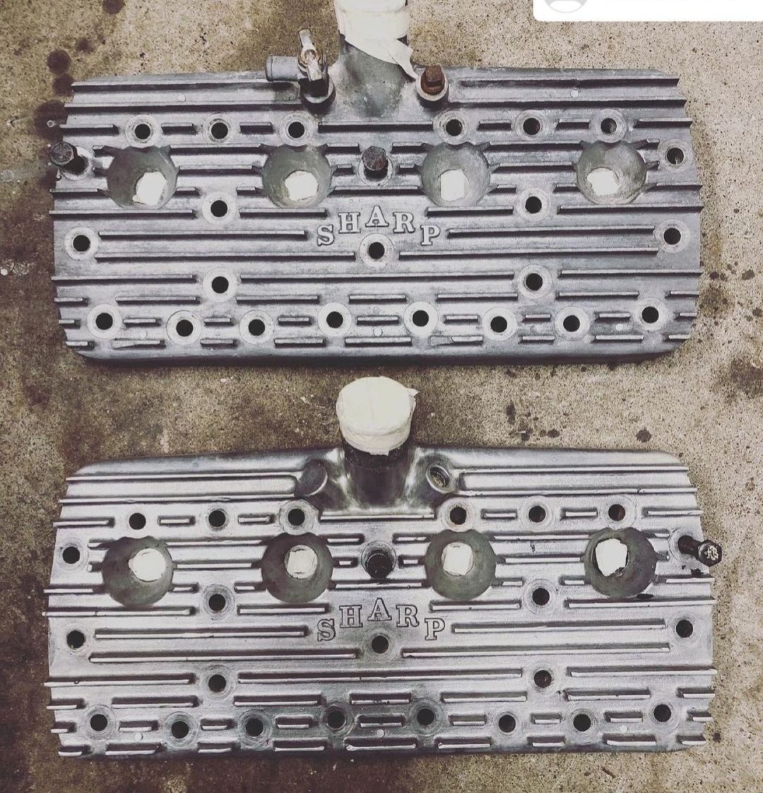

  25. The 2 things I need really badly right now are
    1) a REALLY nice original 32 firewall
    2) and nice set of block letter Sharp 59AB heads. There is a rough set on ebay currently, but I'd prefer to find a nicer set to start with. And I do know about the H&H repo which are an option...even though they only come in script letters on the repo.

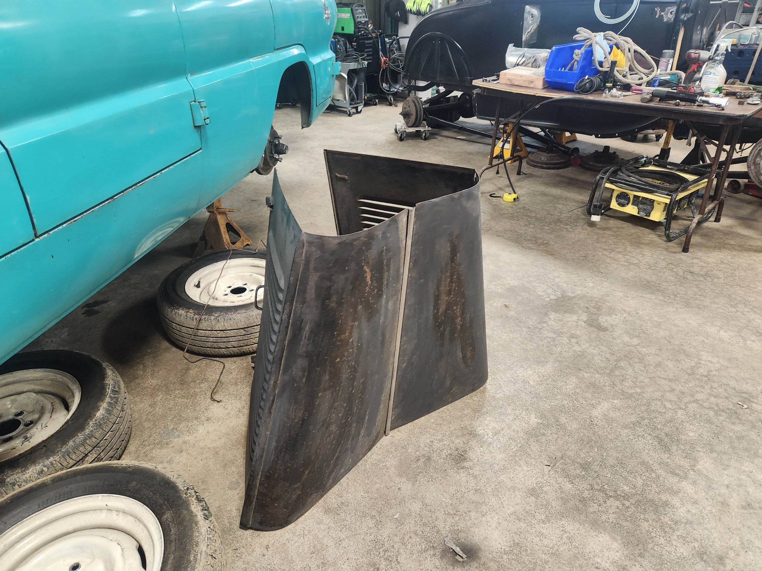

  26. Well...its been snowing. Hard. We have 5-6" here. Luckily I'm stocked up on oil and have the heater blasting. Work in the shop is going.
    As far as the 32 is concerned we've had some project scope creep.
    Firewall has been acquired. It had a blemish that Texas Matt cut out and fixed.
    He also built this cart. Just about perfect for putting a body on....while we fix the frame.

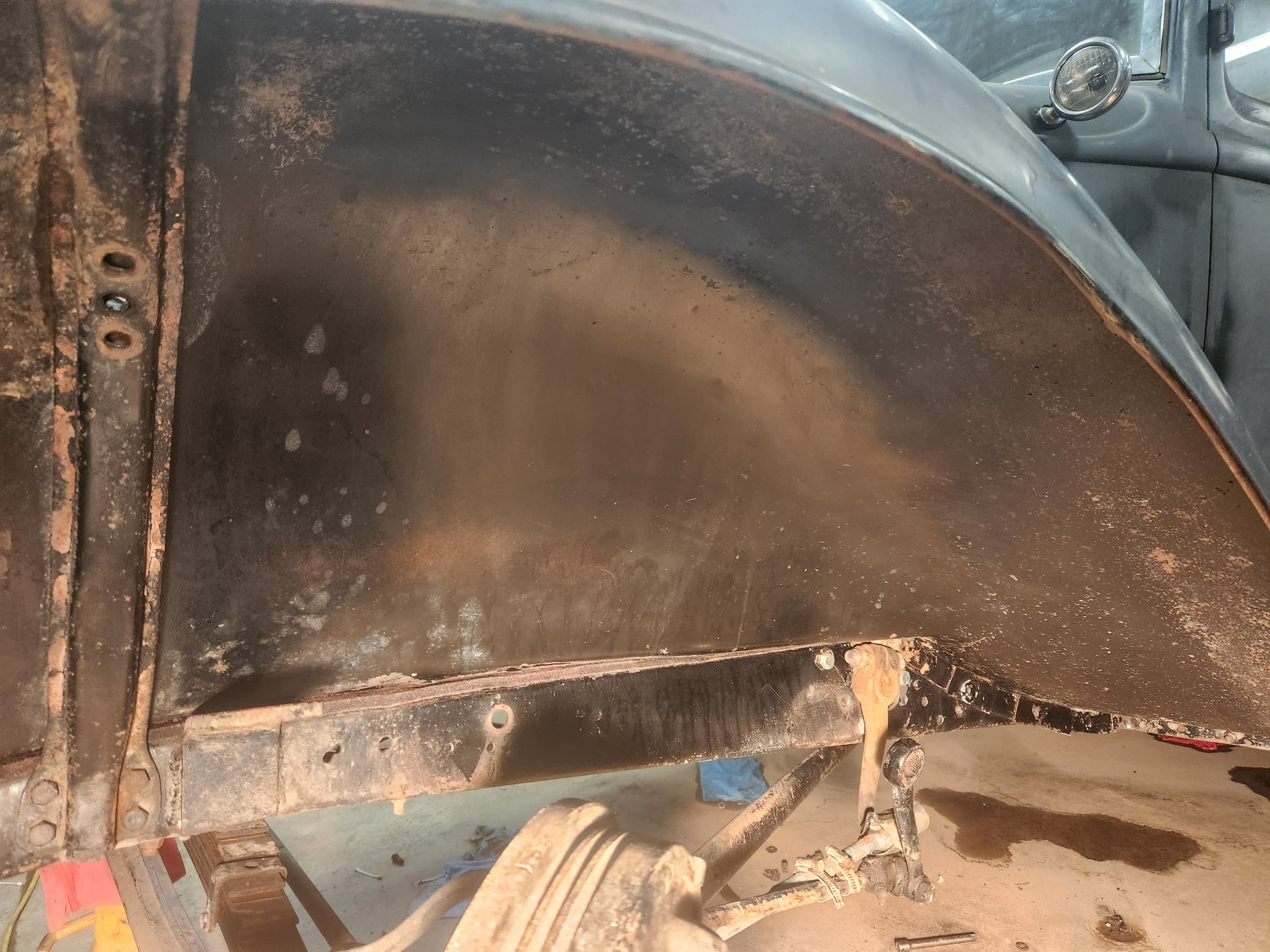

    Unfortunately, this car has typical 1932 rear frame sag and the wheel base is off side to side. It should be noted that the front crossmember is also bolted in. This is all important stuff and we've(myself and the owner) have decided it's best to make the old girl sound in the chassis department. Even if she'll be a little "worn" on the outside.
    With this I set about removing the fenders. I gave several spray downs of Kroil. Over a period of a week or so and I was able to remove all but 1 bolt. Which I ended up cutting.
    They came off easy enough.
    Throwing the tires back on, I knew it was gonna look cool!
    Than I moved to the front...
    I gotta admit, there is something incredibly cool about taking the fenders off a 32 that have likely been on there longer than you have been alive. Next up! The body comes off and the frame goes on the frame table. I'll have an accompanying video out soon on this. But wanted to document this as my first time taking the fenders off a 32 ford. And figured ya'll could have a sneak peak too.
    Sorry for the poor picture. Should have taken the welding blanket off
