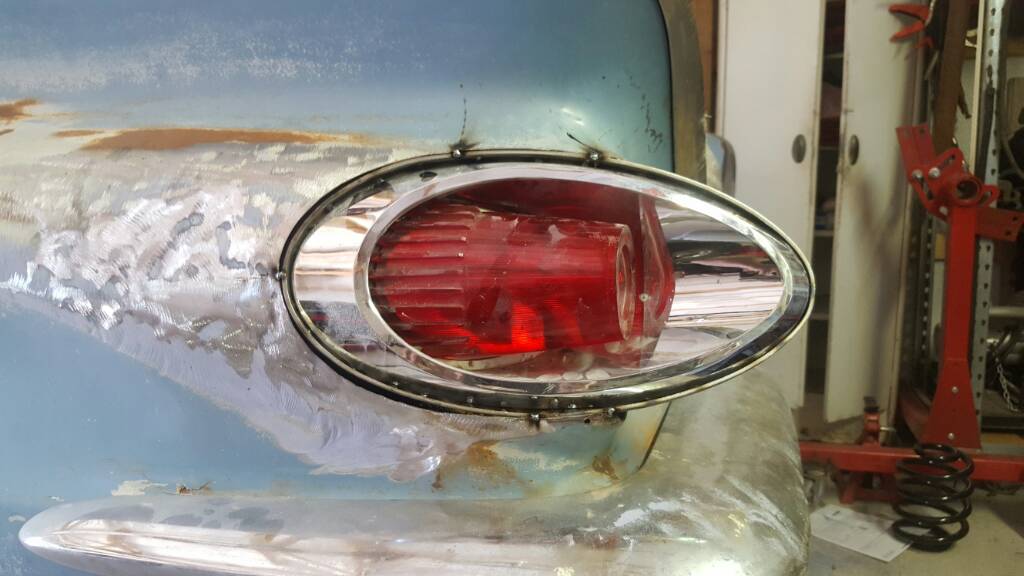

    I knew there was some old damage behind where I was mounting the Polara taillights so I ground it off and founf the quarter was somewhat flattened. Roughed it out round again and helped a lot with the fit on the new light. Felt good enough about it to tack it in

    Amazing how well those lights fit the Buick contours. Looking good!

    So cool! When you get a chance could you take a shot from behind looking straight at the light? I'd like to see how it looks from the rear.

    great job G V , at first I didn't grasp what you were doing with the cone shapes.
    Now it all makes sense.
    The Moose did a good pshop too.
    I agree, those lights look better on the Buick than on the Dodge.
    That'll be an attraction at the car shows for sure.

    Yea, I didn't end up using as much of the old headlight buckets as I thought I would, but by the time I got it lined up and fitted this was all that was needed. You kind of make this up as you go along. I'm pleased with the way it is looking.
    Bill, when I get the brakes finished and can pull it out of the garage I will get better shots.

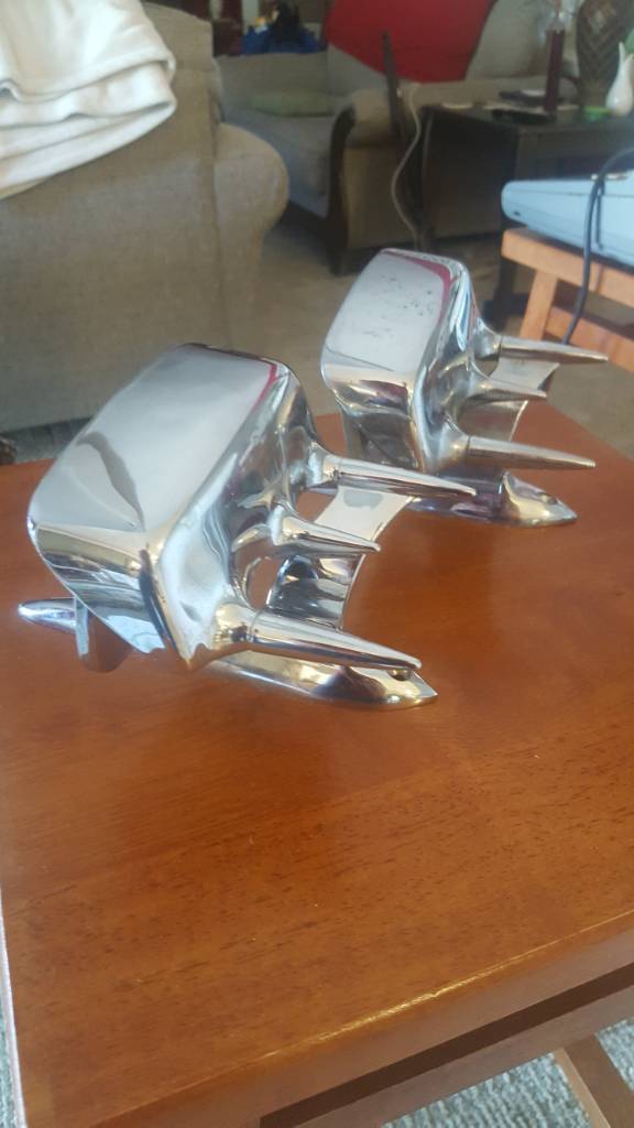

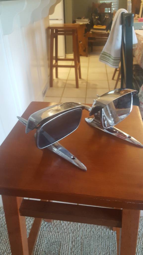

    Well, don't know if it counts as progress or not but I aquired a pair of 2701 Autolite mirrors which I think are going on the Buick.
    Been trying to get the T back together so the custom project had just sat this summer. 20180808_123757.jpeg 20180808_123747.jpeg

    Those mirrors are way cool. The Buick is looking great so far, keep us in the loop.
