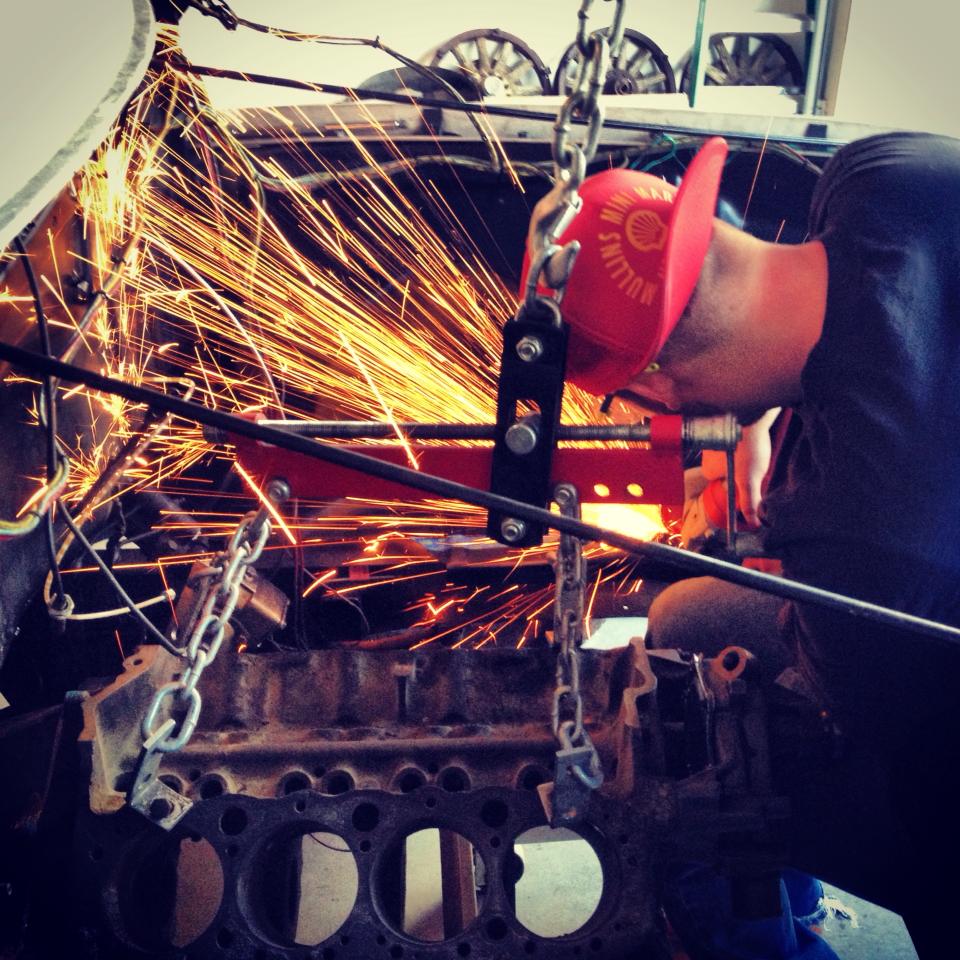

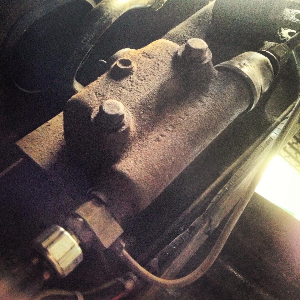

    The previous owner "installed" an unknown powersteering rank (I believe it was from a Taurus or something similar. The custom crossmember was a disaster. And yes that is the right front brake line coming across the trans & power steering crossmember!!!:eek:
    So I got a little wild with the sawzall:

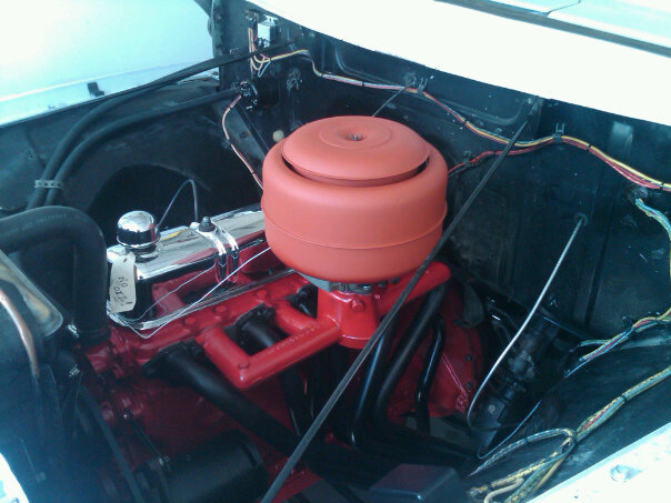

    I think oil bath air cleaners are so cool.
    But instead of modifying the above one (from a bigger carb) I decided to go with a factory single barrel one. I also ran a hard fuel line and a hard line for the load-o-matic advance. You can see the rebuilt column and box in this picture too.
    Mocked up a down and dirty exhaust.
    And had a buddy burn it in for me.

  9. Looks like the Taurus rack. Man looks like they melted it with the welder and those booger welds. Looks good now!

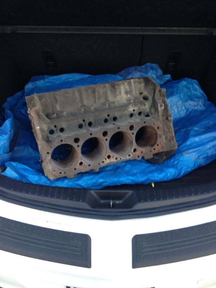

    A few of my friends said to rebuild the 6 again (either repair or replace the block), some said Y-block, Nailhead, or SBF. I want to just be able to drive this and have parts available quick.
    It was a quick call and soon this was at my door.
    To mock the new motor up I cruised over to Keven's (birddog) house for a bare block, and threw it in the back of the wife's Mazda3. I also grabbed an empty trans case from milkweed.

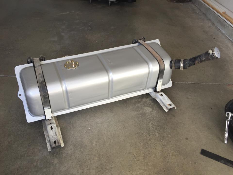

    And while I was at it I decided to eliminate 60 years worth of dirt, rust, and crud from the fuel system. Along with new stainless lines I ordered a replacement from Tanks. It is a nice unit:

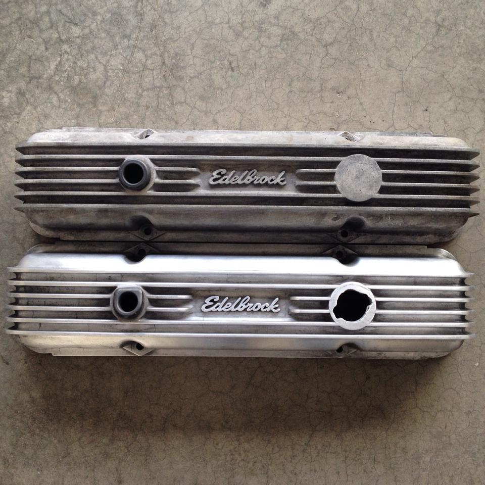

    I picked up an old pair of Edelbrock valve covers CHEAP on eBay. They needed cleaned badly and detailed (top is as bought and bottom is after serious scrubbing)...
