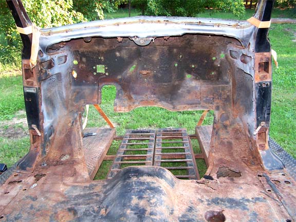

    I used it to put new floors in this plymouth- made new rockers/inner and outer/ with new steel everywhere. I can't imagine life before a roto now... those gray lines are seam sealer before I laid down primer.
    I added a before and after pic---
