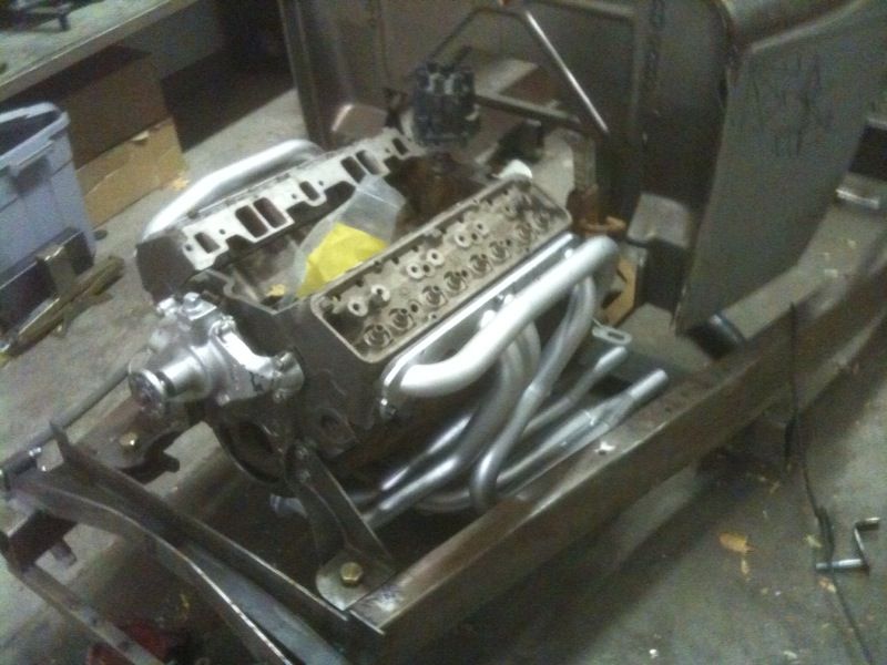

    Your telling me I have too much time on my hands?!? Come on dude, we build hot rods! Its the biggest waste of time ever! do hot rods cure diseases? do they solve delicate Arab-Israeli relations? No. Lets all have fun!

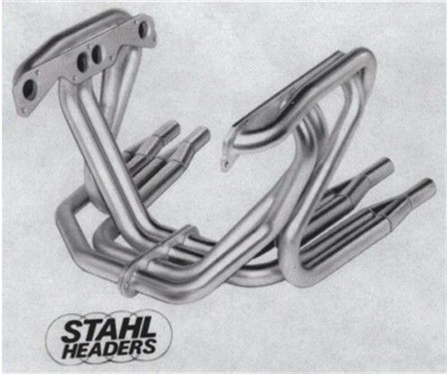

    sorry no pix . that was in the '70s . ran fender well also . what ever was around ! .. 180's are more for dirt cars , you lose the firewall & have to make firewall & floorboards to cover them up . they normally come out behind the dist & over the bell housing & trans ................... steve

    That's the F.I. system you're running? I'll bet those throttle bodies will just LOVE ****ing in all that nice hot air from the headers. Should make huge power.

    Back in '70 ,i helped a friend put a set of 180 degree hedders on his Big Block Mustang ,,all under the motor ,,we had to raise the front 'bout 7 or 8 inches so the darn things wouldn't drag on the hi way ,,we got the hedders already made up from the Old Gapp & Roush drag team ,,Later ,,in NASCAR ,,Roush ran those 180's on his Ford Race Cars ,,after winnig a bunch of races ,,everybody was tryin' em ,,BUT ,,just like everything else ,,they went out of style in favor of the Step Hedders with the Merge Collectors ,,which made a bunch more horsepower that those odd ball sounding 180's ,,

    I don't even want to think of the primary lengths on some of those tubes! As for equal length, to take advantage of the equal firing sequence - not so much.

    Wouldn't those throttle bodies look better on a tunnel ram somehow?? I mean, while you're being crazy.

    I dont think he said anything about his homebuilt EFI untill somebody else made a remark about the 2BBl on that engine.
    As for the heat, maybe he is underestimating that problem
    Maybe I am too, but I think with some heatshields, some insulation, and maybe some exhaust wrap it could be OK.
    At least we wont be frying our starters like you do with a lot of header systems
    So that is kinda practical, right? :D
    Yesterday it was about 107 in the shade, monsoon is starting so its humid.
    I have no cooling in my shop, and the metal was hot even before I started welding on it.
    If the heat inside my car ( I have one with 180 headers too ), gets higher that my tolerance level can handle I could be in trouble.
    We'll see...:D

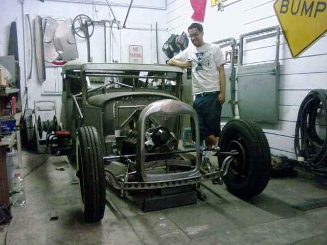

    ( I got these dirttrack headers off Ebay, really cheap.
    So I cut and shut them to work in my car.
    And then I cut and shut the car to get 9" more engine setback. :)
    If you go over to the Dogfight Forum you can see a Thread on it.
    O/T for the HAMB...)

  28. ramaro
    Joined: Apr 1, 2007
    Posts: 106
    ramaro
    that is awesome! are you going to run four pipes all the way back? going to sound great!
    I have an Idea for the alt mount, and thats my only accessory
    I plan on ducting the intakes away from the header
    4 of the pipes are 4 inches shorter than the other 4. It might be possible to chop off the shorter ones and build them longer, I'll see tonight.
    I was thinking about running them under the car,but I ultimately want this thing pretty low, and tri-fives dont have much room for exhaust under the car(im still using the bellhousing mounts). im going to run them out behind the tires into a lakes pipe.
    i was running this induction before, but the plenum design and injector angle was unsatisfactory, so I'll be working on that while I'll drive it with the 2bl.
    the previous 283 scored up the cylinder walls and started smoking, so I found another one and rebuilt it(this time with brand new rings!)

    It seems to me that I tried to figure a set for a BBC in a bracket car with struts up front. I only had to cross over 2 tubes to get what I wanted. I didn't bother because drag racers are damn near like snowmobiles with regard to RPM. 180 headers bump the torque curve in the low and mid (already stated) which really helps coming out of corners, hence their popularity in sports cars and mid-engine combinations. No corners on drag strips, and the fact that our car only used like 2000RPM rise in a run, well **** it. Not worth the effort. As fun as that looks (admit it kids, it looks like fun) you may run into some issues but if you're up to the challenge, go for it.
